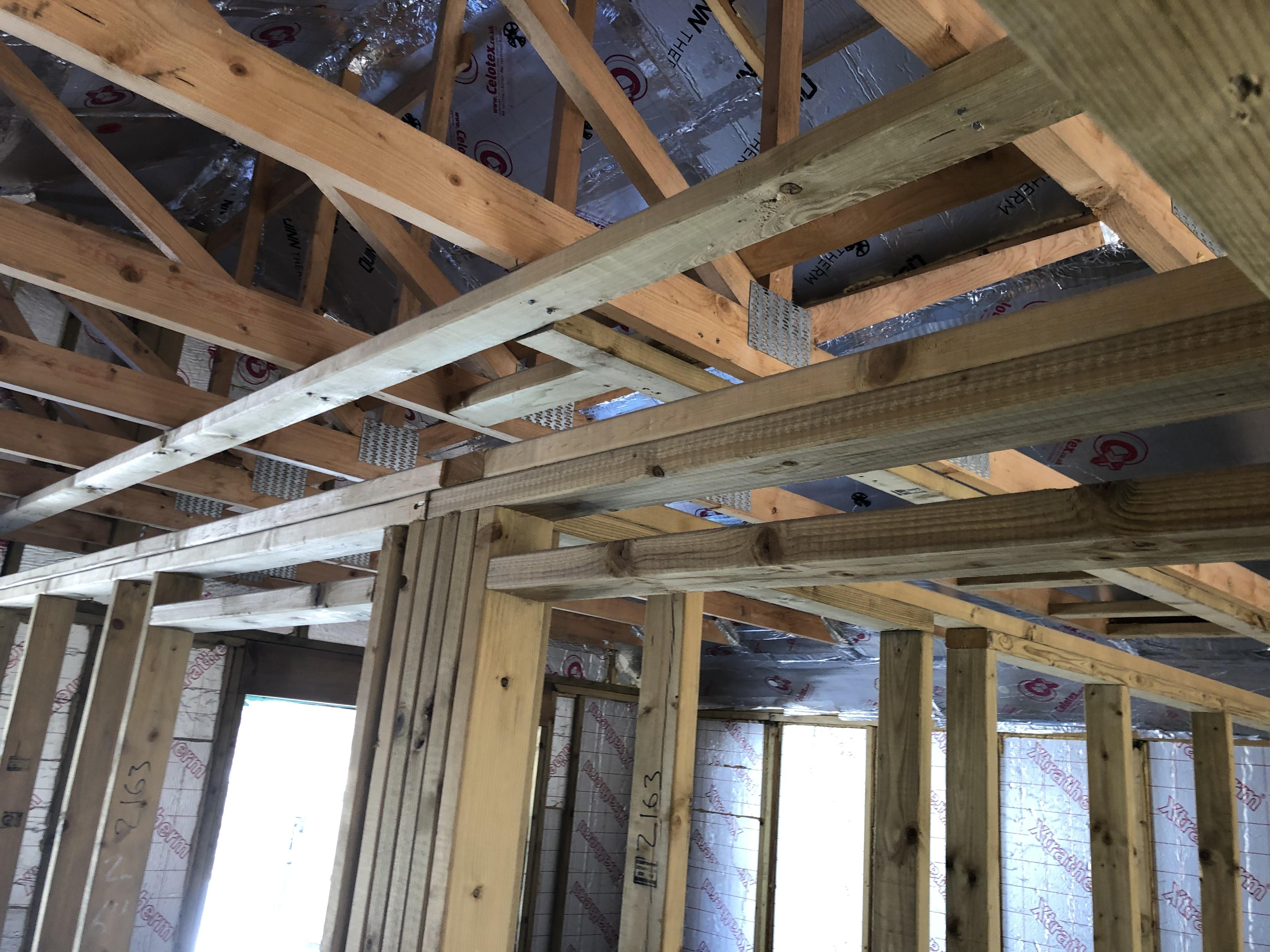

Mr Punter Posted July 9, 2019 Share Posted July 9, 2019 On 02/07/2019 at 13:15, pocster said: Not 1 truss the same distance apart . You may want to consider cross battening under the trusses with 25 x 50 or 38 x 50 at 400 ctrs for your plasterboard and your electrics. 1 Link to comment Share on other sites More sharing options...

Pocster Posted July 10, 2019 Author Share Posted July 10, 2019 13 hours ago, Mr Punter said: You may want to consider cross battening under the trusses with 25 x 50 or 38 x 50 at 400 ctrs for your plasterboard and your electrics. The trusses as they are shouldn’t have plasterboard screwed to them ??? Link to comment Share on other sites More sharing options...
