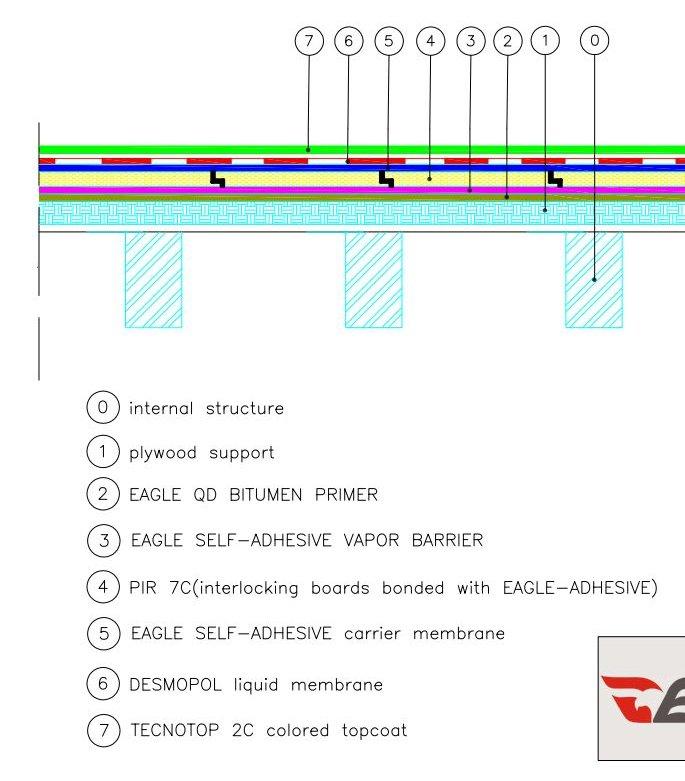

SteamyTea Posted June 12, 2020 Share Posted June 12, 2020 2 minutes ago, Onoff said: It was polyurethane liquid waterproofing systems was thinking of. Seems you lay a mat down as you would with fibreglass etc. Think this is the system that someone on here once used. https://www.apolloroofingsolutions.co.uk/market-page/liquid-coating/ 3 minutes ago, Onoff said: Only colour here is brown mind? How do you get brown in the sun? "Come on Brown, it is lovely out here" 1 Link to comment Share on other sites More sharing options...
Onoff Posted June 12, 2020 Author Share Posted June 12, 2020 8 minutes ago, SteamyTea said: Think this is the system that someone on here once used. https://www.apolloroofingsolutions.co.uk/market-page/liquid-coating/ How do you get brown in the sun? "Come on Brown, it is lovely out here" Can you remember who? Link to comment Share on other sites More sharing options...
SteamyTea Posted June 12, 2020 Share Posted June 12, 2020 6 minutes ago, Onoff said: Can you remember who? No, and it may have been the predecessor site, or even the other place. Link to comment Share on other sites More sharing options...
Onoff Posted June 12, 2020 Author Share Posted June 12, 2020 43 minutes ago, SteamyTea said: No, and it may have been the predecessor site, or even the other place. @MJNewton used Desmopol I found from some searching. How's it standing up? Link to comment Share on other sites More sharing options...

MJNewton Posted June 12, 2020 Share Posted June 12, 2020 (edited) 4 hours ago, Onoff said: @MJNewton used Desmopol I found from some searching. How's it standing up? Yes, all fine thanks. It's only been 18 months though so maybe a bit early to comment on longevity which is probably what really matters. It's been really tested though over the past year with the rain, and the fall isn't the best (builder made an error with the firrings.... grrr - still winds me up) so if there was an issue I'm sure I'd have seen it now. I'd definitely use it again - easy to apply (a roofer did mine but next time I'd DIY) regardless of complexity if surface/upstands/etc, no seams, tough yet elastic etc. The only things that do bother me about it is 1) hardly anyone else seems to use it (the manufacturer told me they sell very little to the UK compared to other countries and, for what it's worth, stating that the UK market does tend to hold on to its traditional building methods so it's been a tough market to break in to), and 2) I do wonder if Desmopol is all that different from those 'quick fix in a can' paint-on roof repairs that even the manufacturers state are for temporary use only. That said, Desmopol does have a BBE certificate and comes with a 15yr (or is it 25?) guarantee that can be extended 5yrs at a time by an additional coat over the old one every 10(?) years so I'm as confident as I would be for any flat roof covering I think. Here's a pic (of the roof lantern really but's got most of the roof in) after around a year: Edited June 12, 2020 by MJNewton 1 Link to comment Share on other sites More sharing options...
Onoff Posted June 12, 2020 Author Share Posted June 12, 2020 18 minutes ago, MJNewton said: Yes, all fine thanks. It's only been 18 months though so maybe a bit early to comment on longevity which is probably what really matters. It's been really tested though over the past year with the rain, and the fall isn't the best (builder made an error with the firrings.... grrr - still winds me up) so if there was an issue I'm sure I'd have seen it now. I'd definitely use it again - easy to apply (a roofer did mine but next time I'd DIY) regardless of complexity if surface/upstands/etc, no seams, tough yet elastic etc. The only things that do bother me about it is 1) hardly anyone else seems to use it (the manufacturer told me they sell very little to the UK compared to other countries and, for what it's worth, stating that the UK market does tend to hold on to its traditional building methods so it's been a tough market to break in to), and 2) I do wonder if Desmopol is all that different from those 'quick fix in a can' paint-on roof repairs that even the manufacturers state are for temporary use only. That said, Desmopol does have a BBE certificate and comes with a 15yr (or is it 25?) guarantee that can be extended 5yrs at a time by an additional coat over the old one every 10(?) years so I'm as confident as I would be for any flat roof covering I think. Here's a pic (of the roof lantern really but's got most of the roof in) after around a year: I'd say it's likely superior to the acrylic roof repair compounds. I've tried a number of makes Aquashield, Cromapol, Flexacryl etc. On my crap felt roof (see the other thread) they all give up after a while. It's a yearly redo job. I might be being unfair to them as the substrate they are being put on is basically live! Where's good to buy Desmopol from then? Link to comment Share on other sites More sharing options...
MJNewton Posted June 12, 2020 Share Posted June 12, 2020 (edited) 12 minutes ago, Onoff said: Where's good to buy Desmopol from then? Good question; it doesn't seem to be all that widely available when I looked around for where I might get it from in future. I know my roofer got his from Raven Roofing Supplies although there's no mention of it on their website (which is odd as they do training courses for it too). I'd get it from there as they's local but I'd suggest others contact Eagle Insulations as they are the UK distributor I think. Edited June 12, 2020 by MJNewton Link to comment Share on other sites More sharing options...
SteamyTea Posted June 12, 2020 Share Posted June 12, 2020 @MJNewton Did you use glass fibre mat when your builder did it, or was it just painted/rollered onto a board of some sort? Link to comment Share on other sites More sharing options...
Onoff Posted June 12, 2020 Author Share Posted June 12, 2020 15 minutes ago, SteamyTea said: @MJNewton Did you use glass fibre mat when your builder did it, or was it just painted/rollered onto a board of some sort? Some videos of it on YouTube. Link to comment Share on other sites More sharing options...
PeterW Posted June 12, 2020 Share Posted June 12, 2020 Rawlins sell it. https://www.rawlinspaints.com/home/roof-paints/flat-roof-paints/3874-eagle-desmopol-liquid-polyurethane-membrane.html 1 Link to comment Share on other sites More sharing options...
MJNewton Posted June 13, 2020 Share Posted June 13, 2020 10 hours ago, SteamyTea said: @MJNewton Did you use glass fibre mat when your builder did it, or was it just painted/rollered onto a board of some sort? There was an 18mm OSB deck and he put matting just over the joints. Link to comment Share on other sites More sharing options...
SteamyTea Posted June 13, 2020 Share Posted June 13, 2020 (edited) Just now, MJNewton said: There was an 18mm OSB deck and he put matting just over the joints. Makes sense, lot less fiddling about. Almost the same as my idea of GRPing a flat room. Just do the joints on site. Edited June 13, 2020 by SteamyTea Link to comment Share on other sites More sharing options...

SteamyTea Posted June 13, 2020 Share Posted June 13, 2020 2 minutes ago, MJNewton said: Slight correction: it was actually a ply deck (the OSB was used below the insulation). Be interesting to see how it works on OSB, someone one here wanted to know what the best paint for OSB was. Just had a look at @Onoffvideos. Roof really are made in a most ridiculous way. Almost as if they are made from the leftovers on site. I am surprised that there is not a modular, mass produced in a decent factory, system. Link to comment Share on other sites More sharing options...
