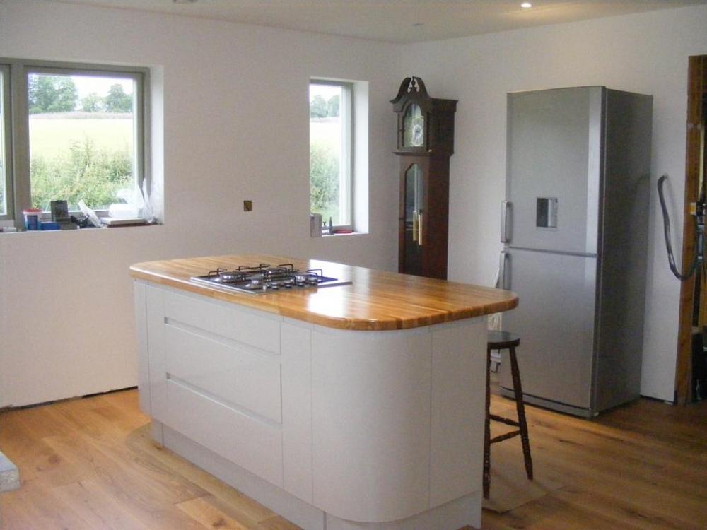

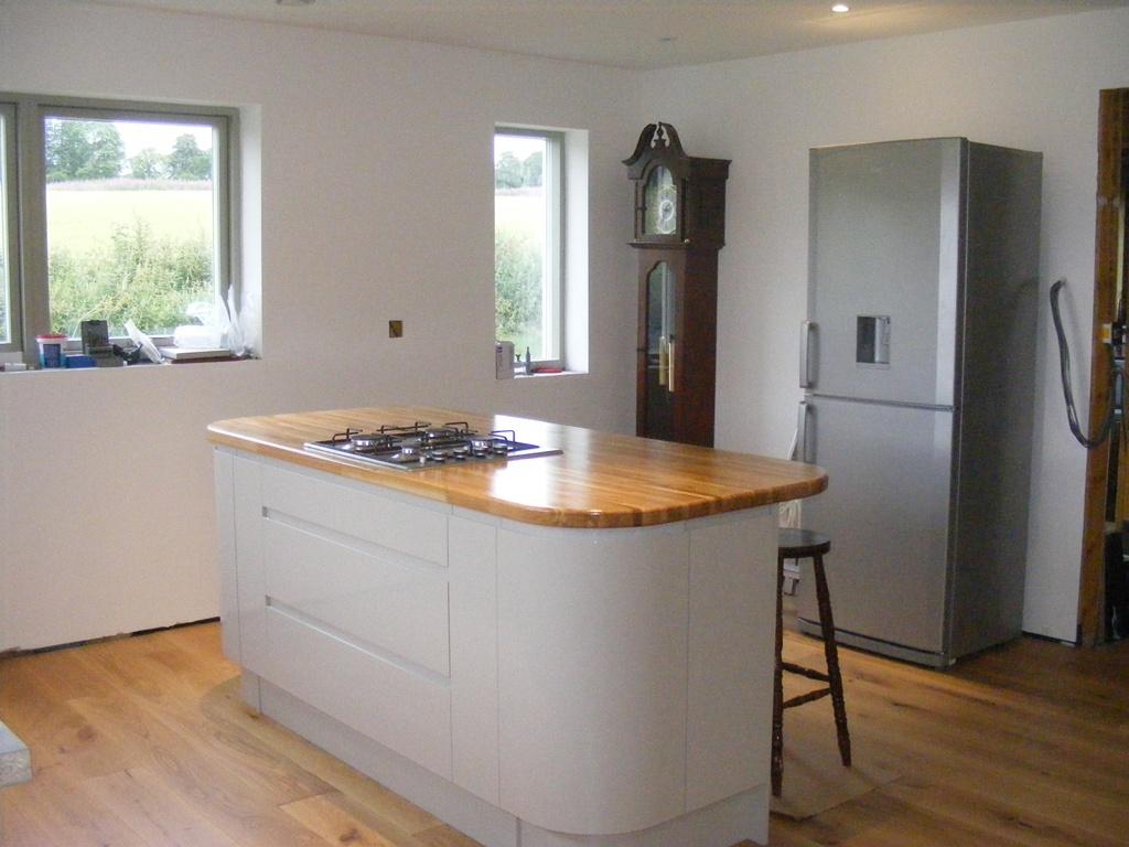

ProDave Posted June 20, 2019 Share Posted June 20, 2019 We have a (Howdens) Oak worktop on the kitchen island. I didn't oil it, but varnished it, with the better option 2 pack varnish that Howdens sell, but I forgot to note the actual make of the varnish. 2 coats on the underside, and 3 coats on the top, applied by roller. Nothing stains it, not even red wine, everything just wipes off. I do avoid putting hot things on it. Link to comment Share on other sites More sharing options...
