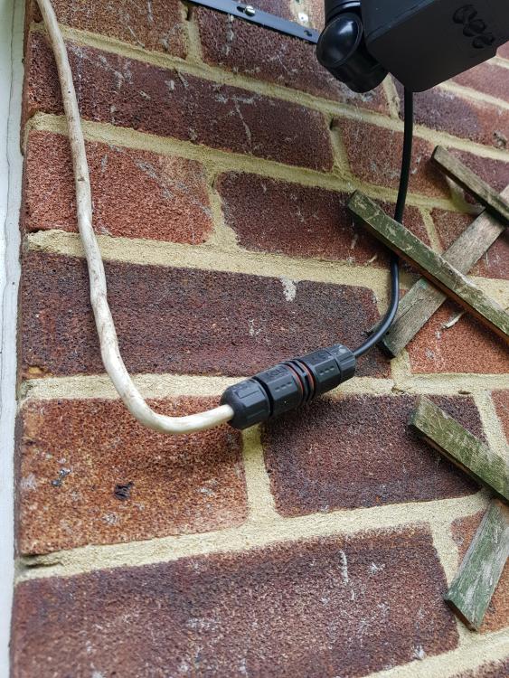

oldkettle Posted June 16, 2019 Author Share Posted June 16, 2019 1 hour ago, PeterW said: I’ve started speccing these on any joints where there could be moisture Wiska Joint This one is cheaper than the one I used. It seems to require separate connectors? The description says Use with 2 x 2-way (WA412) or 1 x 5-way (WA415 ) Does it have enough space for 3 WA412? Link to comment Share on other sites More sharing options...
PeterW Posted June 16, 2019 Share Posted June 16, 2019 It’s designed to hold pairs of other types of connector. Really useful for outdoor stuff and also with things such as connections for towel rail elements that whilst they are behind a panel, they are in a potentially humid environment. Link to comment Share on other sites More sharing options...
Ed Davies Posted June 16, 2019 Share Posted June 16, 2019 But the common case is to want to make three connections (line, neutral and earth). Link to comment Share on other sites More sharing options...
oldkettle Posted June 16, 2019 Author Share Posted June 16, 2019 (edited) 1 hour ago, PeterW said: It’s designed to hold pairs of other types of connector. This is what confuses me. What about the earth? 2 x 2-way (WA412) means one for live and the other for neutral. Edit: just noticed @Ed Davies said the same thing. Edited June 16, 2019 by oldkettle Link to comment Share on other sites More sharing options...
