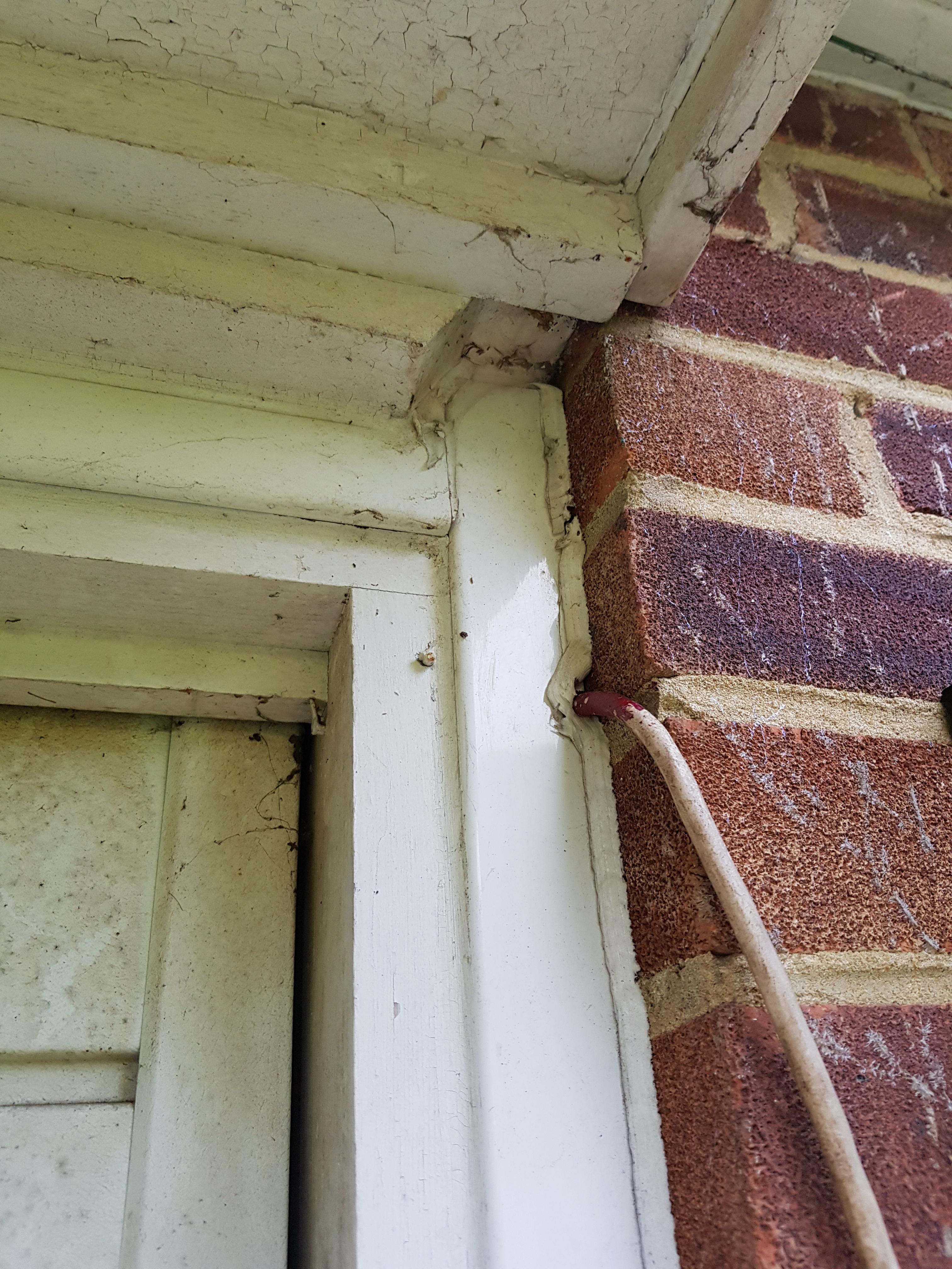

Is this legal?
1 minute ago, oldkettle said:
The cable in question is the light grey one that goes down from the switch. This picture is only to show where the connection originates. As @ProDave confirmed, no RCD. I should have looked it up earlier of course, don't think I saw a single one anywhere in the house.
So at some point, grey becomes blue ..!! Wonder what that junction looks like ..?!

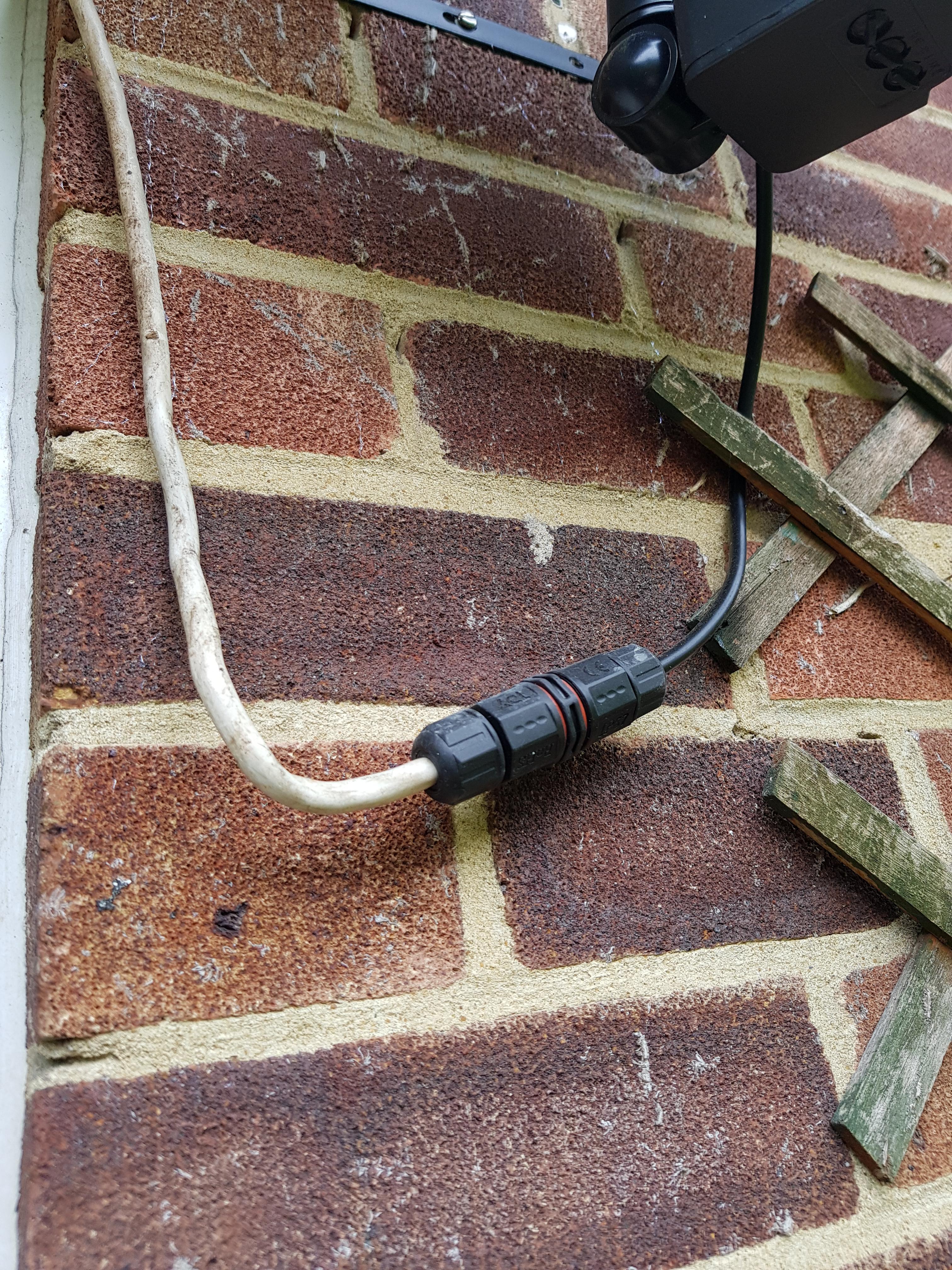

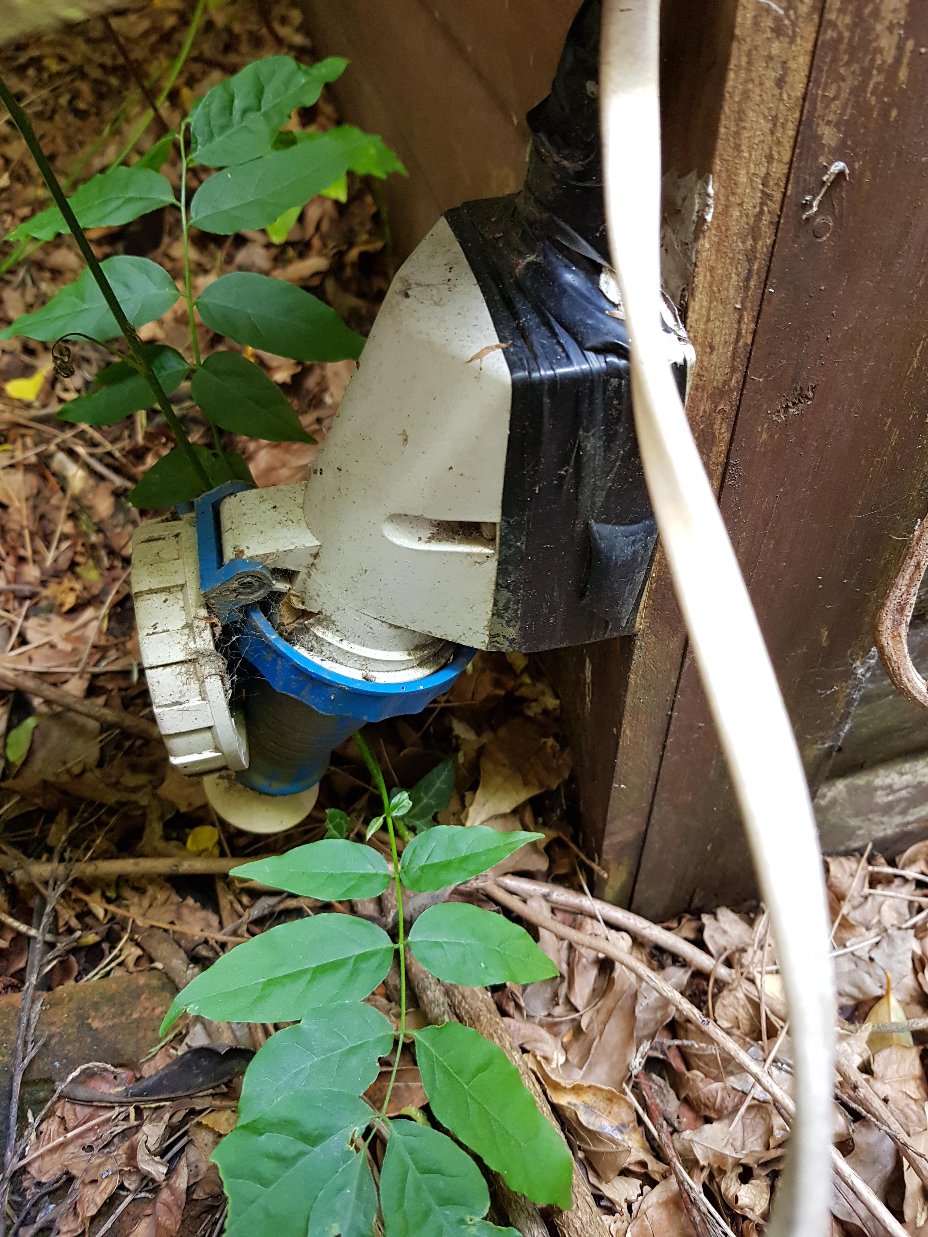

Not even sure where this happens, must be somewhere behind the summer house (and it is not easy to get in there)
But yes, it is grey to the summer house and then blue to the greenhouse. Since this connection is not inside the summer house I doubt it would have an RCD ?
And the last one - grey to blue connection.
@ProDave, yes, this is quite clear. I hope to deal with it when we build our extension as most of the electrics will have to change. I am the only one trimming hedges and mowing the lawn, hopefully it will survive another year.
On 12/06/2019 at 09:36, Carrerahill said:
It does not satisfy BS7671 (the wiring regs) but it is not illegal - the police will not be making arrests, there are very very few things that do not comply with regs that would be considered illegal.
You have many options here - this is just a summer house feed - I assume not part of building works or anything, in which case you just want to make it safe.
Undo it, route it through conduit, clip conduit to fence, re-connect.
Replace with SWA
Dig a trench and bury SWA.
Ahh ..!! All is ok as it’s a commando socket wrapped in black tape ..... why do people think this sort of stuff is ok ..??!
That's actually a proper IP6X one. Undoubtedly let down by a bad gland install.
Top entry is the work of the Devil.
Bottom or rear entry every time if you can. Appreciate difficult against a fence post.
Apart from the fact that there are some people that will just bodge anything together, I believe that another reason is that it's just so damned hard for a lot of people to find out how to DIY something safely.  There's loads of information around on stuff like plumbing, but there's a really strange attitude amongst some when it comes to electrical installation work.  Sure the best answer is always to get a competent and suitably qualified electrician to do the work, but if someone can't afford that, then the next best thing is to make sure that all the information needed to be able to do a safe DIY job is readily available.
Yes, this means that often an installation won't be 100% tested as it should be, as the test gear needed is beyond the means of many DIY'ers on a budget, but it's really not hard to just do a fairly straightforward job, like running power to a shed, safely, if the information on how to do it is made readily available.  I know this probably pisses off some in the trade, but my view has always been that if someone can't afford an electrician then they are probably just going to DIY the job anyway.  Better that someone intent on DIY has access to information to do a reasonable job, than have the situation we have now where some people do crap work out of ignorance.
It also seems that it's not just DIY'ers that are doing some really dodgy electrical installation work.  YouTube is littered with videos by competent electricians highlighting really dodgy stuff that has been done by incompetent members of one or other of the Part P cartels.  What really gets my goat is that after getting a degree I had to sit CEI Part 2 in order to join the IEE (as it was back in 1975).  Now someone that's done a 5 week Part P course can be a "competent" person and IET member, yet they may well not know their arse from their elbow.   How any short course can produce someone of equal competence to someone that's served their time I just don't know.
That's the difference between a professional and an incompetent person. Haven't even noticed it was top entry. In my defence, it wasn't easy to take this picture. Not a fence but a back of the summer house surrounded by a thick hedge. ?
Is this one any better? That's actually mine, a replacement light. Don't hold back.
Other option would have been an IP6X junction box. Fed from loft is it? A neat option is feed through the back of a wall mount jb then bottom entry to the light fitting. Silicon the back of the jb where it meets the wall.
I like the IP6X Amphenol / Bucaneer style connectors like those, good for 16A some of those. What I do is go belt and braces & pack the inside of the connector with silicone grease at work. They last indefinitely.
How does the white cable come out of "wherever"? Watch for chaffing. I'd have used black too. I'd have added some nylon P clips and used stainless screws tidy things up / stop things flapping in the wind.
Thank you. P clips will certainly make it look better and stop any movement.
Do you you fill the whole of the inside with grease? This stuff is not that cheap, £15+/500ml. On the other hand, the connector itself is more expensive anyway.
This was an existing cable out of the garage front that was previously connected straight to another light. The new LED came with the short length so had to couple the two. The exit is actually under a small canopy _not sure what part of it can be seen in the picture.
Ultimately, this will also be replaced at some point after the extension - money permitting of course.
