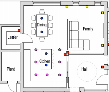

Weebles Posted June 9, 2019 Posted June 9, 2019 FWIW this is our electrician's initial plan for our kitchen / family area. We actually have gone for 3 lights above the dining table and it is rotated 90 degrees. And we have ended up with 12 ceiling spots - 3 rows of 4 - above the island. No pendants over the island (my choice). We also will have some under wall cabinet lighting. And just wall lights in the family area. The LED spots are dimmable. Seems OK so far but the room is still unfinished so don't know for sure yet.

CC45 Posted June 10, 2019 Author Posted June 10, 2019 I've positioned ours ~ 500mm from walls (no wall cupboards) - that puts the lights 'in front' of any user. The enlite E5 are fire rated so no messing about with any fire hoods plus they have a 60deg beam so it spreads light. I seem to remember that they are ~ 400 lumens. @Weebles - is the area between the table & family area a bit dark?
Weebles Posted June 10, 2019 Posted June 10, 2019 5 hours ago, CC45 said: is the area between the table & family area a bit dark? I don't know yet as we aren't living in it but the electrician has actually extended the run of 4 spotlights into the zone between the island and the table so there should be a bit of residual light from those. And the pendants over the table run left to right now. I imagine we will be OK with just the wall lights in the family area, for chatting, reading and watching TV. Quite a bit of natural light flooding through in the day. Anyway, we will see, and a standing lamp of some sort might be needed which would be fine.
