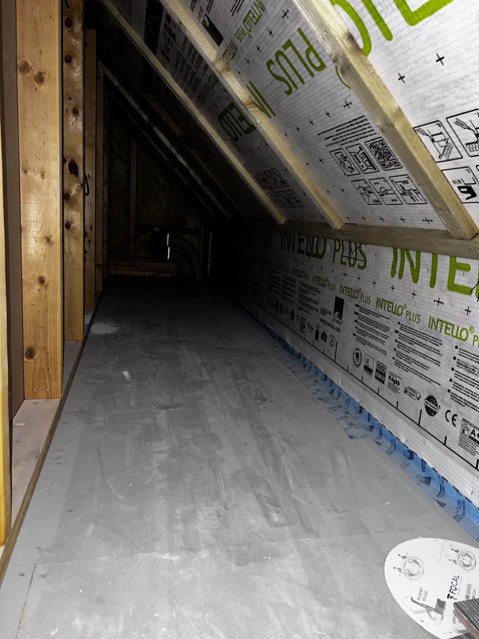

Very true. Here’s some pictures of what we did to make what would have been smallish rooms feel much bigger. The bedroom is 5.2m x 4.4m with a 2.5m ceiling height. The sitting room is a similar kind of size in an L shape but is 2.9m to the ridge beam. The coomb picture shows how much is lost given Heb Homes do this in both sides albeit I built ours 100mm further into the room to give is more flat wall space behind the bed.
We vaulted one half of the area upstairs and raised the ceiling height in our bedroom. It’s coombed too we left it all open on one side so the angled ceiling meets the outside wall rather than creating wasted pointless cupboard space we’d never use. Heb Homes standard upstairs layout wastes a lot of space and creates long narrow bedrooms which is a common problem with room in roof designs.
What we did in the upstairs sitting room. Transformed what would have been a small awkwardly shaped room.
