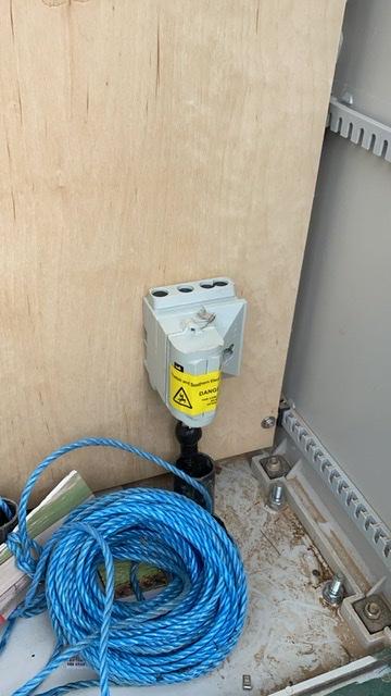

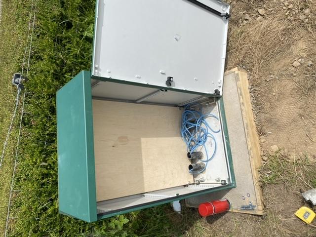

I spoke with SMS again and they’ve confirmed they’ll install the meter with just the cable and fuse in place. However, I’ve arranged for an electrician to do all the other work anyway.
Thanks guys. Task for tomorrow!
That’s what I originally thought but when I spoke with SMS several weeks ago they said what I have is fine. I even sent them a picture. I’ll get an electrician round to do their side of it regardless of what SMS have been telling me.
Hi all I have installed a kiosk and SSEN have installed electricity supply and fuse. Octopus (via SMS) are coming on the 20/9 to install the meter. I’ll then arrange for an electrician to come out and install a mini CU, some site power sockets, earth road, and switched fuse ready for the SWA to the house. I plan to keep the meter here permanently. I’ve spoken with the SMS about what else they need done before they arrive and they’ve said what I have is fine but they were a little vague. However, I was chatting to another self-builder today and he said they won’t install the meter unless I have an earth rod so I’m a bit confused. I could just get ah electrician to do all of the above ahead of the meter install anyway. Any advice?
