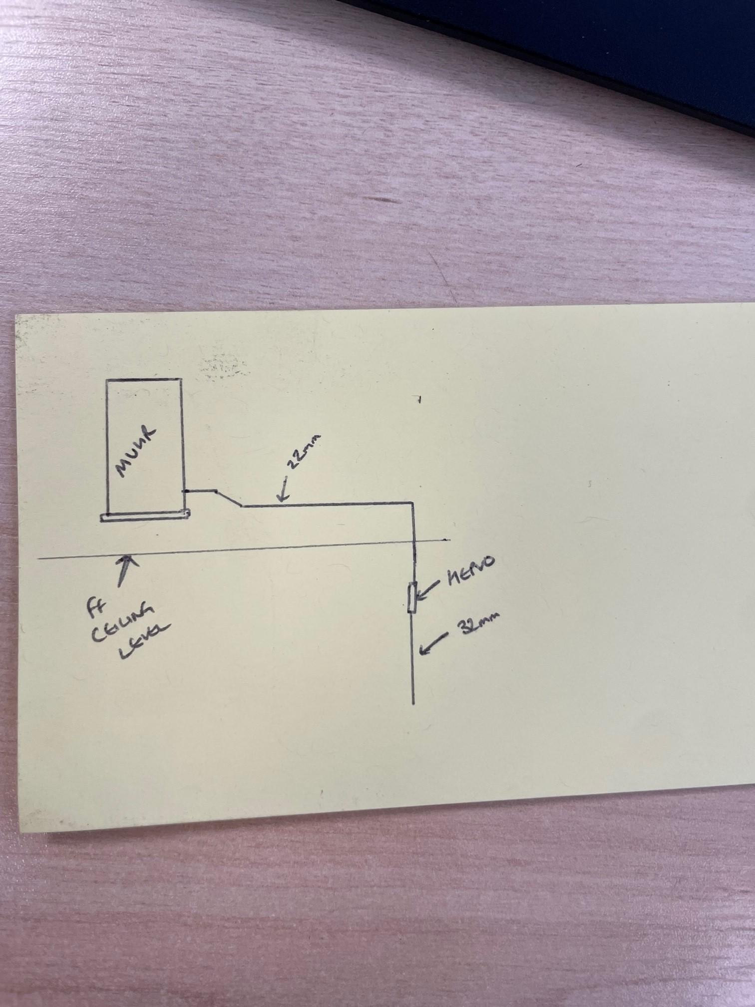

Thank you! Daft question - how do I know what drain discharge I am configured for? My MVHR unit is sat on a board (with anti-vibration feet) so was planning on using the drain hole at the back as pictured. Can this have any horizontal pipe work? I was going to come out the back of the unit, set it down about 6inch and run this 'horizontal' for around 1.5m until an elbow straight down and then ill step it up to 32mm then HepVO and then into soil pipe. Please see attached dodgy drawing What did you use to step the pipe work up? Many Thanks -

Hello all I have slightly above zero knowledge on even basic plumbing however I need to pipe up my MVHR condensate drain so it can be boxed in etc. I have a Vent Axia Sentinel and on the instructions it says it accepts a 22mm pipe (see attached) I know I need to install a HepVO trap and the smallest size they do is for 32mm pipe, is it just the case of installing 22mm pipe onto the unit then increasing the pipe size to 32mm for the trap and then carry the pipe on in 32mm into my soil stack? Or would you just use a reducer and expander of 22 to 32 just to install the HepVO trap? Is it best to use solvent weld or is push fit ok? Any advice or best ways to do this would be really helpful as I am not sure which way to go Many Thanks
