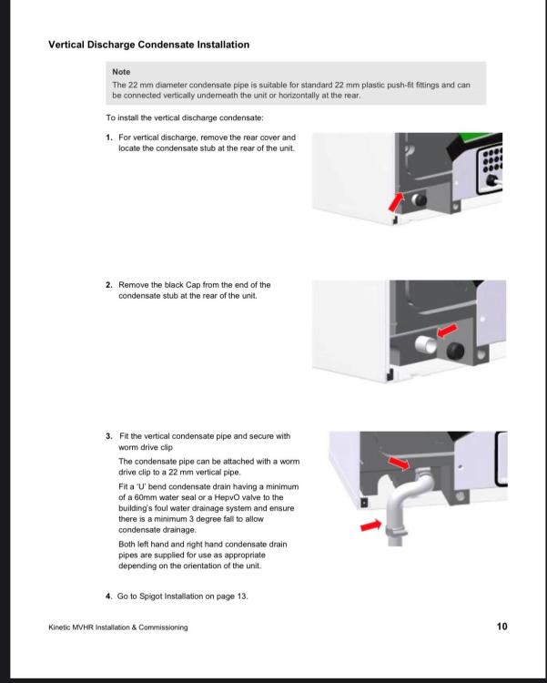

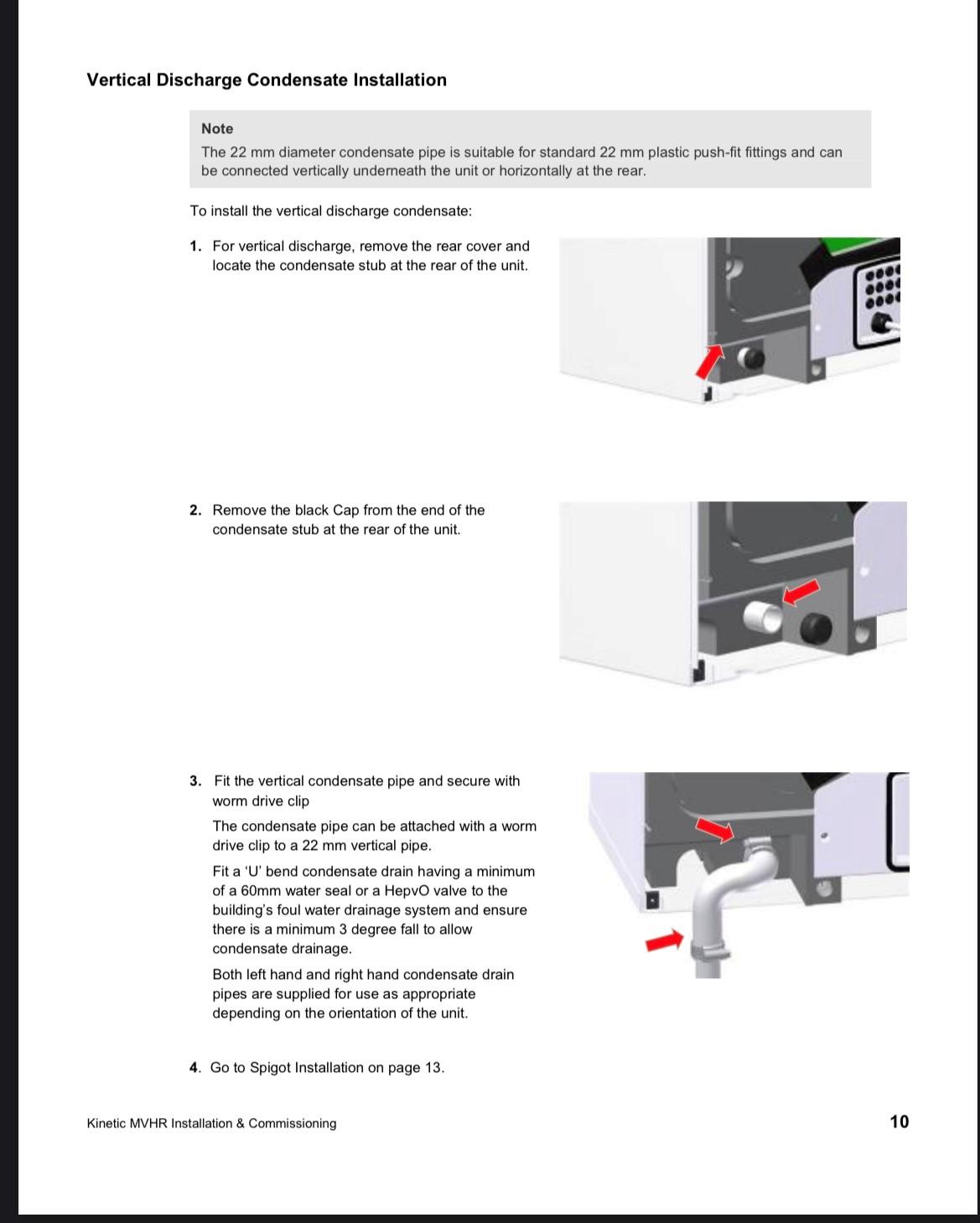

  4. Hello all I have slightly above zero knowledge on even basic plumbing however I need to pipe up my MVHR condensate drain so it can be boxed in etc. I have a Vent Axia Sentinel and on the instructions it says it accepts a 22mm pipe (see attached) I know I need to install a HepVO trap and the smallest size they do is for 32mm pipe, is it just the case of installing 22mm pipe onto the unit then increasing the pipe size to 32mm for the trap and then carry the pipe on in 32mm into my soil stack? Or would you just use a reducer and expander of 22 to 32 just to install the HepVO trap? Is it best to use solvent weld or is push fit ok? Any advice or best ways to do this would be really helpful as I am not sure which way to go Many Thanks
