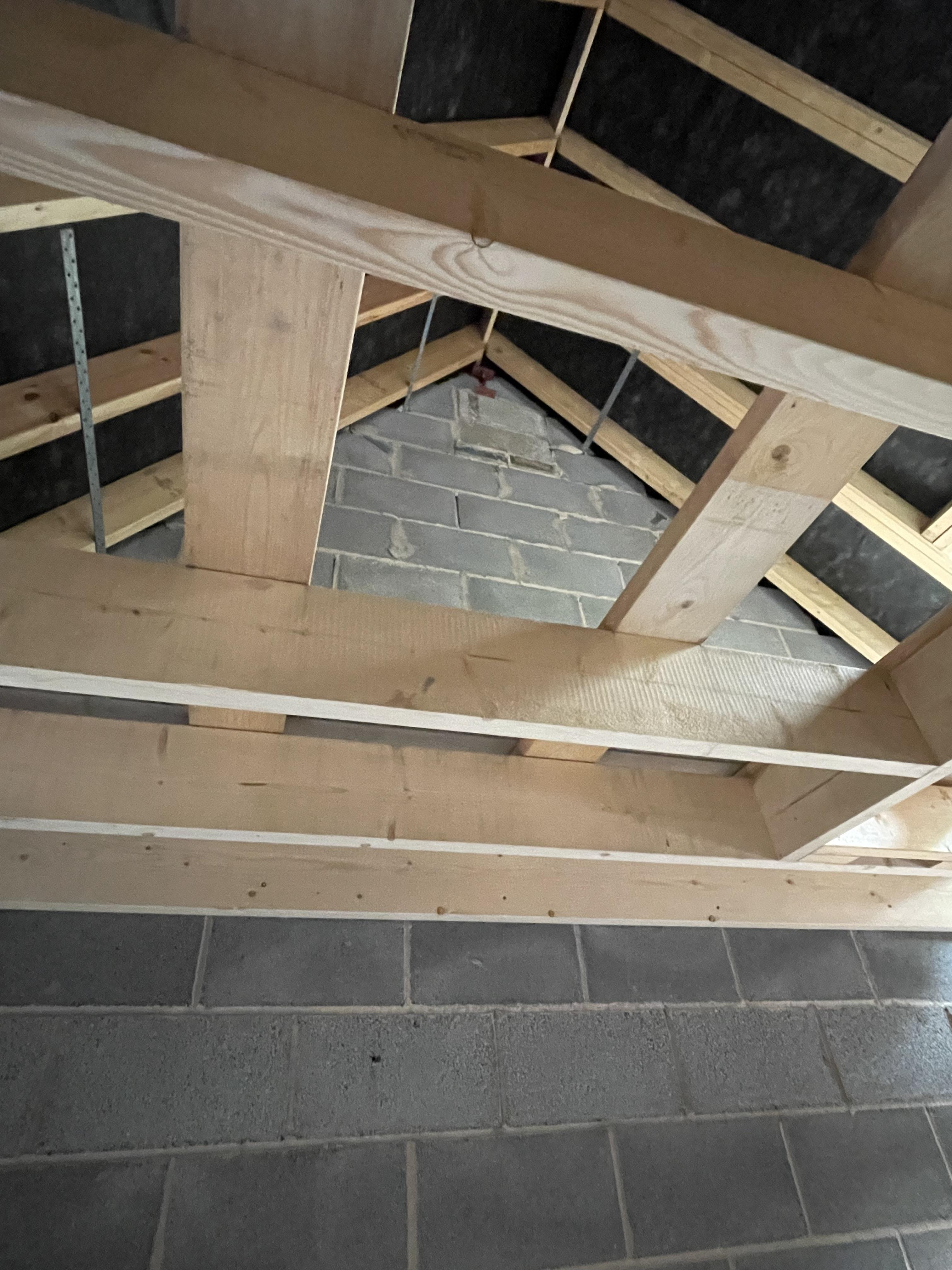

Hi all I have made a start on my vaulted ceilings. I now have 100mm PIR in between the rafters and 100mm PIR underneath. I have taped all my PIR joints with foil tape, I have foamed the edges of the boards and plan to air tight it to wall plate and block wall. Will this be sufficient for air tightness or is it best to put a vcl over my battens and them tape that the wall instead? My plan was to just use a VCL strip down the middle bit

I tried to explain to him and shown him some examples, his concern was how does he know a 50mm air gap was maintained throughout? And he has never signed a vaulted ceiling off that didn't use PIR between the rafters I decided this wasn't a battle worth pursuing and it would only take me a day to correct so thought best to keep him on side as he will be looking after my project to the end now
I have just had a meeting with my BC officer (a new one for my job) and he is not happy with the slab insulation between the rafters no matter how I much i tried to put my case across. To keep everyone happy I am now installing 100mm between the rafters and 100mm underneath (I have already cut some 100mm so cheaper to do it this way) When I fit in them between the rafters do I have to foam and tape over the joints or just foam and tape over the 'top' (under the rafter) layer? Slightly annoyed about this as I spent all Sunday doing one room but he was not having it and not worth the argument this time Many Thanks
