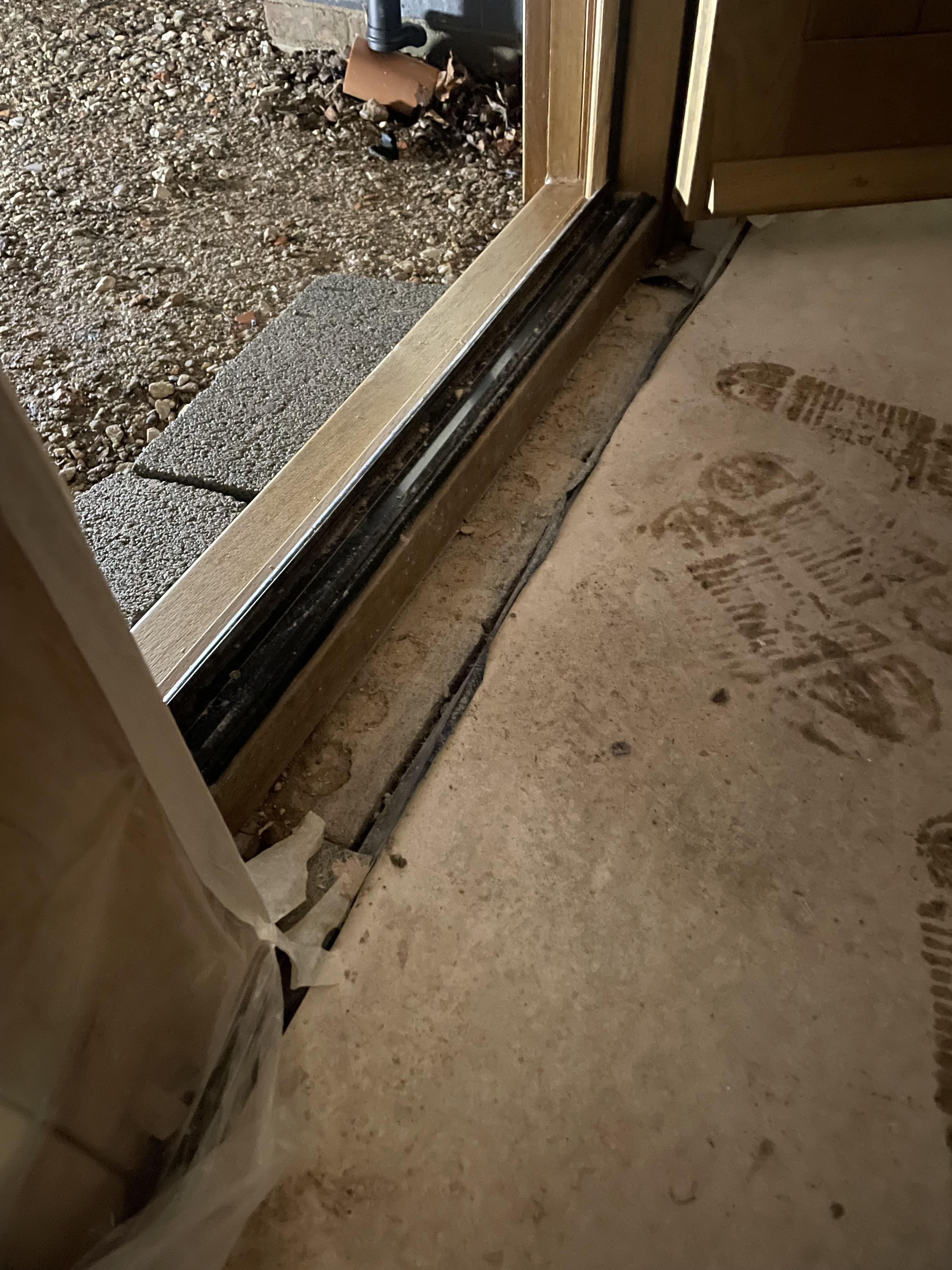

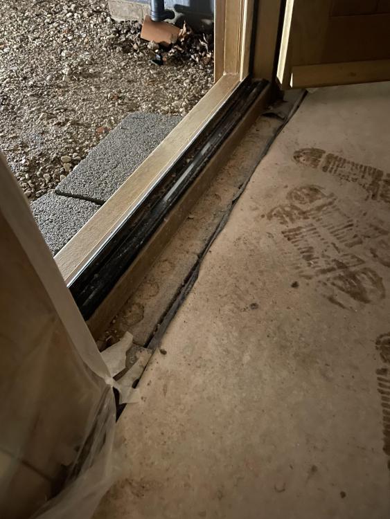

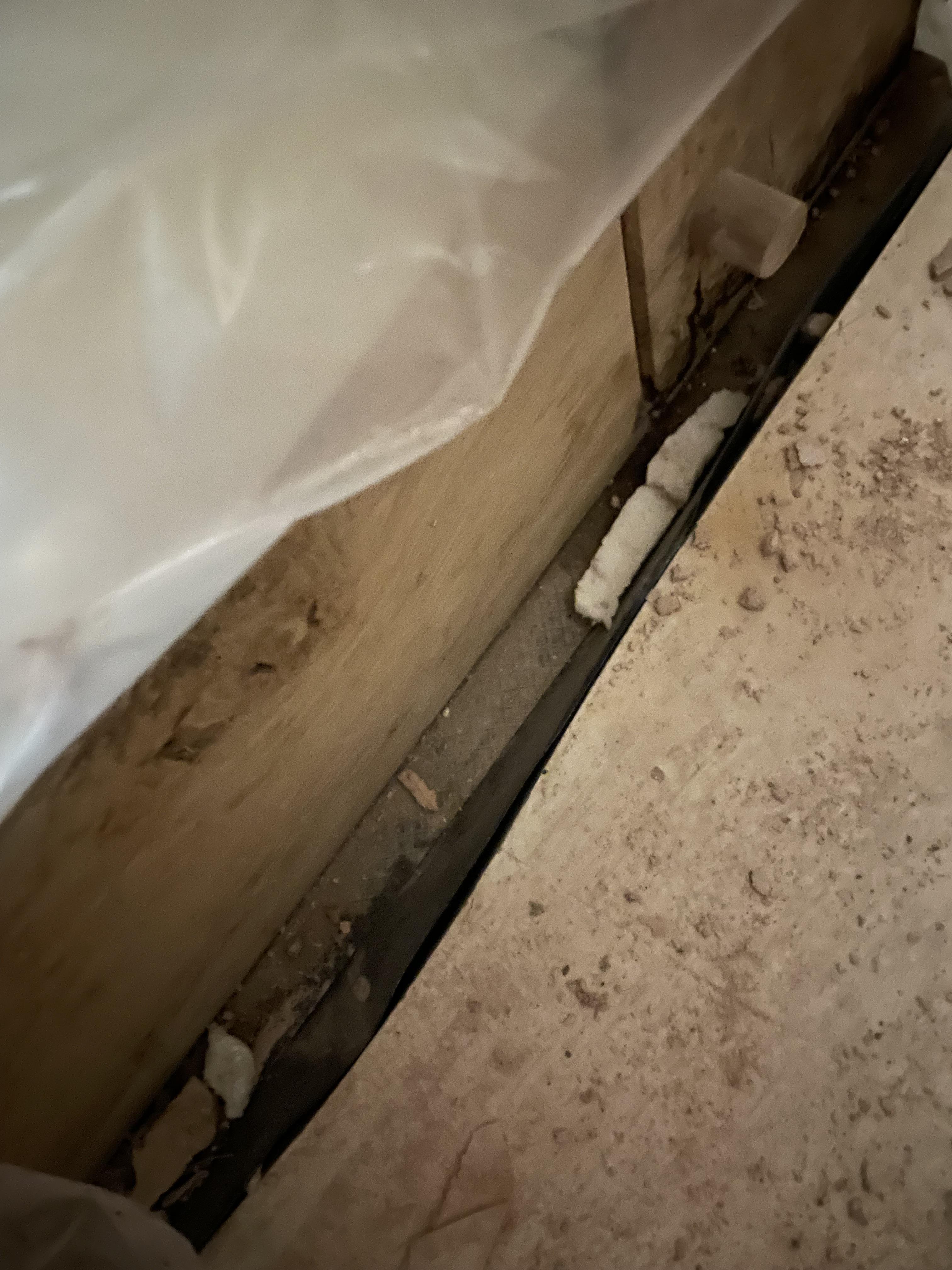

  1. Good Afternoon I am in the process of preparing my floor ready for tiling, the floor is anhydrite screed (50mm) and there is gap between the edge of my screen and oak frontage. It is around 25mm deep and varies in width (see photos) The oak frame sits on a piece of DPC and I was planning to try and get some air tight foam and then sealant along that edge. I was going to foam as maybe holes i could see, mainly around the bricks/edge of screed However I am guessing i need to lay some form of pvc sheet to stop the screed escaping and also to stop the screed getting into the oak, can any suggest any ideas on how to do this? And what screed to use if possible? I have attached a couple of pictures to try and show the area I need to fill Any suggestions very much welcomed!

  3. I also have another question relating to preparing the floor, as the company who did my screed floor protected the oak front and there is a large ish gap from the edge of the screed to the floor ( see pictures) what is the best way to fill this gap? It’s about an inch deep and think it will need like a lining to hold in the gap filler/levelling compound otherwise it will run away I think. apologies for the poor description in my problem but hopefully the pictures help!
