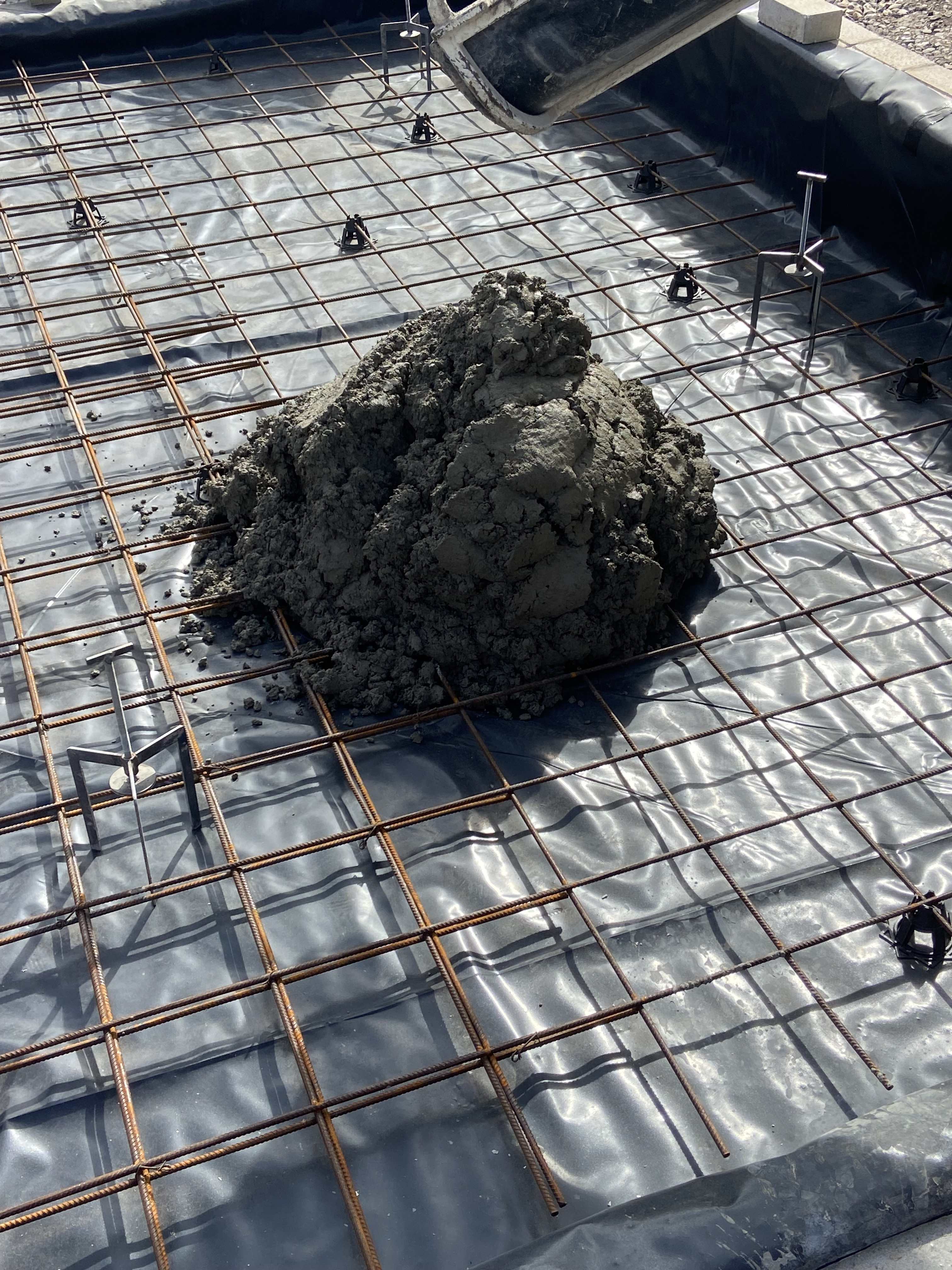

So after Cemex failed to add micro fibres to our last batch of self compacting concrete and their subsequent lack of interest in sending out a tech chap to look at the plastic shrinkage or help remediate their error, i decided to take my custom elsewhere.  Heidelberg and their ‘Easyflow SCC’ to be precise.
I stood momentarily in shock, ignorantly thinking.  “Maybe it’s magic stuff and it will suddenly turn into the porridge consistency it should be”.  Hence to say.  Said magic never happened 😂
The driver said he spoke to the batching plant and it was mixed with a stiff slump as it was for a ramp.  Made me chuckle though as there is a clue in the name ‘Easyflow’

So where does that leave you? What's the fix/work-round for the Cemex stuff, and what are you going to use instead of the lump of 'clod'?
If all orders are detailed, in writing, then wriggling out would arguably be difficult. OTOH total inactivity/failure to engage works for recalcitrant contractors all the time.
Also, it just occurs to me that any 'obvious' description, especially in a product name, probably has to be queried. You said '...there is a clue in the name 'Easyflow', but maybe there simply isn't! 'Oh, we call it that, Sir, but it's stiff - and does not flow easily - when we think it should be.'. I am not sure I'd have queried that either, but it's a Life Lesson...
Keep us posted on the next steps and, I sincerely hope, the success thereof.

Unfortunately, we only have Cemex and Heidelberg near us.  Reading is slightly too far and was warned by another concrete supplier in Woking that when it comes to SCC you want to source it from a plant near to the site.  I subsequently discovered yesterday after Heidelberg requested the ticket from the batching plant, that the operative had entered a slump of 75 and not 750.
Having know understood the error, I stupidly got them to send another batch today as I have to get these slabs done.   After they had put in over 1m3 it became apparent that they had messed up again as the concrete just wasn't flowing like SCC should.  I raked like a man possessed and thought I was going to have a heart attack.  I had no choice though as I was on my own and thought "wtf do you do with so more concrete already in.  I can't stop and leave it, so water had to be added.  The driver didn't speak hardly any English and couldn't understand what I was asking him.   I've requested full details from them as I am completely conscious that water should not be added.
I know individuals on here will be thinking.  "stupid xxxx, why didn't he carry out a slump test on site ...". But how many people actually do that for a residential house build.  I worked in construction for a few years and even spent time doing factory floors and not once did I see a slump cone.  It's not rocket science and I'm just pxxxxed off dealing with such incompetent fools.

Why are you not doing a sump test when the truck arrives
one bucket full out the truck, slump test, if it fails it goes back.
every video I’ve seen on scc the test it as soon as it turns up.

Because I am an naive idiot who assumed that if you order something, then you get what you ordered.  The whole thing has been one sorry episode and I wish I has not used SCC and instead used a mix on site company who could have simply created an RC30 mix with a high slump that could have been pumped and levelled easily short handed.
I subsequently discovered what went wrong with the Heidelberg SCC mix. The batch plant held back water and didn't bother to tell anybody.  The driver spoke very basic English and he didn't know, so a simple lack of communication caused a whole heap of unnecessary pain.
That is for very special circumstances... a bridge, a block of flats. I've not done or seen one for decades.... commercial or home.
(on big jobs we had a lab that did slump tests and took cubes for testing, and so did the supplier.
The problem will have been  the fibres. Adding them to an  'easy flowing' mix will seriously stiffen the whole thing. A vibrating poker would have made it run  but obv that wasn't to hand.
I've gone off fibres recently because they seem to stick together in  great clumps more than they used to, and the handling issue.
But it also looks very dry indeed.  How did it even reach there?
You have nicely laid mesh so cracking shouldn't be a problem... if they get the mix right.
In fact your photo is an example of doing things right, apart from the pile of mess in the middle.
Cemex you say! Worth noting.

Every batch we had from both Cemex and Heidelberg differed significantly.  We had 3 loads of Cemex Evolution Flooring from Cemex.  The first 2 loads in the same day were identical.  The third load of exactly the same mix, but with fibres today, seemed way too fluid and there was excessive bleed water (completely wrong for scc) all placed by chute and no water added on site.
Heidelberg Easyflow offering was far too stiff, but this has subsequently been confirmed that they didn't add enough water.
