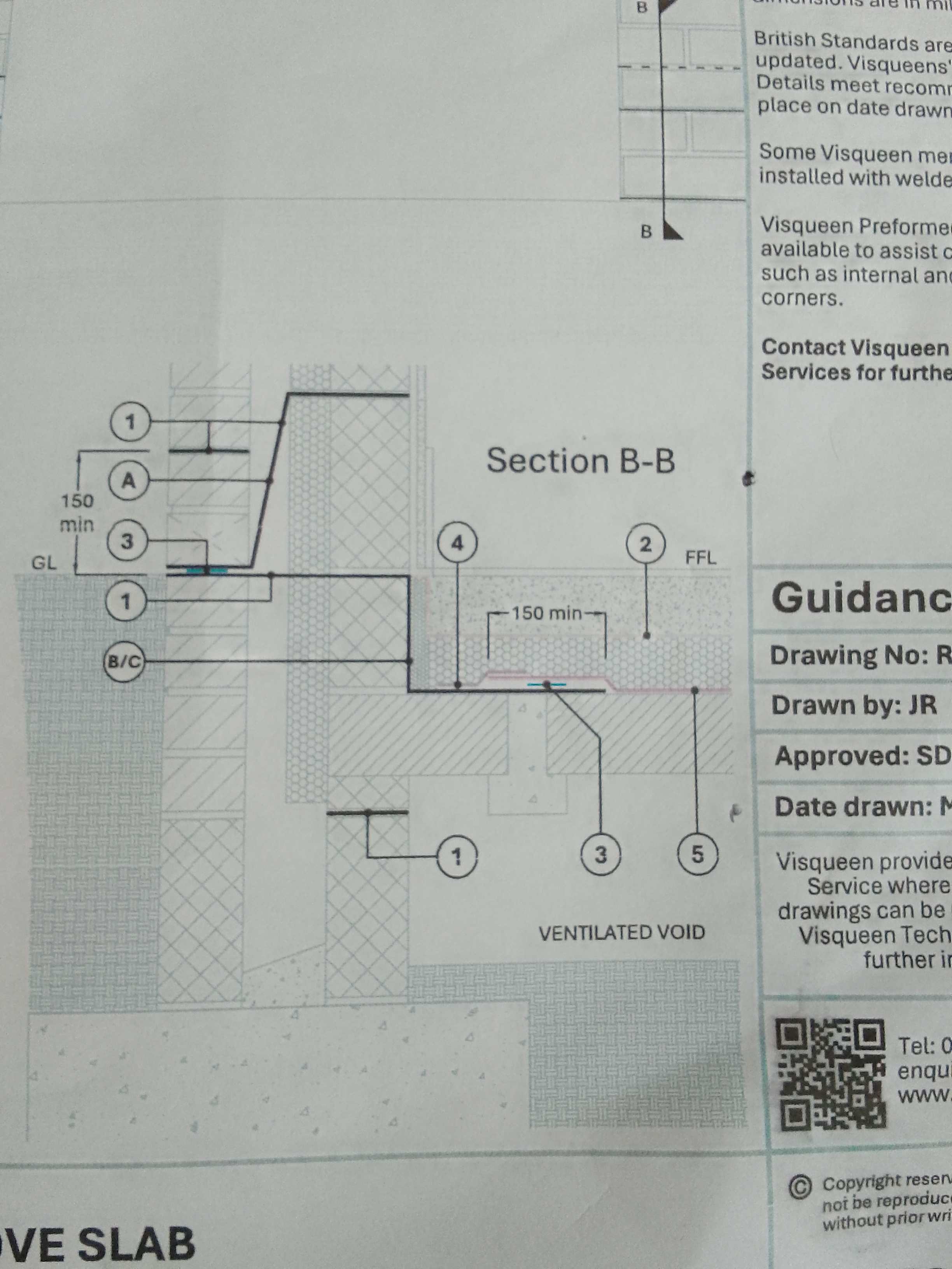

This is very interesting and although a year later, I am keen what approach you went with. I too have been banging my head against a brick wall on this topic. We are having a ground bearing slab and level thresholds. My plan is to simply follow the detailing for the block and beam Radon barrier protection. If you swap out the block and beam for a ground bearing slab then why would it not work. From what I can see, water / damp cannot migrate through the ground into the dwelling and the cavity tray captures any moisture from the cavity and will surely help mitigate and water that did try to breach the cavity. Can anyone see any reason why that detailing could not be used for membrane above a ground bearing slab? I want to go membrane above slab, for the simple reason that service penetrations are quite high and to get a decent damp / Radon seal below the 150mm slab will be a complete dog's dinner.

We only require 'Basic' Radon protection as we are in a 3-5% area. The one issue I've got is that the membrane sits at the same level as the coupling on the rest bend. No idea how I'm going to solve that problem. But the top hats I purchased won't work. I think Juta do a liquid rubber that you create a dam and pour. The top hats are great for soil pipes in the middle of a room, but not so when your soil pipe is in the corner of a room. -

Yes. Slab build up is as you have stated. Taking down the internal 3 courses won't take long and it will help considerably with gas membrane installation and concreting. -

As some of you predicted, our self build has turned into a disaster. We’ve now parted ways with bricklayer number two. Choosing a ground bearing slab was a dumb idea and beam and block would have enabled everything to run more smoothly. i think the bricklayer could have made things simpler by not building up the internal walls the past the block course. This has now made the Radon membrane detailing more tricky and expensive, due to the number of internal door ways. I also feel it’s going to be difficult to lay the slab as the open door ways will mean you have different levels for tamping off. I am contemplating taking the internal walls down to the top block course. What do people think? I don’t want any hate. So if you’ve got nothing constructive to say, please don’t comment. I’ve been contemplating deleting my BH account.

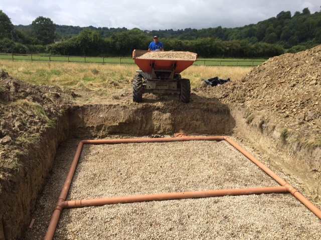

Rest bends haunched. Pea shingle layers done as described. Picking out obvious foreign objects impossible.

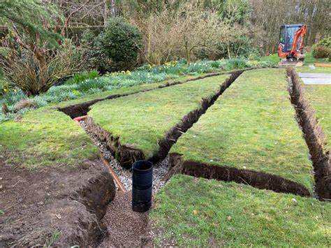

The excavated soil from the foul drainage trench is very flinty and I wanted to ask whether I could backfill the trench using said soil if I cover the foul drainage with 100mm of pea shingle or should I get someone in to screen it first. Trying to avoid unnecessary expenditure, but also possible problems in the future.
