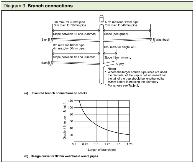

Externally you've got no problems. Distance between IC's is between 40 - 90m allowable. I would just make sure all the points are rod-able, especially at the base of the stack. I though the length of branches was limited to 3m for a 40mm pipe although this might only be without an additional AAV (see attached). Although I've just installed an internal shower waste which is around 5 ish meters to the hopper and no problems yet.

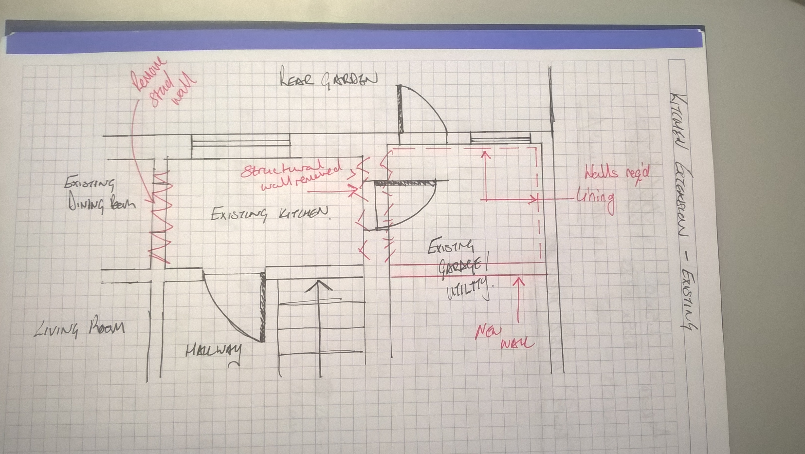

I thought that a sketch would help. It's a bit crude but you get the idea of what I am intending. Happy with the understanding of what I need in terms of fire and structural input. Good point about the air bricks I won't be able to confirm this until I get the existing finishes off the walls.
Never given it a serious thought. I am assuming that as this will be an extension of an existing kitchen that it wouldn't require anything additional other than perhaps relocating and enlarging the existing extractor above the hob. Am I looking at this too much like a diy problem?
Floor will be timber battens and boarding on existing concrete floor to suit level difference. Insulation between battens. Both the floor and the wall depth are restricted to the interface of the original property. Ceiling will be insulated between existing flat roof joists. Building Control will probably be involved at some point. I should point out that I do work in Construction (although behind a desk) and I am aware of what I need in terms of regs. Just wanting to bounce some ideas off people.
Hello Everyone, After lurking silently on the other site for a number of years I have finally decided to start contributing albeit with a question. Anyway, moving into a new property next week and could use some decent advice regarding dry lining a garage. Current plan is to extend kitchen into a partial garage conversion. Currently I only have a single skin brickwork wall (i.e. 102.5mm thick) and I am wanting to install something like an 89mm dp stud wall fitted up against the brickwork with full fill insulation, VCL and then just plasterboard finish. I wasn't planning on adding any additional heating to the room (or windows). With the conversion being a kitchen I am slightly worried about condensation risk amongst some other things and would appreciate it if someone would pull my ideas apart if you know what I mean. Thanks in advance D
