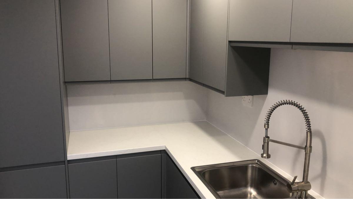

Tbh, I’m quite impressed with the Howdens units. I’ve only ever seen builder fitted Howdens kitchens that leave a lot to be desired. If I look closely, I can see some quality differences between it and our Alno kitchen but that’s to be expected. Most of the credit though must go to the fitter who's done the work to turn it into a quality install with standard quality equipment.

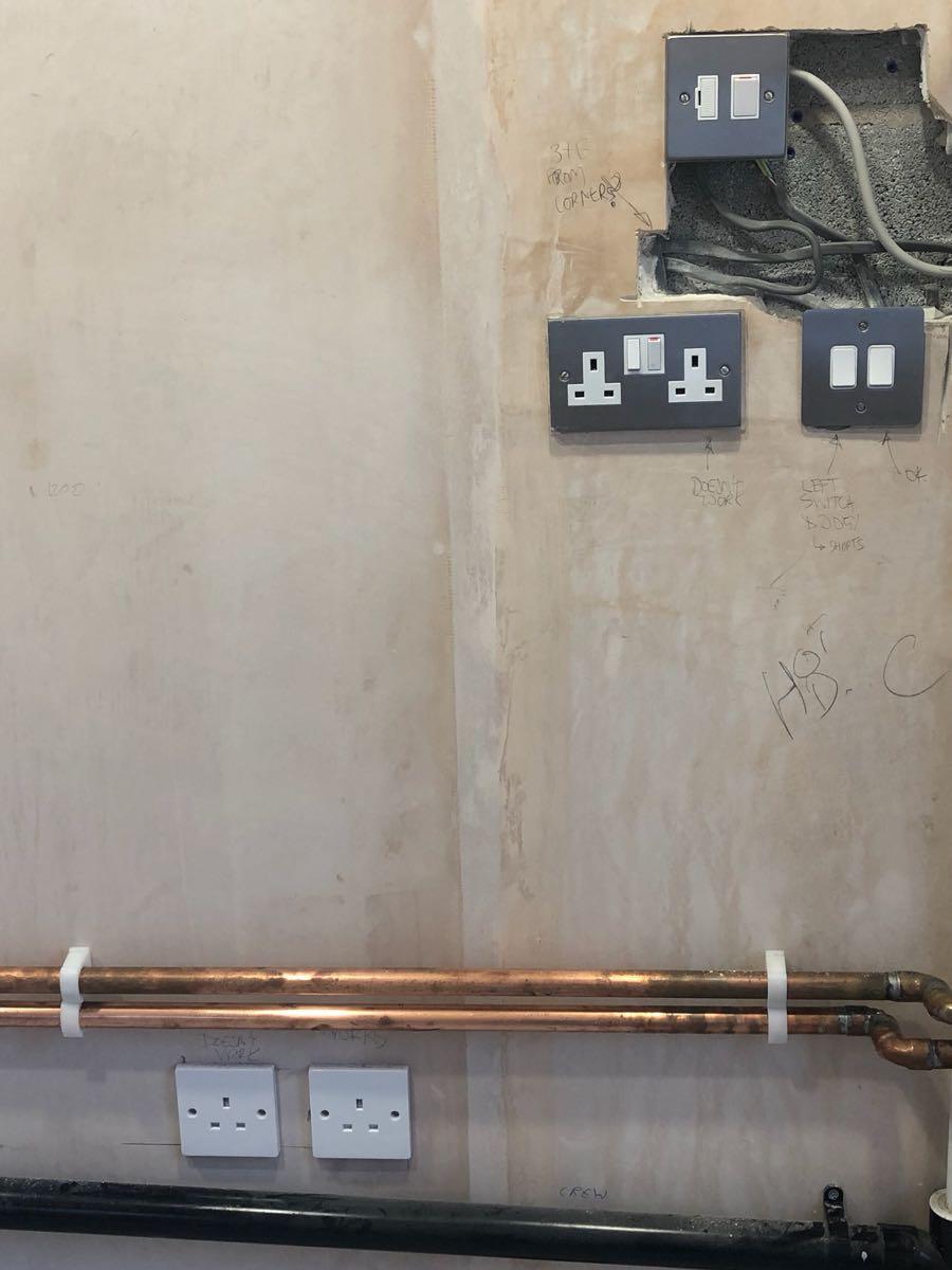

Obvs on the grid and plate. height is fine it’s the plumbing that messes up that space for the white sockets filling that plaster hole will be fun too ?

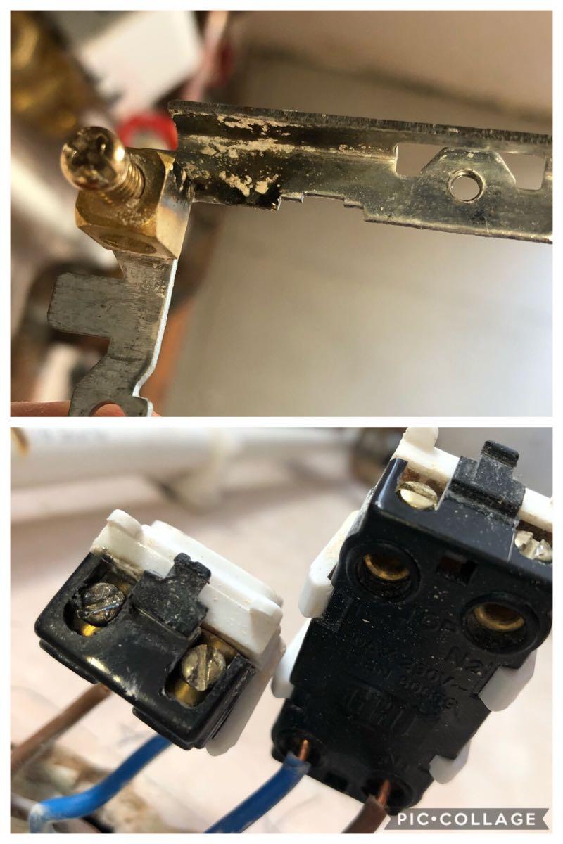

https://www.screwfix.com/p/mk-1-way-20a-dp-grid-switch-white/47279 1 way 20A DP is correct? These existing ones are CED (shit)
I swapped them round, the unmarked one just didn’t want to work. All that jazz in a 25mm back box as well, amateurs.
They don’t fit, they’re standalone, it’s not the end of the world ?♂️

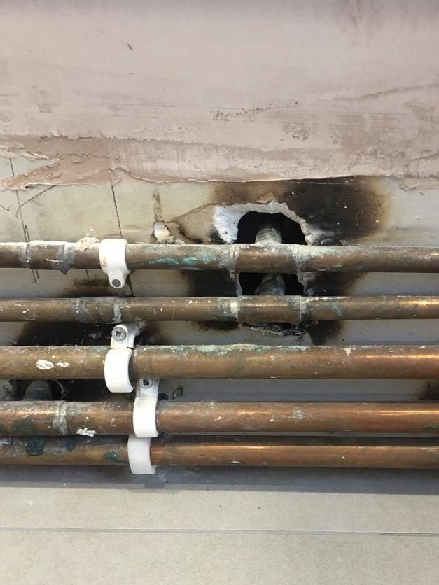

A problem solved. One of the switches is defective. The ones with the scorch marks is the one that is working ? going to replace both ?

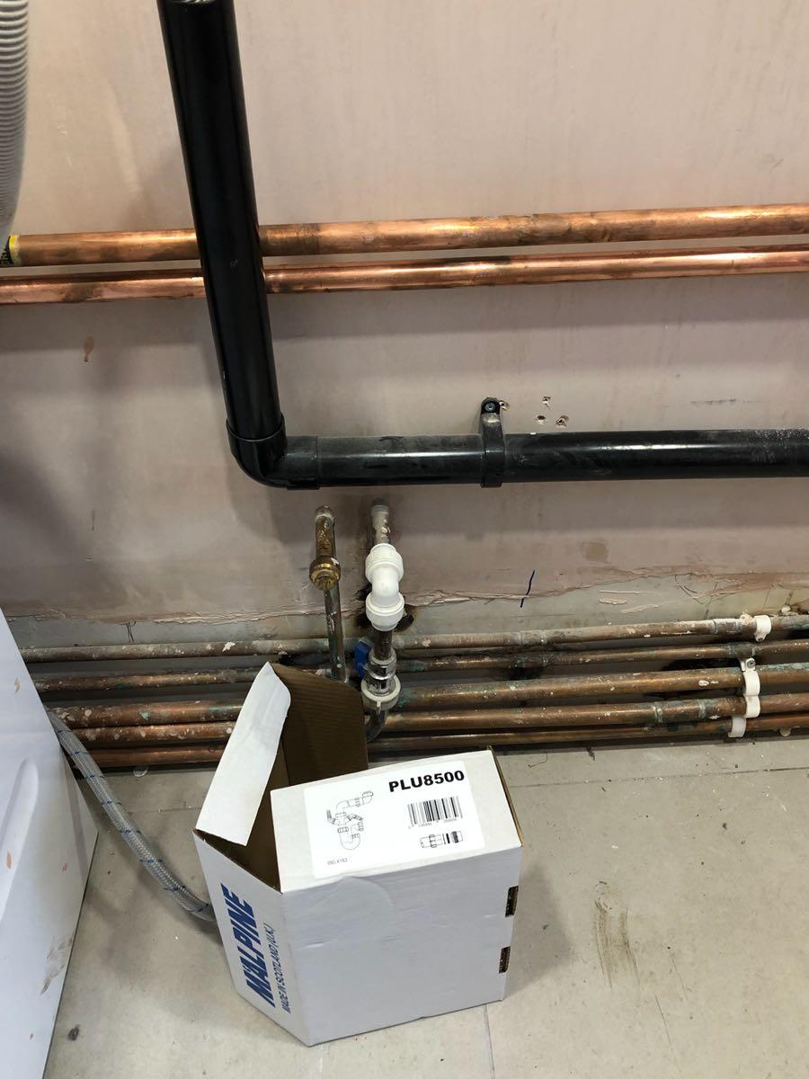

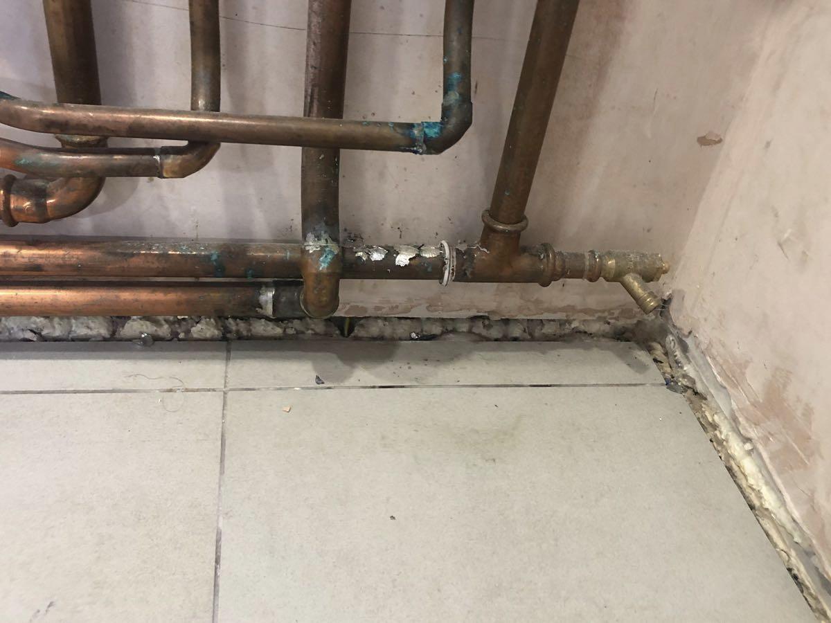

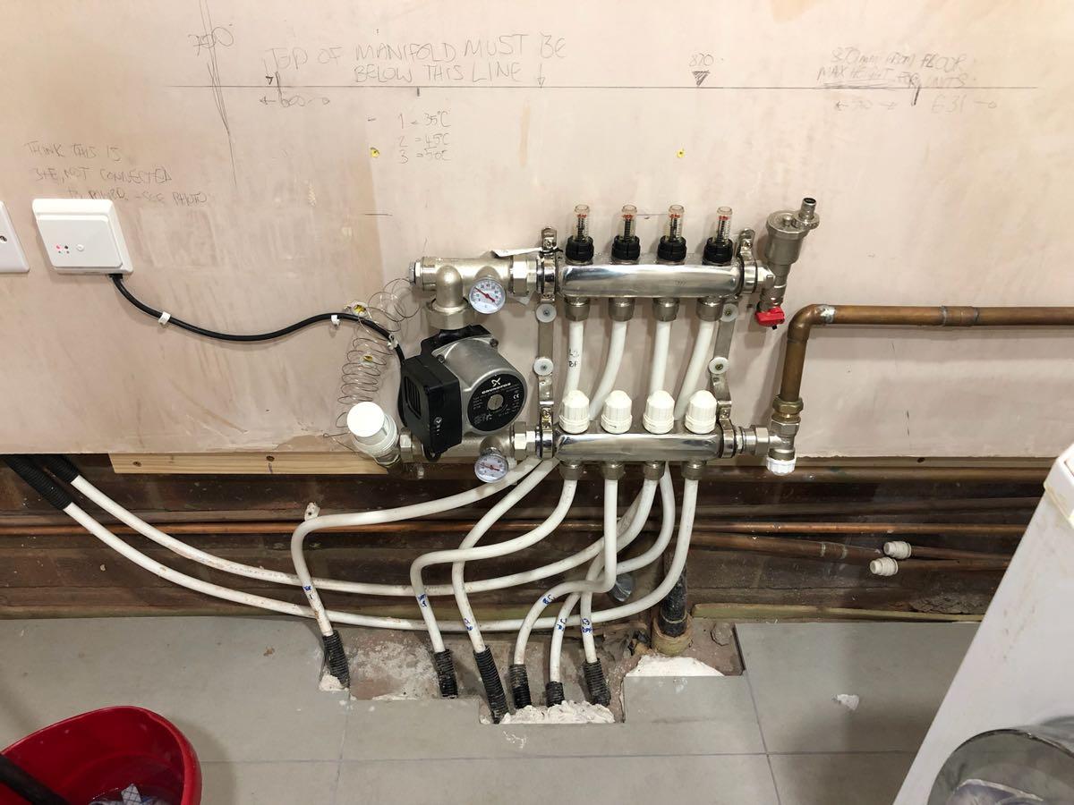

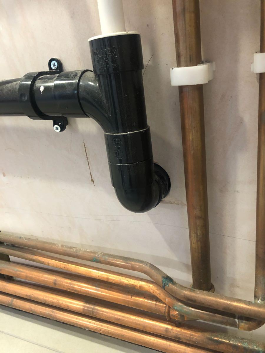

Got some gaps to fill: 1) around waste pipes going going through external wall 2) copper pipes going through a stud wall Foam? Acrylic? Silicon type? Next, there’s a 2 switch grid switch isolator thing supplying 2 sockets beneath counter level. One switch/socket doesn’t work. Can the 2 switch isolator be swapped for a high enough rated single isolator switch and then use the cable to the working wall socket and replace the single with a doubleskt? And just blank off the defective one? This is to run the washing machine and tumble dryer - (otherwise the appliances will run off a double extension in the working socket.) The ufh manifold sticks off the wall. A base unit is going in front of it. Most of the back of the unit will need to be removed. Is there anything I need to do in the unit after fitting to make sure it runs ok? Ventilation? Protection to prevent damage/interference? where the services run along the wall near the floor, I am intending to silicon some 20mm aluminium angle to the floor in lieu of a skirting board. Sound reasonable? (It will flood into the rest of the house anyway) The existing waste pipe will need modifying for a sink but I need to speak to the fitter first as to what he is willing to do Hopefully photos make sense.
I am not tackling this now and getting someone to do it. I do however have some pre-fitting snags to fix.
