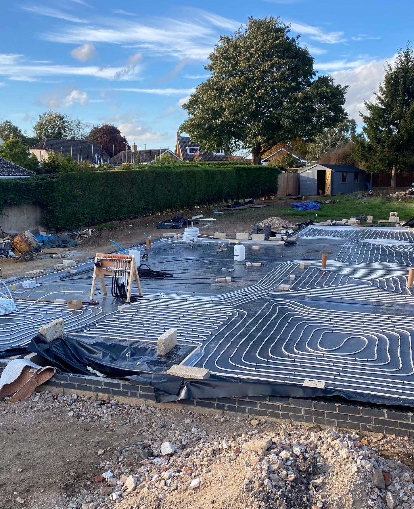

screed above is a waste of money Mines very similar to JohnMo except I have pipe spacing at 150mm. I used EcFlow fibre reinforced concrete. it heats up much quicker than I expected and I get away with low flow temps, highest flow temp I’ve had is 29 degrees.

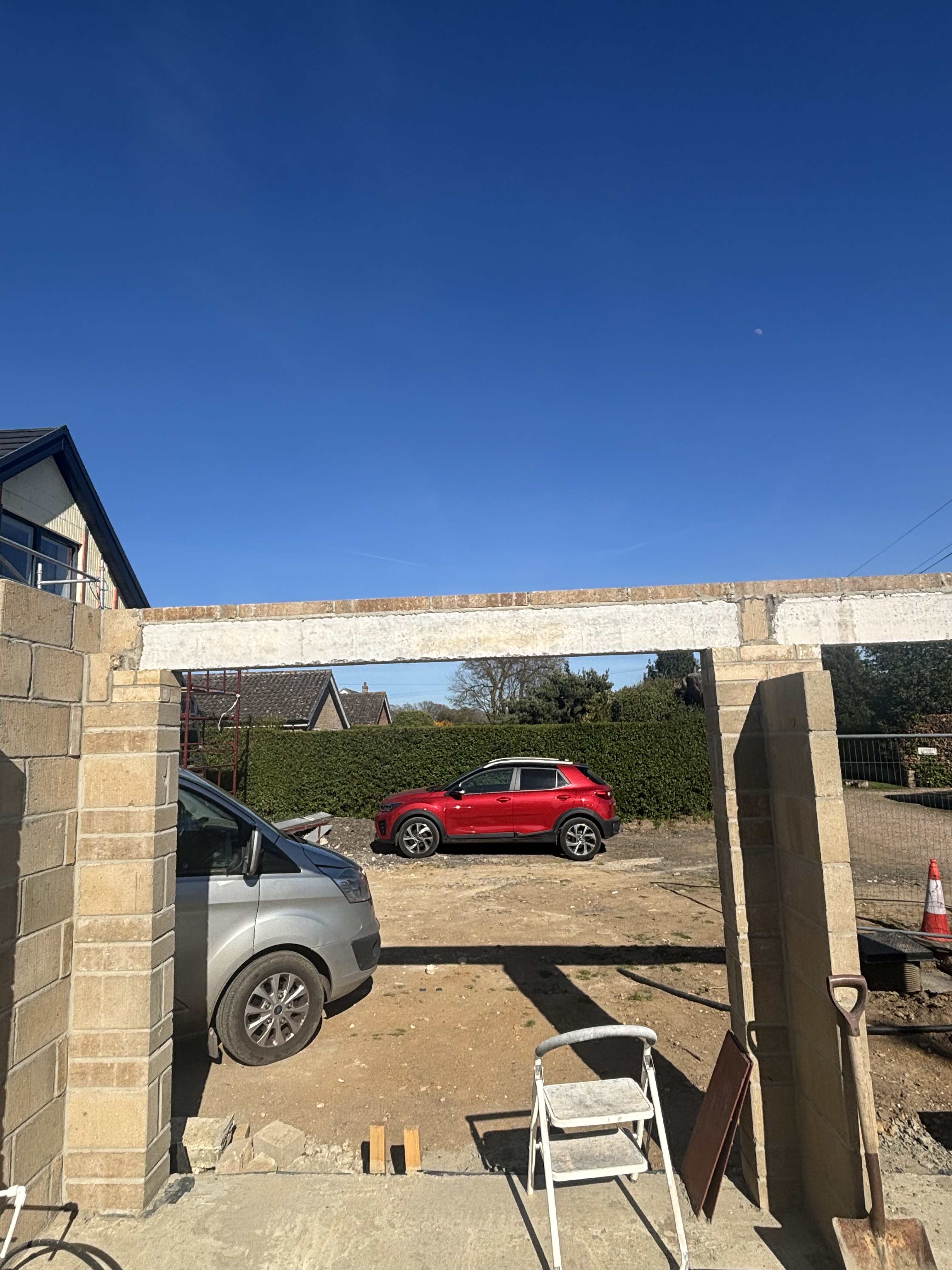

Yeah double garage with 2.4m doors can’t get the straps on the inside though due to the double thick block work piers
Just had a thought, could I strap the trusses to the piers instead of strapping the wall plate ? As the straps are to prevent lift, a twisted strap wrapped over the trusses and screwed to the concrete piers should achieve the same result if I’m not mistaken
Yes potentially the straps would then be over 2m apart though, and I assume the straps and screws would need to be stainless steel ?
Has anyone got any suggestions on the best way to affix the wall plates above these concrete lintels. obviously I can’t just fit the normal straps down the blockwork due to the piers.
