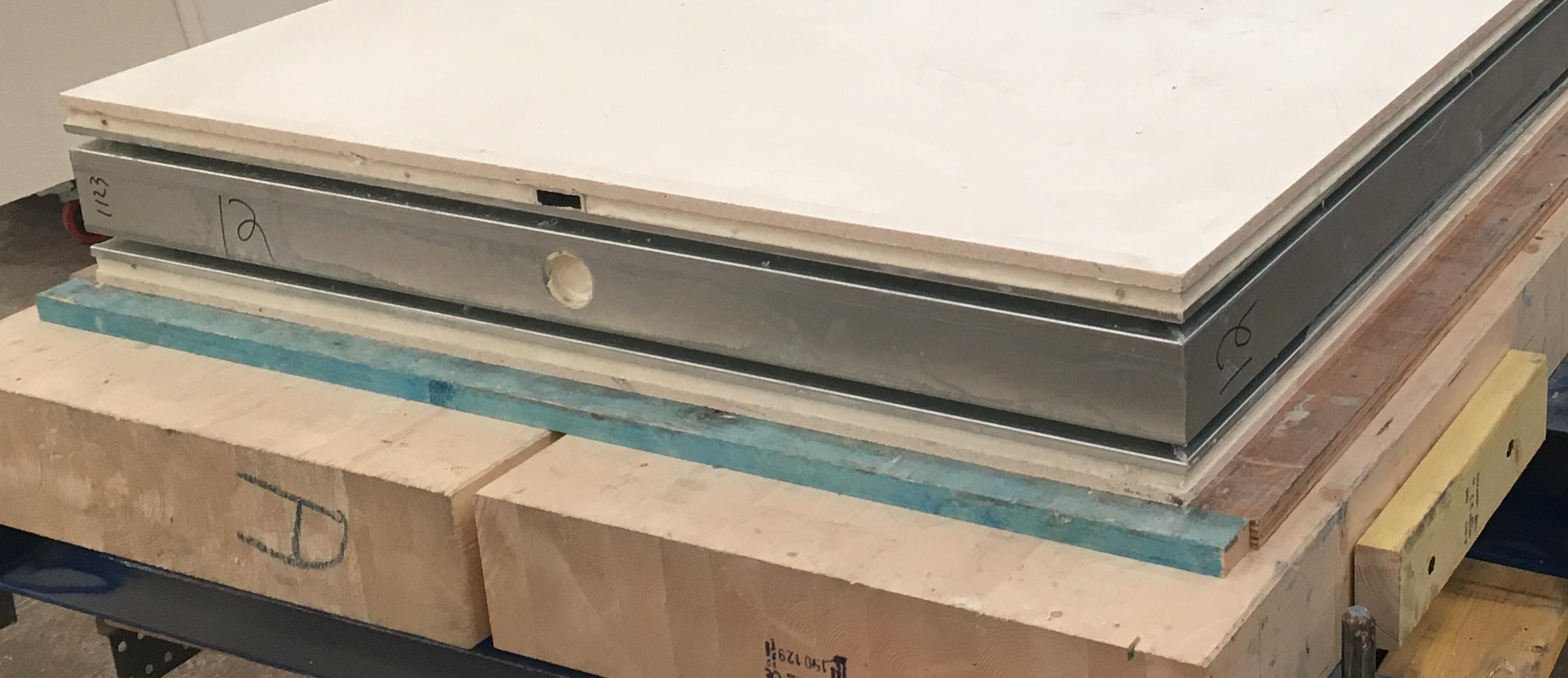

We went with 4Wall engineered SIPS panels from Tribus - they are a bit more high tech (and more expensive) than timber framed panels, but we have ended up with a certified Passivhaus and they were a big part of that. Project Etopia is using the same system as part of their "turn-key house" system.

Back to the OP - we used 4Wall SIPS from Tribus for the main construction of our Passivhaus. As ex-timber frame guys who now manufacture the 4Wall panels, they did everything from the slab upwards (not including the slab itself), so SIPS panels; stud-walls, floor and roof timbers ready for the insulation and membrane. Their speed caught our builders by surprise because first-fix was upon them before they knew it. They're based down here in Devon but have built in Scotland.
