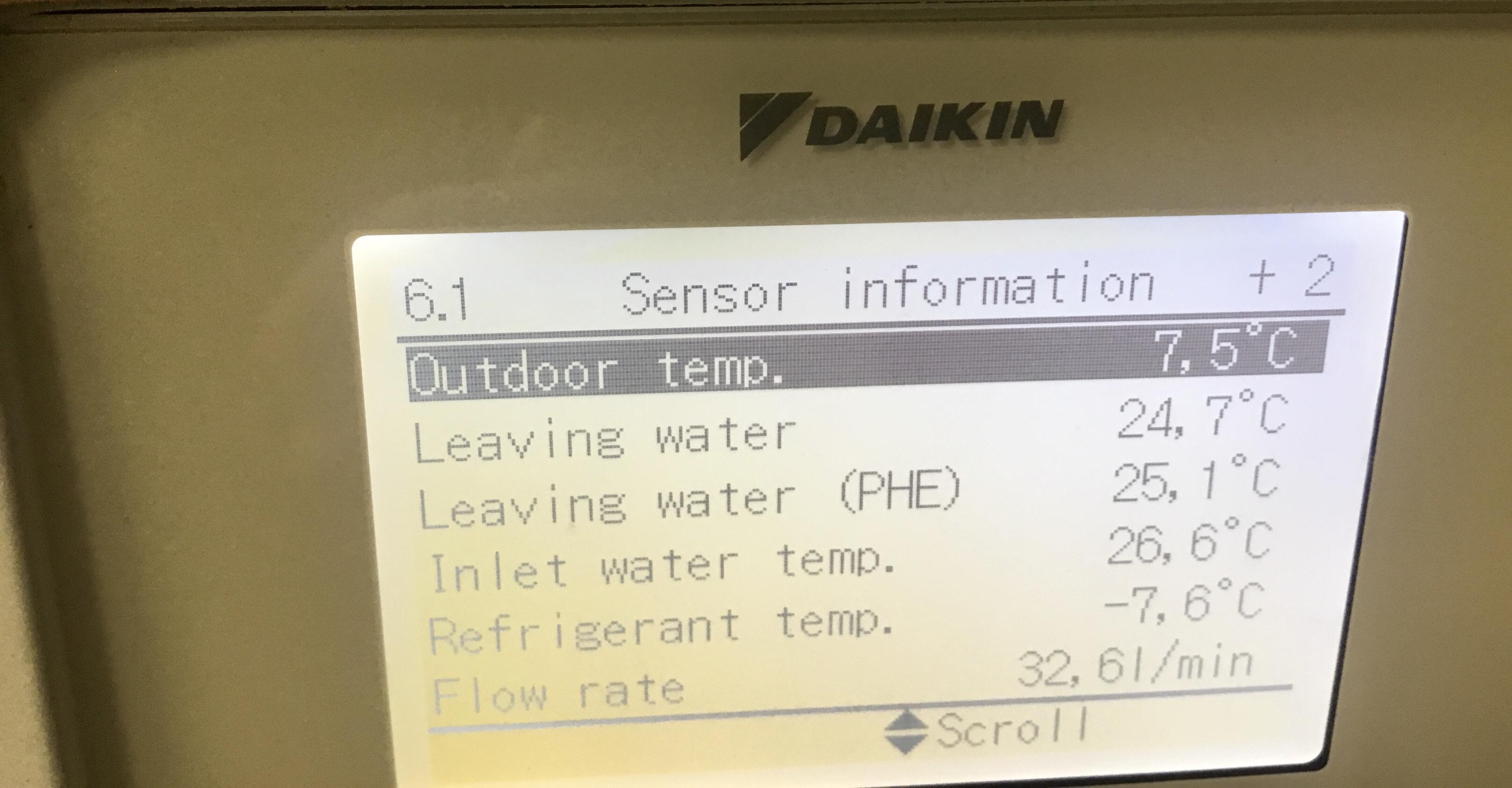

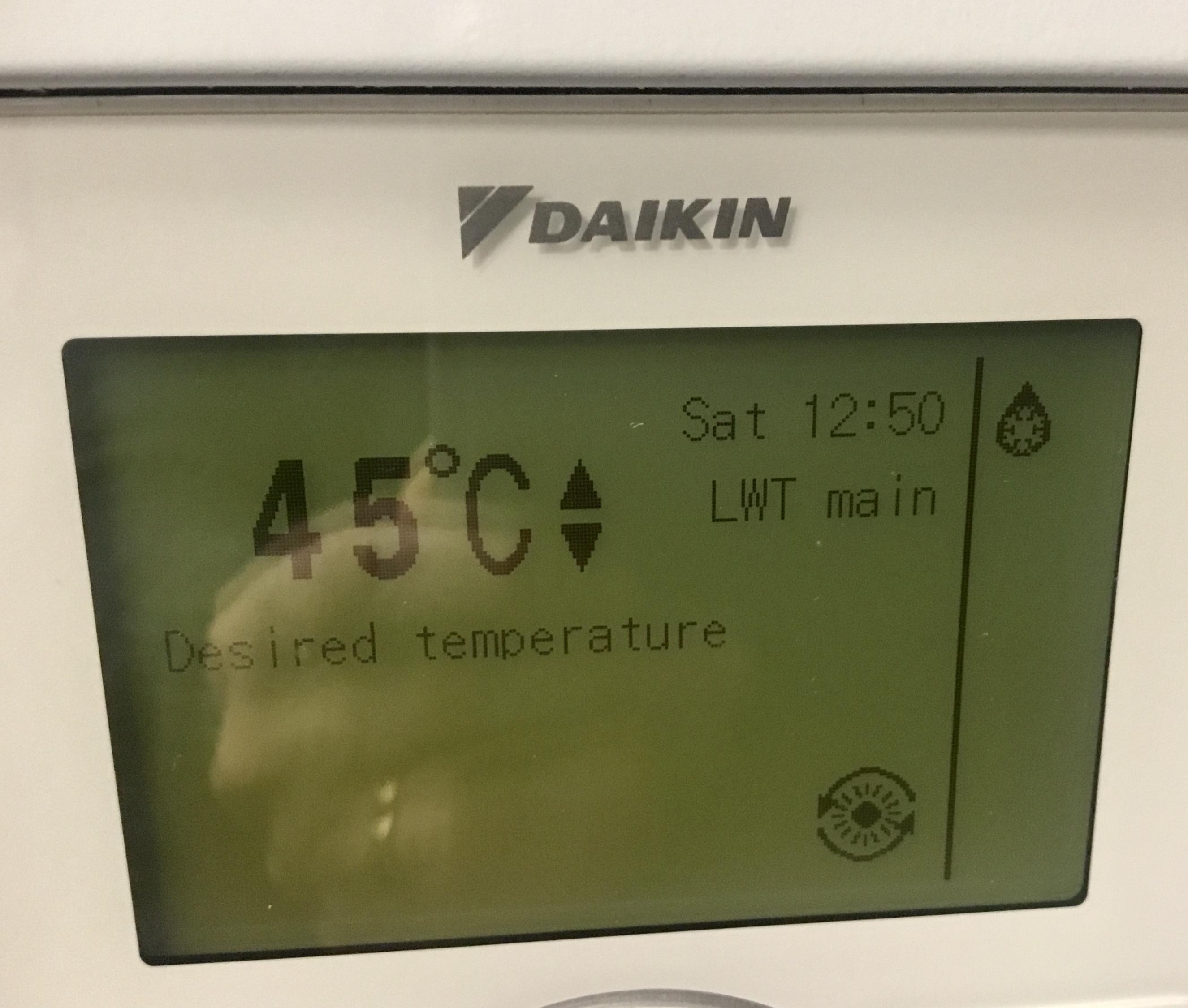

There was a just slim line of ice down one side a bit earlier. The PHE temp had already reached about 36 from about 26 before the defrost started, and the outside temp was good, so I thought we were all good to continue and get up to 45. Yes, i think we have a buffer cylinder, I remember we had an extra £1000 worth of plumbing a year ago in our attempts to get a solution, which I believe was adding a buffer cylinder. That fixed an error code we were getting. I’m pretty sure it was defrosting because the little snowflake symbol was presenting on the main display of the ashp. It only last a few minutes so I don’t see it unless I’m standing there forever, but I was triggered to go and check because the house power consumption went down to about 1.44 instead of the 2.58 it was previously running at, yet all thermostats were still calling, so I knew none of rooms had reached temp and turned off any pumps. The refrigerant temp had dropped sharply to -7.6 from 36 by the time I got to it, then the snowflake symbol went off and the refrig temp started rising again
FYI, if it’s a useful case study for anyone, it’s just gone into a ‘normal’ defrost right now at 12.48, outside temp 7-8C, now doing its thing trying to get the PHE temp back to where it was. When it’s in this mode it drops back before it ever reaches the required temp (we have set it to 45 since the original 36 made zero impact on the room temperature). If we’re lucky it will reach 35 before it defrosts again, on repeat, so makes no dent in the room temp.
Steamy Tea, it’s a certified passivhaus so low heat loss. It’s a Daikin Altherma LT Split EHBH08CB3V wall-hung indoors, ERLQ006CAV3 outdoors . It uses a Sunamp for DHW but that doesn’t use the ASHP (that’s another story, we initially hoped it would. But for 9 months the sun is enough to fill it and then direct from the grid for the other 3.) I think we suffered a bit from being early adopters 3 years ago, different tradesmen for the different techs, and no local experts in marrying all the technologies. It’s taken us this long to know that it’s a real issue and not just user error or teething troubles, because it’s only on for 3 months of the year and needs a run of frosty nights. Finding an expert is the hard bit. No-one we called can tell us if a bigger unit will make any difference. Any tweaks an engineer has done can take a year to reproduce the conditions that cause it, and every experiment to see if it works differently with different usage patterns needs the same conditions for days/weeks. Apparently the next size up would fit our current pipe work, but there’s no guarantee it would make a difference, but we’d need whole new pipe work if we went a size above that. So do we go one size up and risk failure or rip out more and possibly over-engineer it in the hope of fixing it. If anyone knows any Daiken heat pump experts in Devon, and ideally know Sunamp too, who can say ‘X is the problem and Y will fix it’ and is willing to take on maintenance of an installation they didn’t put in, I’d love to hear. DPmiller, I’ll check on that, I know when it was first installed Daiken sent a man I believe he disabled an heater within the internal unit because being in the plant room it would never need it. if the external unit has one would it explain this occasional power usage surge? I see lots of defrosts but this spike is very rare, only saw it once or twice, each time for about 20-30 mins, and it sticks out like a sore thumb on the solaredge app household power usage. Thank you both for your help, I am going to contact Daiken direct now that I have the confidence to say it really is an issue that needs to be fixed.
Thanks Steamy Tea, yes sorry, kW, forgive my schoolgirl errors. Thanks for confirming that something is not right, we’re finding it very hard to get anyone to advise us, no-one seems to know what to suggest, We don’t know if putting in a more powerful unit would guarantee to resolve the problem so are reluctant to try it and find out it that ot makes no difference. At the moment it’s not fit for purpose, but we are obviously very committed to this type of heating. Do you know if the rare 5kW spike is a normal thing, or if that in itself is also an indication of a problem?
