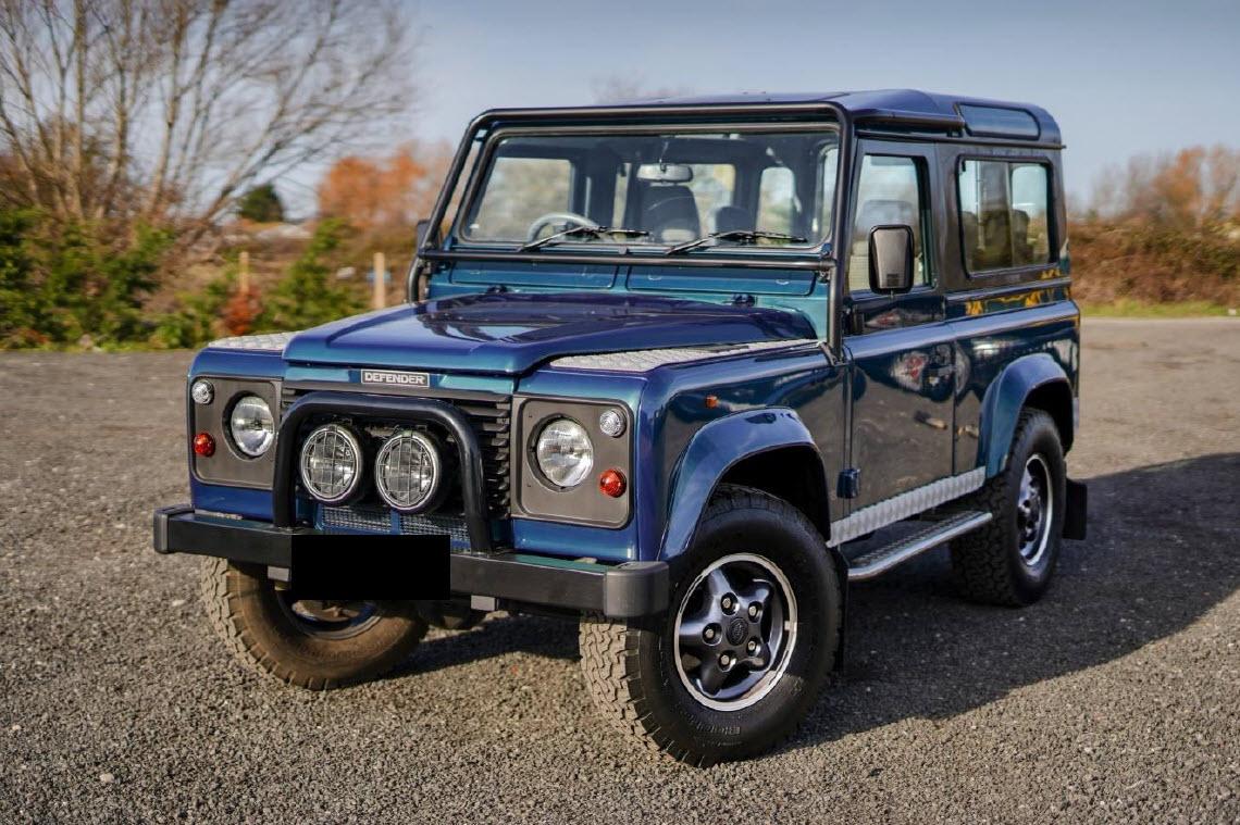

  1. Yep, I a self confessed Defender addict. I've tried to kick the habit but just can't. My latest if my best yet. A completely unmolested, factory spec 50th Anniversary with the standard flip metallic paint, 4LTR V8 automatic. It even has the original tape deck I'm in love Oh and sometimes I start the engine just to listen to the engine ? Sorry trashing your thread OP
