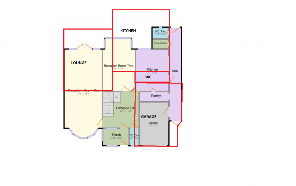

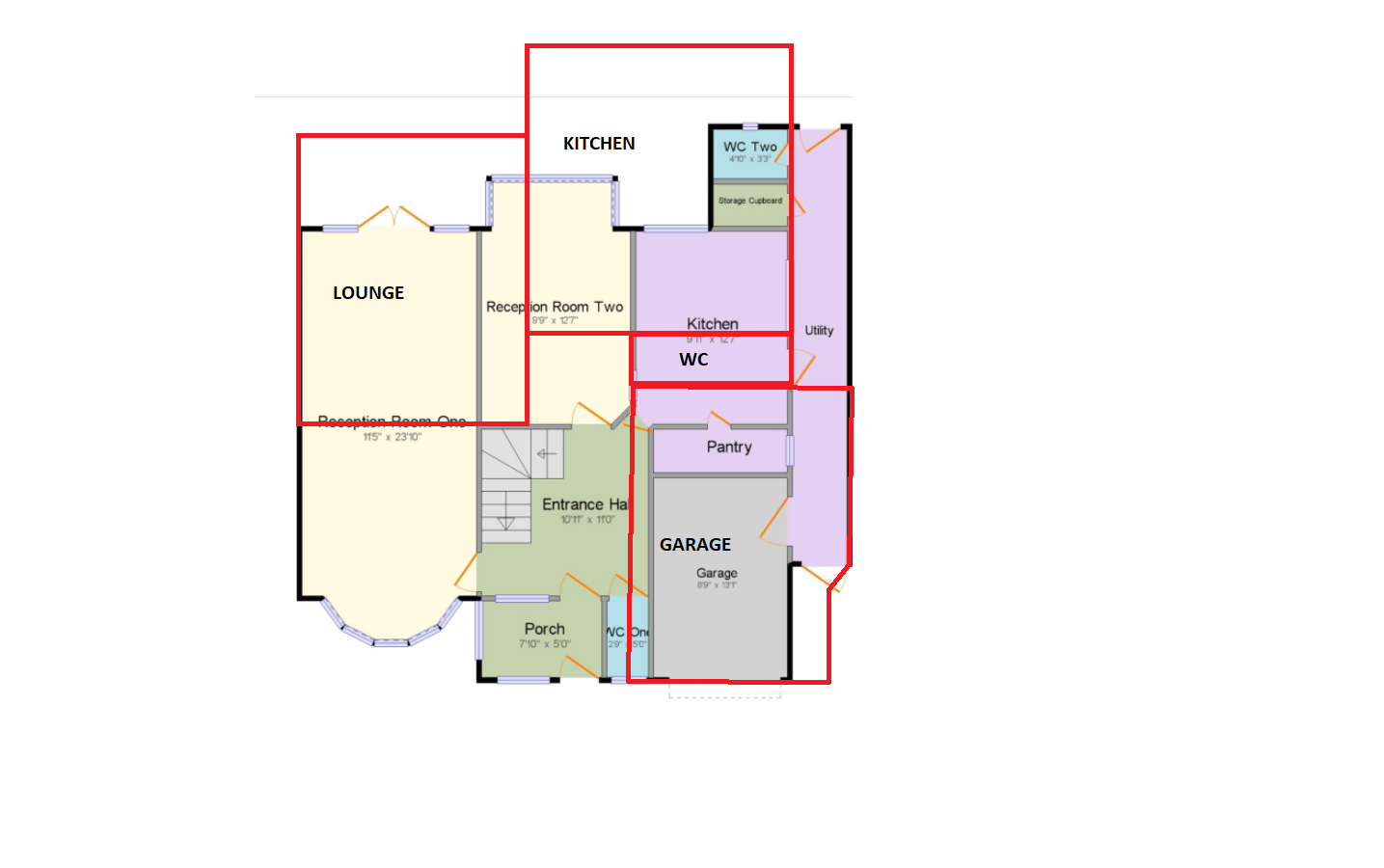

The rear arrangements and WC move were already planned to make more living space, so the additional shit from the garage moving inwards changes it a little. Thanks Ferdinand - does the Google maps link do as a site map? 20 MacKenzie Rd - Google Maps The first floor of the property is fine and only requires the WC and bathroom to be combined. It's the ground floor where I'd like to create more space. I'll more than likely have to use IWI for the lounge wall (unless neighbour agrees to EWI on that side) so that takes the room width down to around around 3.3m, which is a little narrow for me. So I thought about partitioning it into two, and extending the lounge into the garden and the current dining room. I could forgo extending into the dining room and just out, but I like the idea of having good width lounge. A large kitchen diner is also a must, so combining what's left of the dining room with the kitchen and then extending outwards again should give us this. The utility room can go next to the new proposed WC, with a door to the outside. -

I was thinking some sort of steel under Bedroom 5 to provide support, but I'm just guessing here. The side wall of the utilty space is right next to the neighbours wall, the utility space is just above 1m. Yes, this would be our forever home so I'd like to get as much of it right as possible...and I can't get having a usable garage out of my head! I had planned to remodel the rear of the house but sacrificing the pantry for garage - another metre inwards shouldn't be too much more of a headache/cost. Good suggestion Ferdinand and I had thought about that. I've remodelled the downstairs to include the changes I had planned anyway re lounge, kitchen and WC. This could work well as I'd have the size garage I want and keep a decent sized hallway. With this model, there won't be any new wall touching the neighbours and should actually be around 0.5m gap. I also don't think it'd add much more to the cost of what I was thinking of originally. -

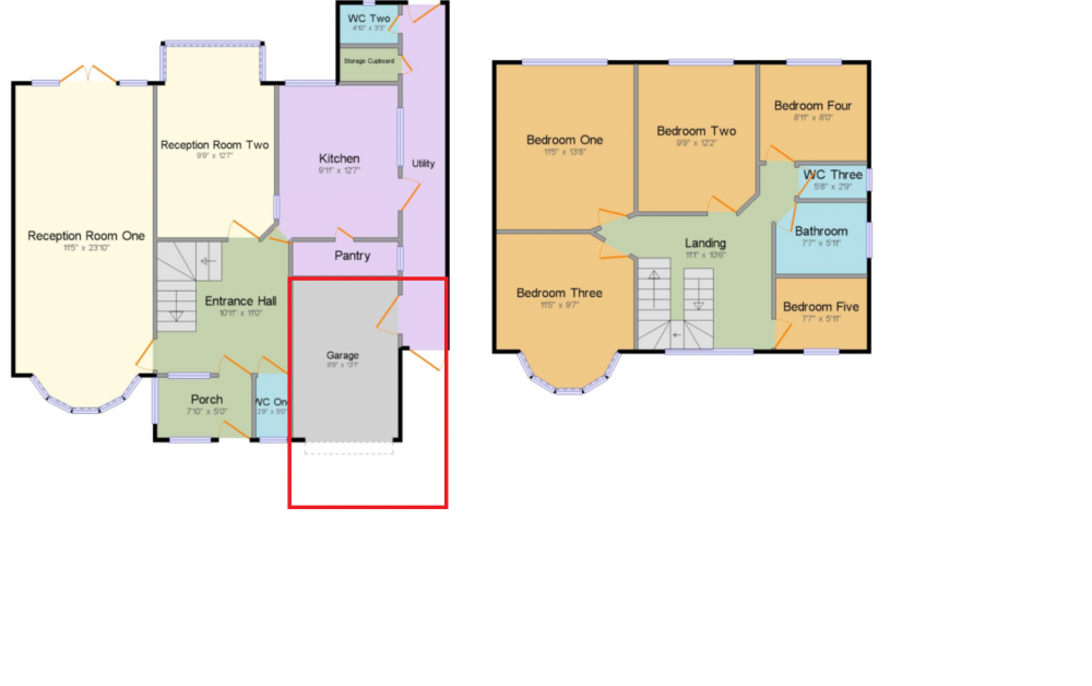

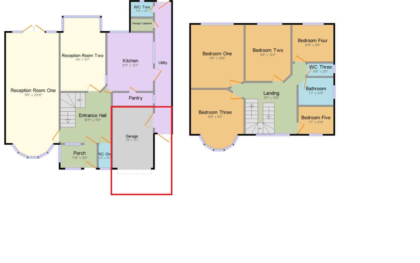

My car, although not quite a tank, is 2.1m wide and the garage is currently 2.7m. A minimum of 1.4m of door opening space seems to be recommended i.e. 80cm for driver + 60cm for passenger side, hence 3.5m as a target. I've attached the layout for the ground and first floor and have added a red box for the most simplest extension. Bedroom five above the garage doesn't go out to the full width - looks about 3/4. It also needs lengthening by 2m. Doing this outward will just bring me to the 45 degree rule for neighbours window, but happy to sacrifice the pantry if needed as I'll be looking to extend and remodel the ground floor. There is also an option of sacrificing the WC by the entrance and extending inwards, but this will be more complicated. I hadn't considered a car port, aside from how it'd look on that road, bedroom five above may be tricky. But it'd certainly remove the need for a brick wall extension and so provide some extra space...interesting idea. -

Yes, its the only front to rear access, but the garage can be used for this by still having a door into the rear garden. I'd really like a garage that I can park my car in and for that I need a minimum of 3.5m width. With the house in question, taking the garage up to the neighbours wall would give me a little over 3.5m, when I take into account EWI on the house wall. The house also has a 3m wide entrance hallway, so I could potentially take some space from there also, but that may be more tricky depending on structural requirements. -
