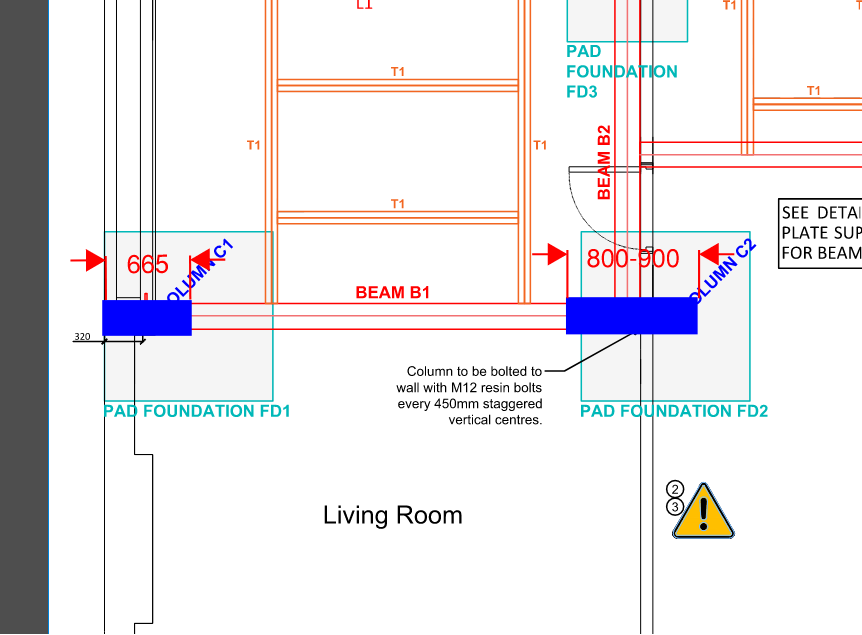

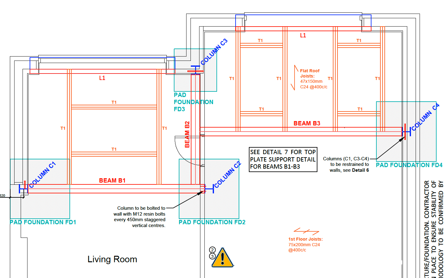

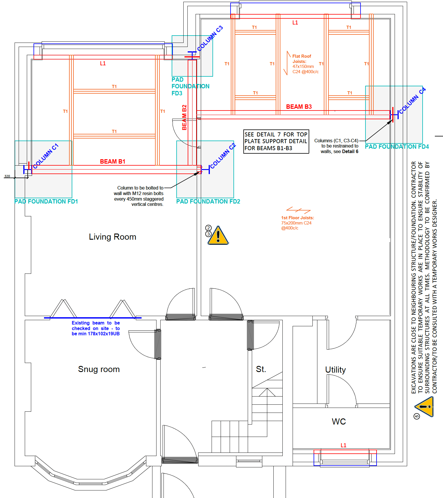

@Gus Potter - I've attached the plans and the SE drawings for all the floors. The whole disruption is the biggest concern. The living room is fully finished and the disruption will probably affect at least a third of it. We have a solid floor, so fortunately no electrics to disturb and no pipework underneath.
Sorry for the late reply - I need to enable notifications. By box frame, do you mean something like the attached option the SE suggested?
@joe88 - what did you end up doing? My SE has also specced pad founds and am looking at ways I can minimise disruption of the existing living room floor. The one alternative he has come back with is to use wall piers and possibly with underpinning - but these are would stick out too much. Also - if there is no reasonable alternative, then how much of the existing floor would need to be dug up? And would cold bridging be an issue?

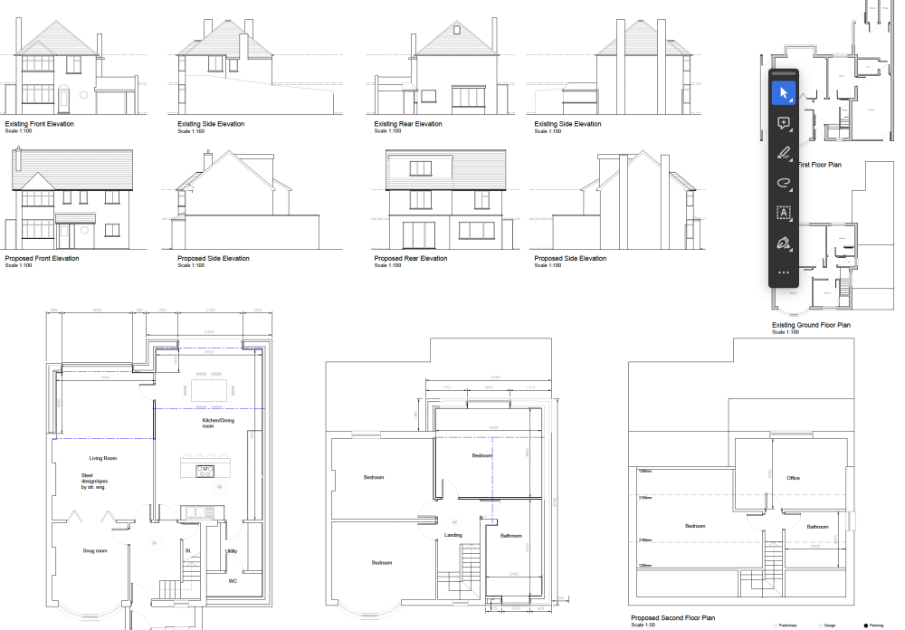

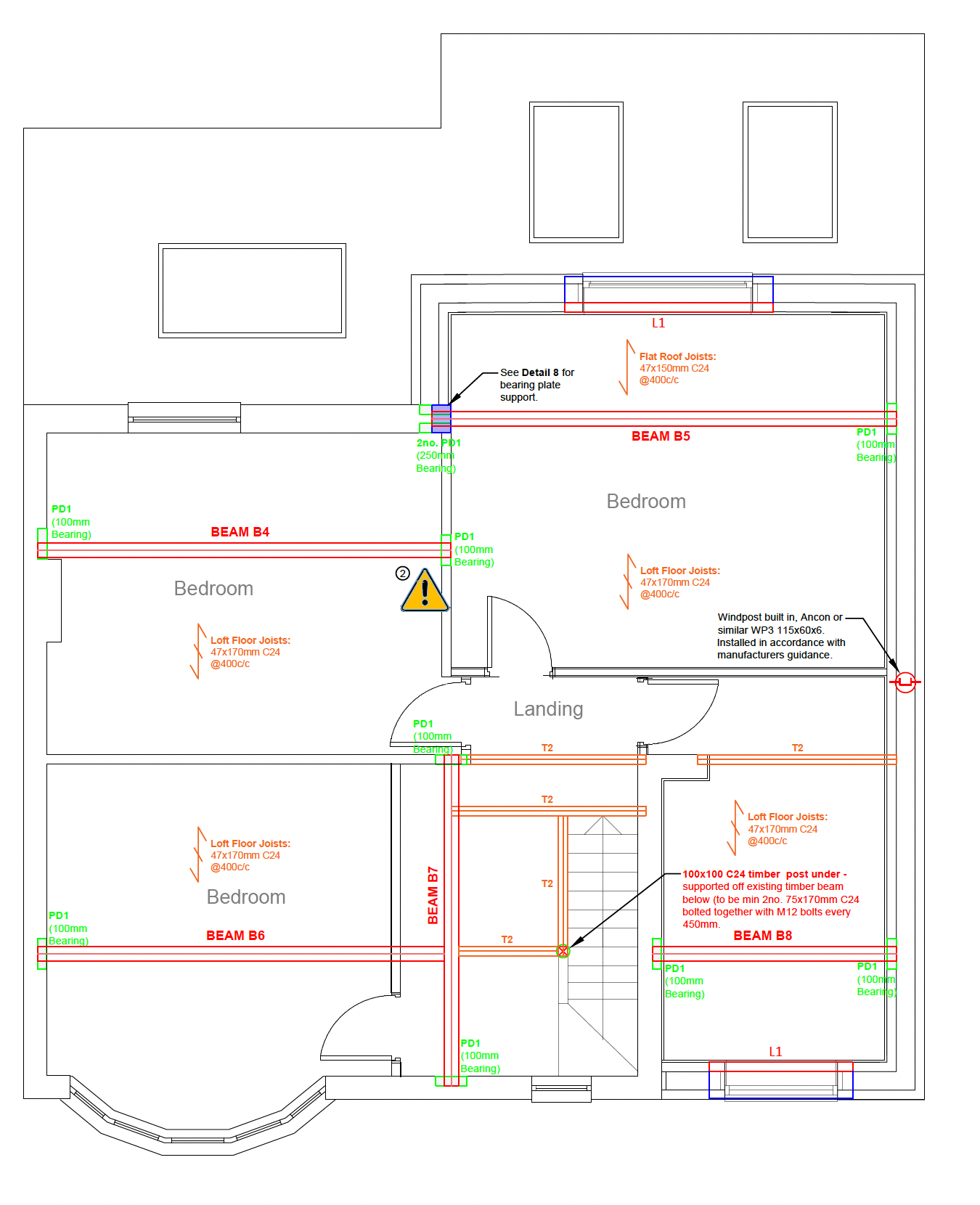

I've had the drawings from the SE and @ETC was right, there is a lot of steel going in. My builder thinks it's way over the top and I'll discuss with the SE in the new year, but what do you think? -

Hello, After a couple of self-inflicted planning resubmissions and getting a final approval, I've now received my first drawings back from our architect. The property is a 3-bed 1950's detached that has already had some work done to it - namely modernized and small box room removed to increase size of bedroom at front....so currently only two beds! What isn't clear from the drawings is that we're having a completley new roof structure, going from hipped to standard gable. The reasoning beind this was to get more headroom in the loft space, with the added benefit of being able to get more solar. I've aleady submitted some changes to be made, but thought it'd be great to get your thoughts. I've attached the drawings and some of the changes I've asked for: Ground floor stairs to not have the second turn at the bottom and finish facing the snug room wall. Lounge to have large window as specified and not doors to garden. Pocket door between lounge and kitchen to be replaced with standard door. Kitchen sink at specified location New rear bedroom reduce to 3.3m No ensuite for new bedroom Move rear bedroom window to centre of wall Remove ensuite remnant from existing rear bedroom Increase storage room size on first floor to 600m as MVHR is to be sited here. New window for loft landing Relocate bathroom window to accomodate wall change Relocate second window in office Internal walls to have sand-cement render with skim finish. Increase size of porch to include portal window. 21CO-BR01B Proposed Drawings(1).pdf -

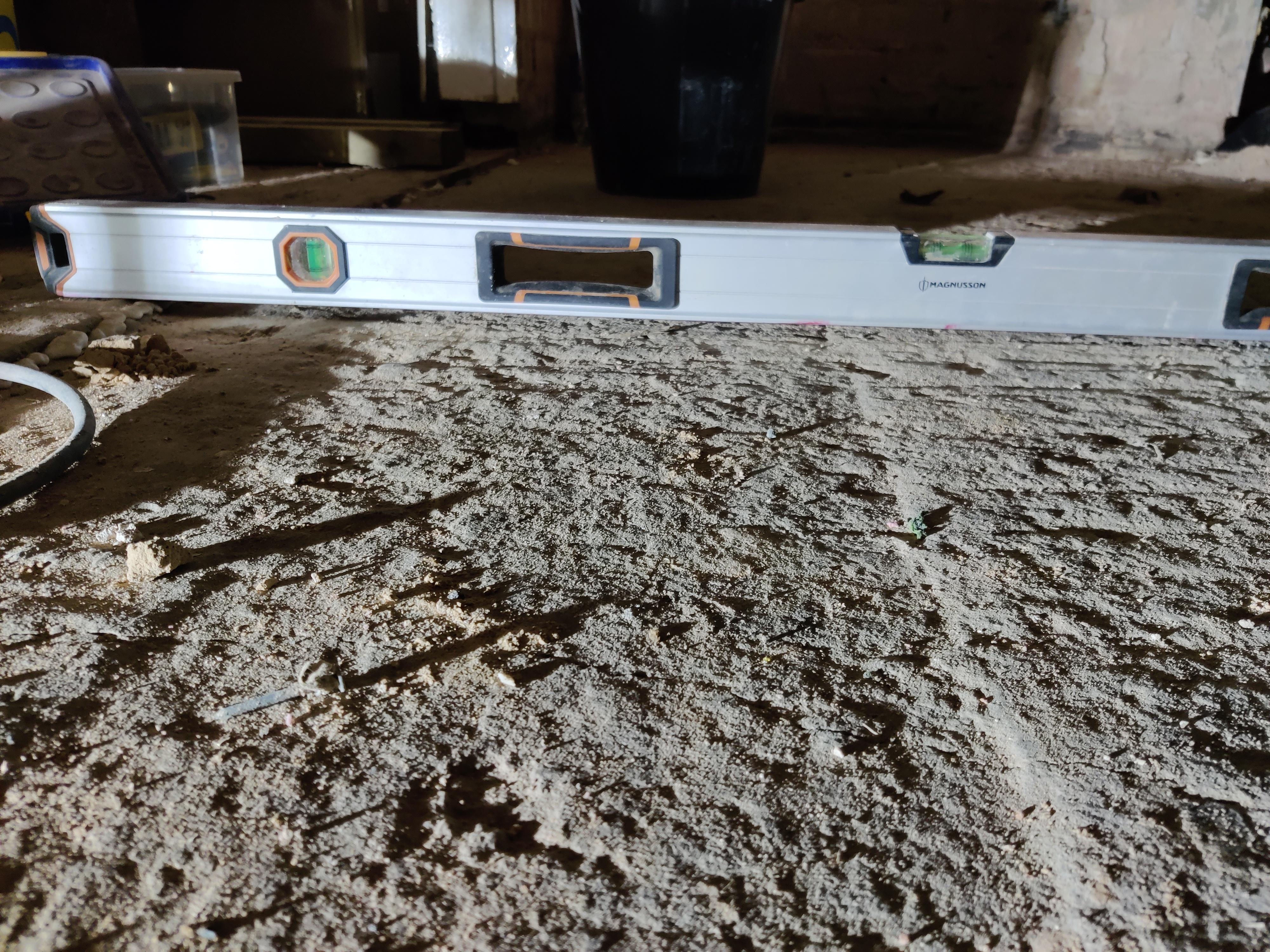

I've removed the screed from the ground floor and have a relatively good slab...except for the transition into one of the rooms. By transition, I mean there are a course of bricks separating one room from the other There seems to be height mismatch of upto 1.5cm at some points and I'm unsure what to do about it. Couple some self leveling screed or a light cement mixture be used to help ease this? I could start/stop the insulation boards at the transition point and then maybe use some 12mm OSB to level the floor. I plan to have a floating wood floor finish.
