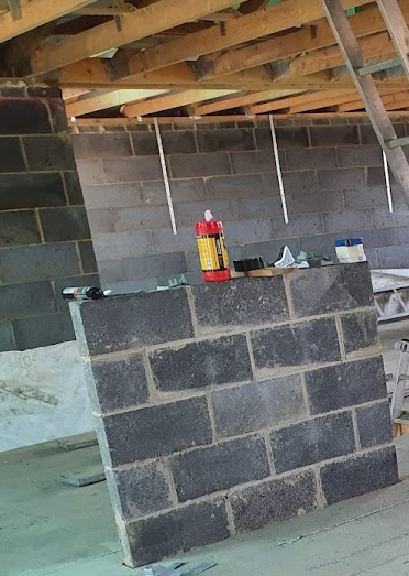

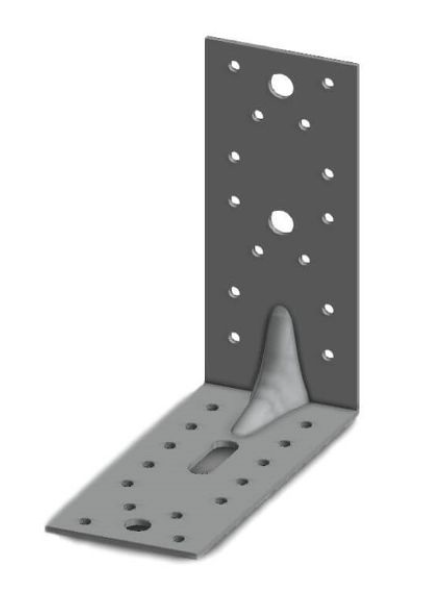

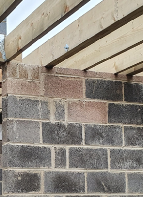

Double storey spine wall going down to foundations. 140mm concrete blocks till first floor joists. Then 100mm concrete blocks from first floor to ceiling of first floor (2300mm height). Length of spine wall 1340mm (3 blocks long) at first floor level. So far built only 5 blocks high Concern: first floor single skin concrete 100mm block wall needs better anchoring because it rests partly on blocks but partly on the joists (that run perpendicular to the spine wall). The joists are 2x10" C24. Topped by 18mm P5 chipboard surface. pic: 140mm inspine wall with 2x10" joists resting on it. Concrete block infill. Qu: What would help to anchor the base of the first floor concrete block spine wall to the first floor joists? So far, thought of heavy duty brackets along the base of the wall, screwed down to joists through the chipboard eg Simpson E9/2,5 Angle Bracket 65mm x 150mm x 150mm

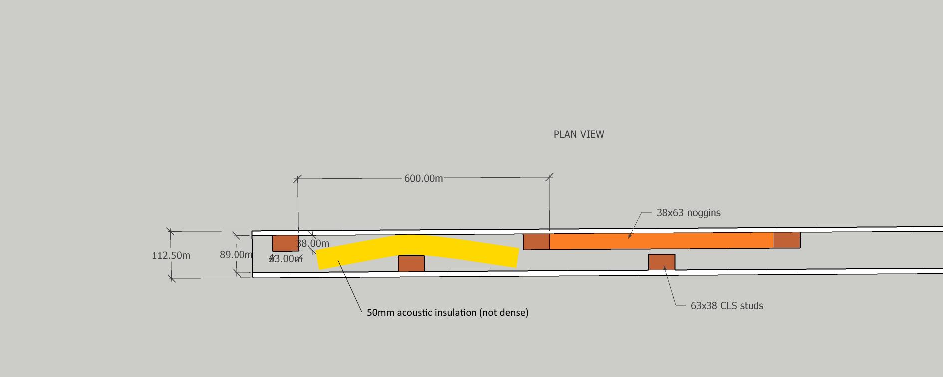

For stud walls, what are the pros and cons of CLS vs timber? Both C24 grade

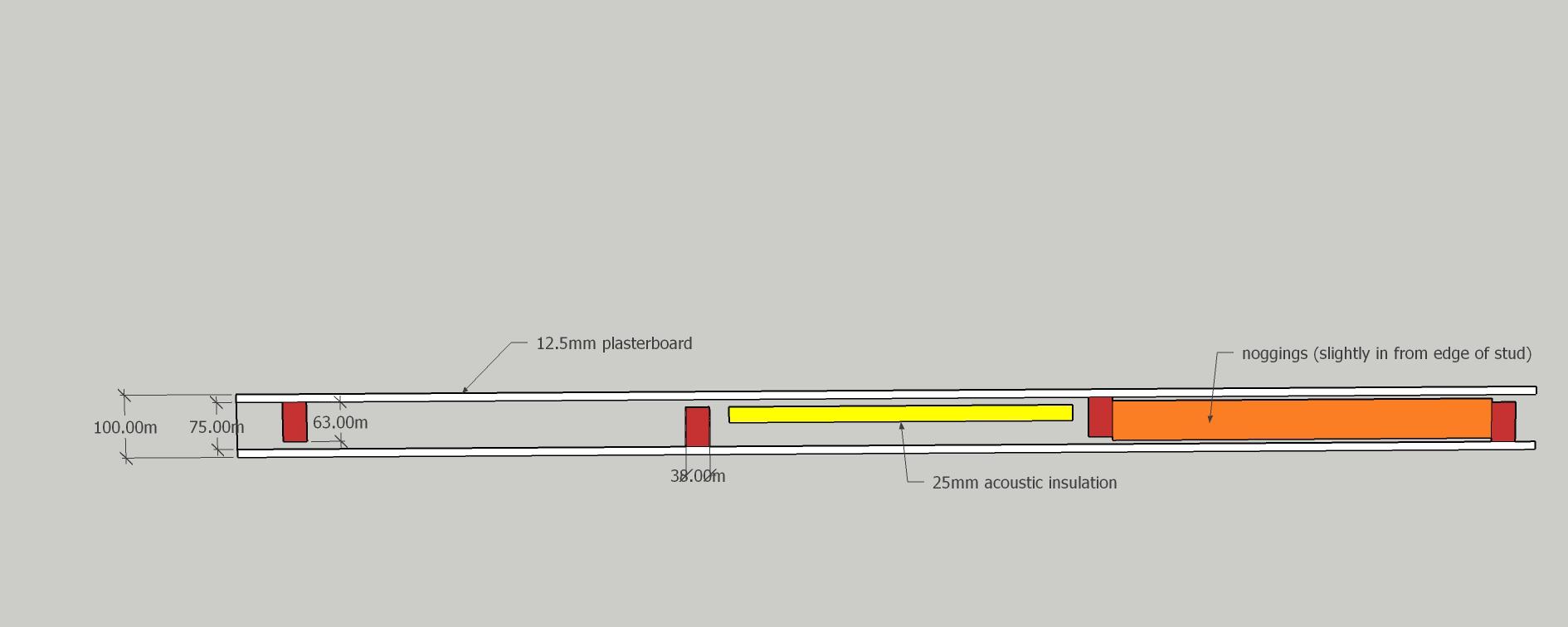

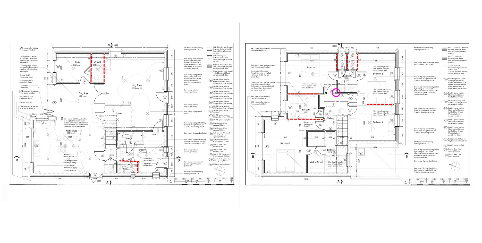

New build in progress. Stud walls preferably to not transmit too much sound, esp from WCs/showers & between adjoining bedrooms. (pic) First floor height to ceiling 2300mm. Qus: A. Would CLS studs 50x75 suffice? Staggered studs. (actually 38x63) Would C24 (or C16) timber 2"x4" for studs offer any advantages in terms of a) structural strength b) sound proofing Some say CLS is less likely to twist, compared to sawn timber. B. Would OSB backing board on noggings suffice wherever stuff is to be fixed to the stud wall later? If yes, what thickness of OSB? (9, 11, 15, 18mm)?

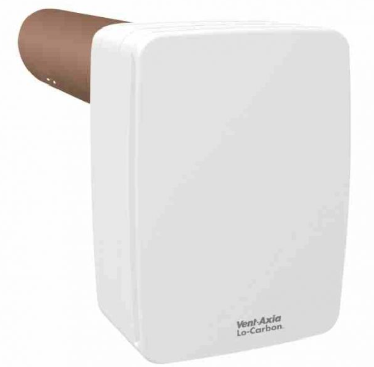

Great point. Core-drilled the extractor openings near ceiling. There is a 12V version of the gadget too. Clincher: Kids might get their fingers into low placed extractors. -

True. Trying to improvise in rooms where this is not possible (ceiling not high enough to be outside the mains electricity-free Zone zero of the shower). Any reason why the less desirable position below window should be avoided? -
New build under construction. Background constant extraction with heat exchange (Vent Axia Tempra fans) in kitchen, wet rooms. To prevent damp etc. Showers sit against walls in some wet rooms. Mains electrics not allowed in that zone. Only lower parts of wall (eg under windows) available for these fans. Any reason why the extractors cannot be at lower level?

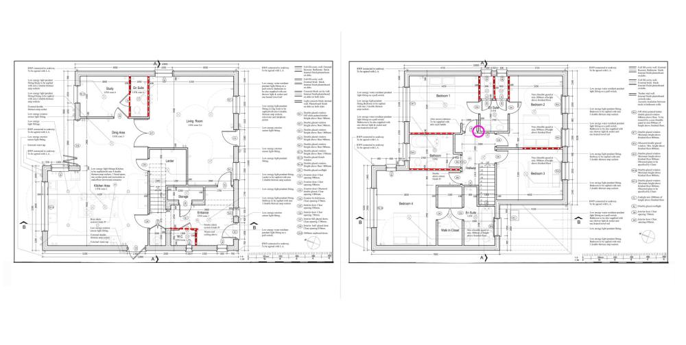

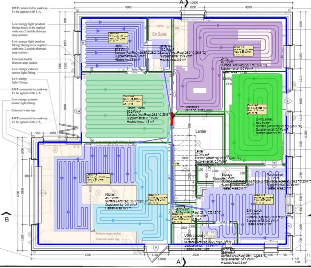

New build under construction. UFH: Is it sensible to try and heat different parts of the same open plan area to different temperatures? ie > 1 thermostat for different parts of the open plan area eg. In pic, mid left is dining, which is part of the open plan kitchen/dining area. Sensible to have 2 thermostats on the basis that the kichen/breakfast bar will be in frequent use while the dining area less so?
