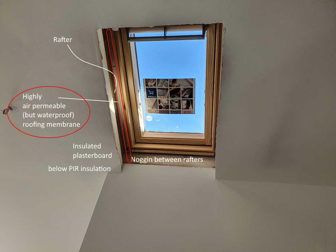

  9. Used Contega solido tape to seal Velux frame to surround. With any luck, that will keep it airtight Then insulated plasterboard to pack out reveals.
  10. Sadly no plastic membrane, only plasterboard with scrim and skim. But might be able to seal an airtight membrane to window frame & plasterboard
  11. New build in progress. Roof window (Velux) installed with insulation sleeve around & under the flashing. Problem: Rough opening bigger than the window. Gap between window and rough opening allows free air flow. How to make this airtight? And well insulated?

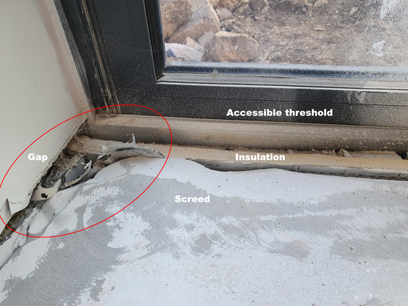

  12. New build in progress. Click vinyl flooring tiles or planks to be laid on screed. Liquid screed already laid. Problem: gap between screed & door threshold What to do, to prepare for flooring?

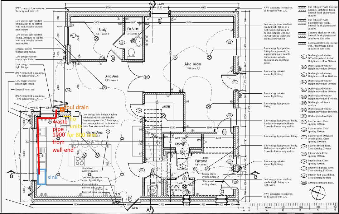

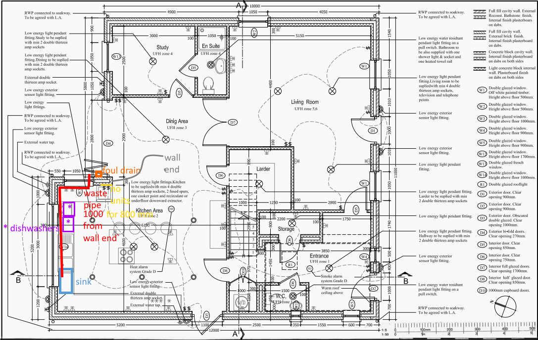

  17. Avoiding external pipes. Is it possible to put a T on the internal bend(s)? Should the waste exit through wall be moved to between units? 2 dishwashers also en route to waste exit (pic)
  18. Nobody likes blockages or inaccessible waste pipes. Kitchen waste running behind units. Is that a bad idea? Given the situation, how to mitigate? Units not installed yet. Waste pipe hole through wall drilled. Can be redrilled if needed. From wall end at right, no units for 300mm along wall Then 500mm drawer unit Then 1000mm corner carousel unit Waste pipe hole 1000mm from wall end at right

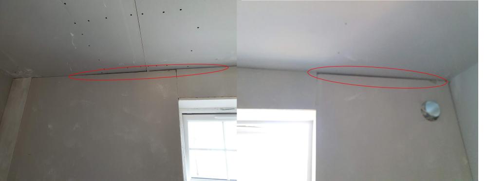

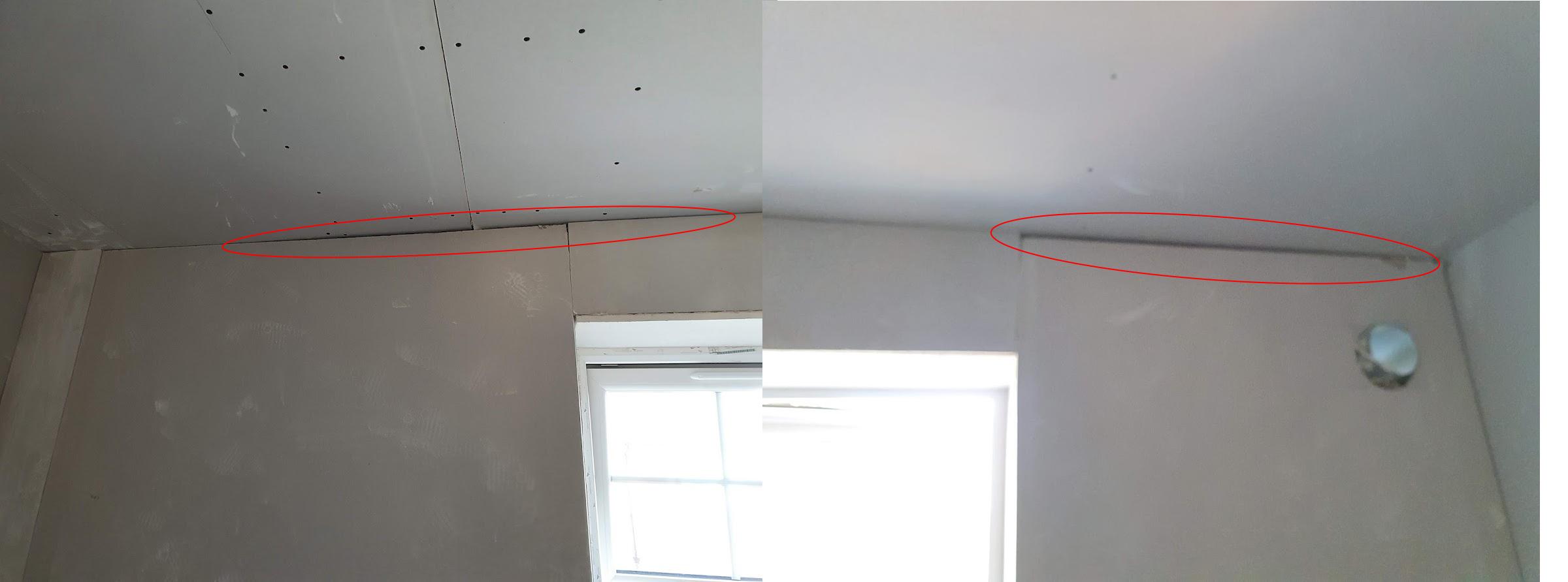

  21. New build in progress. 3 phase cutout & meter (PME) installed in kiosk about 15m from new build. Rigiduct buried in trench, runs from kiosk to near new build. Intention is to wire house in 1 phase but have 3 phase available in house for future proofing Q. How to get electricity to the new build house? ie what specification cable to pull through the duct? Assume complete ignorance here please.
