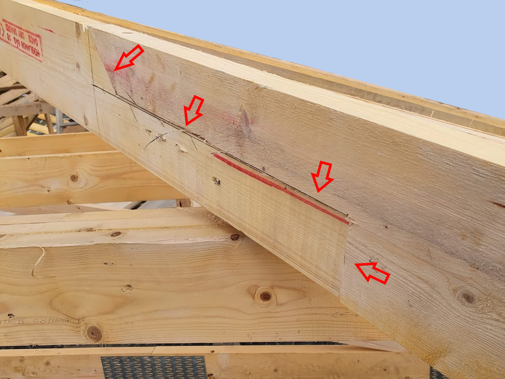

New build in progress, hip roof. For various reasons, one of the hip rafters is spliced (pic). Can D4 glue be sufficient for such a splice? Builder thinks so. Alternative is a steel plate, but that would involve rewinding & redoing a few steps. Trying to gauge how hard to push the builder on this.

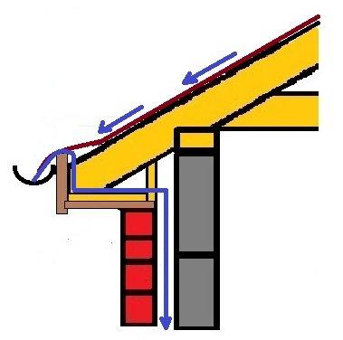

Preventing gutter overflow into cavity
