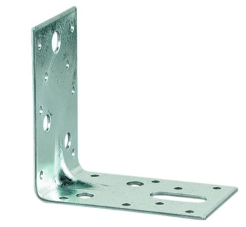

  17. Putting in a couple of these near ceiling to take boxing that will support a 4 inch extractor fan & ducting Wall is Celcon aircrete (high strength) with plasterboard on dabs. Q. What screws would do? PS Tempted to try plasterboard foam adhesive for the bracket & the boxing, without any screws
