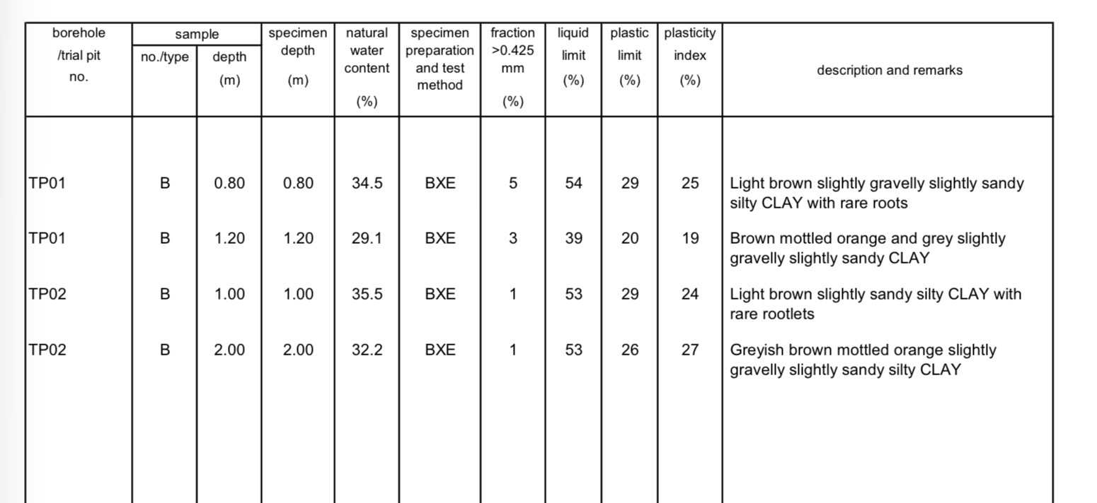

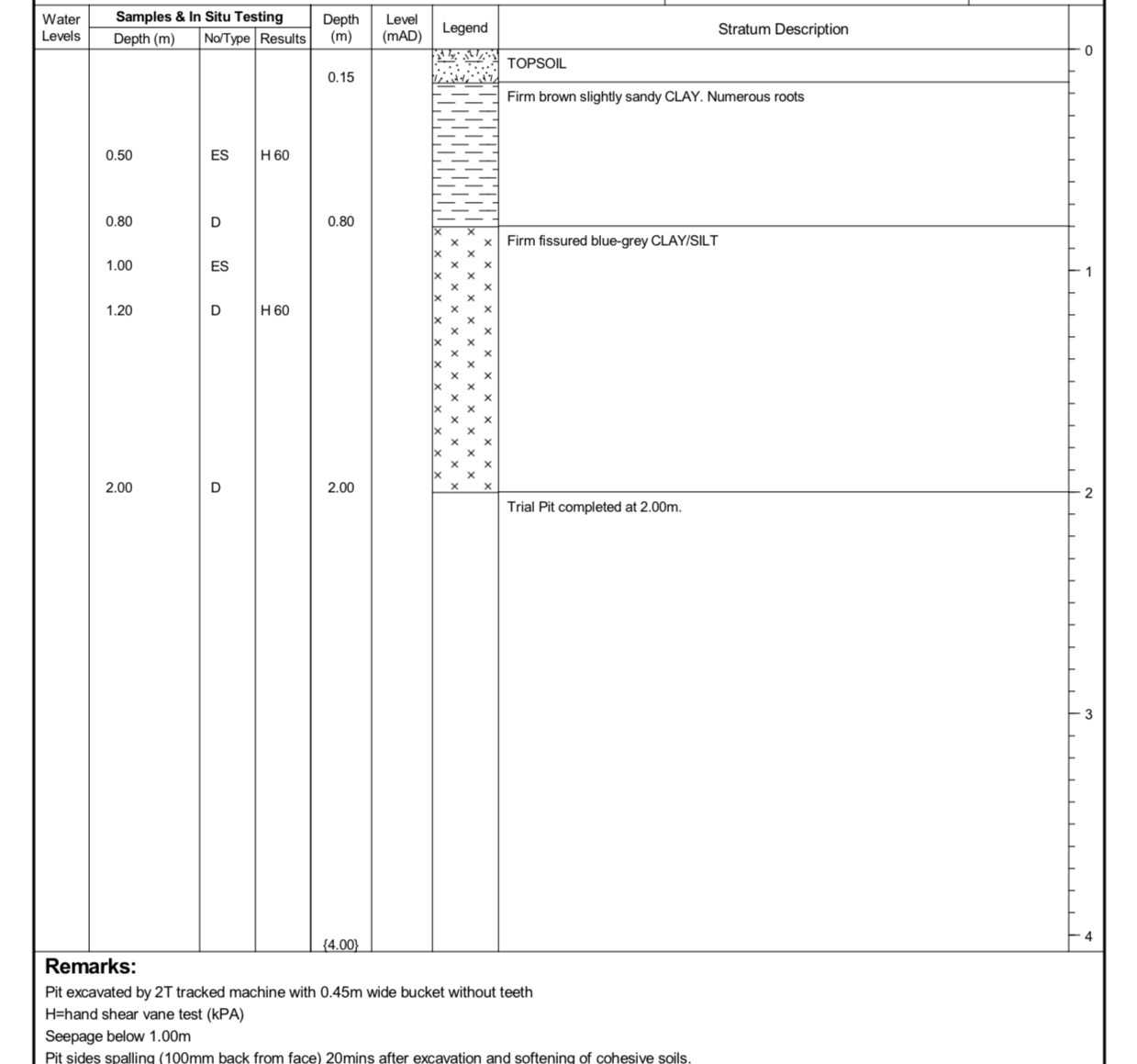

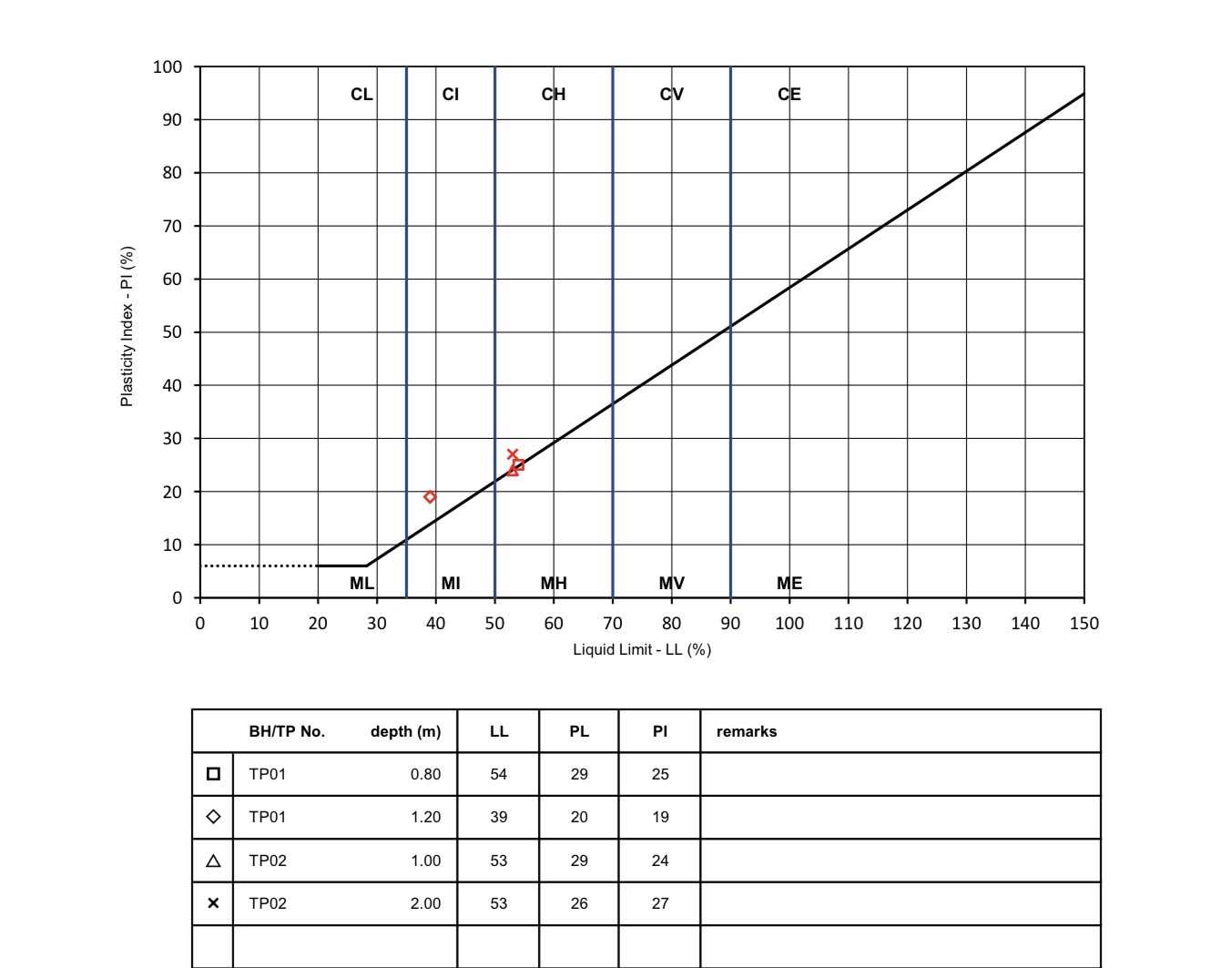

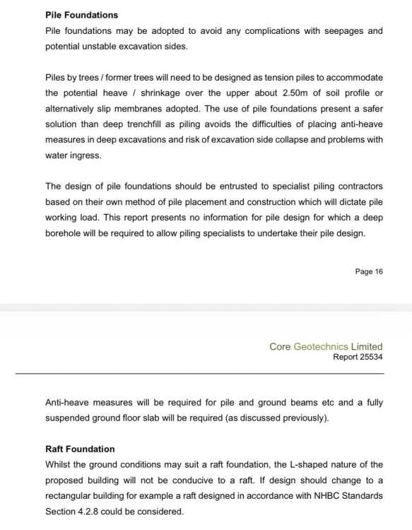

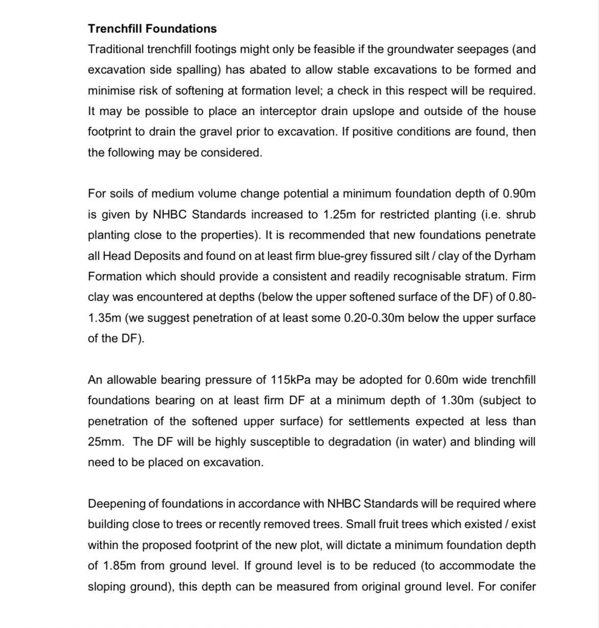

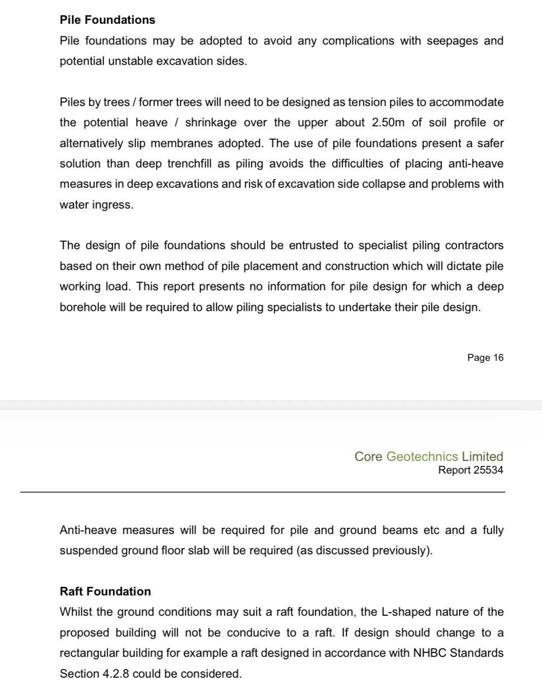

The vendor got consent (with S106). It’s on a road with the other back land developments so precedent has been set. Presumably not full fill trenches otherwise doesn’t concrete cost eventually overtake piling? Maybe I am worrying too much about the trench depth.
It would a lot easier to share the whole report and I prefer in principle, to be open and transparent but in this case need to be discrete. I will try to redact it later. If I am not mistaken, It seems to be mainly a concern about trees rather than soil bearing capacity. The report states (as previous post, site investigations done in January) Groundwater seepage was generally seen at 1.00-1.10m, thought to be mainly a perched water in the granular Head Deposits but also locally out of fissures in the DF where granular Head Deposits were absent.
Thanks for all the comments. The site is a former garden which has been cleared of said former (smallish) trees. It is still bordered on one side by tall conifers within 10m of the nearest foundation. Site of the house is virtually level however the back of the site slopes gradually up from 5-10 degrees. No signs of standing water but ground infiltration test was nil, presumably due to underlying clays (consent has been granted to discharge storm water to sewer). Note tests were done in January.
Well here goes, a few extracts from the report. Note it does not say piles are absolutely necessary, only recommended due to trench depth, stability and potential heave. Once again, appreciate any suggestions.
Thanks, appreciate all the comments. I will post more detail later.

Thanks. I know I will need to talk to a piling contractor in due course. Just trying to get a feel of the cost risk for valuation purposes. From fairly recent experience I can estimate the cost from ground up, just go no idea if I need to add £10k, £30k, £100k for piling.
After saying never again, we are looking at another self build ‘opportunity’! The plot is ideal in terms of size and location but the compromise is soft clay requiring piled foundations. A full ground investigation has been done by the vendor which concludes that piling is definitely required. I know it is a piece of string question but can anyone suggest a reasonable cost difference between strip founds and ‘standard’ piles + ring beam? Looking at 220m2 two storey house with simple form factor so 110m2 rectangular footprint, timber frame and brick skin. TIA

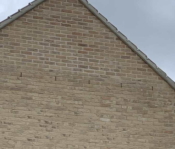

Another vote for 4 however it could look very different on a large area. I used this tool https://nsxpwebapp.nelissen.be/publicconfigurator/?l=en-gb&_gl=1*kft2zi*_gcl_au*MTk2NjIxOTc5OC4xNzg1MTM1NjUy to visualise the difference but still built a few square metre panels before deciding. Went for the natural look in the lower half of the picture to blend in with the older buildings in my location. The upper part (unplanned/feckup) shows how it different it looks with a lighter joint, same bricks, sand and white cement.
