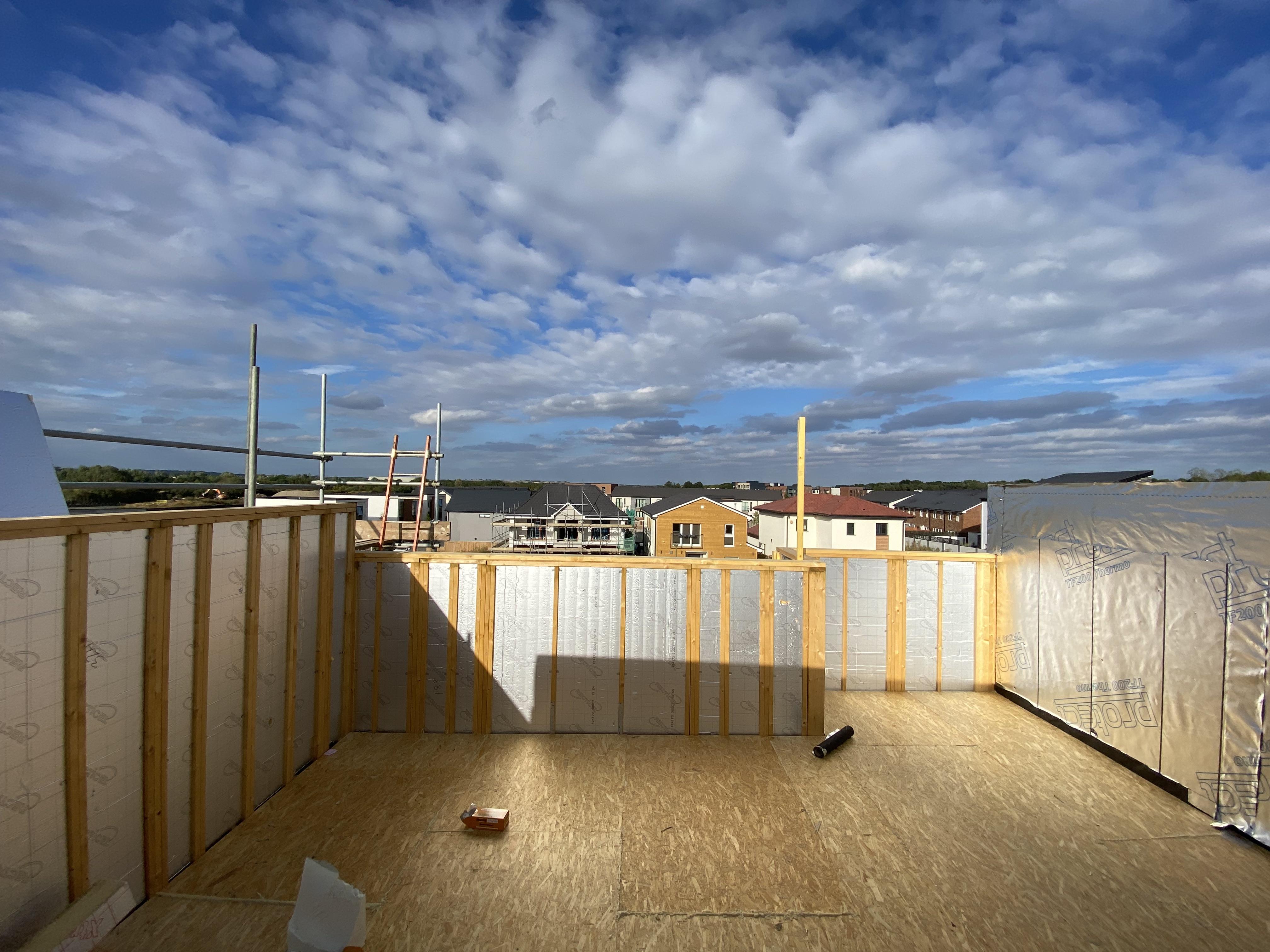

  12. Hi, I suppose I could not have made it any more difficult that it is... We are to build a flat roof terrace on the top floor, and we have a junction of a GRP roof to timber frame wall. The said wall will receive battens, counter battens and vertical charred timber planks to the face. The wall is currently Timber frame panel with OSB. Key considerations: - if it were to be a standard brick wall, I would use abutment trim and simulated flashing. Job done - but here there is none of that. - I considered running the abutment trim against the TF wall and OSB. I concluded that far in another thread. However... - the said external wall is externally wrapped in TF200 breather. - There will be an aluminium coping on top of it, but before - I plan on running the VCL up the said wall to meet the top of it to create a continuous barrier - nevertheless, this means I will be GRPing against a membrane again. - I fear that if I do not lap the VCL to the top, I would be getting rid of a useful "tanking" Or should I: - run VCL and terminate below the abutment trim - install abutment and seal the top of it with GRP - install breather as planned, and extend to the top / underside of the coping - proceed to installing battens, counter, vertical cladding Am I overthinking this??? Picture below to show what I am mumbling about. Thanks! Bart
  13. Thanks! I will have up to 6m runs, and last thing I want is the aluminium trim spiralling out of shape. So, stick to GRP trims I guess, and the one as per the latter link should be fine to use? Seeing that it is made out of GRP.

  16. Grp trim should be nailed to roof snd masticed to wall to maintain flexibility. Breather draped over it and grp onto is my preference here.
  17. thanks, I am being paranoid about water possibly being driven behind the trim if an air pocket occurs or the joint fails in any way. my logics is that it is a neater joint against flat OSB sheet than the draped breather.
  18. Hi, silly question probably, but we are to do grp on the roof terrace and that butts up against the wall which has got a TF200 breather on it. It is a timber frame wall with OSB on it (and the said breather). would you: - fold up the breather, install grp trim, install GRP against the wall and above, then fold back the breather and tape on the surface of the finished abutment - or try to run a grp trim against the face of the breather, then GRP against it, and tape on top of it? decisions decisions…
