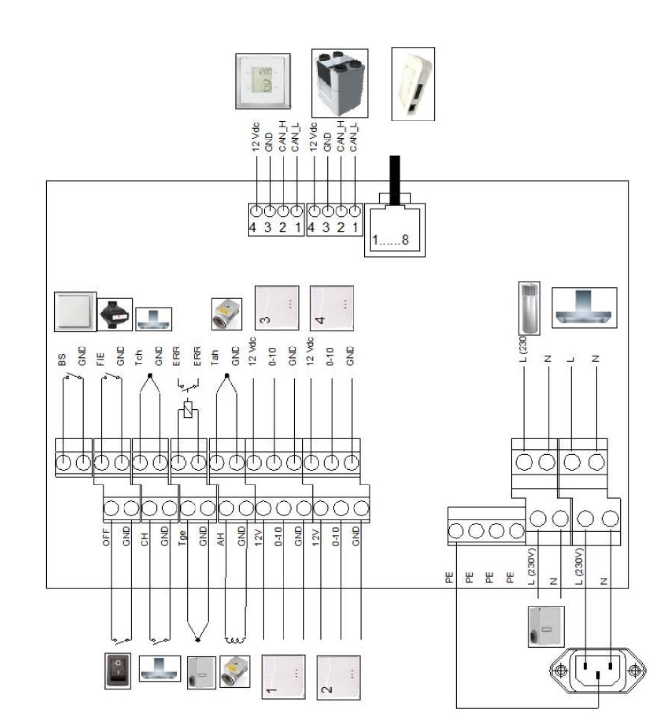

  2. Hi, Me trolling again, about MVHR now... Quick and simple: - Zehnder Q350 - Loxone shebang - Zehnder Lan C (for app prettiness) - Zehnder Options box (for options ) Focusing on the Options: - I can see the wiring schematics allow boost switches all grouped together on one set of pins. Great! Does that mean that I could use logical signals from Loxone room stats and presence sensors (in any algorithm I imagine) that would trigger the brain (Loxone mini server) and close a selected dry relay of choice, which in turn would send a volt free signal to the Options Box and switch on the boost? - the box comes with many more "options" (I am abusing the word, I know...): I could not find any further information about the meaning of all of those other icons above. One suggests there is a kitchen hood. Could I use that to send the signal from the kitchen cooking hood to apply boost? Mind racing, sorry! And if none of the above gets any further use, then is there a way of sending a "boost" signal whilst omitting the Options Box completely? (and saving £300?) PS. Q350, as well as Options Box, and Lan C come with an Ethernet port. I can appreciate Cat6 is to be plugged into Lan C box, but could it equally be plugged into any of the other two? Or would they also need a separate connection? Many thanks! Bart
  3. Hi, I am having the Q350 and Comfo Post delivered for our self build, and while the schematics seem plain and simple: I wonder how to best connect and control the Comfo Post here. The heating system will be driven by ASHP (Vaillant Aero Therm Plus with UniTower) with a cooling option (resistor). How do I best control the flow through the ComfoPost: - as it happens I am siting a UFH manifold in the loft right next to where this unit is going. Could it be a good idea to either tap into the supply pipe to the manifold - or perhaps add a separate zone / port to the manifold and run off of that? The downside is that if this local manifold gets no call for heat "pump operation" there would be no flow at all regardless of whether the zone be open. The benefit of the latter would be ability to open and close the circuit. Also the loop would be super short and would run through a pump that would be fairly local there. Or I could leave this port "always open" and assume that when I run heating, I would automatically have demand for additional heat through the vents. In reverse, i.e. for cold air the same would happen with cold air being added in. Otherwise, how would one logically control this above scenario? Thanks! Bart
  4. Thanks guys, So as I suspected the shared manifold at the top floor is being favoured and deals with the air locking issue rather well. Many thanks! Bart
