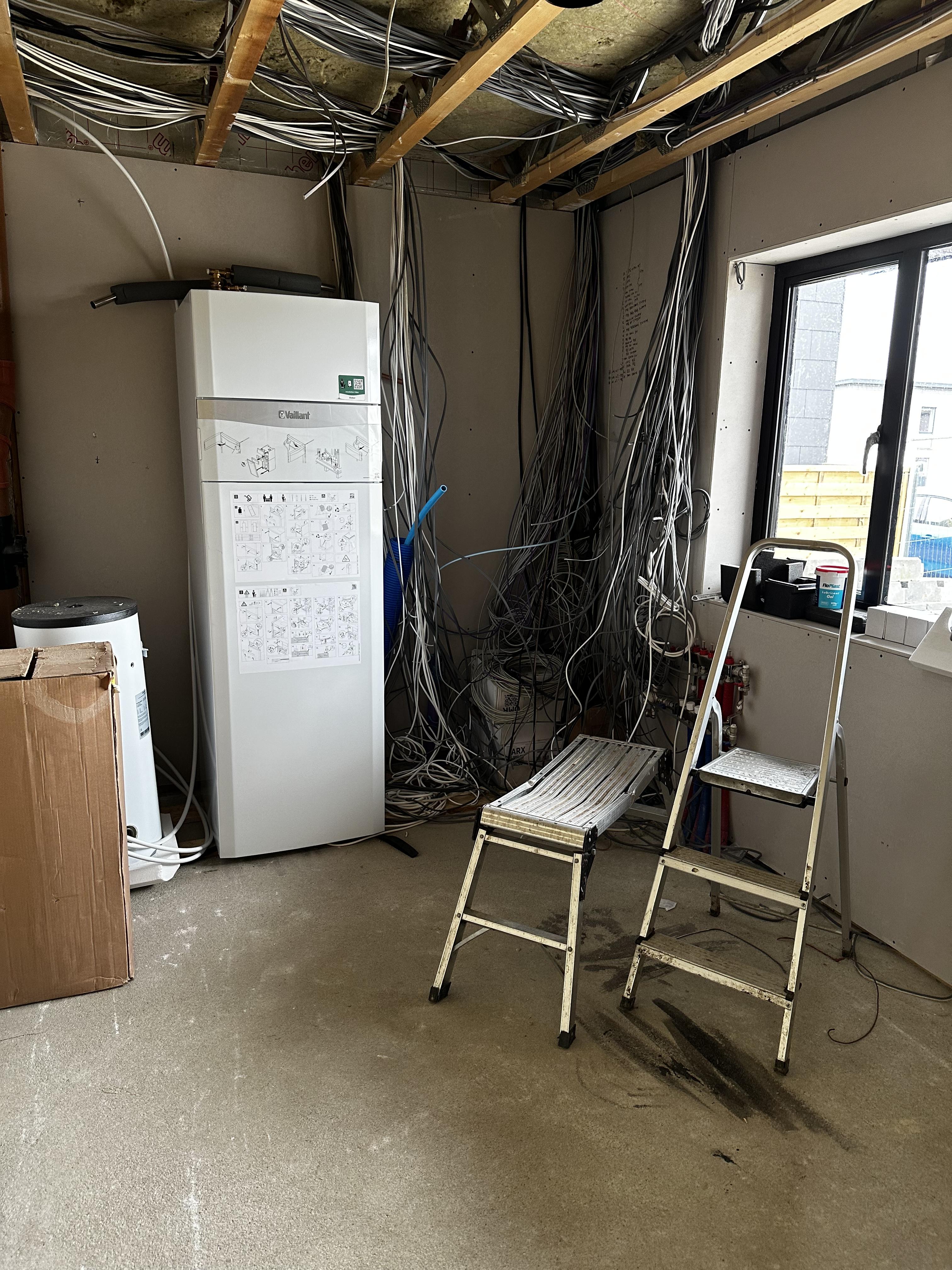

Ok, thanks lads, so in a nutshell: - run the buffer LHS top flow in - through to - RHS bottom flow out? Then cold return pipe to pie. - Can loose the pump, or should? I feel it would help push water around the house, no? I am not worried about the cost of running it. More to ensure the rest of the individual pumps do not sweat too much. - install a bypass valve? Automatic or manual? -magna clean to go cold return fairly close to the Unitower?
Yes all in.
Thanks! yes many pumps and cost of running those. Upper floors are likely to work / run very little, but it could add up. the secondary pump is part of the kit, ao am in two minds whether to install anyway. Top floor pump sits at 6m above GF FFL. That could put a lot of strain on the Unitower pump? in two minds about buffer piping…
Hi, I am currently doing the plumbing for my heating system. I am following the attached diagram. Except for the fact that we have no rads, but only three separate UFH manifolds (one per floor). What I am unclear about is: - do I need a bypass valve? Some sources say it is optional. And if I do, do I get an auto bypass valve? @Nickfromwales suggest gate valve in this post: - we are using a valiant 45L buffer tank. Current plan to 4 tappings. LHS top for primary HP flow / LHS botom for primary HP return / RHS top for secondary flow to UFH / RHS bottom for secondary return from UFH. Some sources suggest (and Vaillant buffer manual as an option) to run only primary flow through the buffer to secondary flow, whilst having the return piped right through. Any benefits to one over the other? Our heating arrangement is most likely: - GF manifold: single zone (possibly keeping the guest room as a separate zone) - FF manifold: single zone (or all three bedrooms separated, but maybe not...) - SF manifold: single zone Many thanks! Bart

I managed to run the ebus in standard 0.75mm twin. Totally along its own joist and away from anything so that’s sorted now
