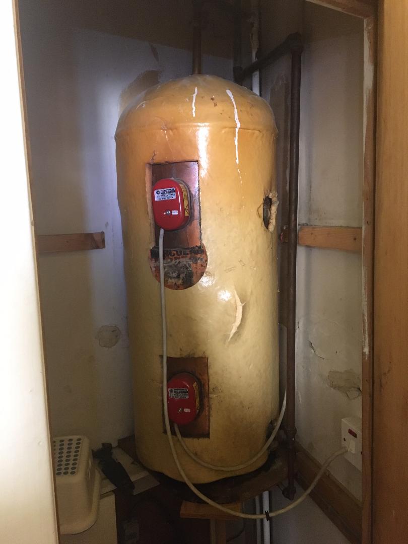

Update - it was an airlock.....attempts to blow this through with the cold feed in the bathroom failed miserably. I then remember that we only have mains pressure in the kitchen so tried there and not only managed to avoid soaking myself but cleared the block after a couple of tries.....thats a relief.
Thanks - tried this with the bath mixer but not getting any noise at all and no progress. Would putting the immersion on and heating the water help in any way?
Hello again...right i drained both tanks and siliconed the leak and then have refilled the attic tank. The cold taps in the bathroom now flow but nothing but minor dribbles from the hot tap. So next question - does this mean the hot tank is not yet filled? If so, how do I ensure it fills? Or is it maybe because I haven't turned the immersion on yet? I expect it is yet another basic numpty thing I am missing but it is kind of annoying as I really need a shower!
Ah ok got you on that. I opened the valve and there is water moving but I suspect that I need also turn off the valve from the main tank in the attic or all that will happen is that it will keep refilling the hot tank!?
Thanks Dave and excuse my ignorance again but if you are right and this is a drain valve do I just need to open that and then the hot water tank will empty without opening any sink taps etc?

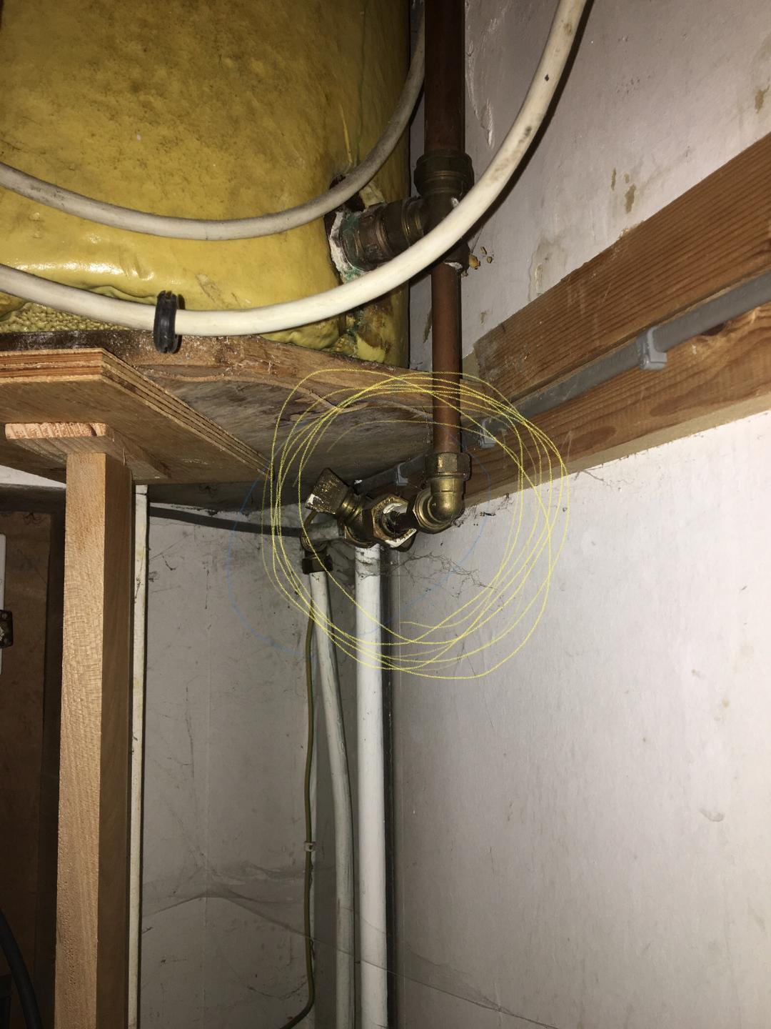

Sorry thought I was finished but one more thing - The LSX stuff says to drain the tank before applying. So next question - how to cut off the cold feed to the tank. I Have attached a photo circling what I think is the valve I need to shut off but confirmation would be welcome? thanks
Thanks for that - I see there still is...Screwfix have it and highly reviewed, this looks like the solution. Thanks again for all help

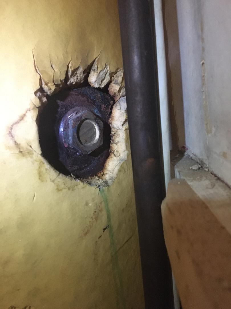

Great sound advice and enforcing my own tuition that the time spent in trying to learn enough to avoid killing myself is probably far too high when compared to the cost of using a pro to do this stuff. I am now focused on two solutions - trying to stop the leak which seems to be from a water inlet? (photos to follow) and continue using the current system or alternatively getting an electrician to hook up with the needed new MCB etc. On the first option, I have tried tightening with a spanner but the nut is corroded in and more force will probably do more damage than good. If there any type of sealant or glue I could use around the thread that would withstand the water pressure? On option two...I will upload photos of the consumer unit..It looks to me that there is room for the required new MCB at the left hand end but would be pleased for an opinion on that. Thanks again.
