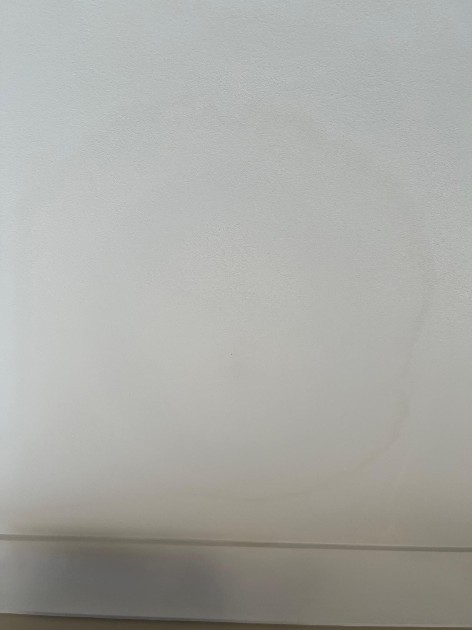

Thanks Folks. I will keep an eye to see if it gets wet again i.e. is the leak still present and when I touch up use the Zinsser product referenced.

Thanks but it's more a question about whether it is common for these stains to bleed through stain block after years have passed.
Hi, Previously we had a leak from a flat roof which was resolved ~3 years ago. It was treated with a stain block followed by a couple of coats of matt emulsion. Today I noticed that there are some brown marks / ring in the same location as previously. The ceiling area isn't damp and interestingly the ring isn't complete and looks faint which makes me wonder if this is the old stain bleeding through the block. Of course this could be the old leak returned but if it were new, would it penetrate the block or make it flake off? Thanks in advance...

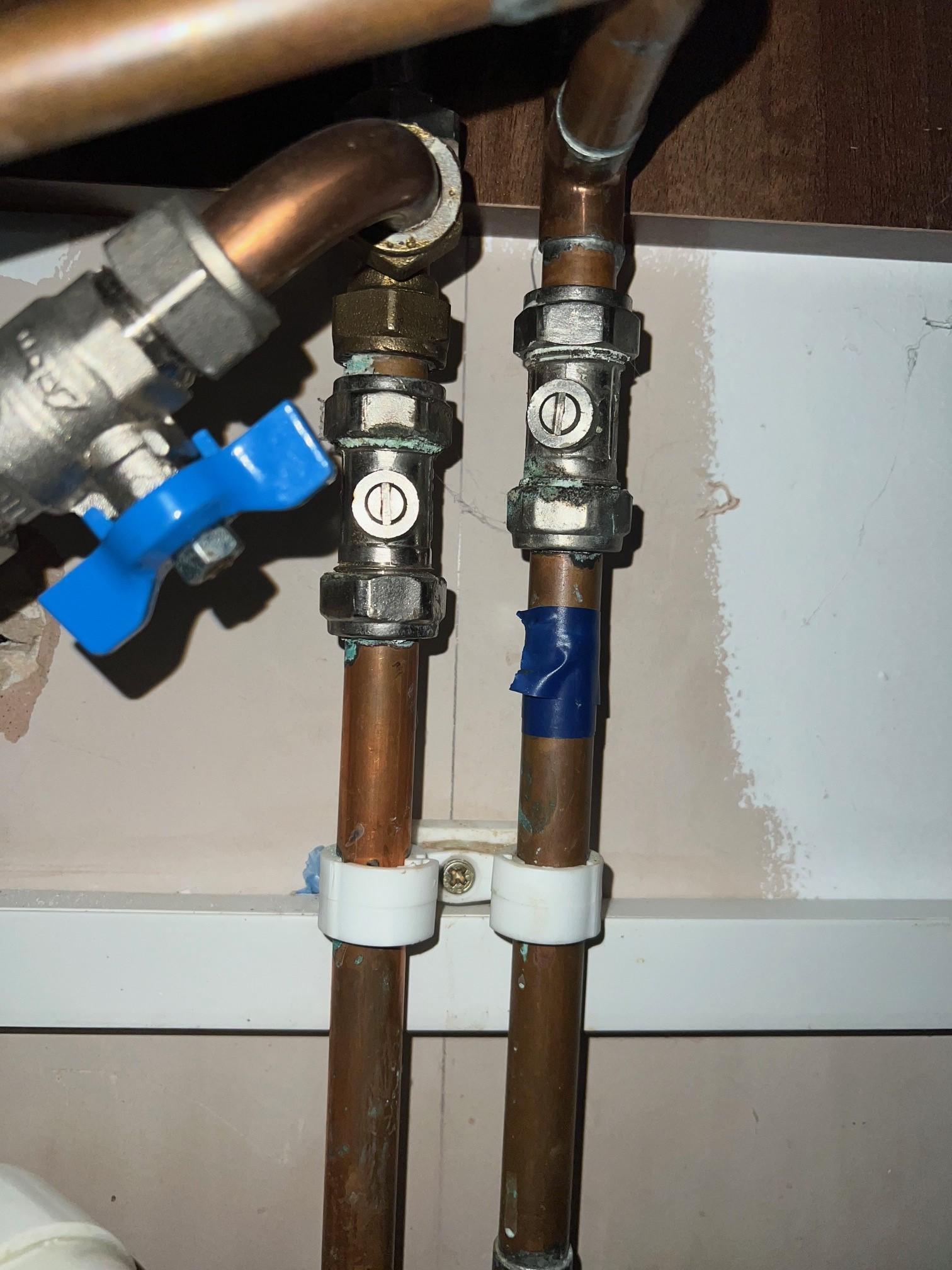

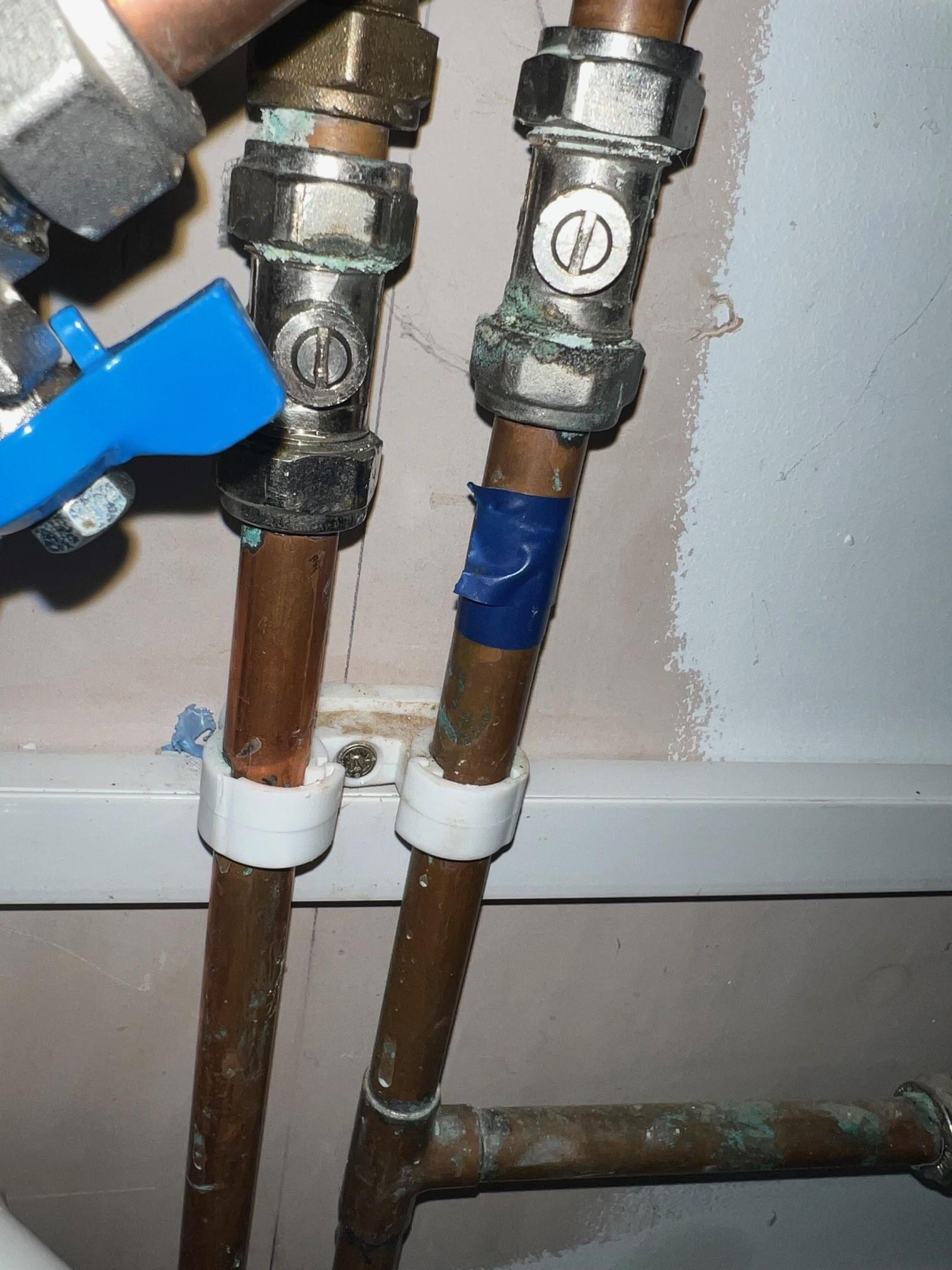

Hi Folks, I am probably being unduly paranoid here but I noticed under our kitchen sink that there is some corrosion evident on a small section of copper pipe between compression fittings on the hot water feed. There are take offs for an outside hot and cold tap together with isolation valves and further up flexi hoses for the kitchen taps. I have a suspicion about what might be the cause... Given the humidity in the kitchen especially when running condensing tumble dryers etc, condensation might be forming on the fittings and dripping down / collecting on the small section of (now green) copper pipe. Although the corrosion is on the hot feed, the water runs cold for quite some time before getting hot as the pipes are buried within the floor. Of course, this may also be an old leak that has sealed itself. It's not causing an issue now but perhaps something I should get my plumber to inspect. My view in any event is that I'd prefer a soldered joint / take off for the hot (ignore the blue handle) as opposed to a compression fitting that somebody has fitted.

That gives me a further degree of reassurance. Thank you.
The ones we do have elsewhere I've looked at and their condition seems fine and they aren't under any visible stress etc.

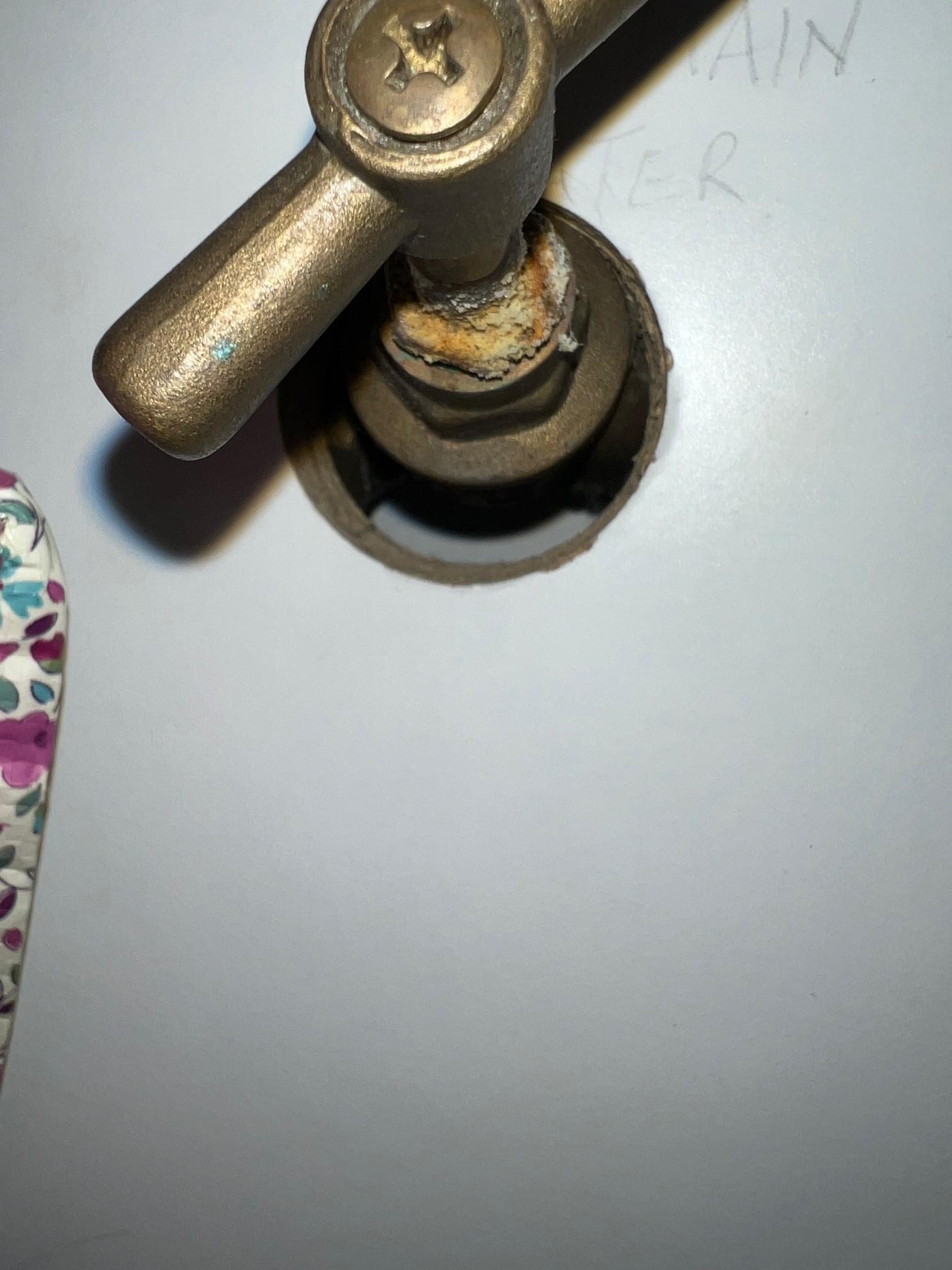

Hi Folks, Over the weekend, my wife insisted that I cleared out a junk cupboard in our utility room, in doing so I discovered a stopcock (that we have never used) had a load of crust around it. It looks to me that at some stage it probably leaked and sealed itself. I've never used it as it's not the main stopcock but rather appears to be an isolator for the extenstion built ~14 years ago. We moved in over 4 years ago and have never touched it and probably won't have a reason to. However, given it's state, I presume that it would be worthwhile getting a plumber to swap it out. Thanks in advance...

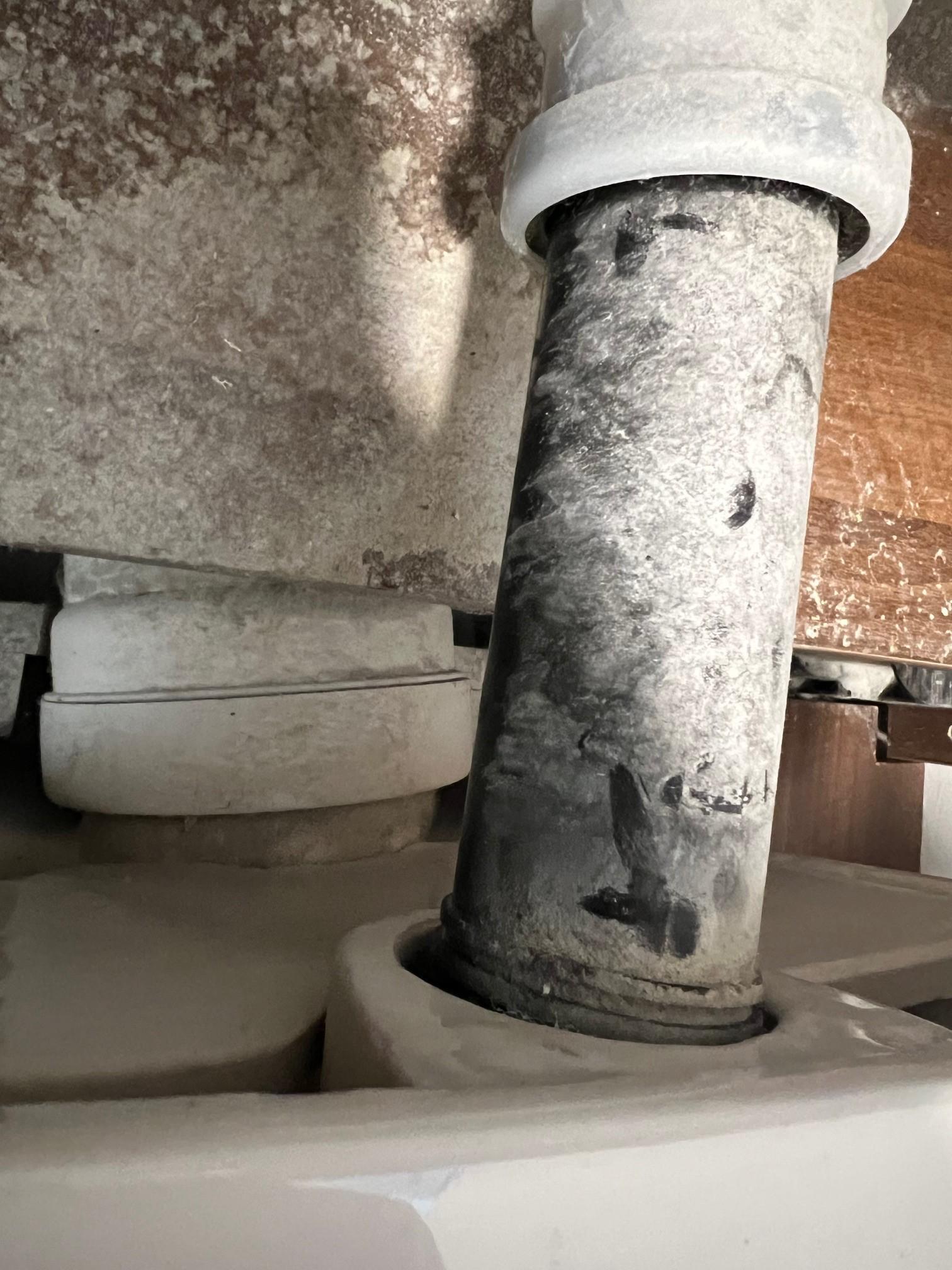

Thank you... It's dry as a bone thus far, no evidence of leakage. I also checked for a weep. I also noticed the plastic cistern leans forward slightly also but it's again clearly been like it for so long I'm going to leave it alone; don't fancy opening a can of worms. Ideally I am sure these should be square / in line. I'm no plumber so will ask my guy to take a look when he is on another job.
I have a pneumatic concealed cistern behind a removable vanity panel. I pulled the panel off to investigate a dull knocking noise when the cistern is coming to nearly full, I haven't ascertained what this might be as yet, I wondered if it was the cold water pipes knocking (as in water hammer) but this wasn't the case. However, this is the first time I've had this vanity front off since living here for four years and I noticed the hose between the toilet and the pan is slightly on the wonk / angle and the connection to the pan looks like the attached photo. This has been fine for over four years we've been here and it's been in place for ~13 years so I am not minded to mess with it but just wondered if this looks normal.
