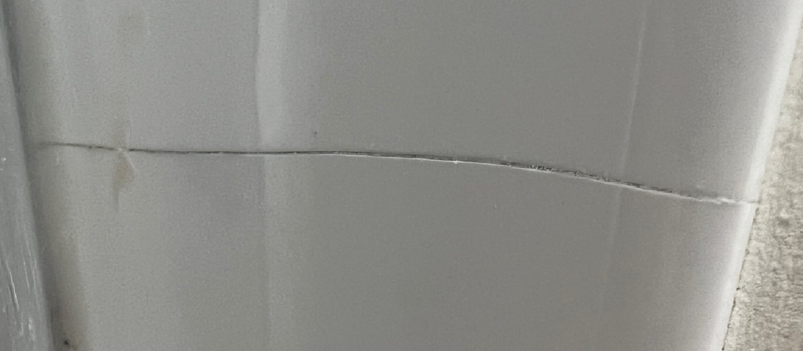

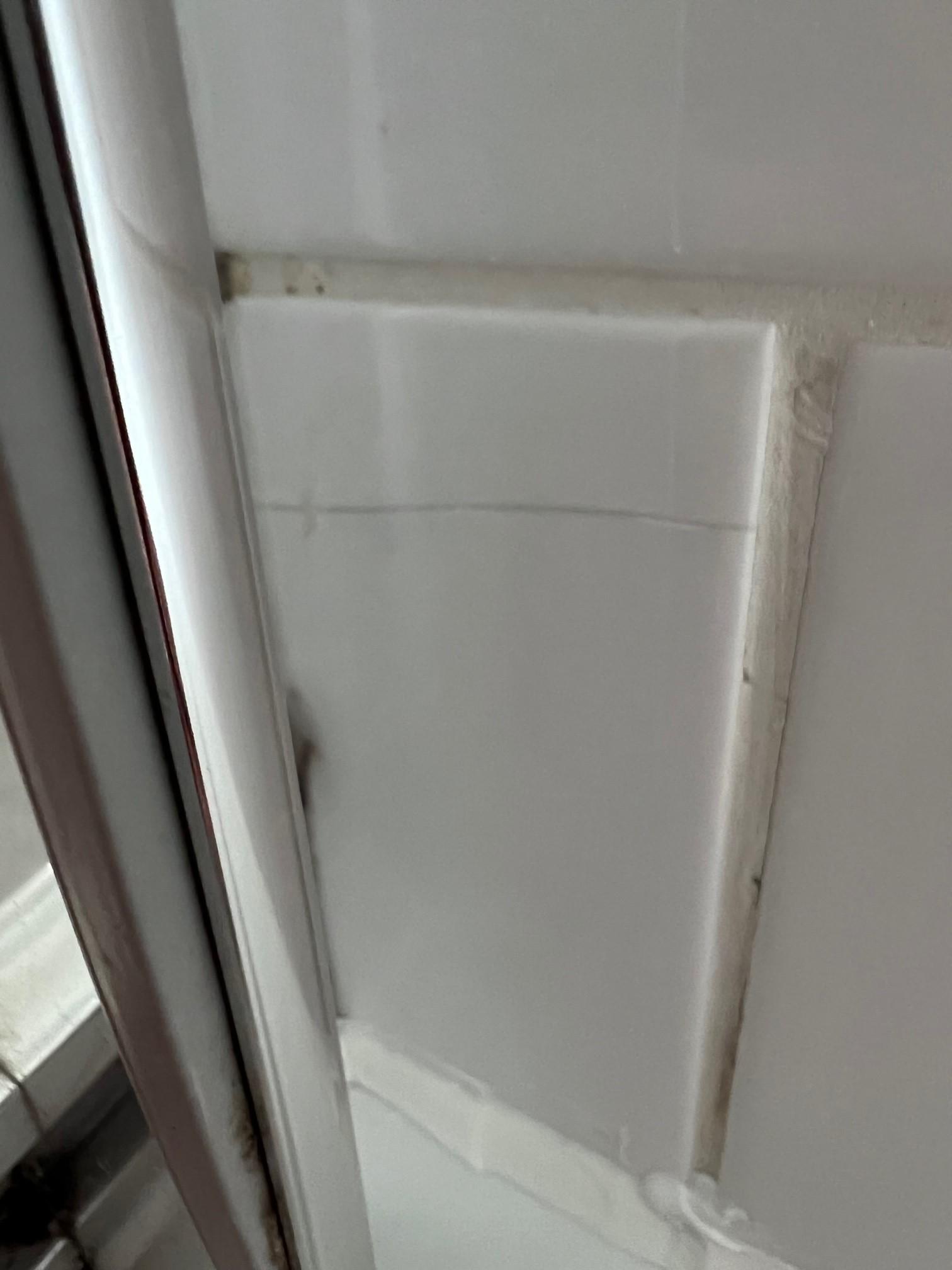

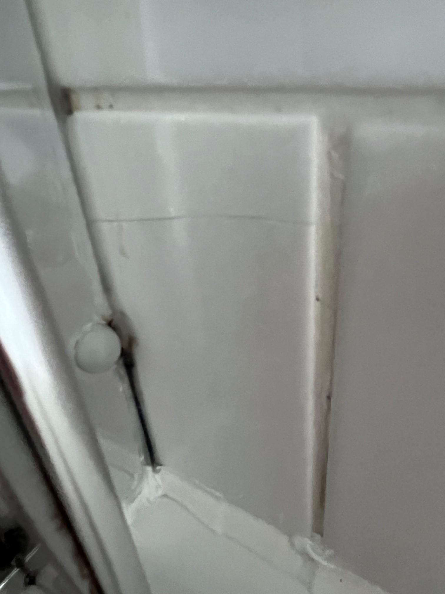

Repairing Cracked Tile in Shower Enclosure
steveoelliott replied to steveoelliott's topic in Wall Tiles & Tiling
My dad in fact offered another suggestion which was to grind / cut back the crack wider and fill with some grout... Probably not the ideal solution as it's either rip the screen off or cut back. The cutting back to profile seems preferable to me. -
It’s not something that I would take on as frankly I am useless at this sort of thing but I do have somebody I could ask. Appreciate your help. -
Tile seems to be solid when I knock on it and not blown. I do think the skirting being installed the other side of the profile caused this as there was a ridge of tile there. -
These are just standard white tiles and I wouldn't be that bothered re match due to where it is... The challenge I will have is finding somebody skilled and willing to cut it out with the profile in situ. I really seem to struggle decent trades and now most only want to do complete refits opposed to these smaller jobs. I had a plumber recently complain about having to refit a Mira shower of mine after some tiling jobs stating that he hates maintenance jobs as they take too much time. My other option is to fashion a repair / seal but figuring out the best way to do it. -
Hi, Today I noticed one of the tiles in my shower enclosure has a crack in per the pictures below... I'm not sure how long it's been there but we haven't been using the shower for months as I keep meaning to get the seals replaced on the vertical uprights. It was whilst looking at these I noticed the cracked tile. I don't want to go down the road of replacing the tile as owing to it's location the whole shower enclosure frame etc will have to be removed to do it properly. As for cause, the only thing I can think of that happened recently was a tiny piece of skirting the other side of the enclosure frame was replaced and maybe whilst being installed the tile got cracked. In any case, we are now looking at how best to repair this... My thoughts have been the following. 1) Apply silicon over the crack. 2) Have heard some kind of epoxy resin might do the trick. 3) Clear nail polish. Now aesthetically it is not a big deal as it is right in the bottom corner. It's more about preventing water ingress. I'd welcome any other thoughts / suggestions. Another way might be to cover this with something so effectively water can't get to it.

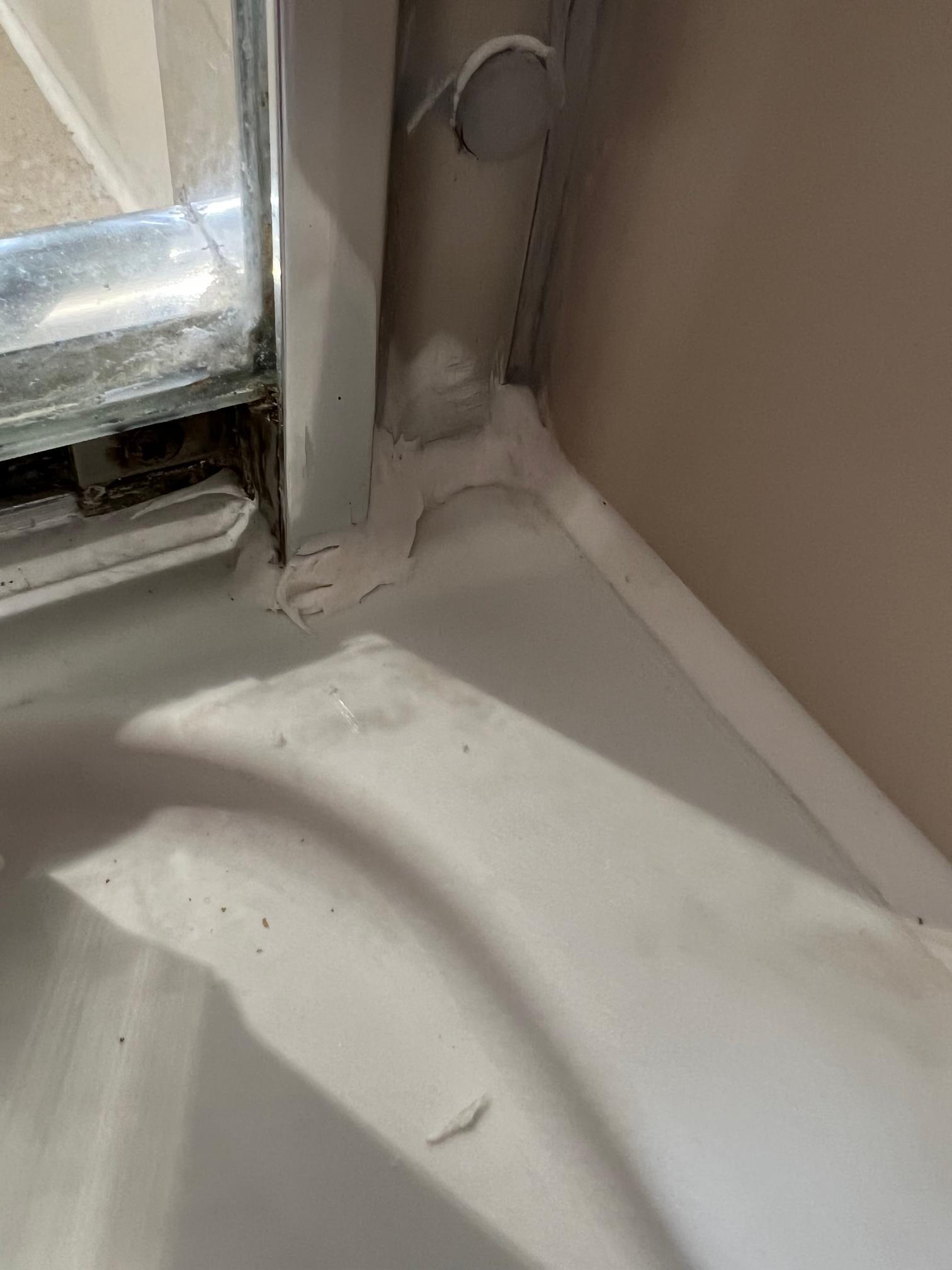

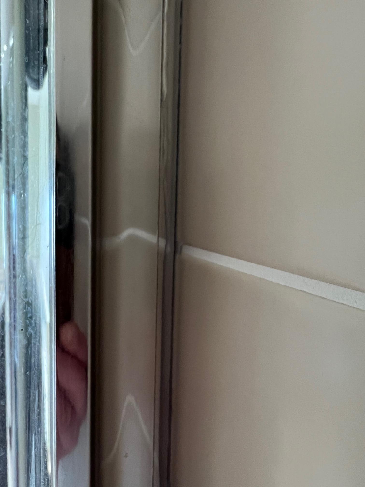

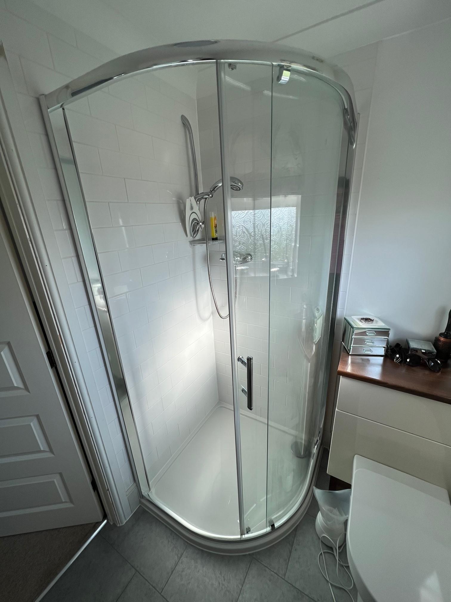

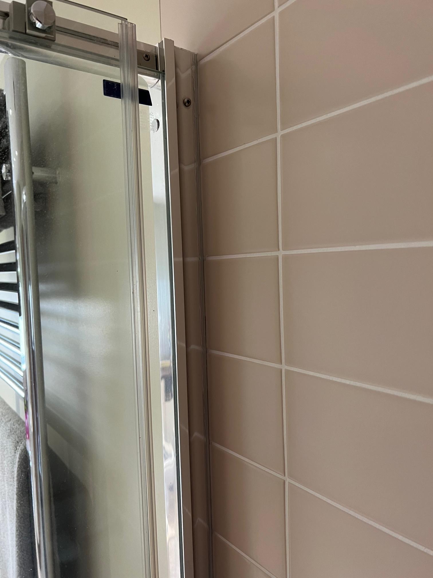

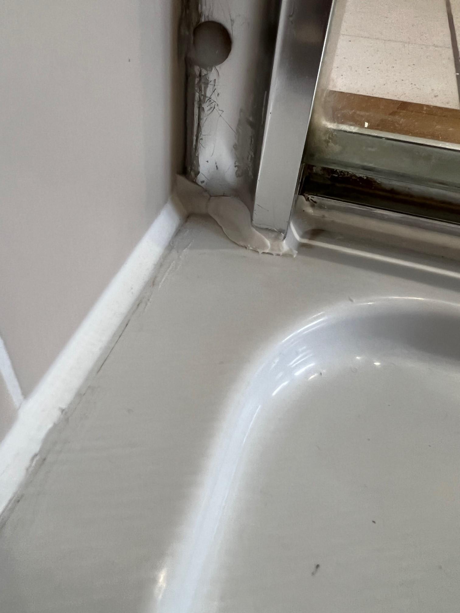

Sealing Shower Enclosure
steveoelliott replied to steveoelliott's topic in Bathrooms, Ensuites & Wetrooms
Thanks... I plan to actually get a local chap in that just does silicone sealing as I'm sure he will make a decent job of it. The concern I have with just clearing the bits from under the door opening is what happens with any other water that may get trapped. -
Hi Folks, I was wondering if somebody can provide some steerage here... having recently had a shower enclosure re-tiled and the Showerlux enclosure refitted, I now know the way the enclosure is sealed is wrong. In part that is down to me as I did ask for all edges to be sealed but wasn't told this was a bad idea. It's only now I realise that very little only the inside of the enclosure should be sealed. The wall profiles had a silicon seal behind them top to bottom as well as being screwed (interestingly prior to being re-tiled these were just screwed). I think this is correct per what I've been reading. Now what I think should happen is all the silicone be removed from the inside of the cubicle (let's start fresh) and then put a bead in the corner and along where the shower base meets the tiled walls. Then on each of the wall profiles run a vertical bead up both inside and outside. The question is whether this should on the inside include the point where the wall compensator meets the frame (see pictures below). I think it makes sense to. I think providing I leave the the rest clear of silicone on the inside, any small amount that may get inside can run back into the tray. How much of the base of the wall profile / compensator should I seal (i'm sure some will say none). Interestingly I've read some posts where folks say seal the lot but then I can see how that may lead to problems. I would then of course seal along the cubicle on the outside only. Thanks in advance...

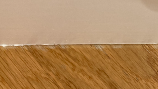

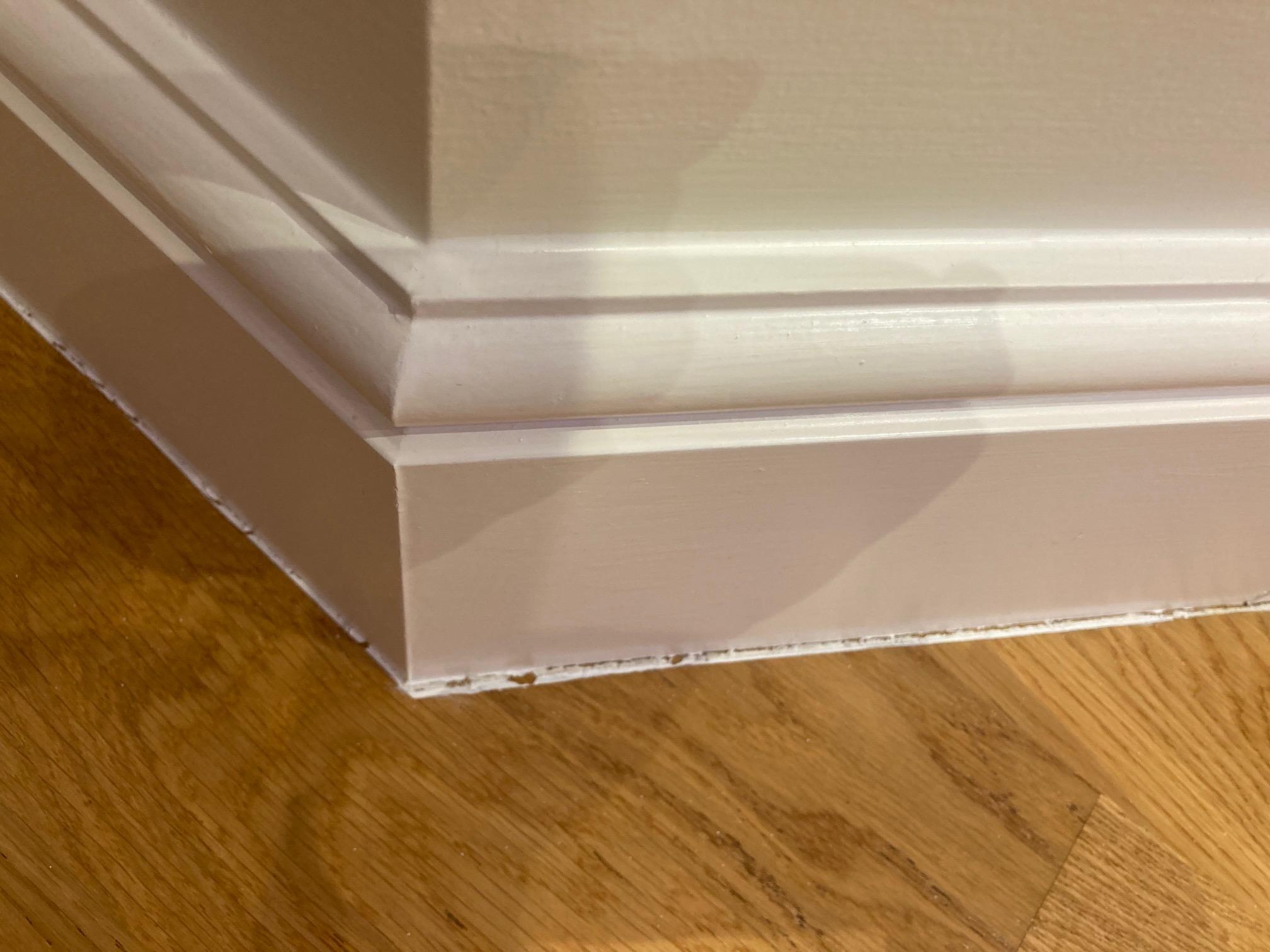

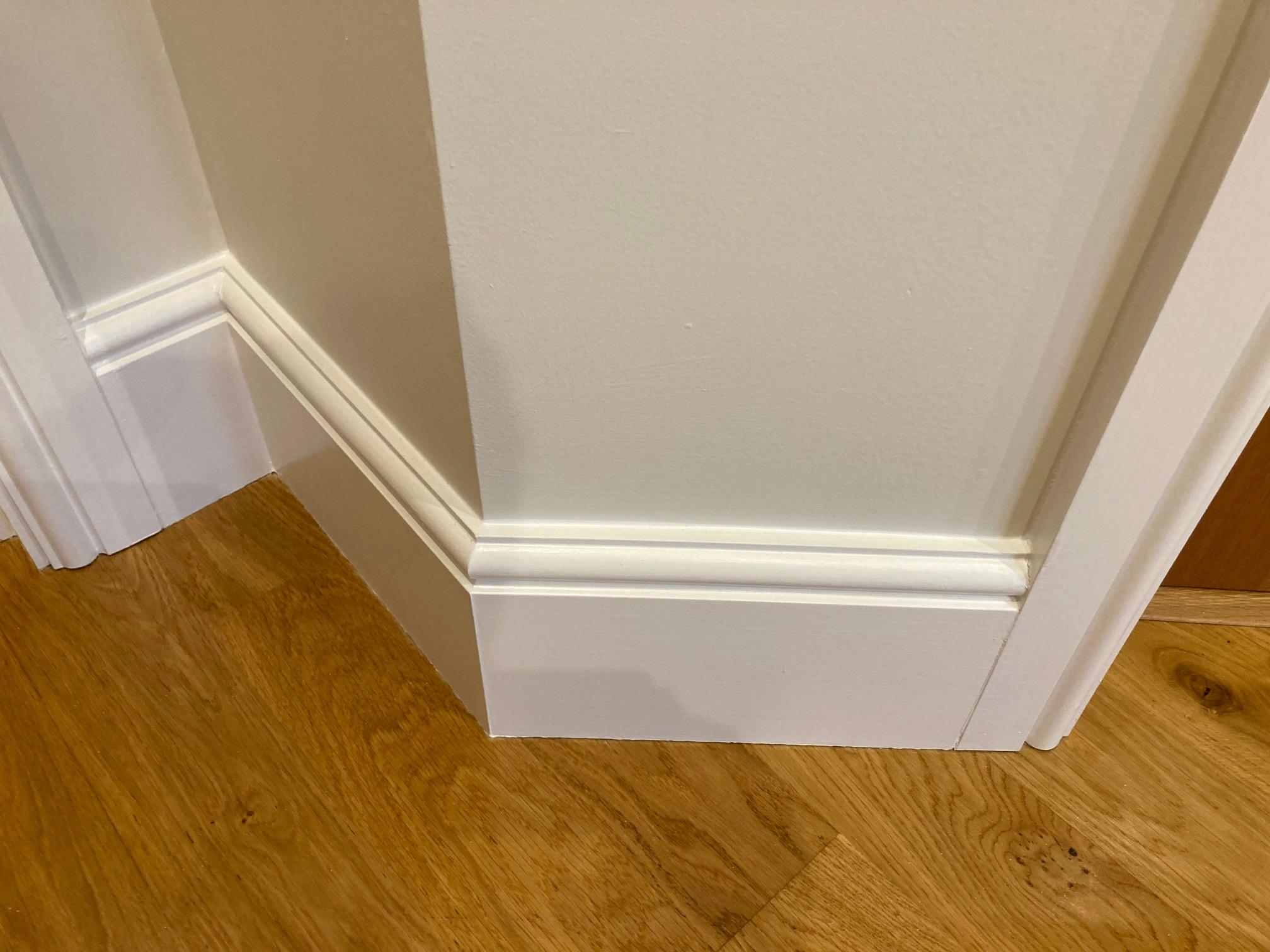

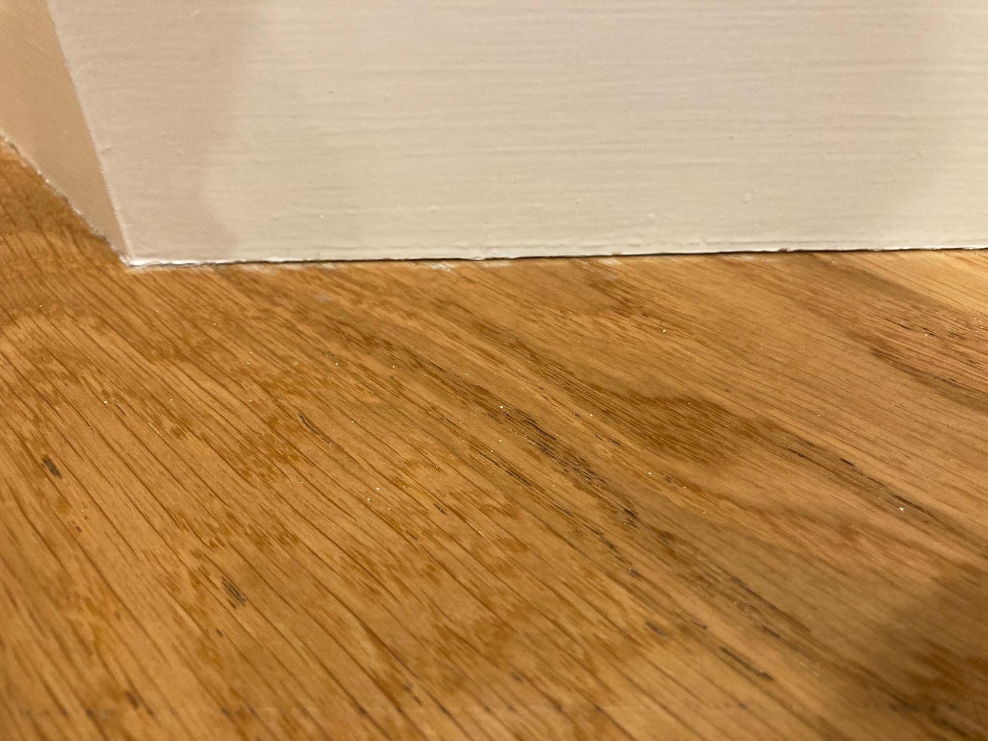

Remove light surface scuffs from wood floor
steveoelliott posted a topic in Wood & Laminate Flooring
methylated So following another post here... I removed a section of caulking between the skirting and my wood flooring as it looked nasty. This isn't laminate flooring and I am told these are wood floors that can be sanded etc. I have noticed in daylight that where the caulking has been removed it has left some marks; either from the caulking or from me scraping it. The later is probably the case. Is there anything I can apply to this as to be fair it just looks like the top coating has been marred. I can live with it if not; it was my wife of all people that called it out lol. Moving forward to remove the rest, I will try some Goo Gone to make it easier... Somebody suggested methylated spirits but I am wary of using that on wood flooring. I have got an area in a store cupboard I can try as a test first though. -

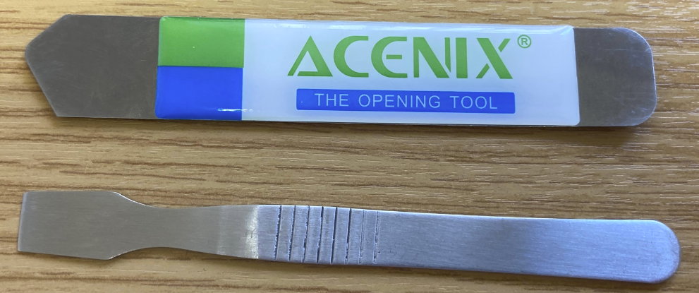

Well... this morning I was up bright and early so figured I try an area with a couple of thin metal opening tools (used for prying electrical things open etc.) I am quite pleased with the results... But I now see absolutely no reason for the caulking being used. This was before: The tools used: I should have taken identical before and after pics but they are the same pieces of skirting... I also did under the architrave on this section too. It took me around 40 minutes for this section so I have my work cut out. I was going very slowly / carefully. I'm sure there are better tools to use but I am wary of marking the engineered flooring. Are there any chemicals that would be safe to use to make this job easier? I have an area in a cloak room I can use a test first.
