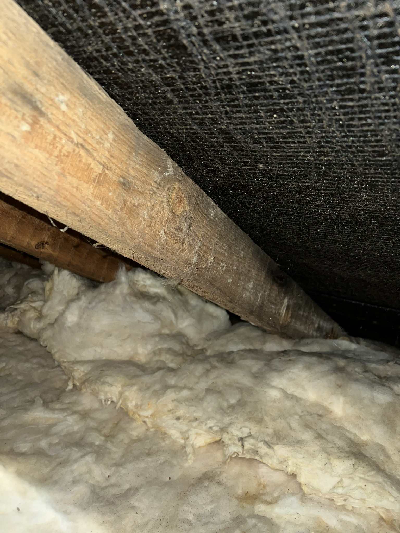

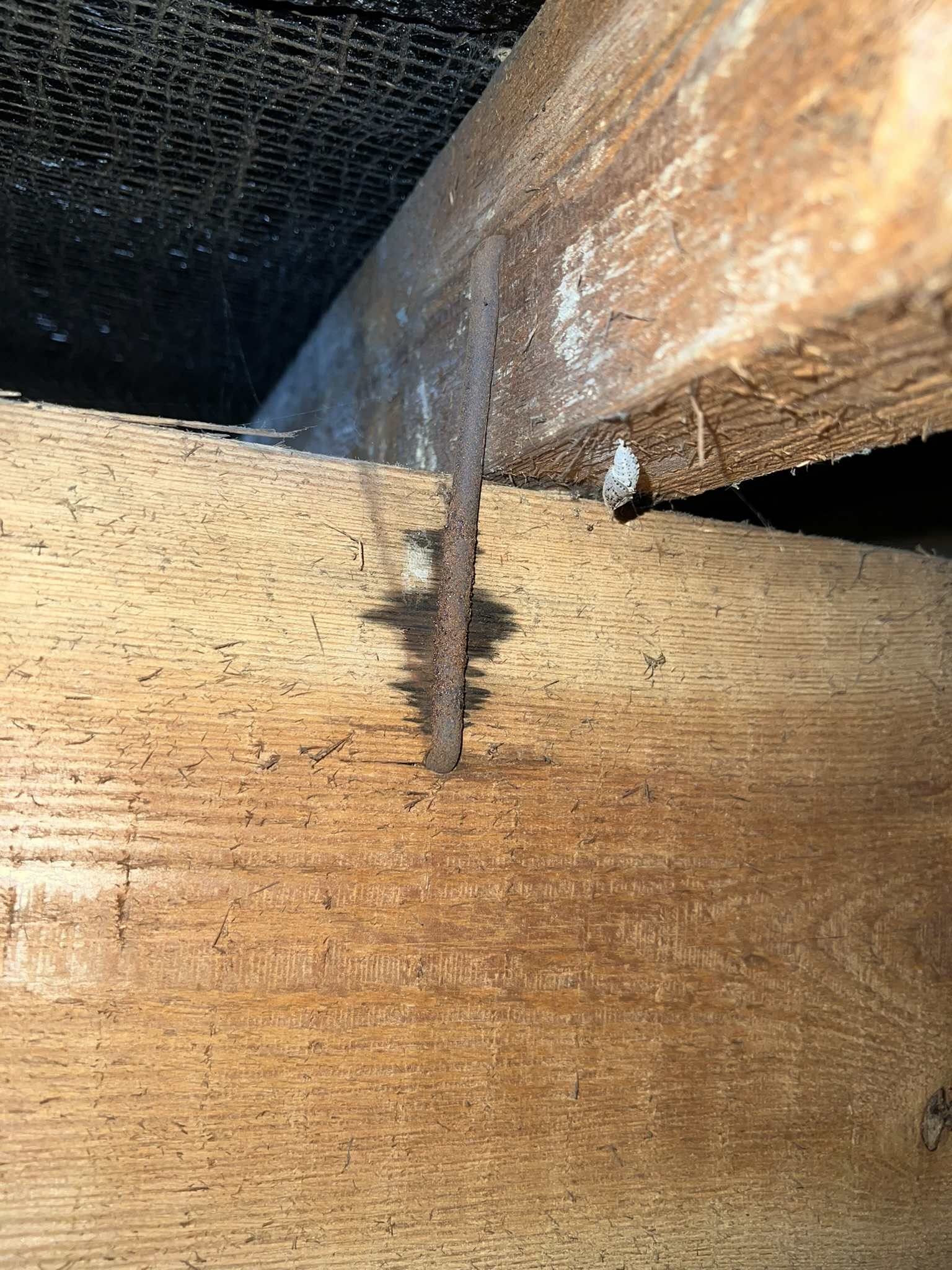

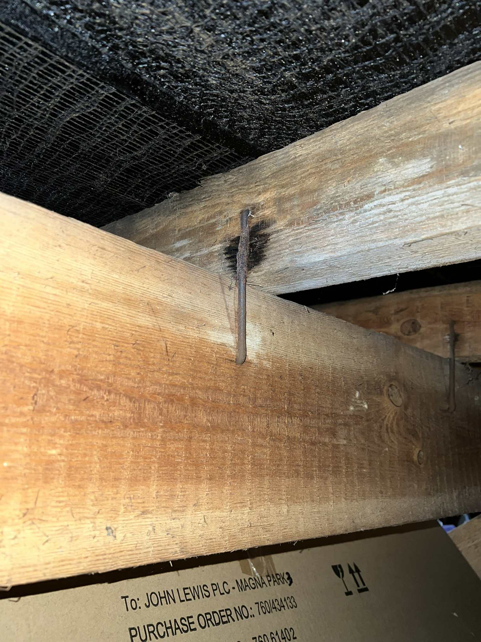

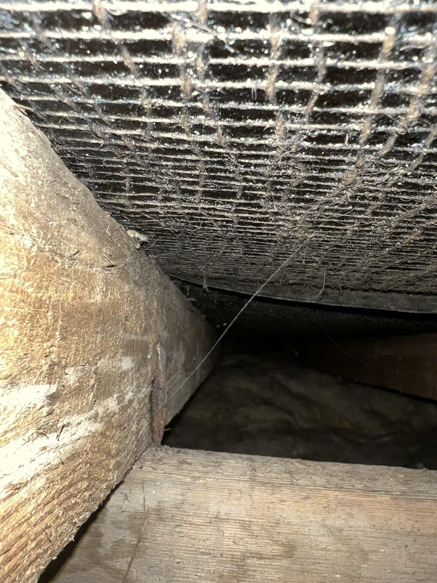

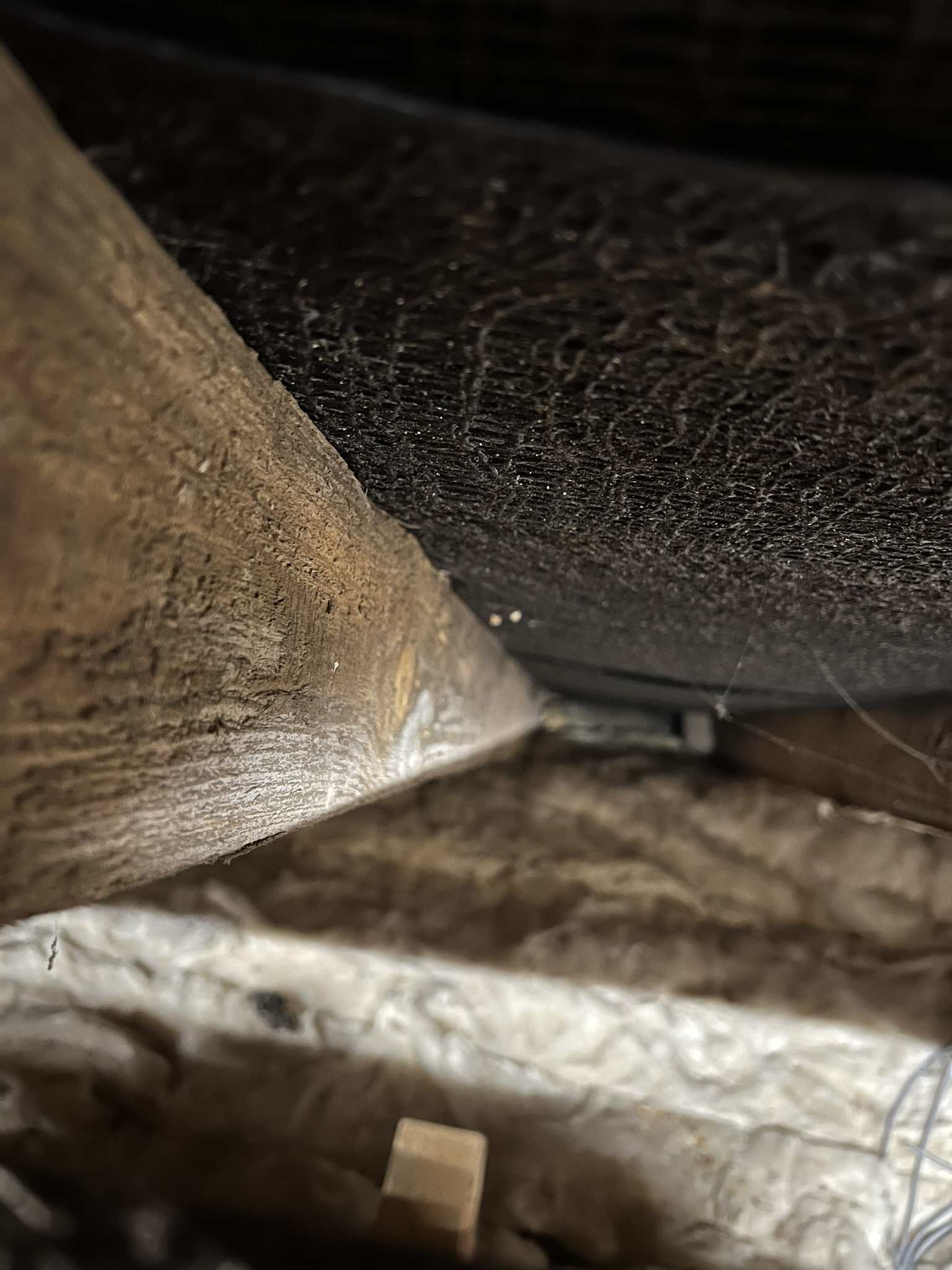

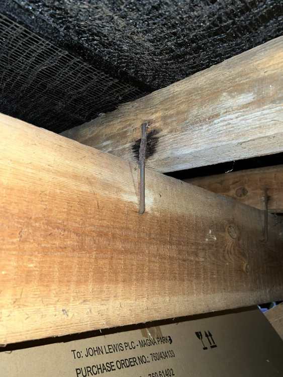

  18. At which location? Between the reducing valve and EV or on the hot water outlet? I can't seem to find a pressure gauge that doesn't come as part of a PRV block.
  19. A week on, this hasn't so far got any worse but it doesn't happen every time the hot water in drawn. For the purposes of testing, I always use the bath hot tap, opened fully. As an example, I drew hot water right after the heating cycle for ~10 seconds, no noise. Repeated the process after 30 seconds, no noise. On the third go, it made the noise a few seconds after drawing hot water. This to me rules out expansion and or pressure. Since they would be much higher / worse after the initial heat cycle. Baxi and my own plumber are at a loss to what this might be.

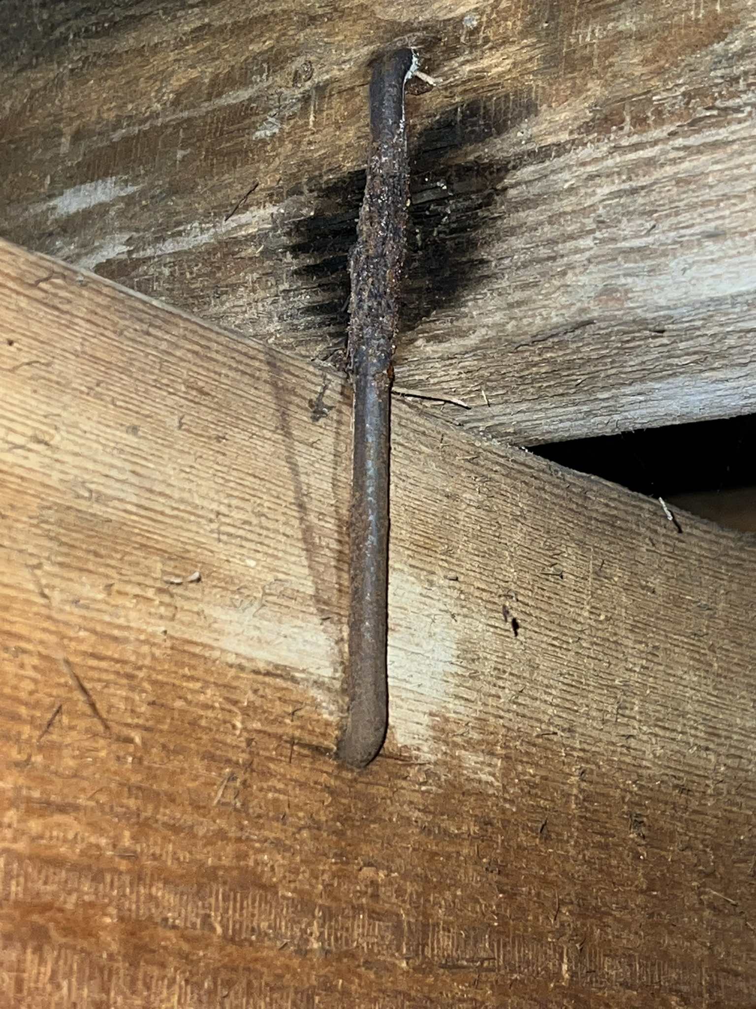

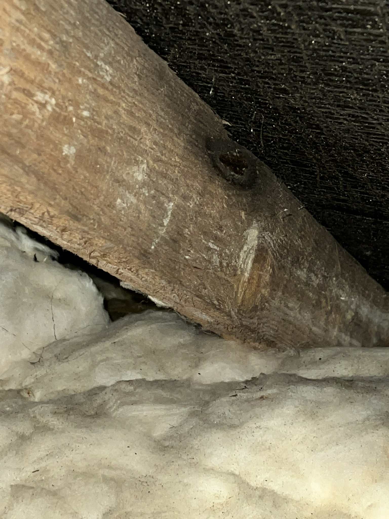

  21. Thanks… It is breezy up there and the roof doesn’t sweat like it used to in our old 90s build. Probably just being paranoid.
  22. Thanks. Those are readings from pushing prongs into the timber rafters. However, they don’t look or feel damp.
  23. Hi Folks, I have a 1960's house with concrete roof tiles with recently rebedded ridge caps (2022). All roof tiles are in place from the outside and nothing obvious from visual inspection. Whilst in the loft I noticed what is obviously the result of dampness to a some rafters on the north facing side. They don't feel damp to the touch but are cold to touch (unsurprisingly). I have a cheap moisture meter with prongs I got from Amazon and that is reading the moisture level between 25-33%. Other rafters in the same loft space range from 11 to 16%. There is no evidence of water ingress and the loft is mostly boarded with lots of cardboard boxes etc. up there. It would be very obvious if something had been leaking, especially with recent weather. I took some pictures of the worst truss and the nail thing that holds it down has clearly suffered from corrosion as a result of the doubt (I don't know what these fixings are called) but I just can't see how these trusses have come to be wet. There is sarking behind the trusses so even if there were a loose tile or water blowing underneath, the sarking would prevent it coming into contact with the truss. I could just be worrying too much and perhaps this is the result of humidity within the loft space but it just doesn't seem that damp in there. Thanks...
