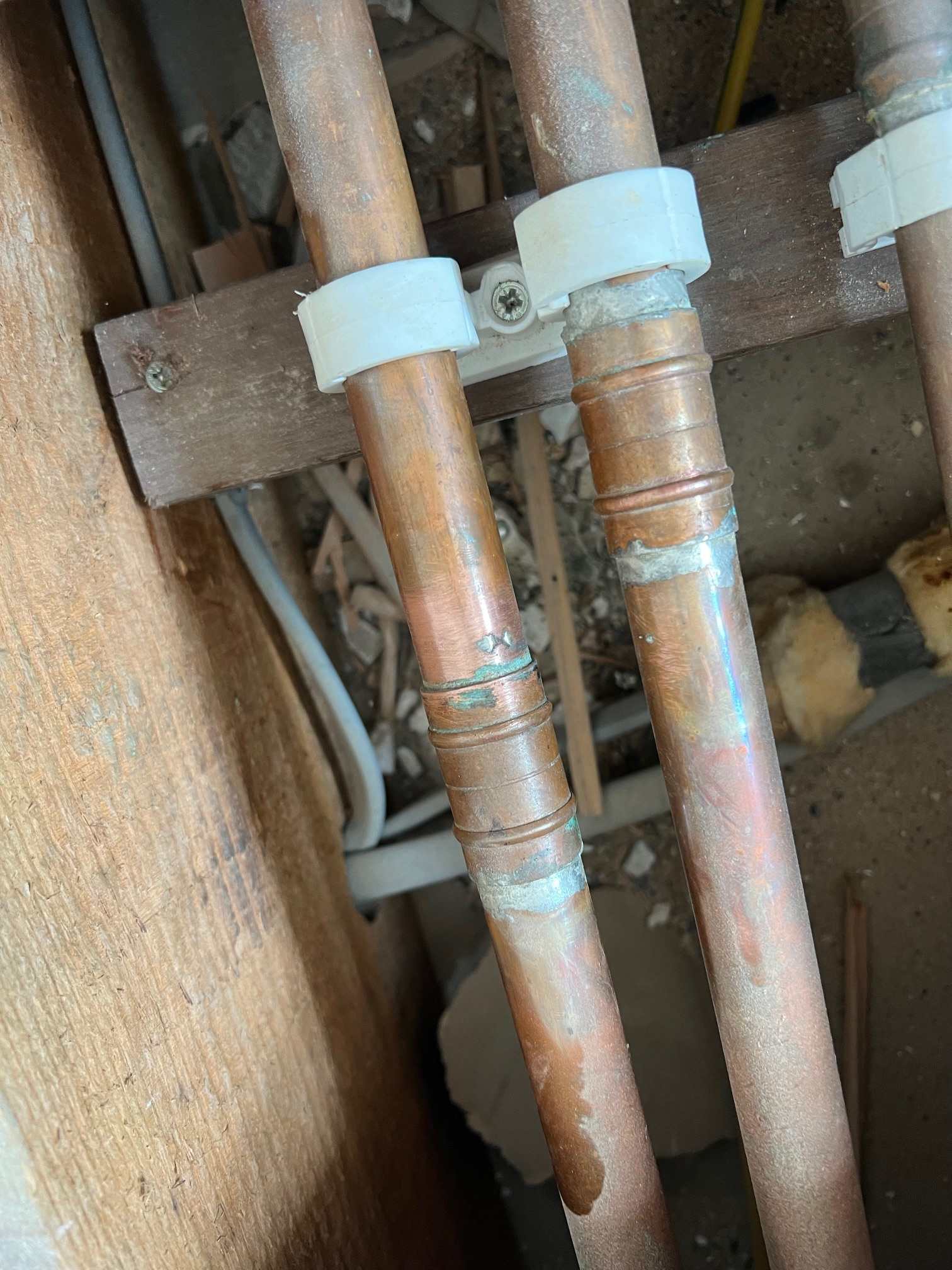

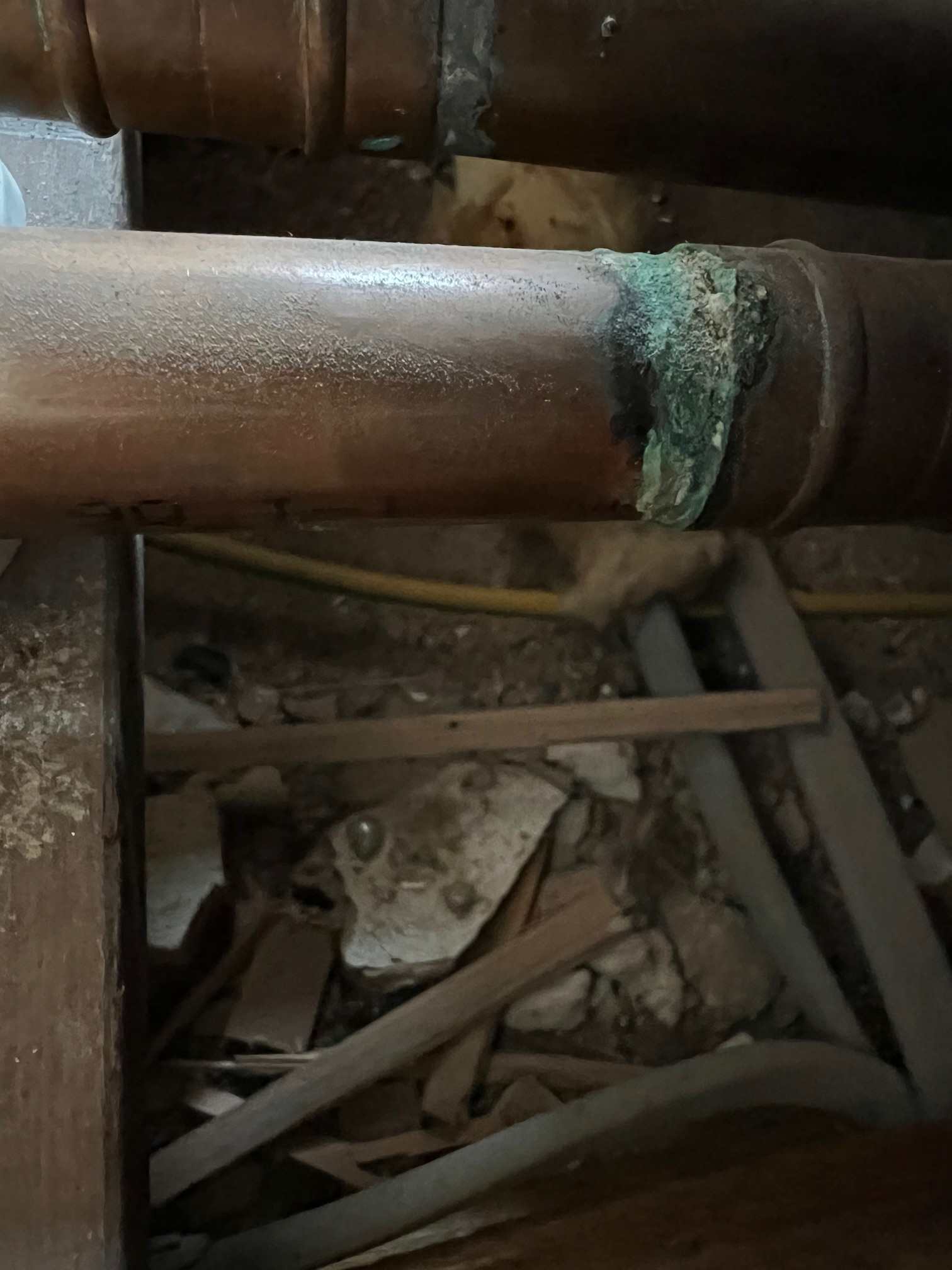

It’s on a central heating system with pump. Pressurised system. I’ve asked my plumber to come and redo that join. Might be being paranoid but I can’t ignore it lol.
Also whilst I am at it, to replace a cracked 18mm T&G board, what should I use? I have 18mm MDF but apparently this isn't suitable.
So, whilst dealing with a couple of loose floorboards, old school tongue and grove type, I lifted one to find this joint which looks to be corroded / leaked at some stage in it's life. It's probably ~15 years old given that was when the previous owners renovated. I've asked my plumber to come take a look and redo that joint. It's on the CH system. Whilst it's not leaking now, i'd rather deal with it before getting the carpet laid and room back together.

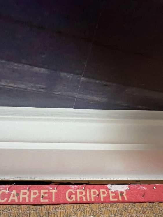

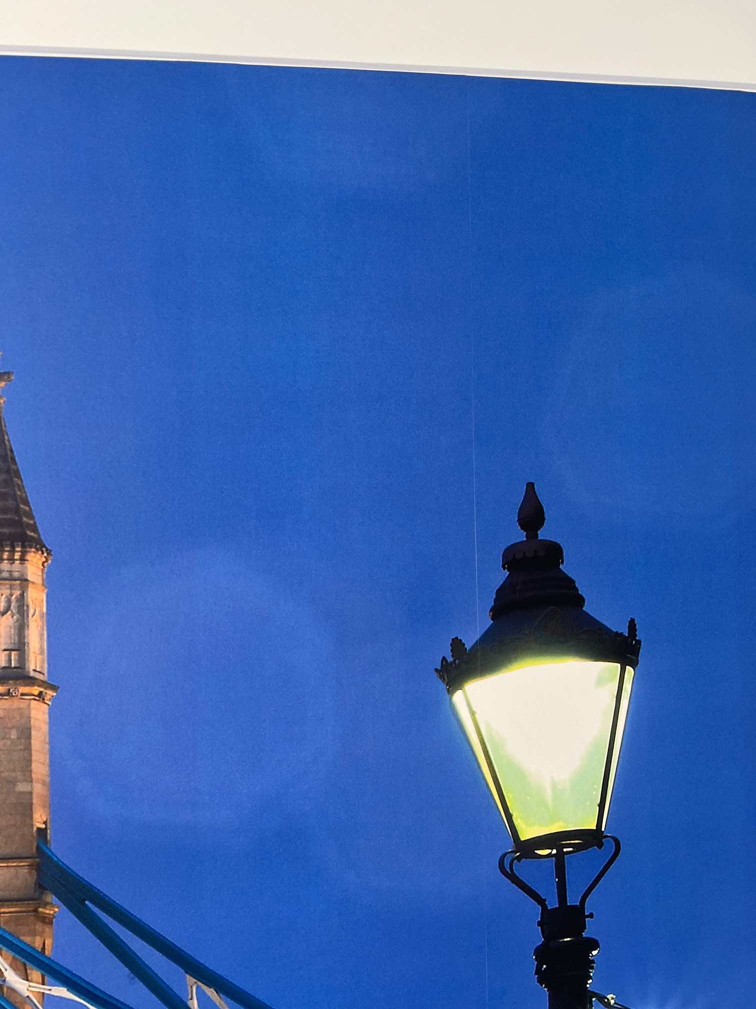

A small bedroom / office. They don’t sell this one now but do similar ones.

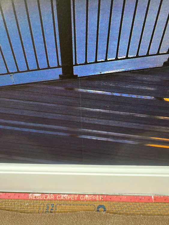

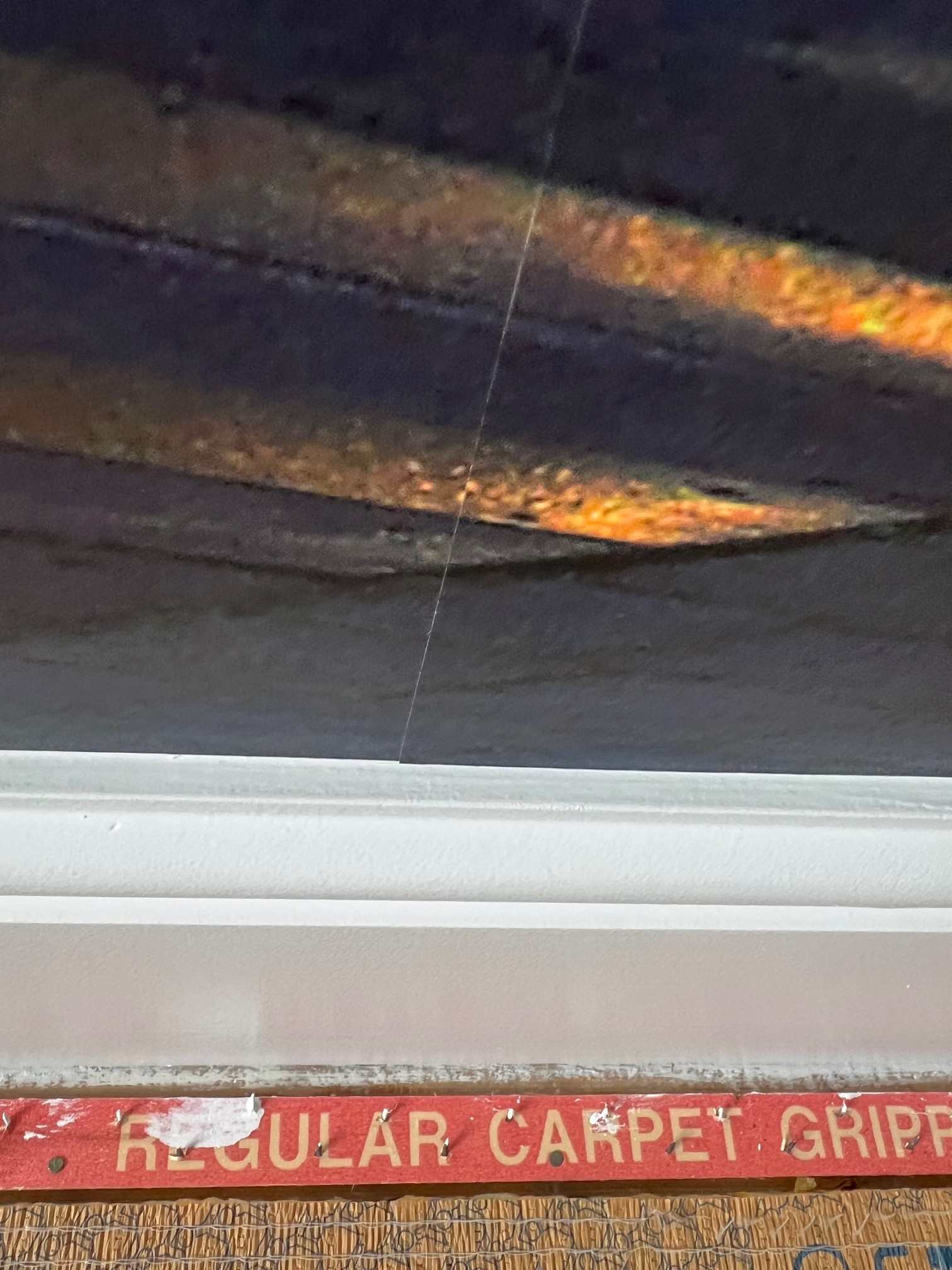

If I am being unreasonably picky. Please just tell me. I have broad shoulders.
The noise isn’t a major concern. But something that I did indeed notice however that can’t be controlled by installation 🙂 in terms of shrinkage this was paste the wall.

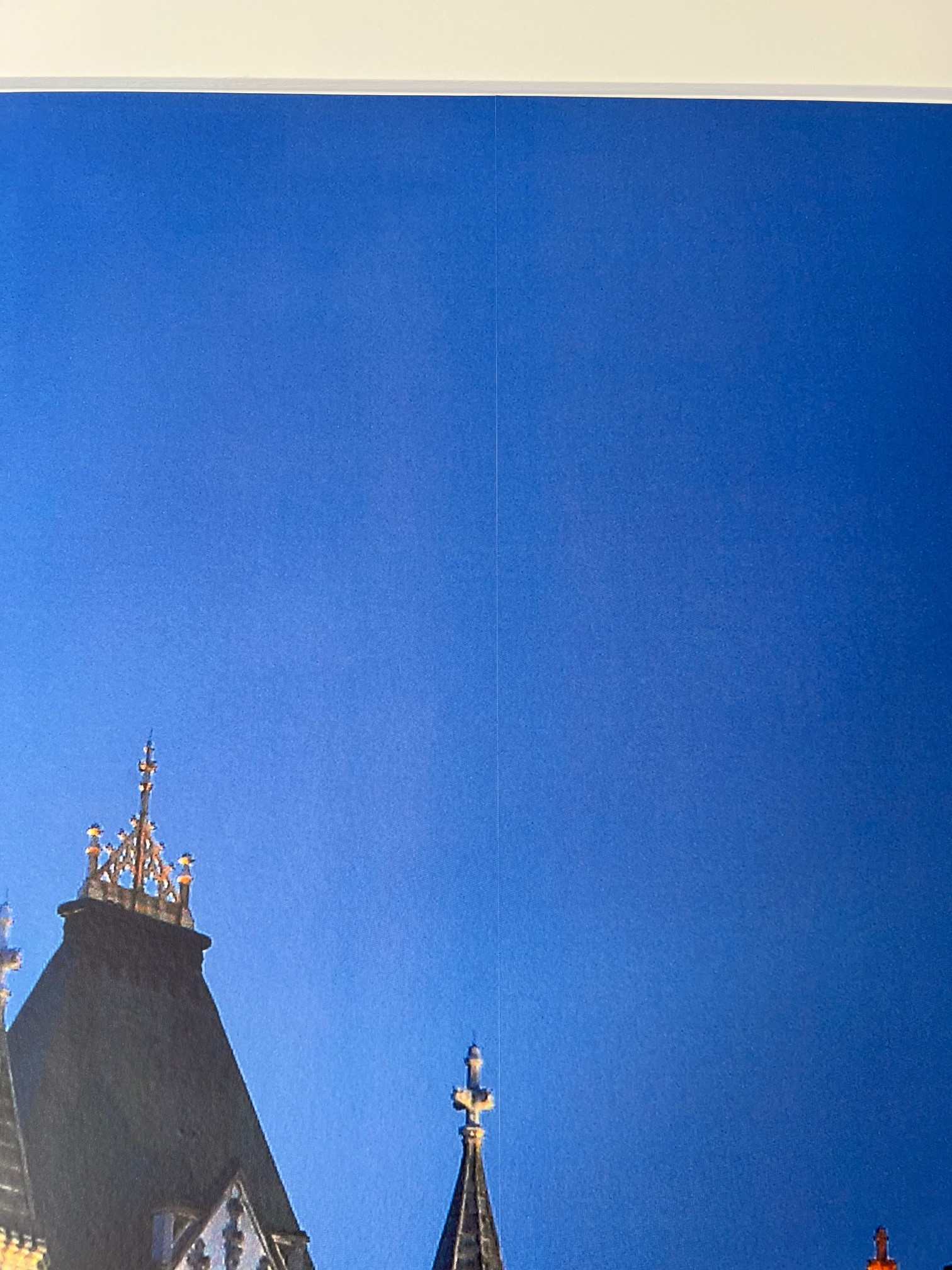

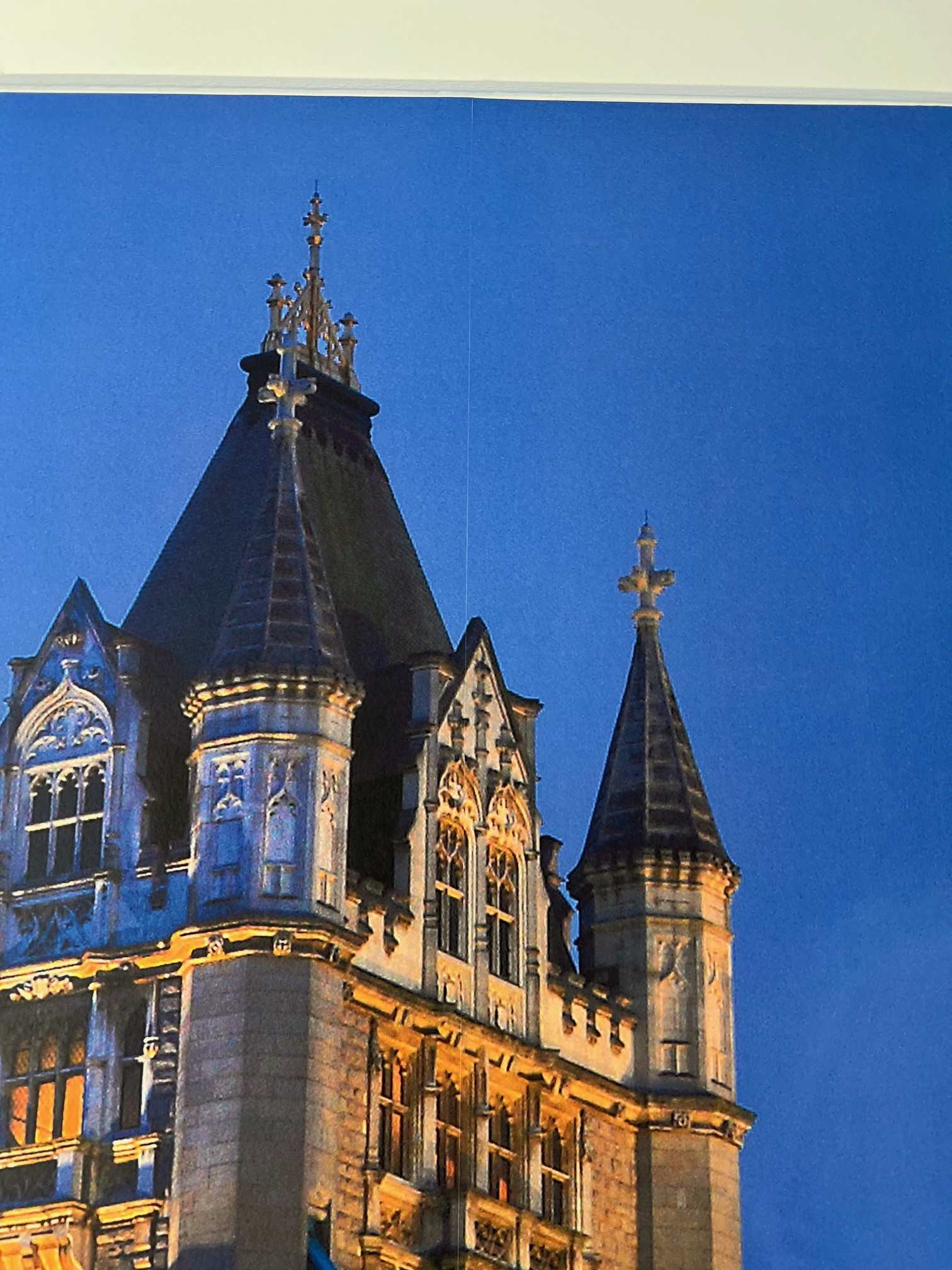

Hi Folks, I purchased a mural from Photowall and had our decorator hang it for us. Unfortunately after he left and I took a look, I immediately noticed gaps / lines along the edges of the paper. I figured I'd give it 48 hours to dry / settle but it's still the same. I raised this with Photowall and they told me 95% of their customers have flawless results and that this must be down to the installation. Not sure I buy this yet. Anyway, I do intend to flag this to our decorator but there isn't anything he can really do now it's up. I am just more curious as to whether I need to consider somebody else to hang any future murals or paper. He has been very good on the two jobs he has done so far and proclaimed to really enjoy and excel at hanging paper. What I don't want to do it be overly picky or critical of anybody. One other observation is how the paper sits on the skirting. Rather than being uniform on each strip, some of it steps out marginally. Having never papered, I'm not sure if this is normal of me being pedantic / unrealistic. Appreciate your thoughts and insights. It's certainly not bad enough for me to want to strip it and redo but it's irritating when you know it's there.
