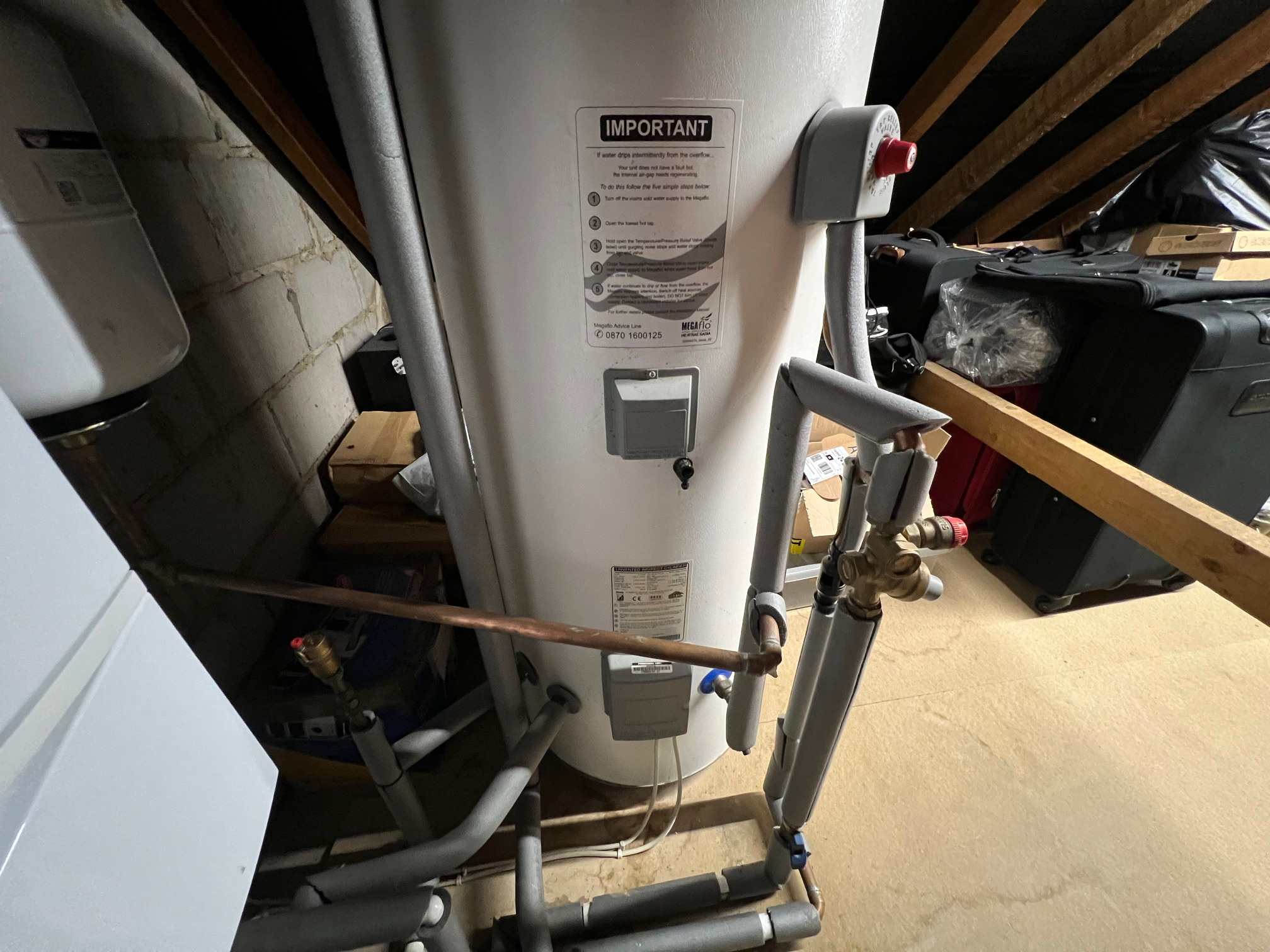

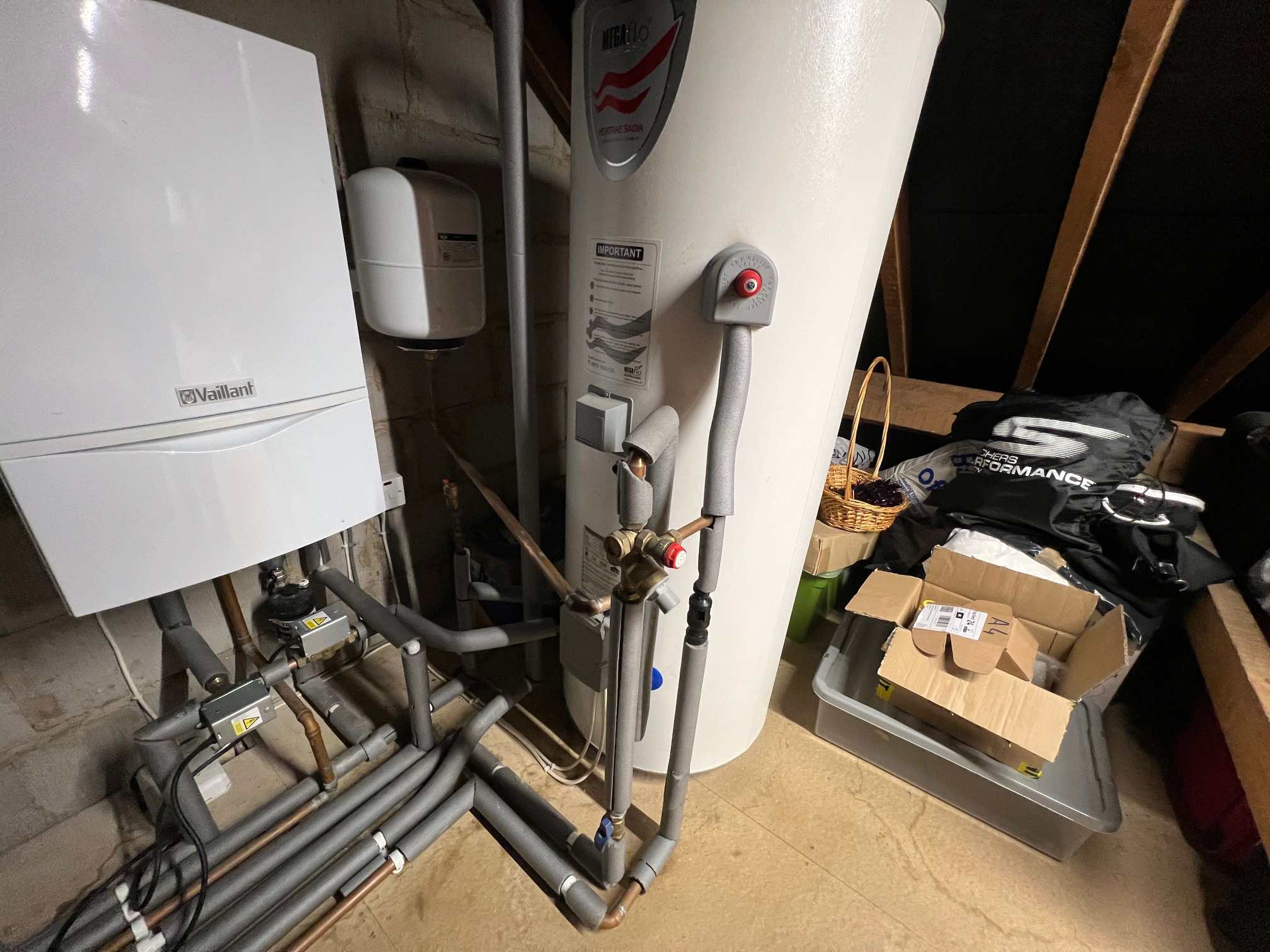

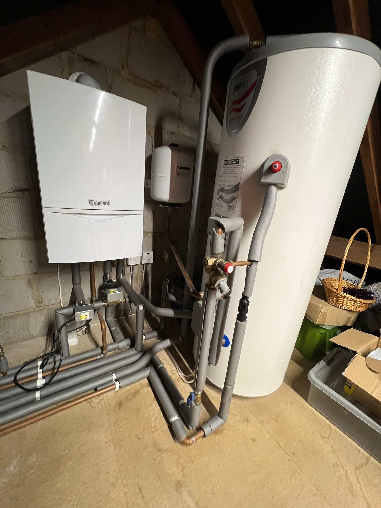

@John Carroll Thanks for providing the spreadsheet. Quite interesting and clearly you understand this topic well The PRV was replaced yesterday afternoon. In terms of the increased pressure, it isn't just on re-heating cycle or overnight. It is consistently much higher than it was before. his led me to believe the old PRV was faulty / blocked in some way. The new PRV is a genuine Baxi / Heatrae Sadia part. https://www.screwfix.com/p/baxi-95605894-inlet-control-kit-comp-3-part/187GW?gclsrc=aw.ds&gad_source=1&gclid=CjwKCAjwl6-3BhBWEiwApN6_kgqdF7Smm3DfsRkfvSYrULnx0A1jc4QSjXFsD4xwVVyVb0AqxJ-mCBoCG4AQAvD_BwE&gclsrc=aw.ds When I say increased pressure, I don't mean 100% more or even 50% more pressure but it is noticeable from what was there before. As an example, around 9 months ago I thought our pressure seemed low, my other PRV was showing 1.5 bar dynamic pressure, I happen to know a local senior engineer at Anglian Water who came and replaced our water stop in the road as it was "old". Once replaced, I was getting ~2 bar dynamic pressure, that was definitely noticeable. The other PRV on the stop tap isn't probably necessary for us given that dynamic pressure never seems to be much above 2 bar but then one day it might be! In terms of your question on the gauge on the stop cock PRV, with a tap open / flowing pressure ~2bar. Once switched off anywhere between 3 and 4 bar but it's instant the moment the tap is turned off and stays there. Might drop and increase a little but that will be in part due to fluctuations in the supply I suspect. In terms of the bubble / air gap. If the baffle is disintegrating, I doubt there is any value in going through the process. The external EV "should" deal with expansion from heating cycles. Assuming the bubble was operational, I wonder what opening the T&P valve does after the lowest tap has stopped? I was also curious as to why you leave a hot tap on when refilling the cylinder?
@John Carroll I can confirm that labeled pipe is the EV outlet. When checked ~3 weeks ago the EV pressure was 1 bar and we increased it to 3 bar. I have another PRV on the cold mains set to 3 bar but with a cold tap running it's just under 2 bar. There certainly is no issue with backflow from mixer taps. The pressure generally from the hot taps is much better than it was prior and I suspect this may be due to the mesh being partly blocked / defective PRV. We know that was faulty as replacing it solved our issue. The bubble on the megaflo is knackered... I had deposits of it coming through taps, caught by the mesh on taps, hence the external EV. This was also confirmed by BAXI. I wonder if there is still any benefit going through the bubble recharge process even with a knackered baffle. I suspect not.
@John Carroll @JohnMo @ProDave Firstly @John Carroll, the EV is the other side of the combination valve. For the benefit of all that advised, this issue appears to now be resolved following the replacement of the PRV block. The one that was on the system was a Caleffi and not a genuine part (it worked fine for years) so I opted to swap with a very expensive set from Baxi which cost £204.00. My plumber did the work earlier today, cylinder was drained, he replaced the PRV with the new one and refilled. So far, no noise on tap opening. It got the point it was happening every time the hot tap was opened unless done very very slowly. One thing I noticed right away was how much more pressure there is when using the hot taps. It wasn't bad before, but now when opened, the pressure is much higher and it tails off after sometime. I actually remember it being like this a long time ago but hadn't notice it drop. With the old PRV block out, I decided to have a look at the mesh filter. It was impossible to pry it out and I had to force it out by ramming a screwdriver down the edge to lever it out. On one side of the mesh there were some crusty deposits so it could be that this was part of the problem or contributing to it. If a cylinder is serviced annually, I guess these filters are cleared but speaking to my plumber, very few people bother. I have another adjustable PRV by the main stockcock with gauge (this is also Caleffe), this provides a balanced cold. I may now with the knowledge from the other have this mesh cleaned or may just opt to swap it completely in case it leaks after being dismantled. Thanks all for your feedback.
Yes I have one of these. Thanks for your analysis... 1) Whilst the EV is not connected to the output on the Calefe combination valve, it is (to my knowledge in the right place and doing it's job). It is notably not a genuine Baxi component. 2) The insulation is on my to-do list. 3) Discharge pipe from tundish, that's interesting as I wasn't aware of this but having said that when I have gone through the process of attempting to recharge the bubble in the past, it has worked fine with no problems. I appreciate it may not be to code though. The total length of the pipe is way longer than 9m as it goes from the loft, behind a stud wall, across a side / lean to extension and then outside. Having said that, when Baxi came out themselves to check the bubble, they never commented on this. The guy even went as far to say it was a good installation. The issue with the noise in the video now appears to happen EVERY time a hot tap is opened. It has got worse. I sent a video to Baxi and my plumber and both believe it to be a faulty PRV set. I am therefore pending a genuine Baxi one to arrive and my plumber will then fit it.
Around 60, not too hot. The tundish is dry. I check this every time I go in the loft as a matter of course. The bubble on mine has disintegrated, hence the external EV. A while ago Baxi came out to check and confirm the bubble was disintegrated and as part of this they checked the installation. They said it was fine. They no longer swap cylinders but offer to put a strainer on the hot side to catch debris, I declined as not had much of an issue with it and a strainer on the hot would just get blocked. I would be surprised if the relief valve was opening as bearing in mind this happens when a hot tap is opened after a heating cycle so pressure is effectively being relieved.
Hi, I have noticed that when a hot tap is opened for the first time after a heating cycle (in this case a bath tap), the water flows for a couple of seconds and then there is a very loud noise as can be heard in the video. Any ideas what it may be? The EV was recently checked and pressure increased from 1 to 3 bar per instructions but notably it did this before. I just at that time didn't know the trigger. It hasn't always done this however, probably the last couple of months or so. Thank you. Img 4357-1.mp4

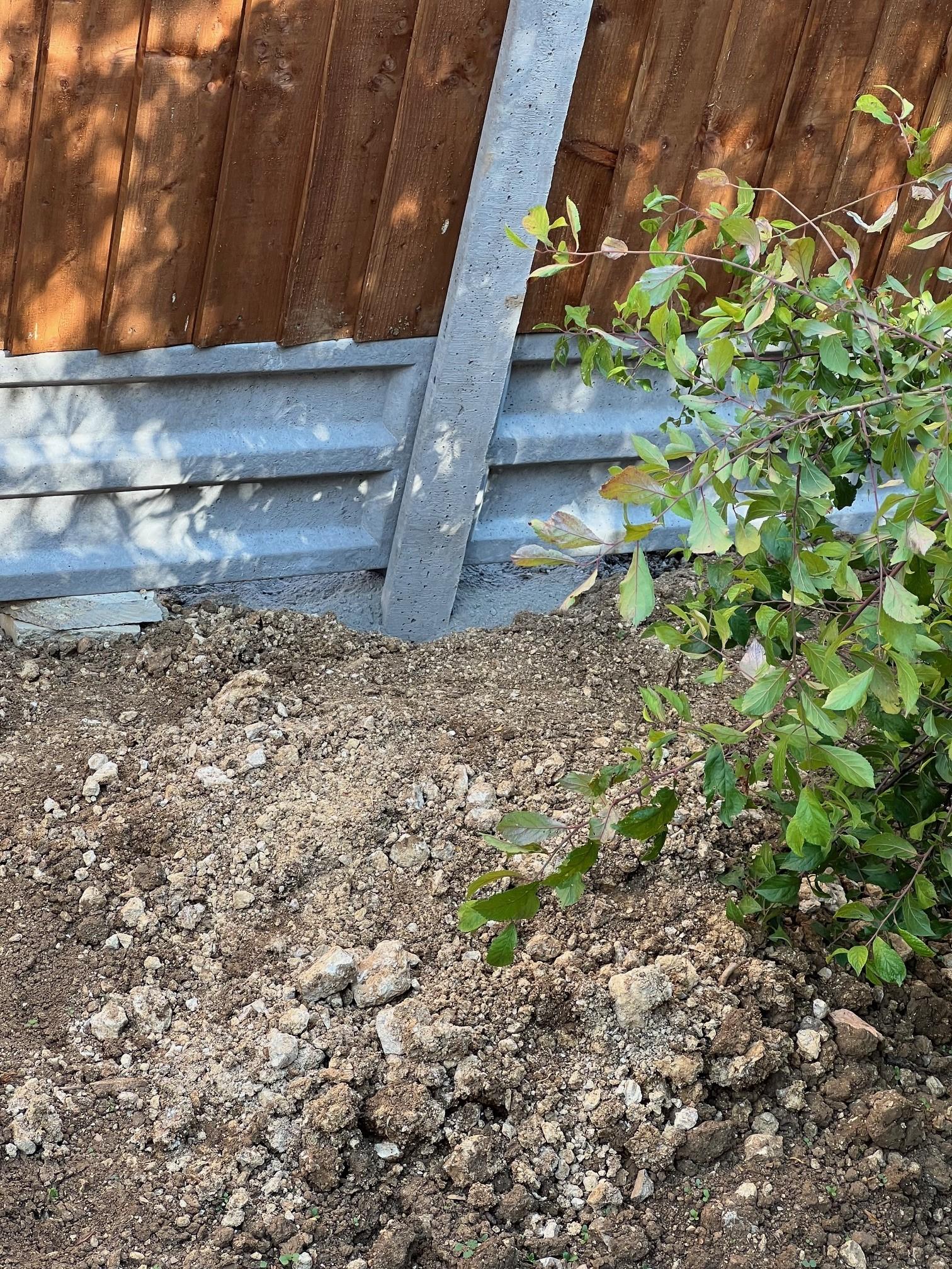

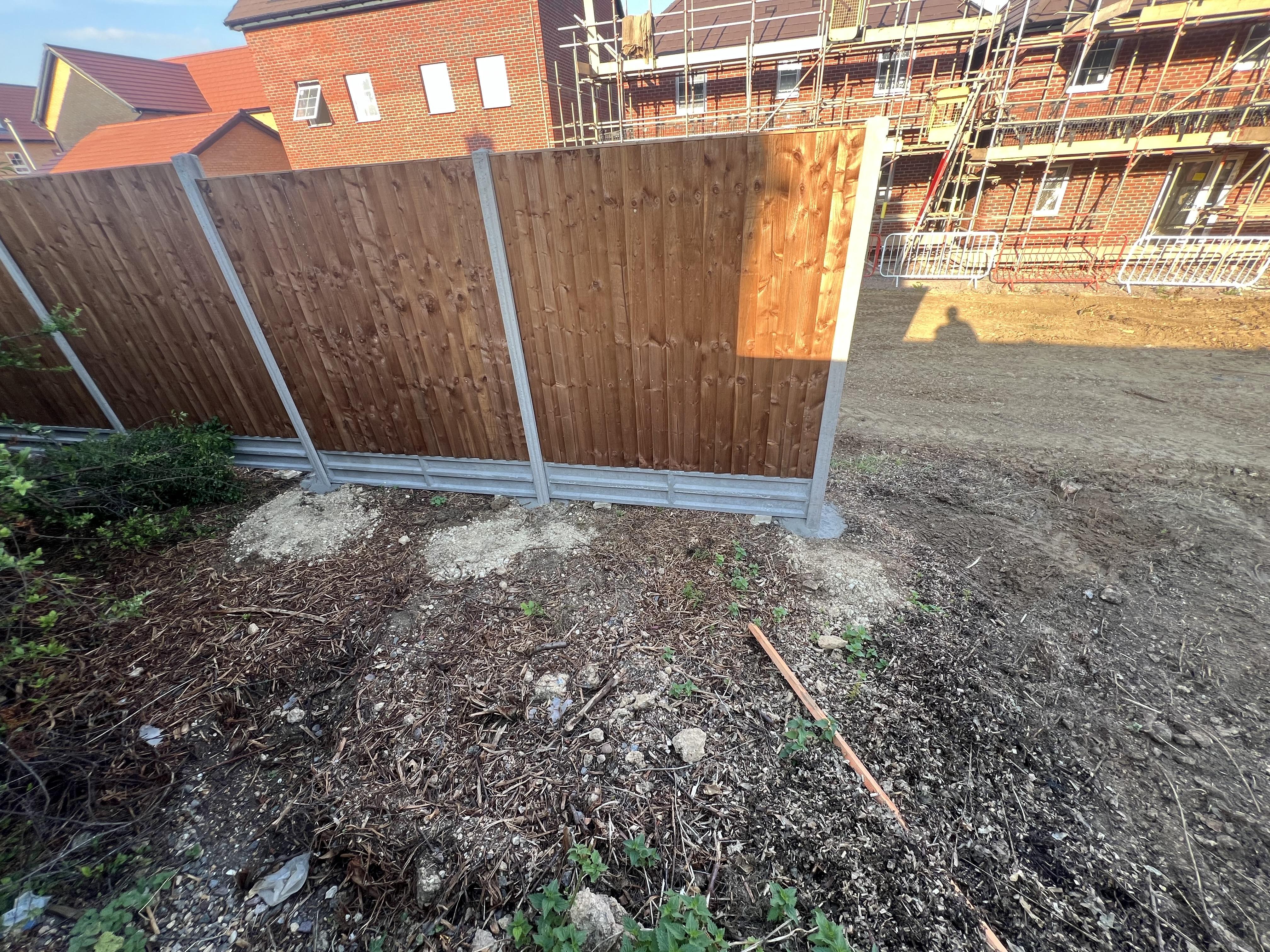

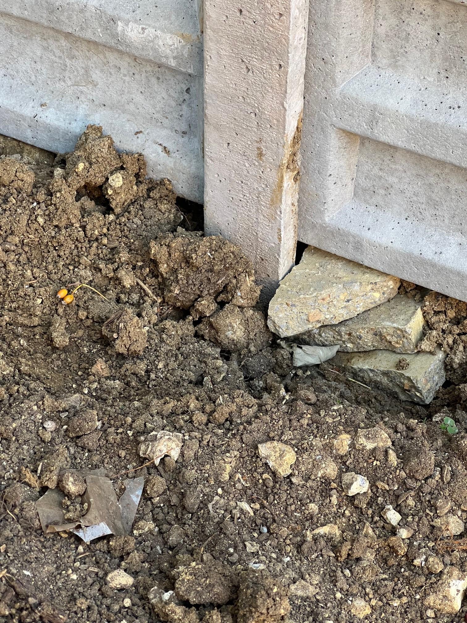

They were using postcrete or something similar. I saw the yellow bags. I'll have to wait until I can actually get my hands on one at a later stage to check for movement at the base. Or when the contractors they are using are back to continue, I'll raise it with them and get them to show me. -
Concrete Posts Filling
steveoelliott replied to steveoelliott's topic in Landscaping, Decking & Patios
Having now spoken with the site manager, I am a little concerned at the movement I saw on the posts when he was showing me all should be OK with the installation. I would expect almost zero movement to a concrete post, certainly my existing wooden ones are rock solid. However, with our existing fence in the way and no direct access to the site, I will need to wait until I can actually check them myself. This fence is coming to us at no cost but it's a long run and ultimately I am going to be taking responsibility for it going forward. I may consider trying to get a local fencing company to come out when it's done to give me a proper opinion and then I can challenge the developer. -

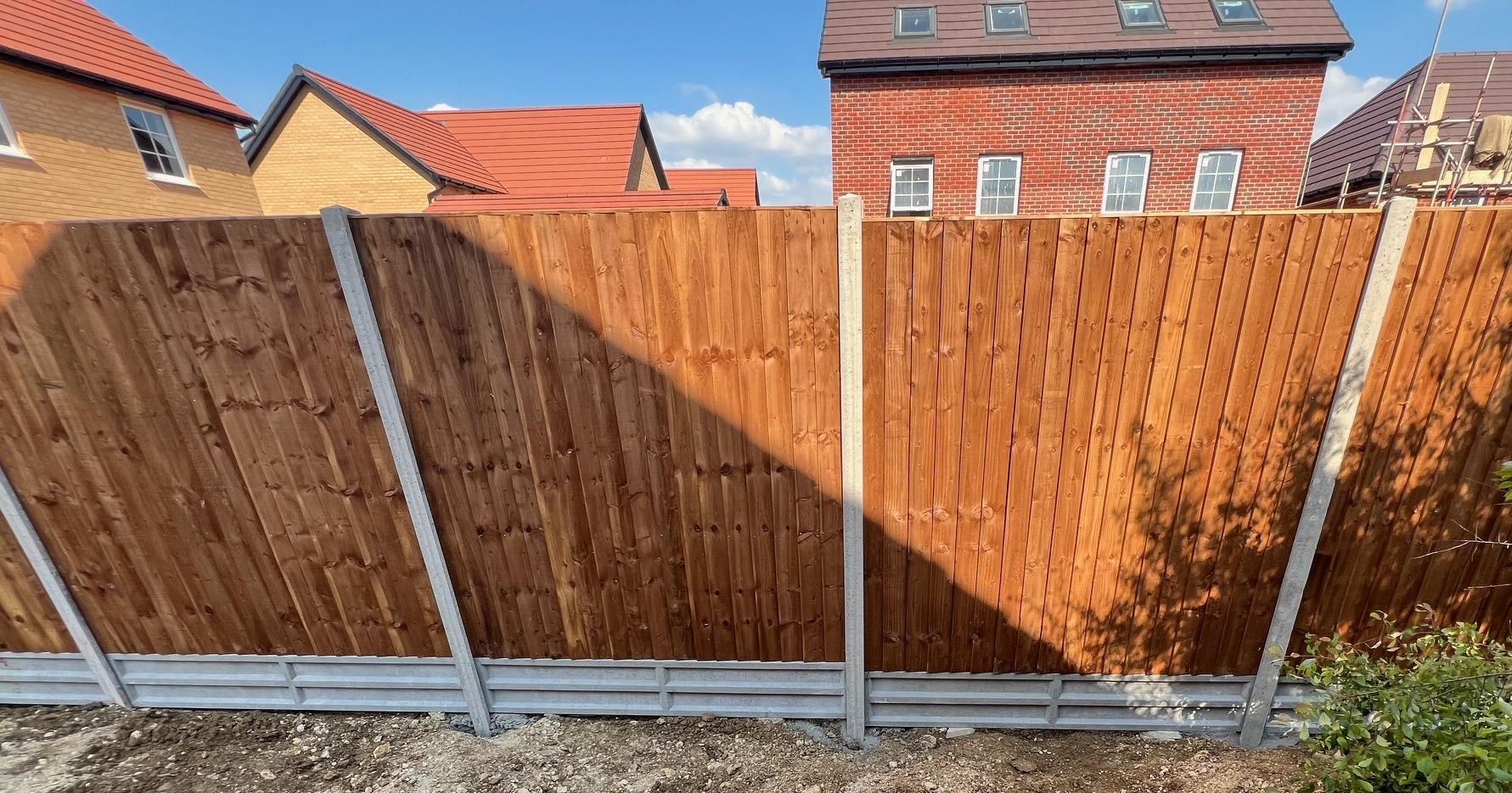

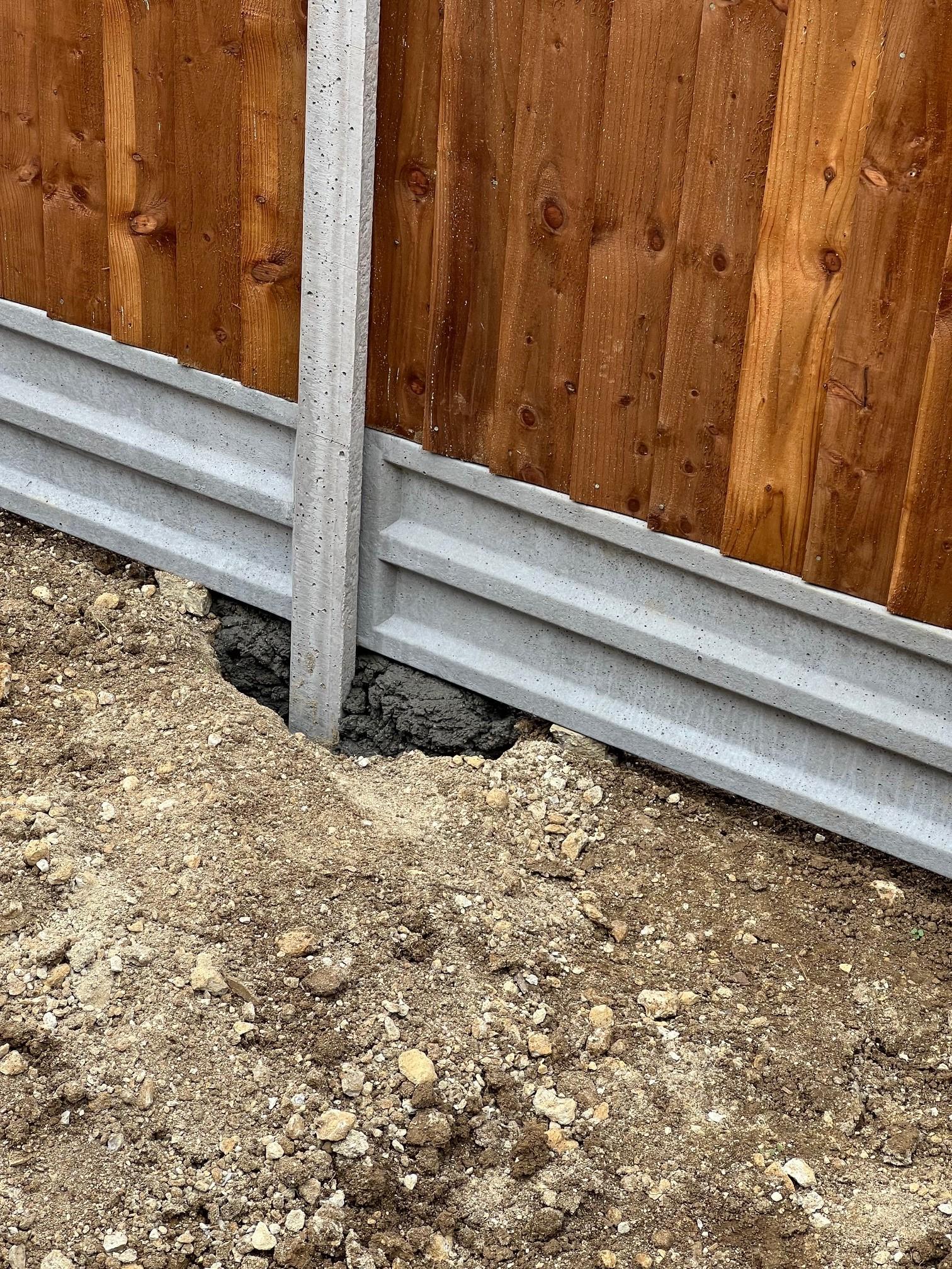

Thanks. Perhaps I’m being a bit pedantic then. I’ve never tackled a fence but what I read suggested filling to the top. They got this last one how I would expect to see it. -
Any feedback most welcome… I will raise this with the site manager. The thing is to remedy it now, they’d need to break up the existing concrete and start again. Anything new is surely not going to bind to the old. -
Hi, There is a developer (I won't name) that is erecting a fence on our boundary and I believe that whilst the holes have been dug deep enough and the fence generally looks good, the filling of the holes has a lot to be desired. It's odd as to me, this is the easy bit, having done the hard work of digging the hole and setting the post. Perhaps I'm missing something but I'd love to canvas thoughts... I think the lack of support for the posts our side is going to cause problems and moreover the lack of concrete meeting the gravel boards in places will cause them to drop later. Thanks...

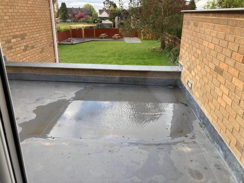

New flat roof - holding water (5 days since rain)
steveoelliott replied to JoshB's topic in Flat Roofs
I know your pain, happened to me when my membrane was replaced and the roofer just replaced membrane without checking falls etc. I was told that it's not a problem per se but I do have a minor leak now it seems so I will look to replace again and get the job properly.
