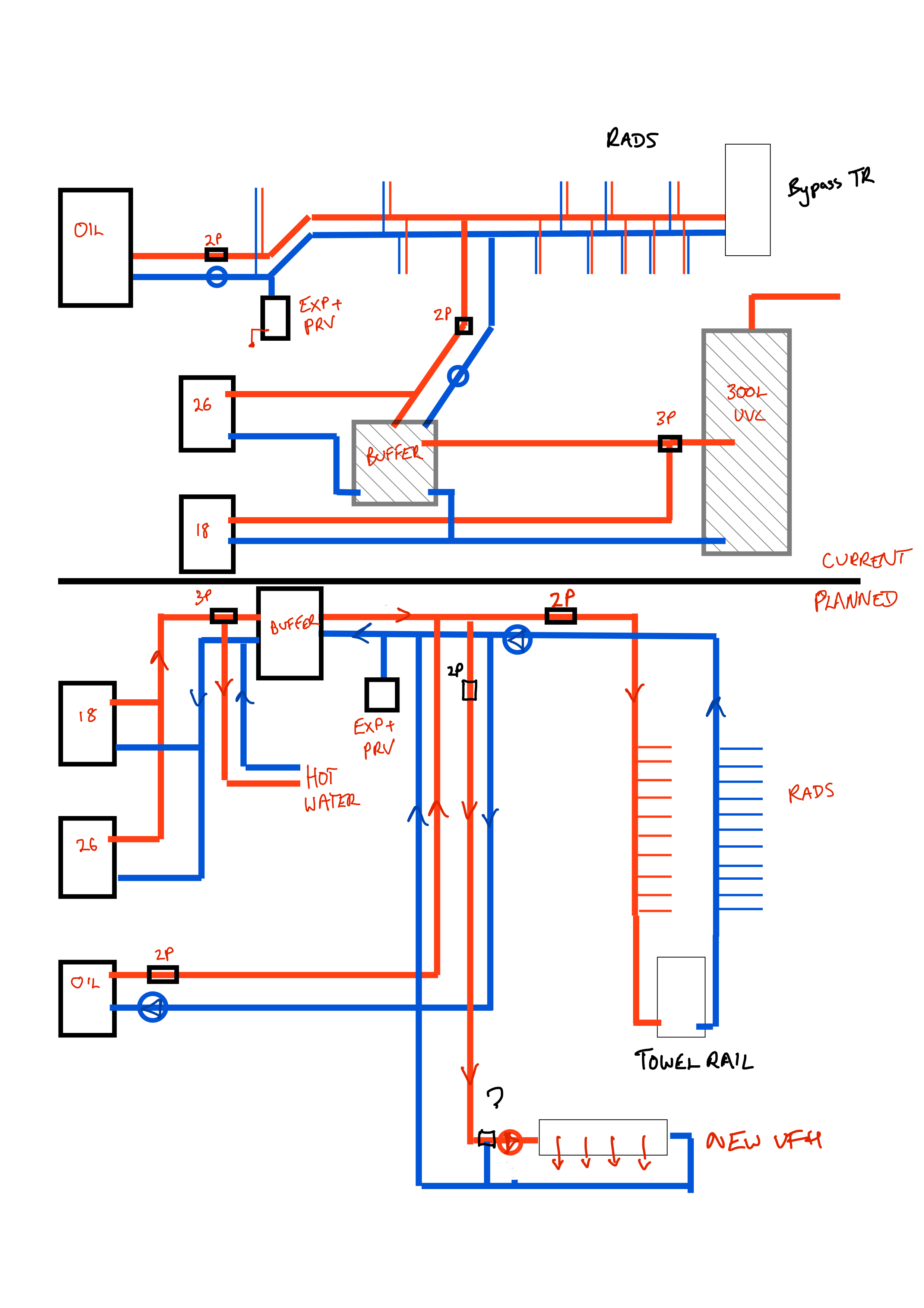

Yep, it certainly makes the meter spin when it all runs together. Ah yes, only one can ever do the DHW, currently the 18. I would aim to drop the 26 altogether in the future. In the CE diagram 18 is on the left and 26 on the right. The intent of the proposed was to allow them to run in parallel for heating and one for DHW but thatās not what is shows! Iāve read in the other threads about removing buffers and using volume of system (my house is plenty cold enough thereās valves open). But specifically at the moment is is the pumped UFH system the correct approach? Can I simplify as per JohnMoās example or is the current setup optimal in terms of feed. -

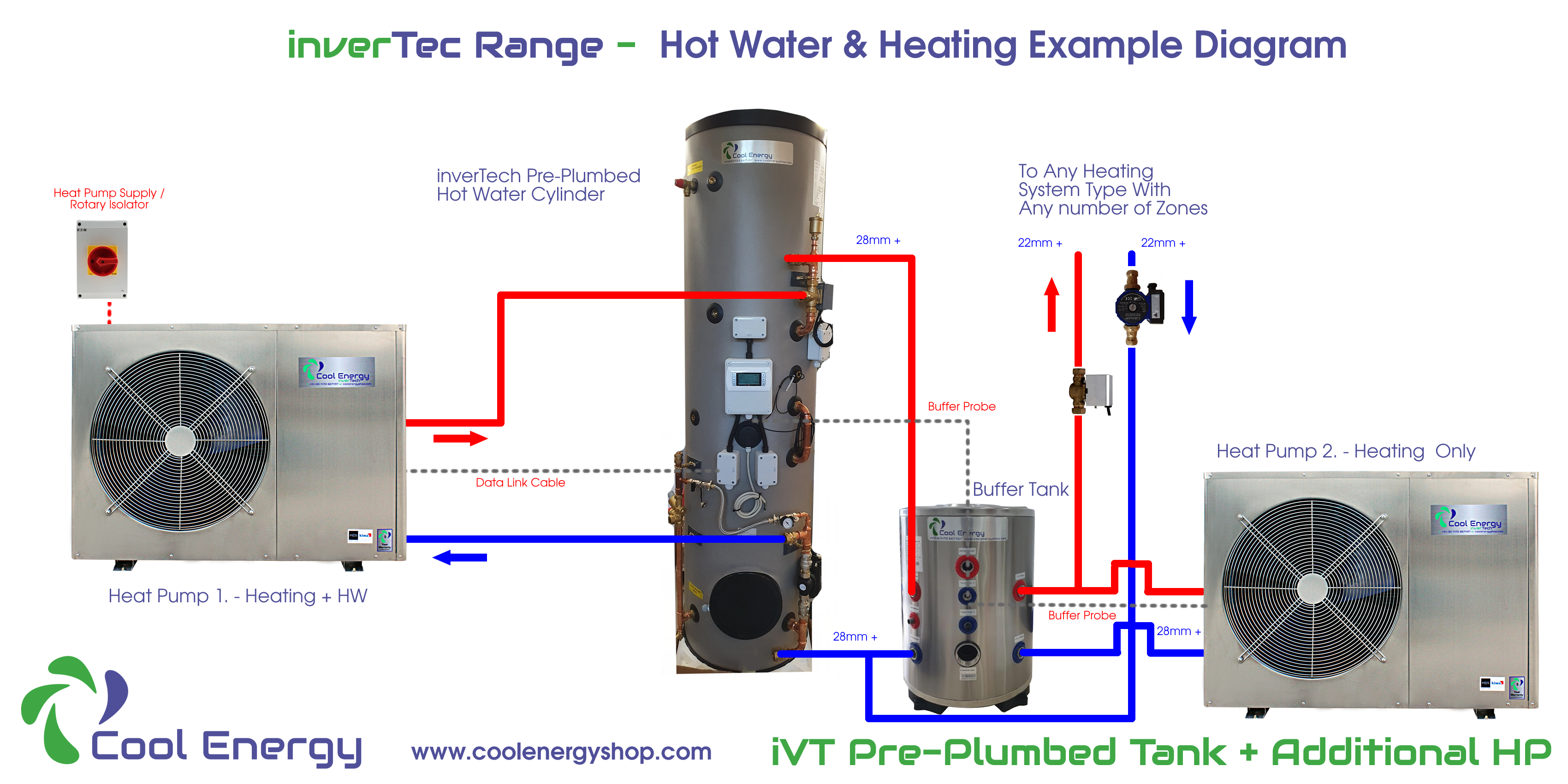

@JohnMoTheyāve been installed per top scribble for 3 years. I appreciate the ridiculous oversizing but I have another project this 26unit will move to once I finish the upgrades to the main house and can prove just the 18 copes. this is the ASHP setup as per CE: -

Iāve got an 18 and a 26 in a weird parallel situation (blame Cool Energy for the upsell!) Iām hoping to get to just the 18, but it does defrost a lot and the 26 helps carry through those moments. -

@Nickfromwales see scribbles below. Current above, planned below. The idea is I could eventually drop the oil and the 26kW ASHP but theyāre there anyway so might as well use them. -

A pretty terrible scribble, give me a few mins to tidy it up! -

@Nickfromwales Thank you. If it was just an ASHP, would it be acceptable to have no control? Is there any point in the 4 port and pump? Why not just run it as a big radiator? -

First of all- HOLY THREAD RESSURECTION! But hoping @Nickfromwales might be able to confirm if the advice above has been superseded- The builderās plumber turned up, saw an ASHP and looked no further. He then supplied a manifold with a pump and no mixing valve- just some sort of fixed 4 way and a pump. I have the ability to run the oil boiler in to the heating circuit and the Buffer tank has an immersion in it- so I would consider a TMV still required. He just keeps saying āitās fine for an ASHPā - is it ever fine to not have a TMV?
