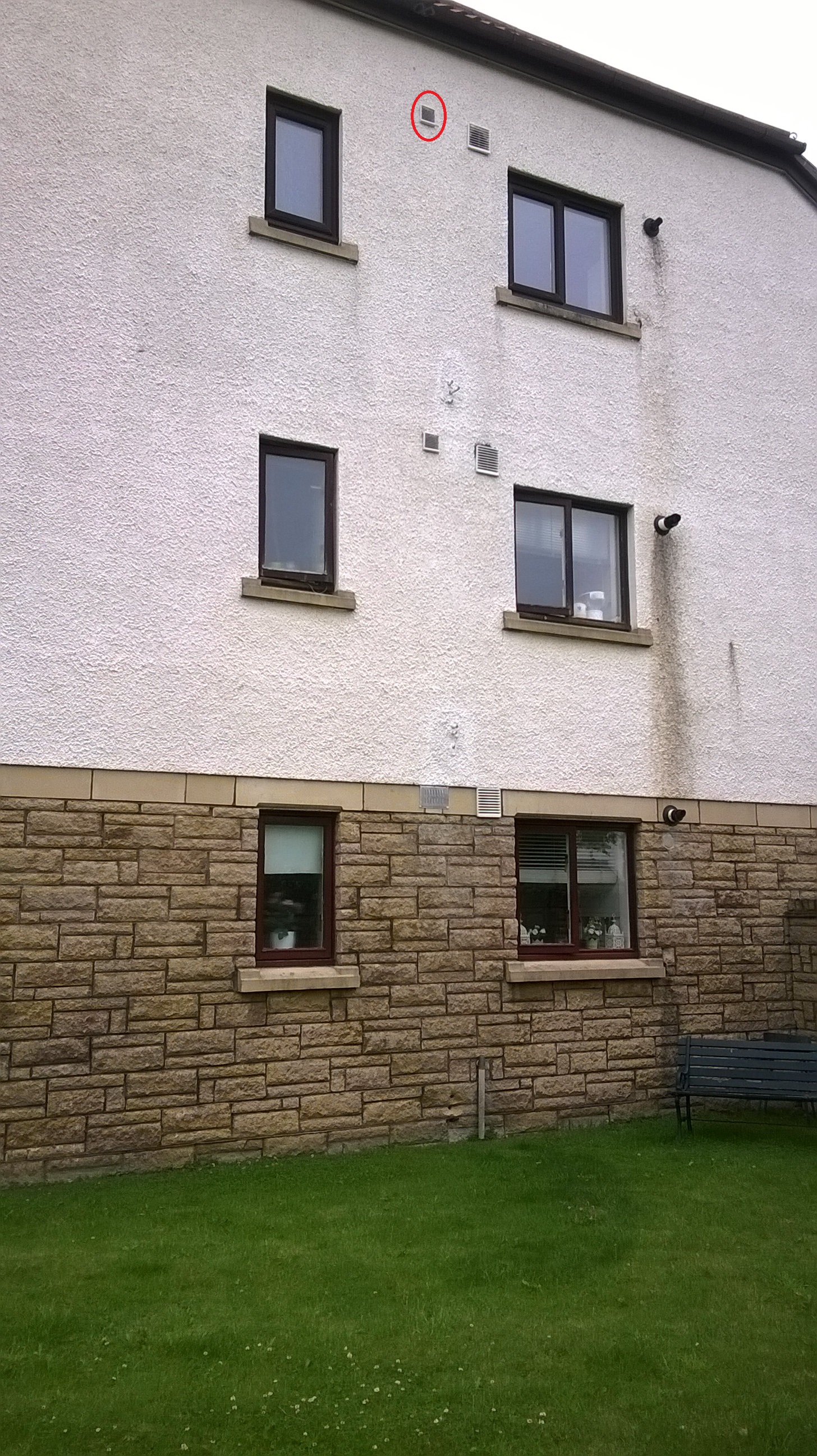

I’m on the lookout for a trades person than can properly install a single room Heat Recovery Vent into a 2nd floor flat. I put details about how the job is around 7.5m off the ground in this thread:- I thinking on using one of the “Trust a trader” type sites from the following list but unsure what one to try first:- www.trustatrader.com www.mybuilder.com www.ratedpeople.com www.myjobquote.co.uk I did try and go with a recommendation but the person said they would come the next week to check the job out and then never returned any of my texts after that. Any tips or recommendation appreciated. Thanks, DD.

I'm trying to get installed Heat Recovery Vent into a 2nd floor flat http://www.i-sells.co.uk/vent-axia-lo-carbon-tempra-selv-lt-single-room-hrv I need a little of the harling chipped away to make the bottom of the existing core hole a little wider and then a PVC plastic face plate screwed to the wall. The problem is that this work needs to be done at height (approx 7 meters as red circle below shows) and I'm not sure if a builder would need to erect a scaffold and platform to do this work or if it can be something that could be done by safely and legally by someone who is proficient with using ladders? If scaffolding is required then any ballpark guesses at the costs for erecting a small tower for the day?

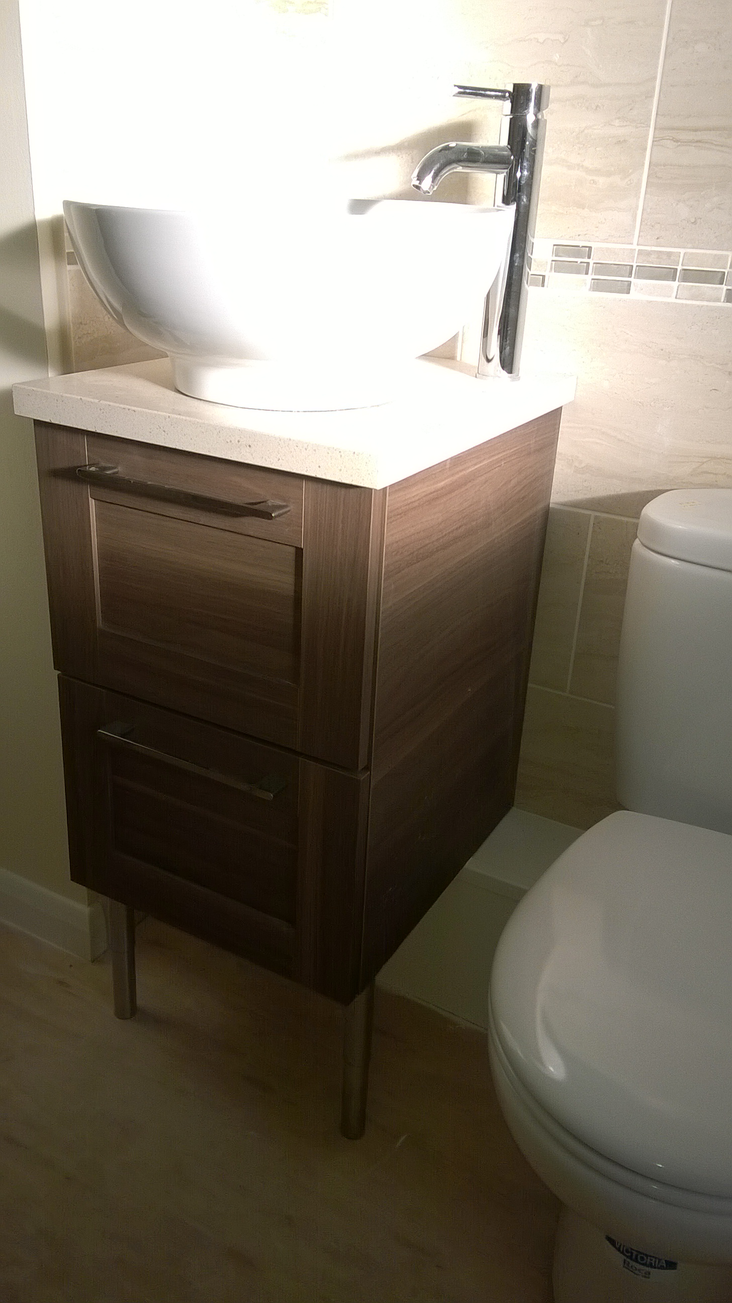

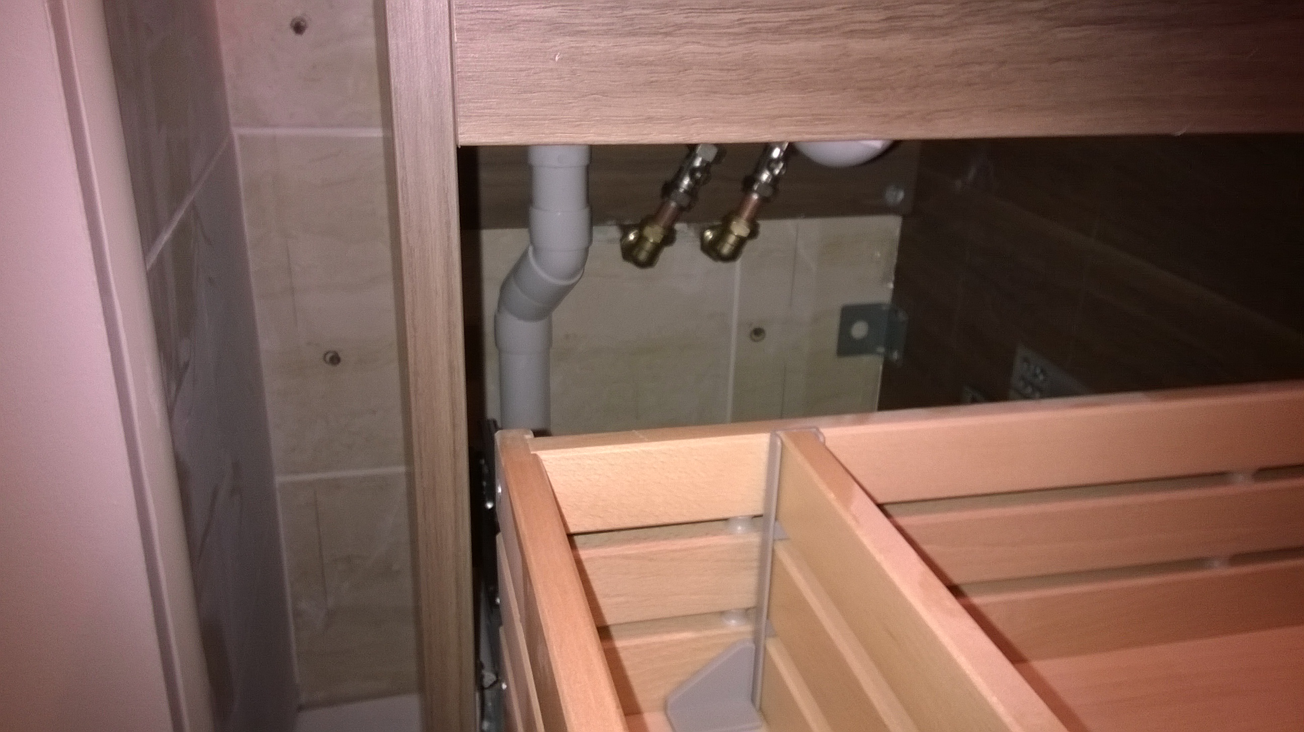

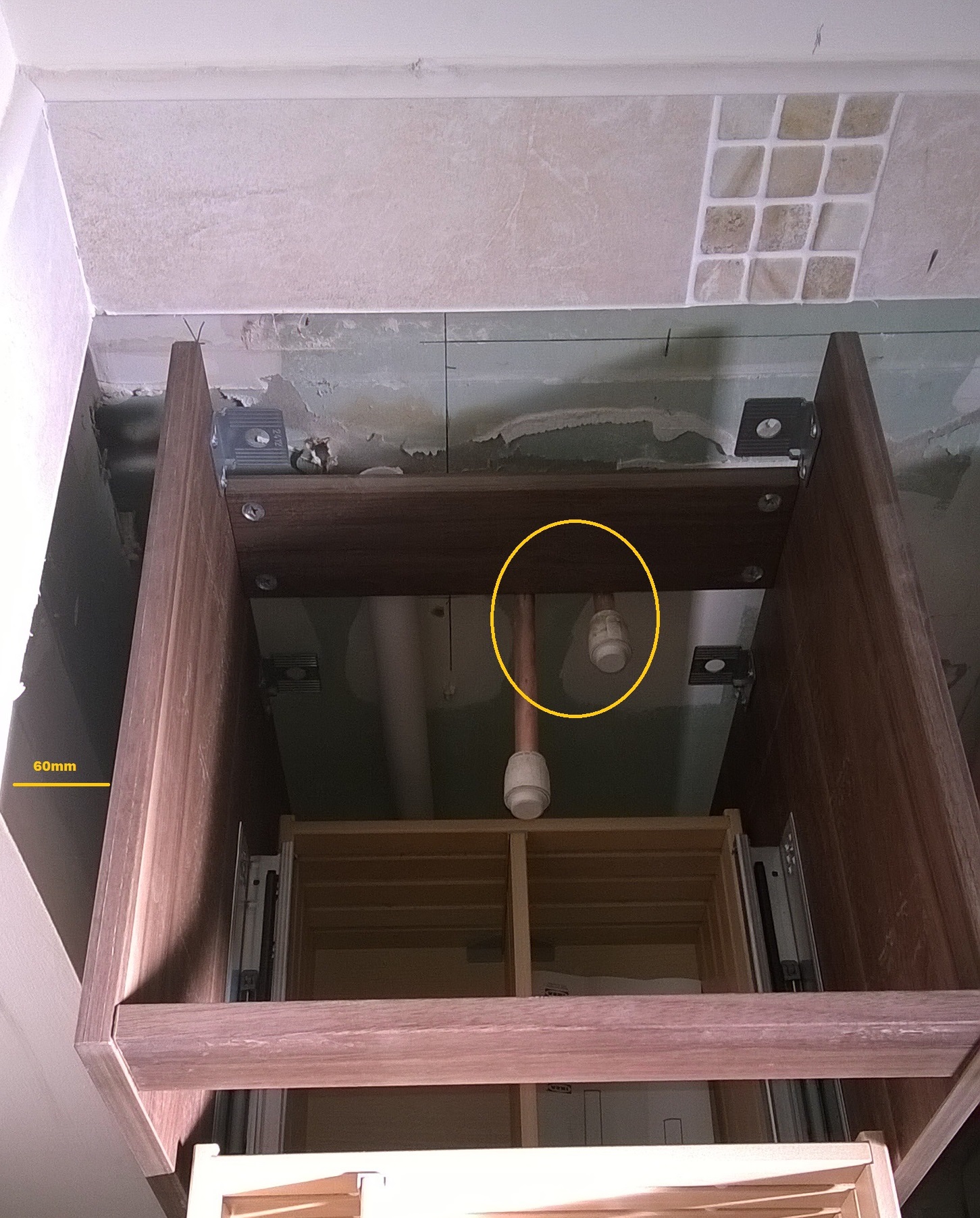

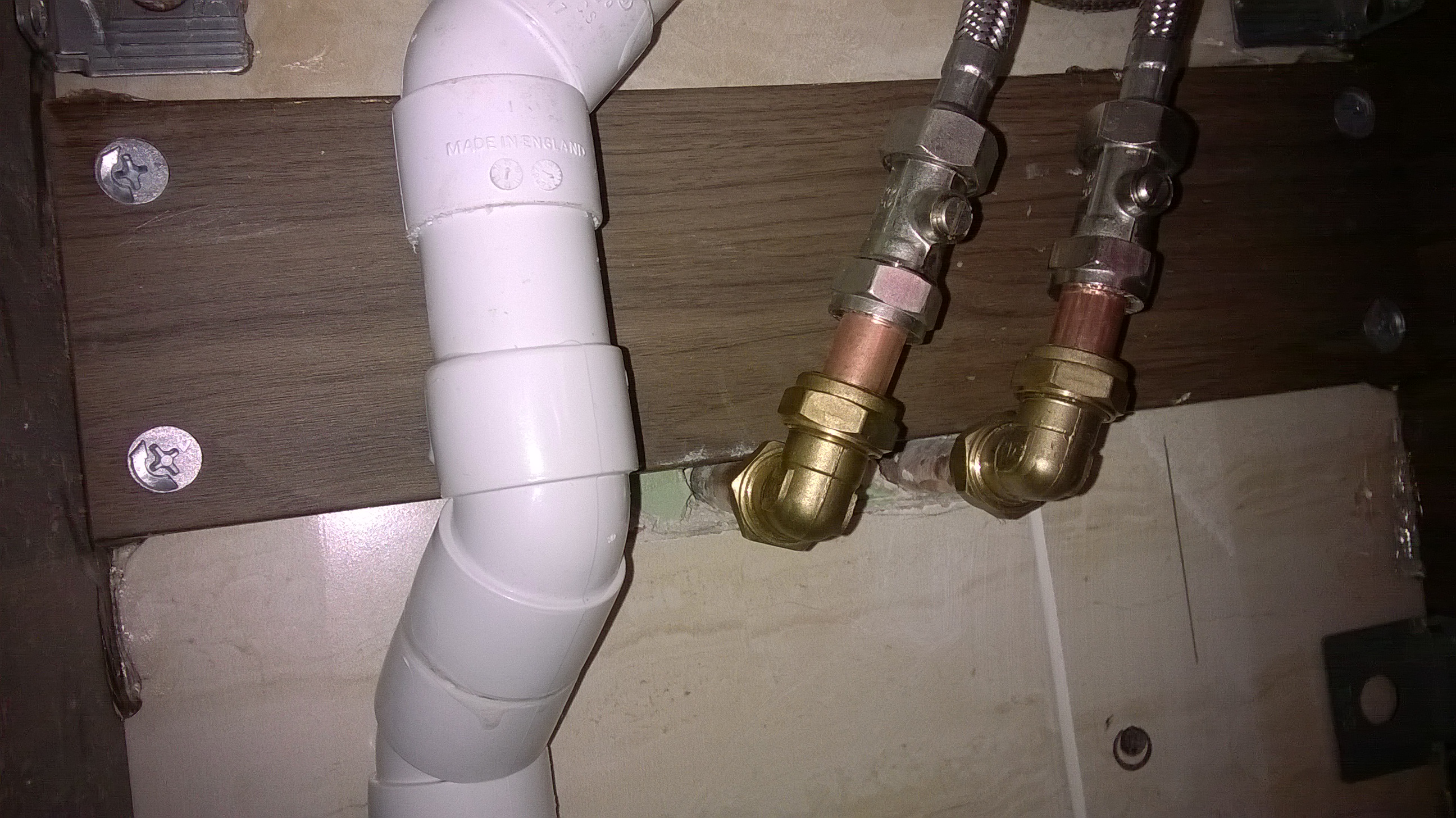

The water pipes are able to be wiggled by 3 to 4mm in either a horizontal or vertical direction. As I now know the pipes are not under any stress, I now feel a lot less stressed myself and I may come round to the idea of living with the set up the way it is. Thanks for the idea of a wiggle test, sometimes just looking at a problem is not enough, sometimes you've got to get your hands on it and give it a push and a prod

That was suggested by my brother in-law but it has the drawback of weakening the unit and the cross bar is basically chipboard with some form of shrink-wrapped pvs/vinyl cover, cut into it and the bathroom vapor will slowly make the exposed chipboard swell fairly soon. It would solve the issue of the weight of the unit not pressing on the pipes though. So it's a cheap hack but considering the unit was shown to the plumber on-site before the brand new water pipes were put into position on the wall then really it is a first fix problem that the plumber should have avoided and should fix at his own cost in my frustrated opinion. The plumber was a grumpy sub-contractor so that adds in a layer of complexity to the mix.
Being a newbie to this building game I am unsure if a basin unit resting directly on water pipes would be considered a defect/worry to experienced builders/plumbers. The basin unit has been installed as follows which looks basically OK before considering the instructions I gave to the builder before installation. Instructions emailed a week or so before installation were:- "Basin unit I was looking at how the basin unit would fit in to the space in the bathroom and I think it best there is a 60mm gap from the box of pipes on the left, that’s 50mm if measuring the gap from a tile. I think the basin unit needs this space to give comfortable gap for the basin bowl to settle flat on the counter top. Also the cold and hot water feeds from the kitchen into the bathroom for the basin tap need to be 50mm lower as currently they are at the same level as the back support plate of the unit. Please see photo below:-" So the first attempt of installation of the unit left a 5 mm gap to the left hand side of the unit and the unit cross bar supports resting on the pipes. So I emailed once more to my build contractor:- "Owners note that structural baton on basin unit is resting on water feed pipes which is stopping the unit from rest on boxing in below as previously agreed. Water pipes should be moved lower so unit can be moved 8mm lower to rest on boxing in. Also shadow gap to left of basin needs to be increased to at least 60mm to allow for access for cleaning gap." Then the basin unit was then unbolted from the wall and moved to it's current locatio where there is now a 100mm gap from the left hand side of the wall but STILL resting on the pipes as shown:- My main concern has always been the fear of a plumbing fault causing a flood; with the weight of the unit considering it's a quartz top and porcelain bowl on top (20kg) + water in bowl and people leaning on it (maybe another 30kg) that the unit should be firmly bolted to the wall and not resting on the pipes, as over time I fear the weight of the unit on the pipes may causes one of the pipe joint to fail? I fear that I might worry about this set up until it is rectified. Do other builders/plumbers here consider the cross support bar resting on the pipes a defect that should be fixed or would they not worry about it? The unit also now seems glued to the wall with some clear adhesive instead of bolting it to the wall, which I guess might be OK in the short term but not convinced adhesive is a longer term/10 years+ good plan. Your thoughts will be appreciated, DD

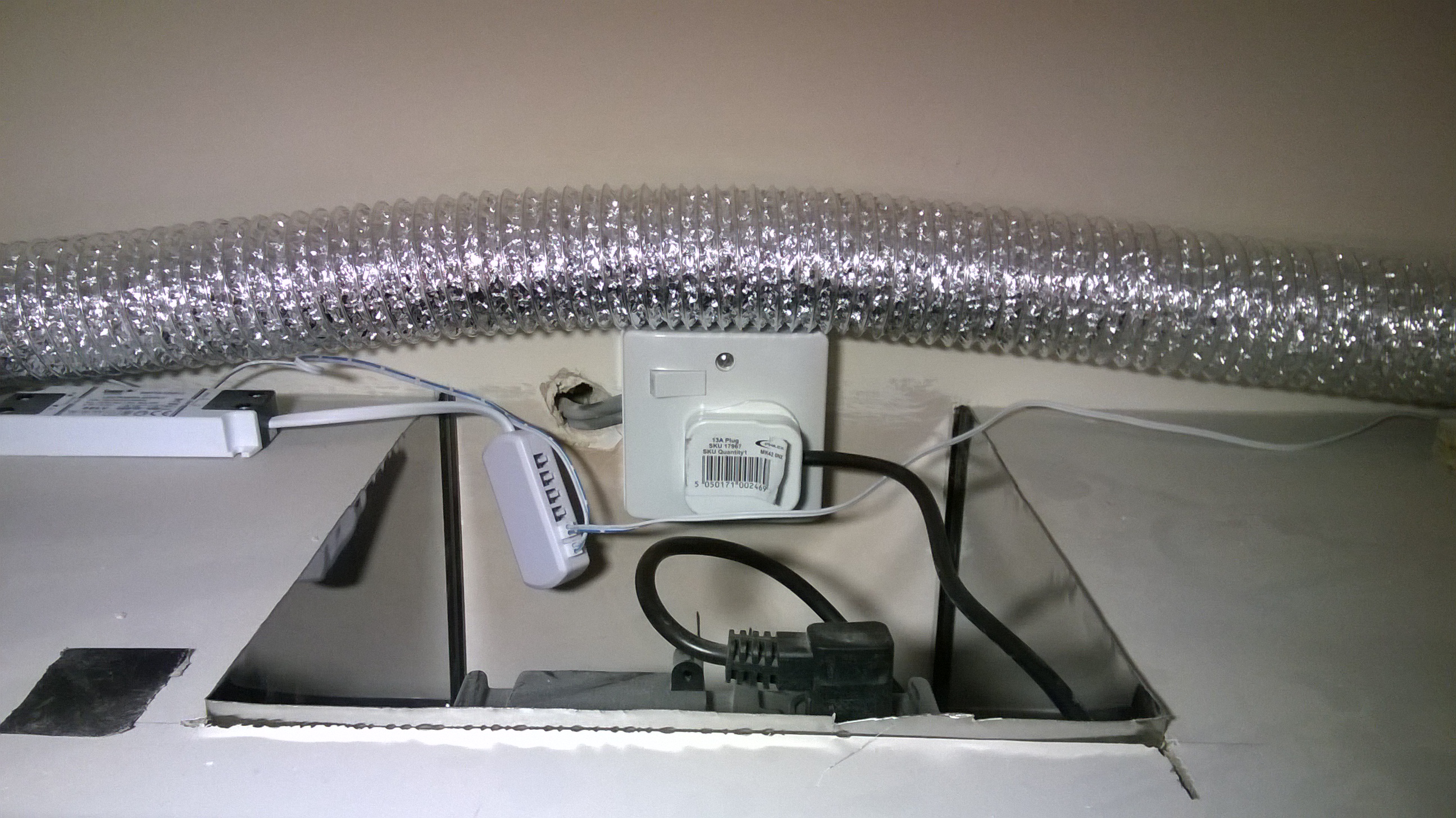

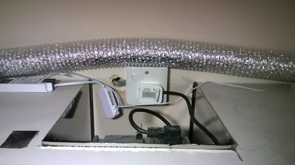

If a hob fire did occur and it was so bad that flames where going up inside the chimney hood, then it is probably time to get out the flat and in the panic if the person can remembered to switch off all the electrics by the main switch in the hall cupboard next to the front door that would be a bonus for the firefighters. I'm more worried about down the line the fan in the hood might give up and need to be replaced and then someone will need to use that plug point that by that time may be well greased up and damp. The problem can be easily fixed by extending the 2 grey wires by 2 foot each to take that socket well out the way. What would that cost to cramp on two small 2 foot extensions, 30 minutes of an electricians time. £40 in total maybe? The hood over the hob extracts just into the general kitchen but the kitchen fan is just 3 feet to the left of the top of the chimney hood. The kitchen fan has 2 uses, it takes 77% of the air from the surrounding area and 33% from a duct, the silver duct runs along the kitchen wall to the hall cupboard where the washing machine and a little clothes drying area are placed. So I'll set the nuaire CYFAN to trickle mode to keep both the kitchen and washing machine cupboard hopefully fairly moisture free. Having the aluminium flexi-ducting replaced with 50mm pvc pipe as someone bound to put a finer nail or tea tray through that flexi-ducting. -

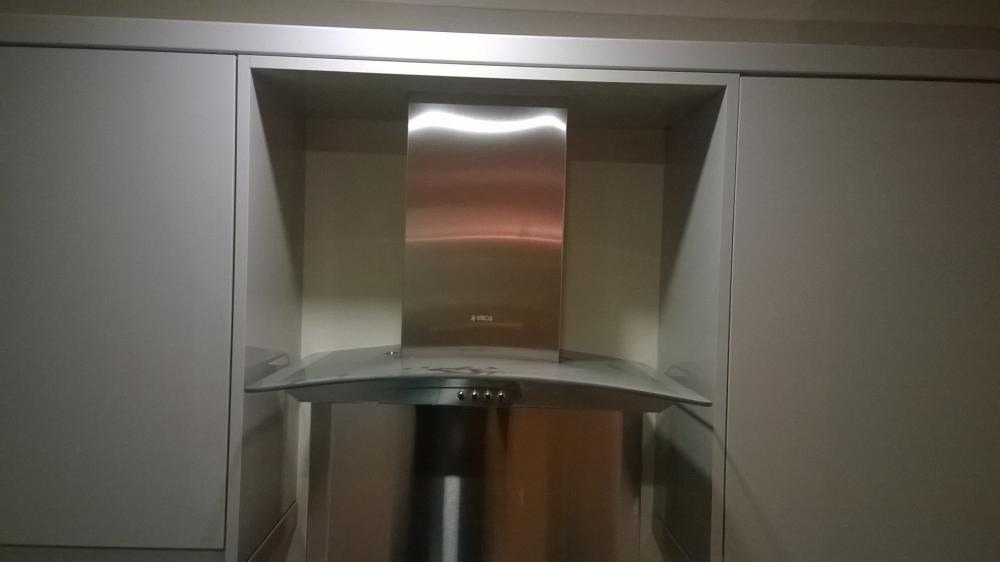

The electrician who the build contractor got in to do my renovation electrics has fitted the fuse/plug point for the hob fan just at the top of the hood chimney and I don’t know how safe or unsafe that is? I guess there won’t be much dampness or grease getting through the hood filters but I have no idea if this configuration is contrary to any building regulations or just me being nervous about not a lot. I have suggested that the main grey leads should be extended with crimps so the plug point could be taken a foot out to the right hand side but the build contractor is no too keen to get the electrician in just for this little job. So I’m trying to judge how important it is. Comments appreciated. Thanks, DD Hood area:- Looking down into chimney hood:-

I did float that idea with the architect, builder and plumber of cutting slightly into the wall but all of them were not keen on the idea. There is nice tiles on those walls and the walls are of a cardboard/honeycomb/egg shell design so the tiles probably give the wall extra strength and cutting into the walls may weaken significantly so took the compromise of a shorter bath. The Tempra that I have bought has slatted vents on the bottom underside edge that a push button lever closes. That will stop most of the returning fresh heat recovered air back into the room. Pushing that level will hopefully stop chills when showering as in effect the unit would just be running as an extractor fan. Will soon find out The drawing package I've been using is "Sweet Home 3D", it's free and very easy, very quick to use. I did upgrade to the paid version from Amazon for approx. £15 and got extra widgets to play with, I'm just amazed at how useful it is
