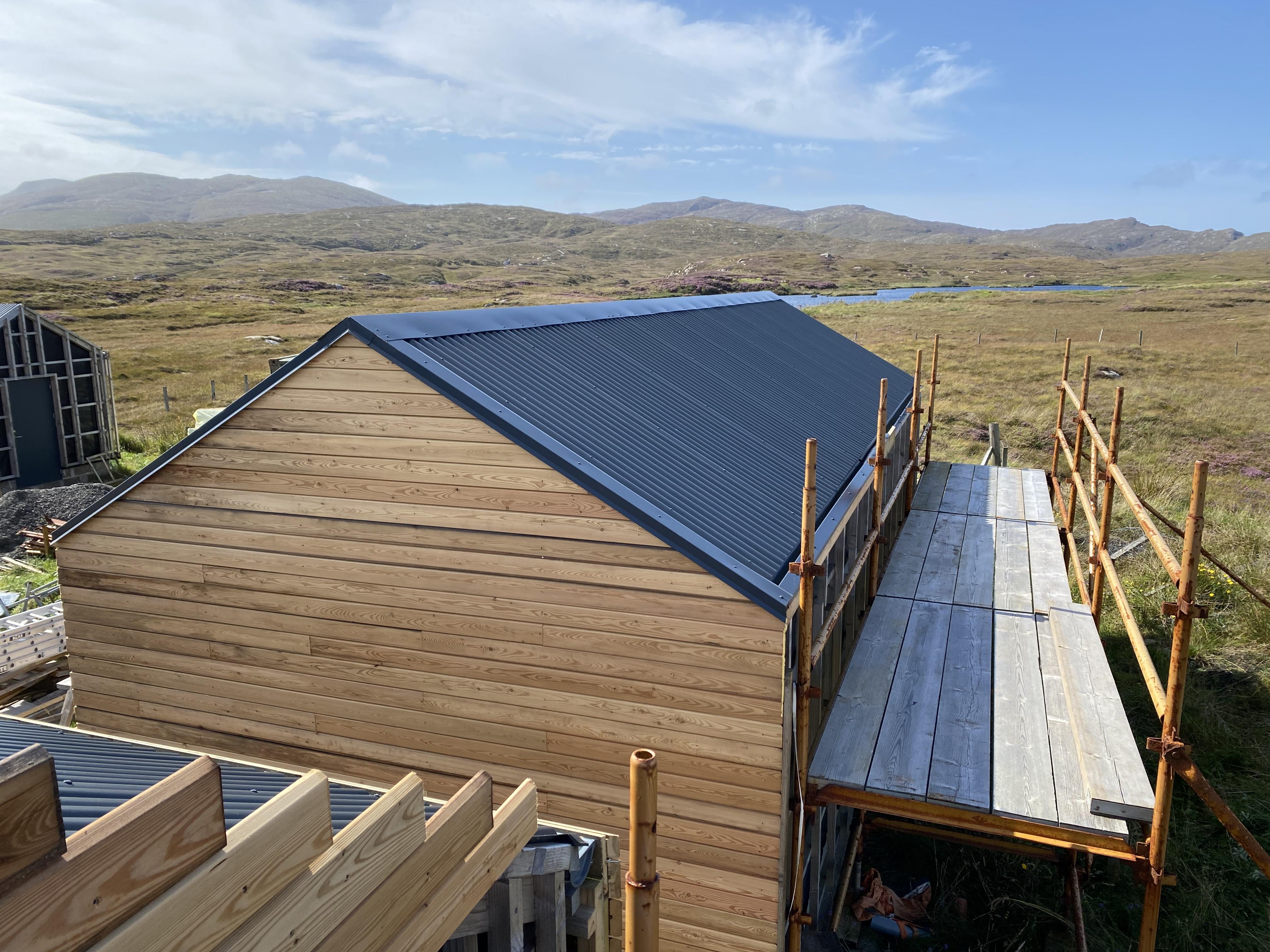

  7. Hi, We are building a house in the Outer Hebrides with Plannja hard finish coated Aluminium specified for the roof in the coastal environment. I’m trying to get hold of Plannja in Sweden but they aren’t responding and their only UK distributor that I know of is Nu Style of Aberdeen and all you get from their automated phone answer is “this office is closed” which suggests they have ceased trading. Anyone know of a good supplier of hard coated 18mm aluminium sinusoidal roofing sheets and flashings? It’s only around 160sq m we need and I don’t want to use steel as I need something highly durable. Thanks, Nick
