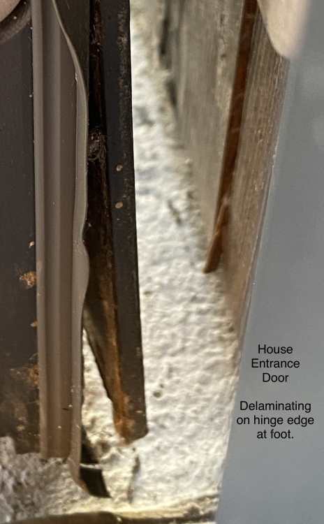

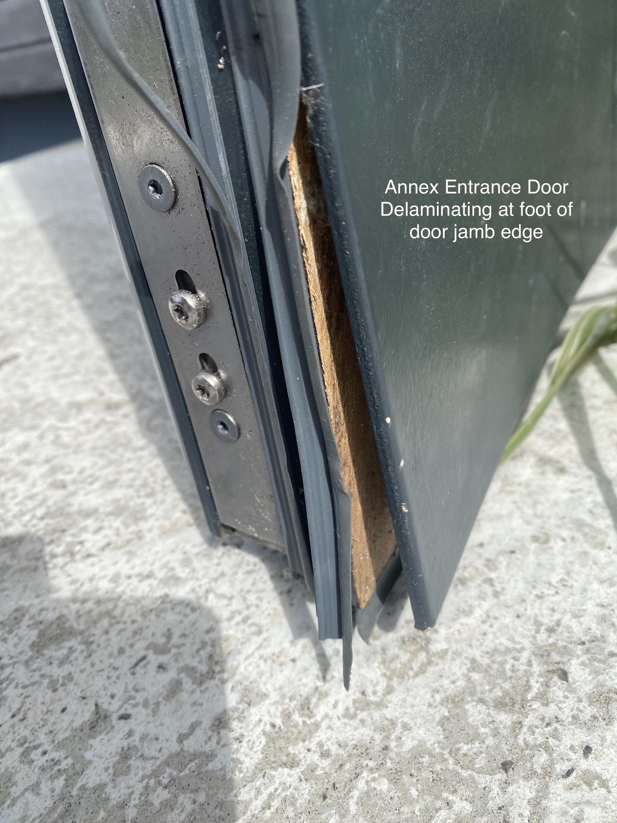

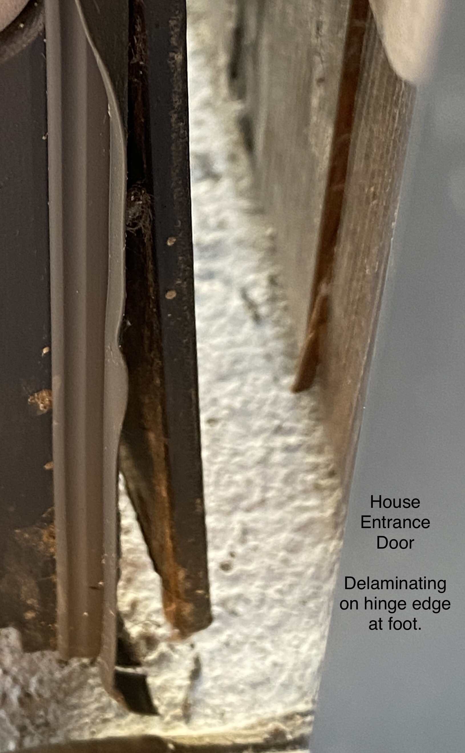

  2. Hi everyone - we’ve just completed a build in the Outer Hebrides and purchased 17 Rationel Frames made up of x3 3.5metre sliding window doors, 3 entry doors and 11 windows. They cost us over £20k in total and I expect the current cost would be much more if ordered today. I would very much warn against anyone buying Rationel, especially in a more demanding environment. The particular issue has been with 2 of the 3 entry doors. They don’t supply Aluclad doors but the AuraPlus doors are laminated timber and interestingly, whilst they claim 20-40 year lifespans on their website, their guarantee on doors is only 5 years. The entry door to our small annex started to blister / delaminate after about 18 months of use and was replaced under warranty. However, the replacement door, and the main house entrance door, have both started to delaminate completely at their foot, one on the jamb edge and the other on the hinge edge. They are clearly not manufactured to be as durable as they should and it’s been a real battle to get these two door replaced. Both are still just within the 5 year guarantee and at first the manufacturer, Dovista, tried to blame work we had done for the failure of the door seal on the annex replacement door, but to be frank, that was just b******s! It was because the replacement door was too tight for the original frame. Their supplier in Scotland has been very helpful, but Dovista has only finally agreed to replace both when they saw that exactly the same problem was happening to both doors. So we are now awaiting the fitting of the replacements but my heartfelt advice would be AVOID. The attached pictures tell the story.
  3. Have to say I agree with Alan & Marshian that if Dovista are prepared to replace outside their (5 year?) warranty, I’d accept their offer. Unfortunately, from personal experience I can say that Rationel durability is poor. We spent £20k+ on 17 Rationel AuraPlus Windows and Doors for our new home in the Western Isles and within 3 years we’ve had 3 quality issues, that’s an 18% failure rate. The distributor has been good but Dovista, the supplier has been unhelpful and reviews on Google and Trustpilot show that we are not alone.
  4. Hi - we spent £20k+ on 17 Rationel AuraPlus Windows and Doors for our new home in the Western Isles and within 3 years we’ve had 3 quality issues, that’s an 18% failure rate. We still have about a year of guarantee and then we are on our own, so expecting some hefty repair bills. The distributor has been good but Dovista, the supplier has been unhelpful. Have a look at Google and Trustpilot reviews. I would very strongly caution against buying Rationel. They look good but my experience is there is dodgy quality.
  5. Hi Omnibuswoman - coming to this late but we’ve just experienced the same problem with our Rationel sliding doors during a fierce westerly storm in Scotland. Did you get a resolution? Reason I ask is that I have found the manufacturer less than helpful on another quality issue. I’m very much regretting that we spent £20k+ on 17 frames & doors from Rationel, especially as we are now up to 3 serious quality issues in the 3 years since installation. I’m afraid there will be some expensive post warranty problems to come. Thanks.
