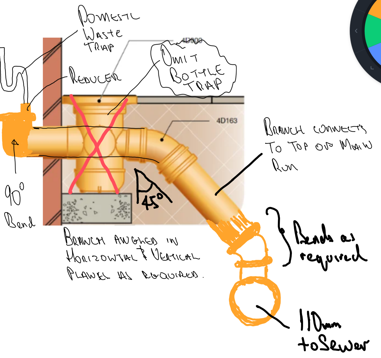

  1. Looking to do a sanity check on the drainage arrangement above as its one I'd like to use in my current project. Do I understand correctly that the domestic waste traps (kitchen sink, DW and washing machine) can be directly connected to a main sewer run via a suitable sized reducer on to a 110mm branch? I imagine that the reducer provides a sealed connection and the trap on the domestic waste prevents foul gases escaping?
  2. I will have a browse through AD H, I'll be running my plans, once firmed up, pass my BCO as well. My reasoning for angled the branch in both planes was purely if needed to make the connection given the narrow spacing I have to work within but as you rightly point out it probably would be beneficial in terms of aiding flow regardless.
  3. As part of my renovation work I am installing a new 110mm sewer run with various connections to an existing manhole. The most upstream connections (2x WCs) have been made and now the run routes down a side entrance to meet the existing manhole. Being a side entrance the width of ground I have to lay pipework in is limited to ~800mm, however along this section of the run I have to pick up a RWP and the usual domestic wastes (DW, washing machine and kitchen sink) The current plan is to use bottle traps to connect these various wastes onto the main sewer run. (Edit to add the current system is combined and BC have ok'ed combining all wastes) The narrow width combined with a relatively deep invert level (~700mm), means I think the bottle traps branches would have to be laid inclined at a 45 degree angle downwards (certainly in the vertical plane and possibly in the horizontal plane) so they can connect to the top of the main sewer run; as opposed to a side entry connection I'm unsure if that top entry connect is typically done or if it could be a problem, hence I'd appreciate any comments or advice on my plans. TIA Sketch below to help illustrate how the connection may be made:

  9. Looking for some design feedback. I have serval waste connections to make at ground floor level. Kitchen sink, disk washer and washer machine. Previously (many years ago) I would have just ran the 40mm waste through the external wall at high level (~1m) and then connected to the main 110mm drain run via a gully trap. I understand this arrangement is currently considered old school but regardless it is not suitable on this current job as I cannot have external surface fixed pipe work at this location. Reading previous topic I have came up with the design below. I'd appreciate if anyone can critique or suggest improvements. TIA.
