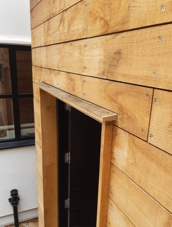

Below is a photo of it finished. I have a dig later to see if I have a photo of the EDPM detail, Illbruck have a good range of tapes.
I did a recent project with horizontally fixed sweet chestnut. For memory I used EDPM around the window reveals and head, tucked up underneath the membrane, then installed head and reveal boards (machined from the chestnut) which projected past the cladding. If I was doing it again I'd use pressed metal trims as the head & reveal boards.
