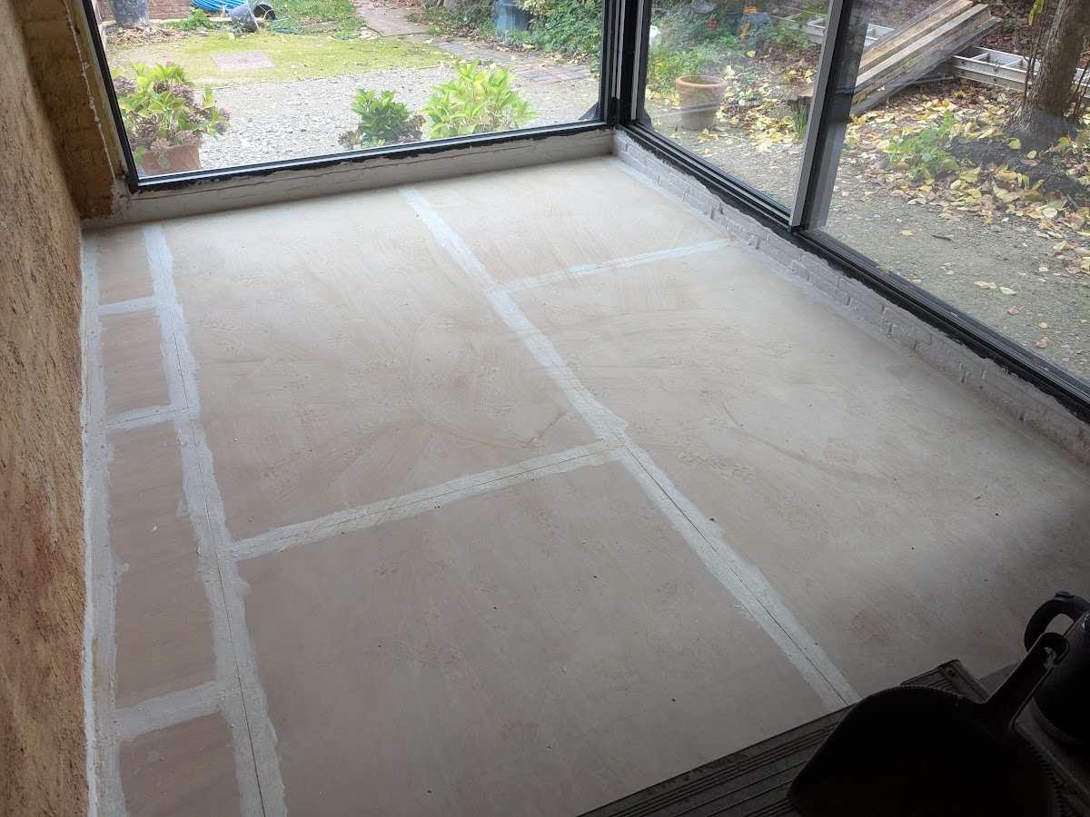

  18. I get so much valuable information from people on this forum and feel I contribute little in return so I'm going to post up photos of the IWI install as I go, it may provide some insight to others doing a similar install. Below are the various methods I used to seal around embedded joist ends. Where the background wall was reasonably sealed around the joist I used airtight paint. It is easy to use, fast to apply and gives a comprehensive covering. In instances where the background was gappy such as around joist hangers I started of just taping the hell of them. The Tesco Vana tape is good, you can mould it around a little and it gets a good adhesion to the parge coat and especially so to timber. (I also primered backgrounds with Tesco primer) However in some other instances the mortar joints in the brickwork between joists was very gappy and would require jointing. And in some of these instances there are timber lintels in the mix so I decided to fit and and tape sections of Intello plus, this meant that the surfaces to be adhered to were predominantly timber which the Vana tape does a great job of. Lastly there were a few instances where the joists ran parallel and too close to maneuver a tape in to seal around. Here I just build filled with Illbruk FM 330. These void seem dry so fingers crossed this bulk filling wont end up trapped moisture against the joist.

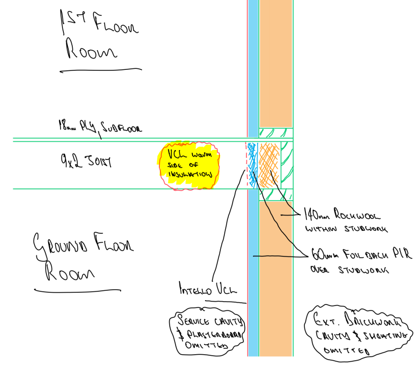

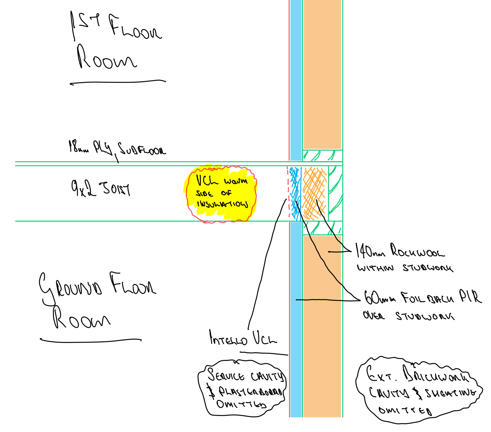

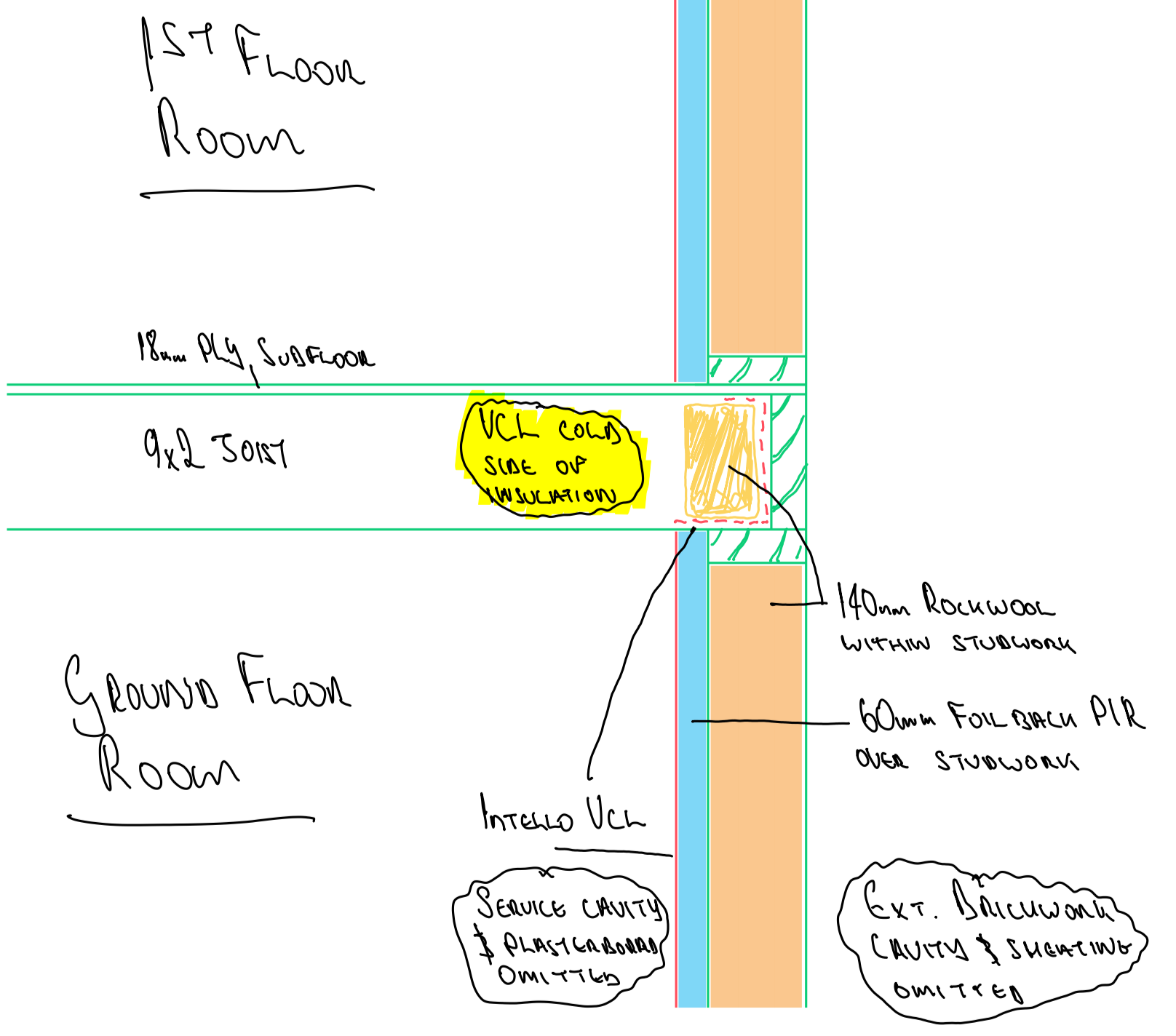

  25. I'm still trying to figure out the best option to resolve the problem of the missed VCL installation at joist level. My issue is struggling to understand the princple of where the VCL should be in the assemblage, therefore I'd appreciate any comment on the two sketched sections below. My understanding is that ideally the entire joist would be internal side of the VCL. That cannot now be achieved here, however, as per below I could continue the VCL up the wall, cut in-between the joists, taped back to the rim joist and around the perimeter of each individual joist pocket perimeter, then fit insulation within the joist pocket. In this arrangement the VCL is cold side of the insulation layer. An alternative sketched below is where the 60mm PIR board (installed over the studwork) is cut around the joists and continued to the underside of the plywood subfloor, then similarly the VCL is continued to the underside of the plywood subfloor and taped accordingly around the joists. In this arrangement the VCL is warm side of the insulation layer. The first arrangement seems to closely mirror other details I have seen online, however does it not pose a condensation risk, where internal born warm moist air may condensate on the VCL behind the insulation? The second arrangement seems a safer in terms of at least limiting the amount of internally born warm moist from entering the insulation layer, and what does get through can still dry into the cavity. However I have not seen any similar detail online. So thats my hurdle in a nutshell, any comments are greatly appreicated!
