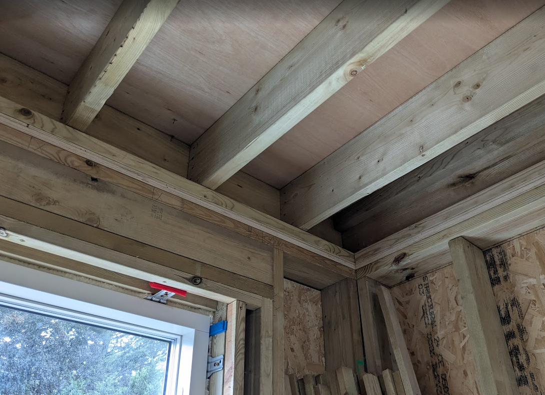

Looks like a good solution but as I've only about a dozen pockets to do it's probably too expensive an option.

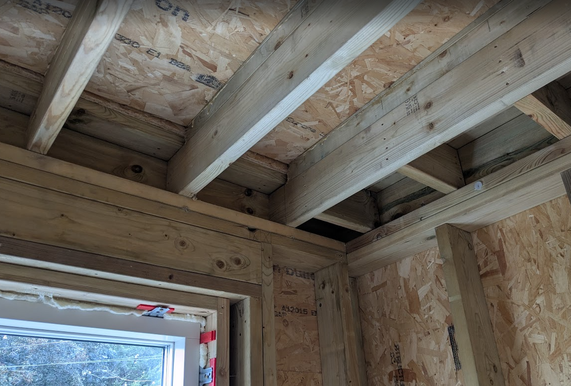

Yes the "Tony tray", I had it well researched but must have been rushing and its inclusion was forgotten. By top plate I'm referring to the horizontal top plate of the studded wall. Basically just end the VCL along the ceiling line, don't fit it in around the joists and tape it along the top plate of the studded wall. The option to have the VCL cut in around the joist will be a bit of a faff alright, however if its required I will do it.
Appreciate any ideas on the following issue to overcome. When constructing my stick build TF extension I mistakenly left out a strip of VCL that I believe is now (at fit out stage) needed to link together with the VCL proper. The design for the VCL was either going to be the PIR foil layer taped as required, or the addition of a sheet VCL. My designed TF build up is broadly as section below: I'm at the stage now of measuring up insulation and looking back at an old thread I see I missed installing a strip of VCL around the joist ends as per image below: So now I am wondering how best to detail/install the wall VCL at the ceiling/floor joist to wall junction as its now built Do squares of VCL need to be cut in around each individual joist void pocket and taped to the joists or can the VCL be simply taped along the continuous top plate? Similarly, at 1st floor ceiling/roof level I'm unsure how the wall VCL should be terminated. I have a VCL installed externally above the osb, so again I will not be now able to link it to the internal wall VCL.

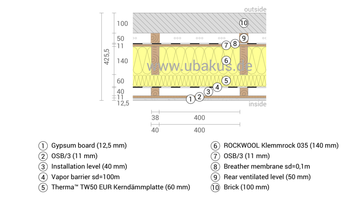

Thanks for the pointers Mike, considerate of you. Being a carpenter I have many different types of saws mains, battery and arm powered! I'm still finalising the spec, only certainty is that gypsum plasterboard & skim will be the finishing layers. In terms of insulative performance and mitigation of interstitial condensation risk, I'm ranking rigid wood fibre board bonded directly to the brickwork with adhesive number 1. That choice will require the entire depth of studwork to be in front of the insulation depth, however it also then creates a service cavity of good depth, so this buildup would work well in the kitchen and bathrooms where services and domestic borne moisture will be most prevalent in the house. In rooms and walls where there are fewer services ran and less habitation, (guest bedrooms and hallways), I am thinking that flexie wood fibre or rockwool batts fiction fitted into timber studwork would perform satisfactorily. I had initially thought of using the same buildup throughout but I suppose I can "upgrade" to utilise natural fibres in the areas of the house where greater volumes of moisture are created. -

I find it strange then that Rockwool require the cavity space, although I think there is more joined up comprehensive knowledge in these forums than the technical departments of some of these companies! Furthermore I'm now leaning towards using wood fibre board instead of rockwool. Just monitoring RH levels in the house atm, and despite it being well dried out RH is at 70%, which is at the upper end of the scale. So I'm thinking the £1k extra opting for wood fibre over rockwool may be a worthwhile expense. -

Yes similar setup to your arrangement. The brackets are needed for that particular system though, as the studs are gyplyner type not C or I type. I actually called Rockwool tech dept with a couple of questions. The fella I spoke to recommended/was insistent that in IWI usage the rockwool batts are friction fitted between studs and that the studwork (and batts) are both stood 25mm off the existing brick wall. In effect creating a 25mm (unventilated) cavity space. @Iceverge in the example you shown earlier I understood that the rockwool batts were pressed up tight against the existing brick work. That arrangement makes sense to me, as otherwise the unventilated cavity is created and that seems like an environment where condensation could potentially form. Whenever I speak to product tech depts I invariably think I should not have bothered calling! -
