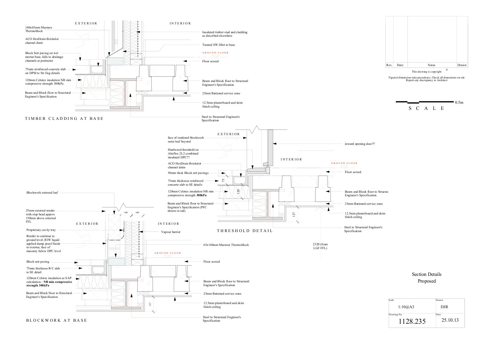

    Structurally it all is parking the sky lights will be slightly raised and to the sides of the parking zone . water proof concrete does sound simpler . But what ‘detailing ‘ is required ? Apart from the mix ....

    Resitrix
    Architects detail ! just following his ‘ plan ‘ .....

    Resitrix
    Lol it is structural you can park on the ‘ roof’ the rest of the dwelling is below ground

    Resitrix
    Hmmmmmm obviously not the right product for my needs . Though he did seem to know his stuff and suggested this over edpm ....

    Resitrix
    So I have my concrete ‘roof’ then need the waterproofing ( company suggested this product as it can take the loading ) then insulation then reinforced concrete then water ever for finished floor / roof cheers
