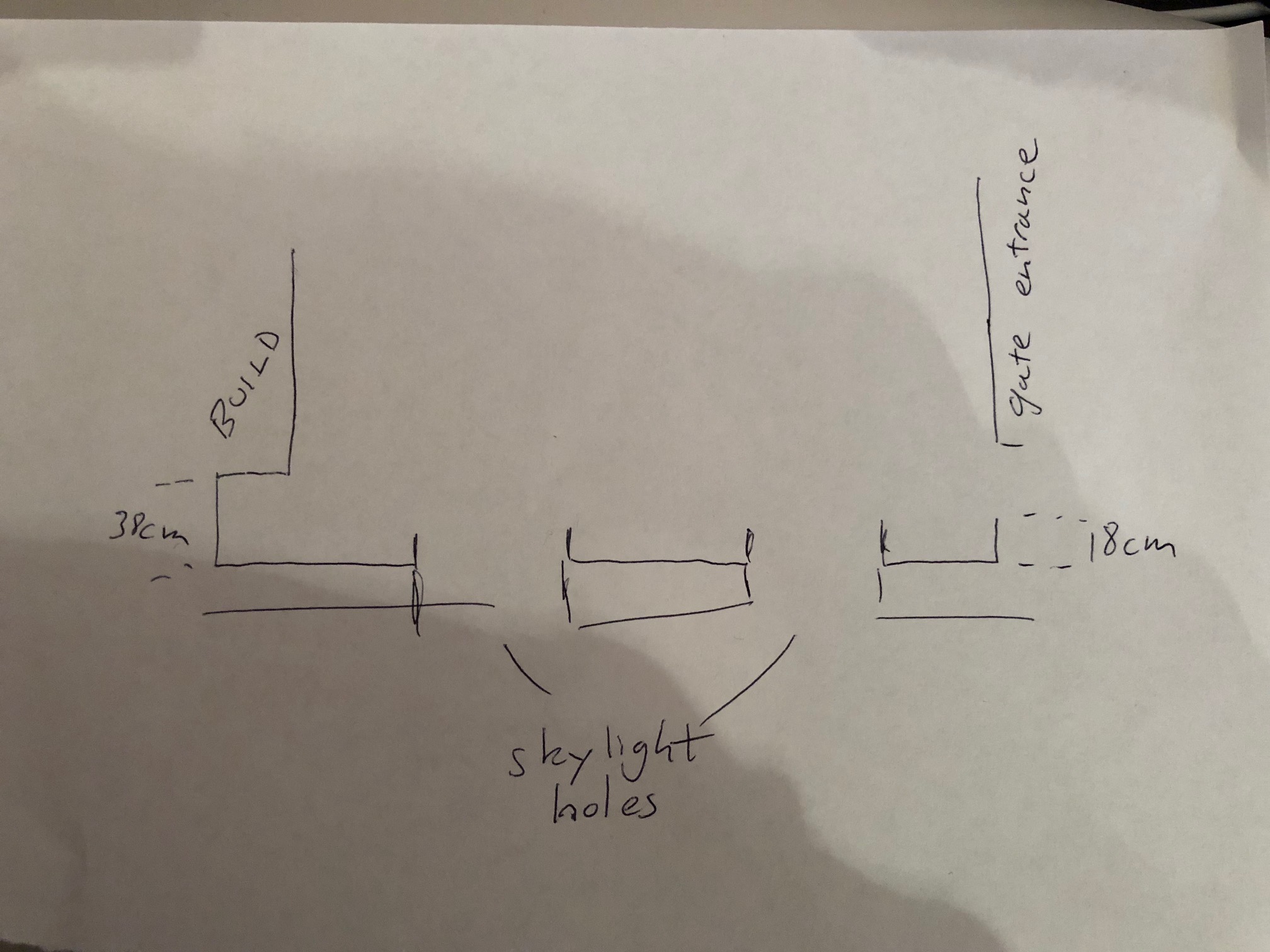

Hey all, Been looking into this. I do like : https://www.sunsquare.co.uk/skylights-and-rooflights/upstand/ But the up stands are £200!!! . They are just 4 bits of wood (maybe insulated I guess). Surely no one pays that much for them?. Some suppliers don't supply the upstand - should I just make my own?. What's everyone else done with sky lights/walk on glass?? Cheers
He hasn't provided a lot! The 'roof' can be driven on. As I said can't get 100mm (let alone architects required 120mm); so will have to do some internally on ceiling. No kerbs - the area is 'bound' on 3 sides so was just going to shutter the 1 open side. ( 1 side build, 1 side wall , 1 side kerbs for entrance but not above build) cheers
I’ve also found out the upstands are only around 150mm . So I assume I have to put concrete blocks around the sky light openings to gain height . EDPM up them . Add the upstand later - so glass is flush with finished floor and add an EDPM layer around the upstand overlapping the concrete blocks EDPM ???
Sorry if I confused you. My current concrete slab is level with 4 sky light holes in it. My build is 38cm above this and at the plot entrance 18cm so I need to generate a slope for that. So I *assume* (that word again) ; once the up stands are in and I've made my slope (sand + dry cement a good plan?) ; plus I know what my final floor finish will be I cut the in situ up stands to match the fall..... ??????????????? I measured the length of slope and at it's longest point it's 6m.
Thinking about it ..... make my upstands too high as I said so cut to suit . Create my slope with sand and dry cement . Get my slope then sprinkle with water to form my semi solid base before final finish ( architect has paving blocks ; but they will be too thick - what else can I do apart from patio type tiles ?? ) cheers
Ok . wont that look bad I.e 50 mm steps ?? I was wondering if I could install higher than I need up stands then once I know my final floor finish cut them in situ to suit ....
My wonderful architect has just supplied a drawing which he forgot to give me ! Needless to say that causes issues He wants 120mm insulation ; this of course isn’t possible with a 75mm screed . if I use 50mm can I insulate internally ( on the ceiling ) to claw back the u value ? . Would insulated plasterboard help ???
Distance is approx 4m will measure properly tomorrow . what do I do about the 4 walk on glass up stands ? Do I mount them at different heights to follow the fall ? I.e tilted ??
Right! : Architect's been out and yes there are issues! Started a separate thread as it's a different question The 'front' slab of my property conceals an underground portion of the house. So the 'plan' is (bottom to top) High compressive insulation i.e. expensive EDPM ; this has to be used as waterproofing and also I have 4 walk on sky lights; so has to waterproof around the up stands (haven't bought them yet!! $$$$$$) Cavity drain (Anco) type thing in front of build and at front of plot to deal with surface water Rebar + concrete pour on everything else The 'front' of the build i.e. the entrance current sits at 38cm from the existing slab (50mm for insulation ; 75mm for screed planned) The front of the slab i.e. where it meets the road is only 18cm So I need to create a gentle slope (Architect had babies telling me the entrance to the property needs to be level or no more than a 20mm step ) My question is where do I make this 'slope'. I *assume* (dangerous word) ; I do as planned and for the final finish (tile, blocks whatever) I make the slope then going from 380mm-50mm-75mm 255 (front of property) to the edge of plot 180mm-50mm-75mm = 55 At this point in time I have no idea what the final finish will be! Any advice welcome!
