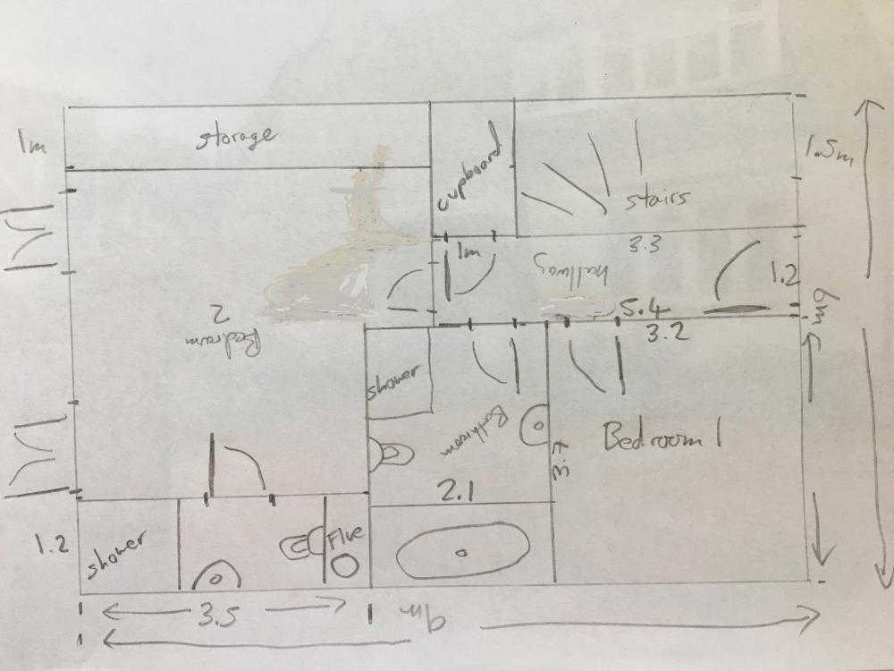

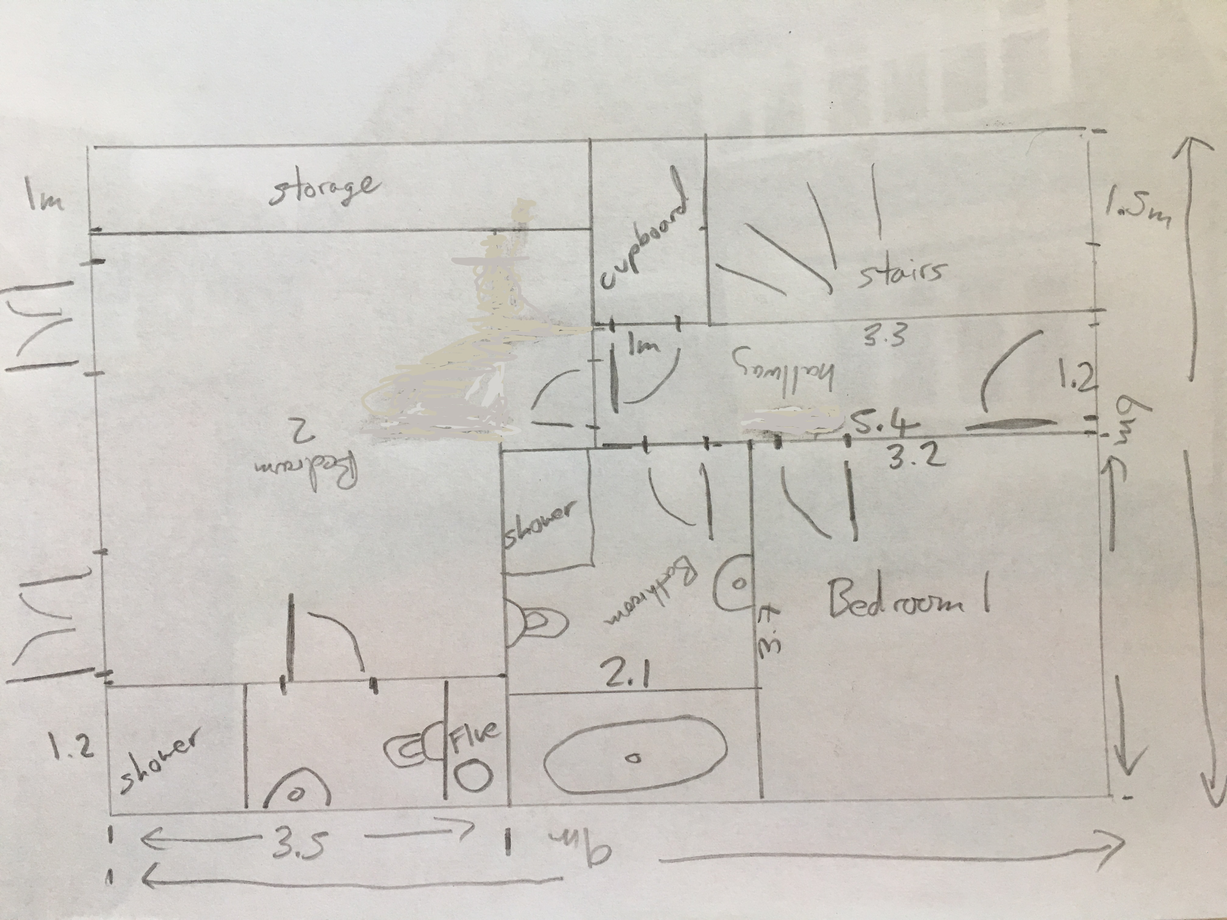

  1. Ensuite as it stands dimensions internally are (allowing for frame + plasterboard etc. ) 70cm x 330cm It won't be quite 330 because some boxing in must be allowed for the flue. So a 70cm shower tray would fit. But allowing for the shower door opening i.e. clearing the sink - might be tight - or might just be my imagination!
  2. I did wonder about the bathroom loo against a bedroom because of noise. Once someone had replied about how 'thick' that wall needs to be I was then going to ask about sound proofing....... Wife didn't want freestanding roll top bath in bedroom - so that ended that conversation real quick ! I did consider rotating the bath but it felt most 'efficient' across the bathroom width. Wife might also want his & her sinks () so must allow for that possibility!!!
  3. Hey! Yeah the ensuite is a squash - TBH it's larger than our current ensuite. It could go the other side and replace the storage & cupboard. Bathroom and ensuite were all put on the same side because the sewer access is that side. Not sure there would be enough of a fall to run from one side to the other for waste etc. beam and block floor. I was concerned about 'stepping' on ensuite/storage not sure it would look right (hence why running right across) Certainly would make for a nice larger shower. But how do I get the waste across? also how does the wet underfloor heating pipes 'cross' the (presumably pumped) waste?. Or do I take the waste high ? (via the ceiling ) across then down?

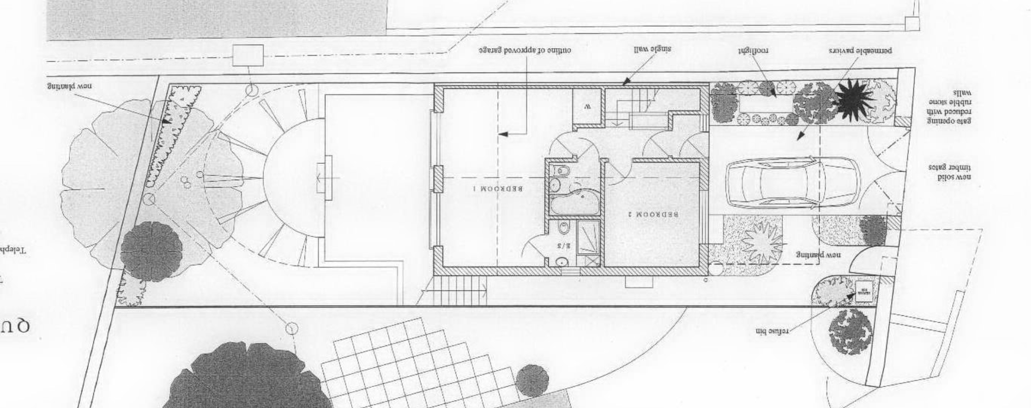

  4. Hey all, Please see attached the original architects layout suggestion and also my *rough* alterations. Any suggestions or comments on better use of the space appreciated. The measurements are fairly accurate but I do have some concerns. Measurements are from *outside* of timber frame so don't allow for thickness of it; originally it was 100m now 140mm. This makes the ensuite shower very tight (originally a 80x80cm standard one); due to the walls thickening now maybe a 70cm wide one? . I can't increase the width of the ensuite as the french doors wouldn't line up with the doors beneath. The bath. The bath in our current house is 1.8m ; i realise now this is quite a long bath. In the new bathroom I don't want the bath tight against each wall - always looks 'squashed' too me. I could widen the bathroom or simply get maybe a 1.4m bath instead? Bathroom toilet. We plan on having a wall hung toilet. I understand that wall will need to be thicker to accommodate this; but how thick?. I have found a super slim wall cistern anyone installed one of these?? https://www.livinghouse.co.uk/acatalog/slim-concealed-toilet-cistern-and-frames.html We plan to add an external porch to make up for the removal of the architects solution. I'm planning all this ready for the timber frame. What width should I allow for a door fitting? 100cm?? (to allow for lining , fixing, packing etc.? Cheers

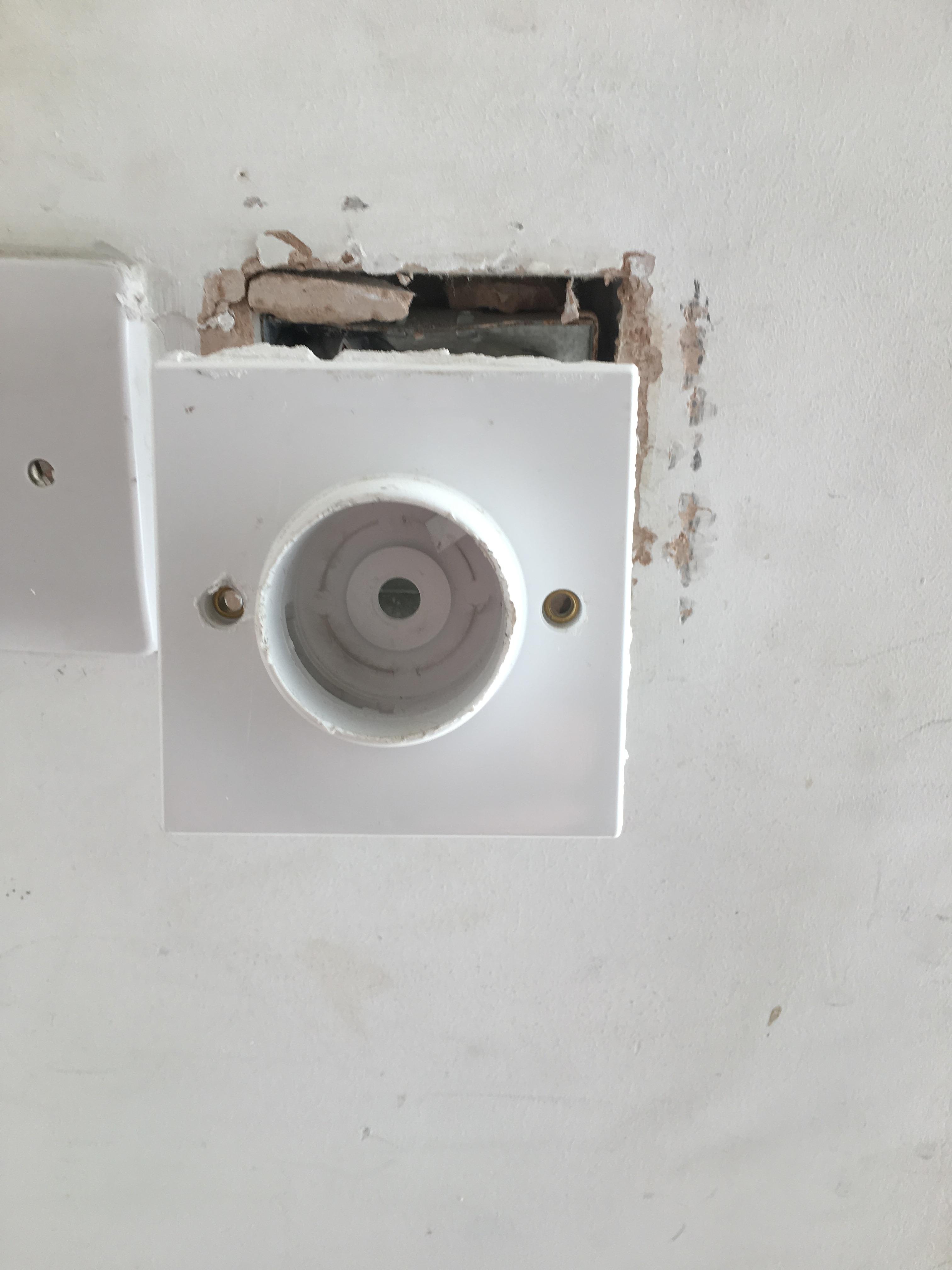

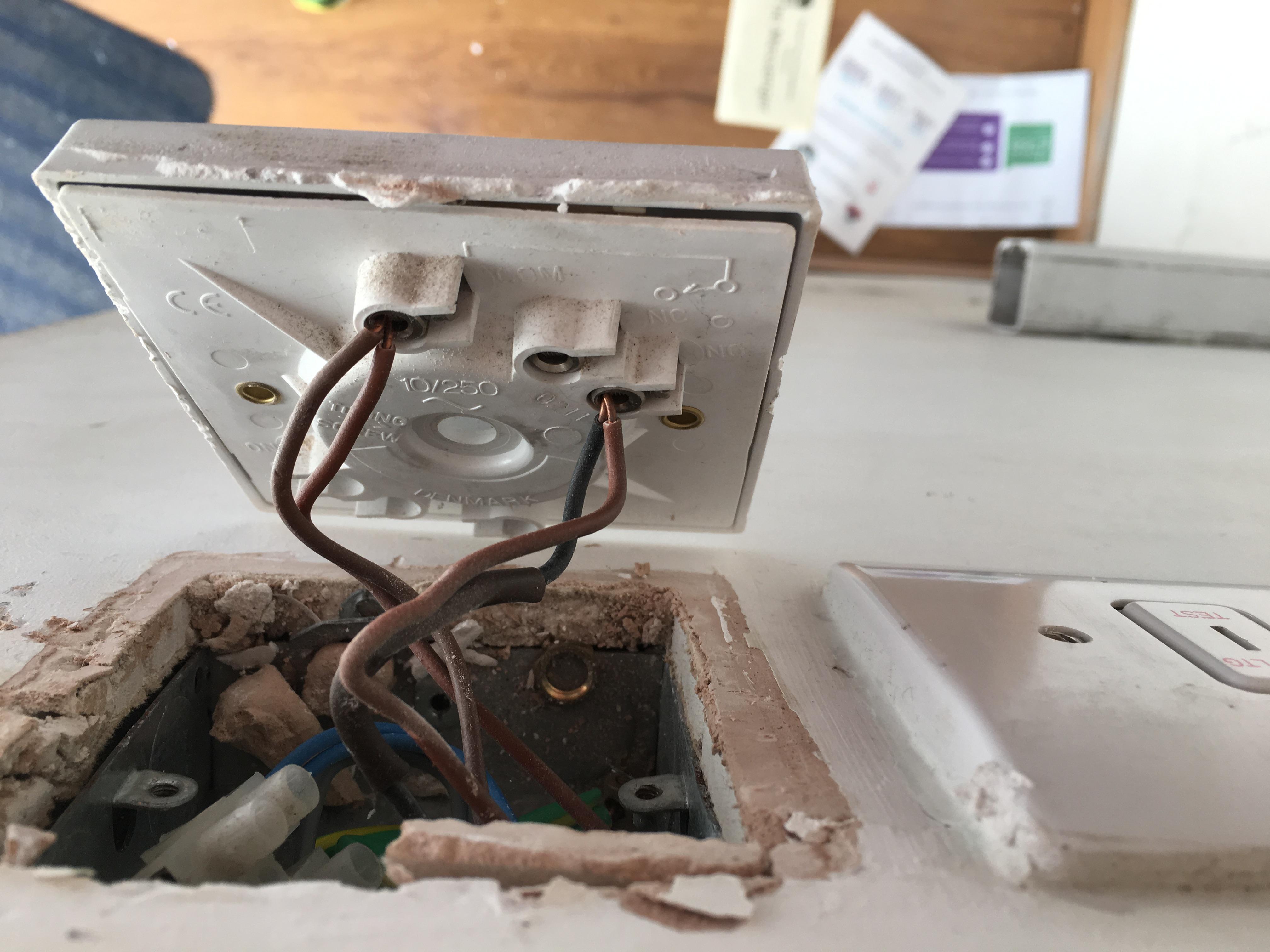

  14. Brilliant explanation thank you ! the stairwell is the entrance way to 2 flats ; ground and first floor . so do I purchase a normal pneumatic switch ? - nothing special just bog standard ?? cheers again
  15. Oops ! shoujd also mention ( may not be relevant ) there is battery backup emergency lighting . So when I flip the ' stairwell lighting ' trip off emergency lighting kicks in . cheers
  16. Hey guys thanks for the help ; now I am confused ! there are only 2 switches and 2 lights . Either switch turns on both lights . the upstairs light switch was the same mechanical type but just 2 brown (live) wires . I replaced that with a 1 pole timer touch switch which seems to work I.e turns on both lights . so the downstairs one as in the photo is the issue . I *guess* if I bought the exact same mechanical switch I'd be ok ; though still not finding what I need online . A direct replacement makes this easy ; yeah ?? cheers
  17. Hey all, I have a hallway where I have a switch at the base of the stairs and a switch at the top that turn on jointly lights top and bottom of stairs. They were the push mechanical ones which are now busted. I bought a cheap (eBay!!!) one for the top stairs that seems to work (bit flakey). The down stairs switch is dual gang (is that the correct terminology?) anyone recommend a non mechanical switch that would work here? Cheers
