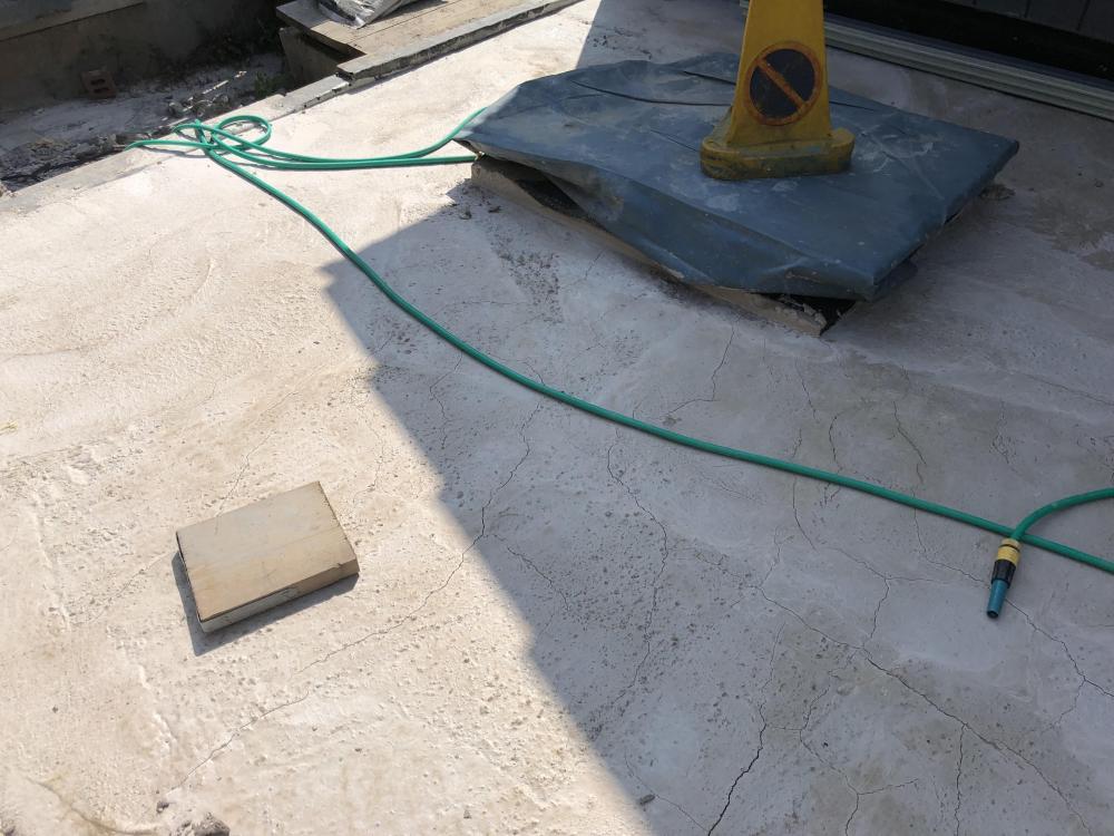

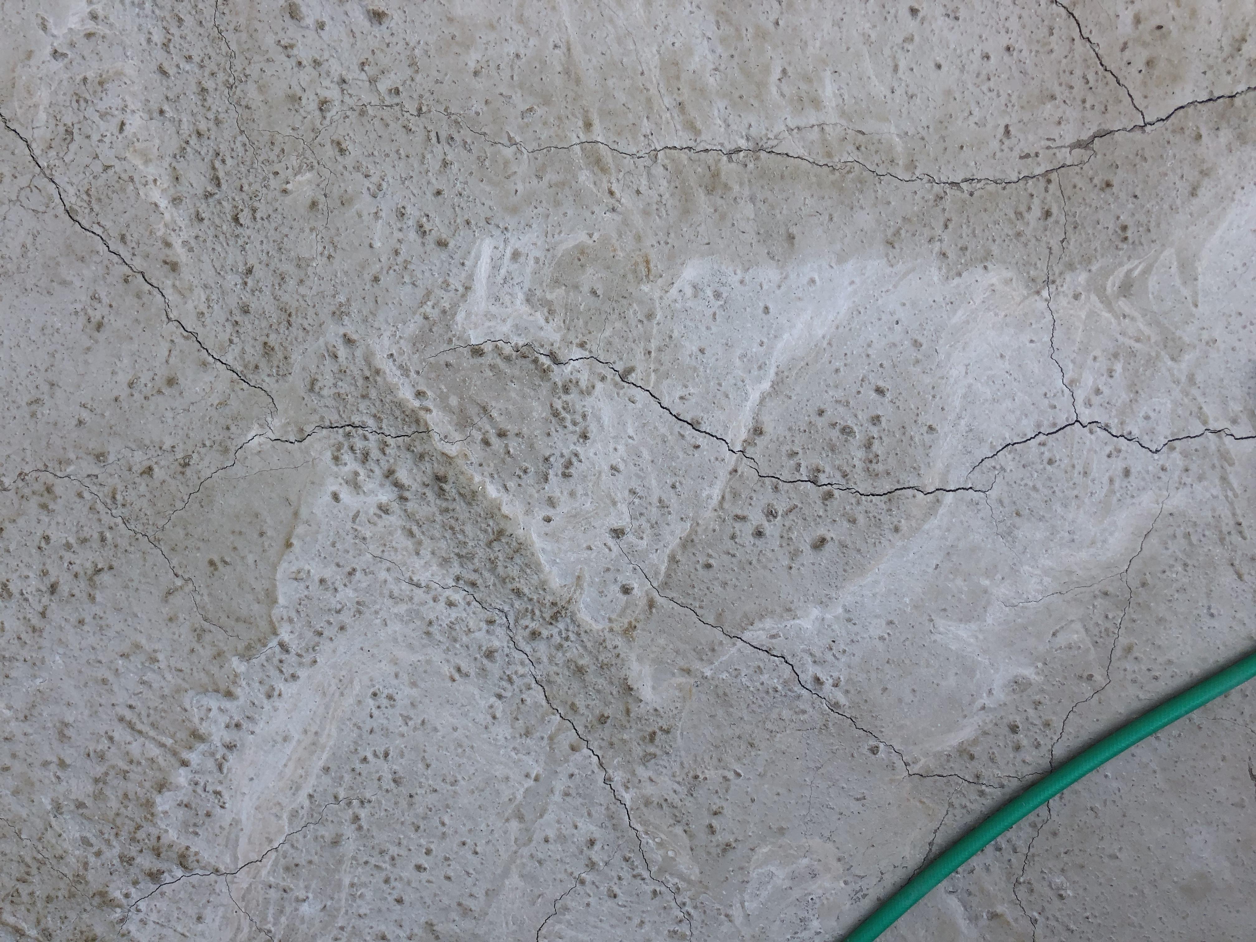

Yeah but I think @Cpd is saying “drain where ?” This is all above living accommodate so the edpm is the water proofing . Once rain water gets through and lands on the edpm it is stuck until it evaporates . I’m not sure what to do now !
I think my point is even with driveway pavers some water will soak through anyway .
Yep agree ! As water is bound to get in then I think that’s why the roofer said expansion gaps - so at least it can evaporate with air flow . Because the ‘roofer’ bodged it ; it’s not like your drawing .

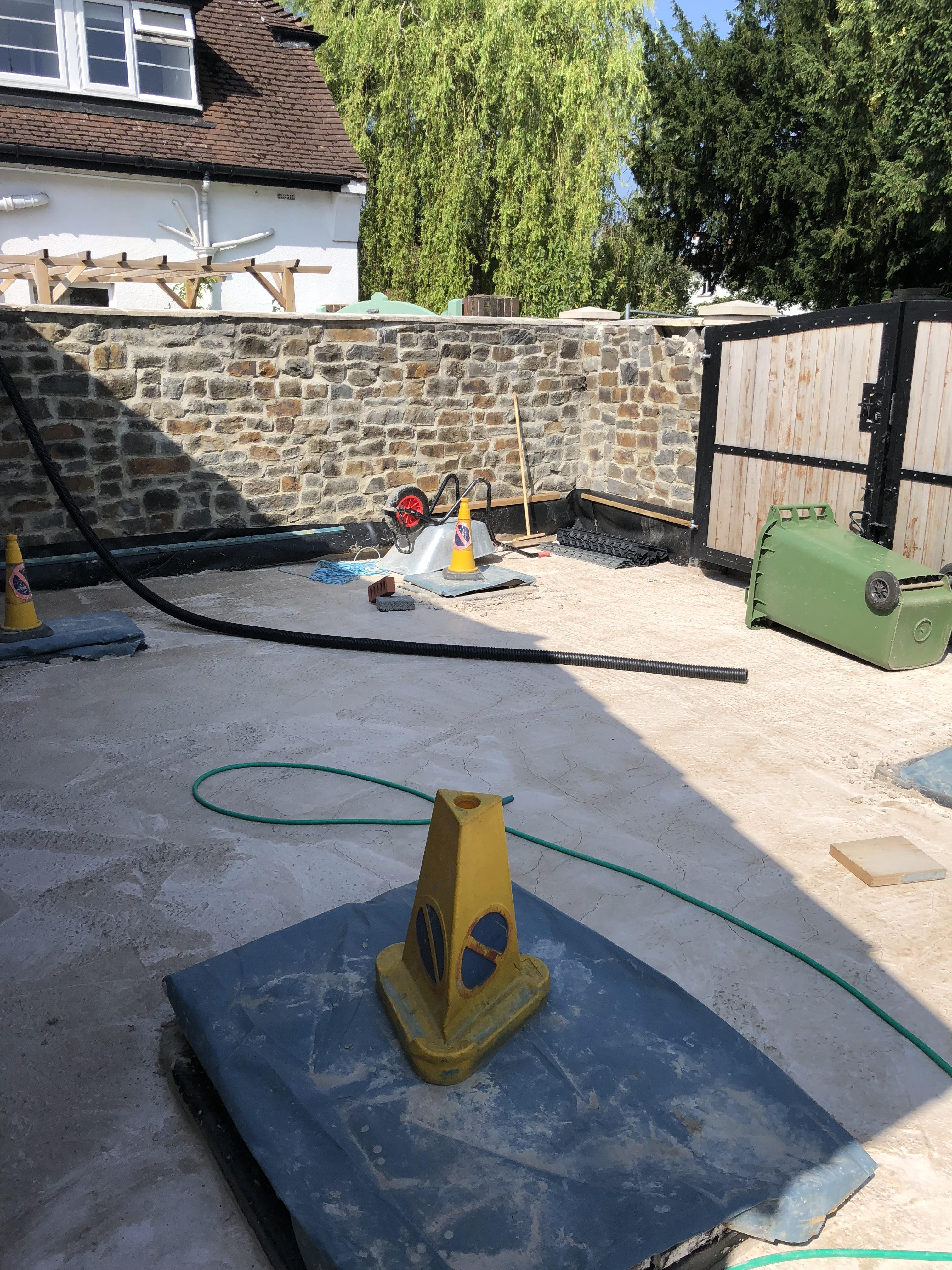

Hey So the layout top down is pavers sand chippings 75mm concrete reinforced edpm cement board expensive insulation concrete reinforced 100mm The 75mm concrete is ‘level’ to the other 2 edges of the plot for run off . plot has slope away from house drainage channel with be placed directly in front house and at front of plot ( gate entrance and lowest point ) that help ? ?
I’m taking a vote on this with myself . I won the vote ?

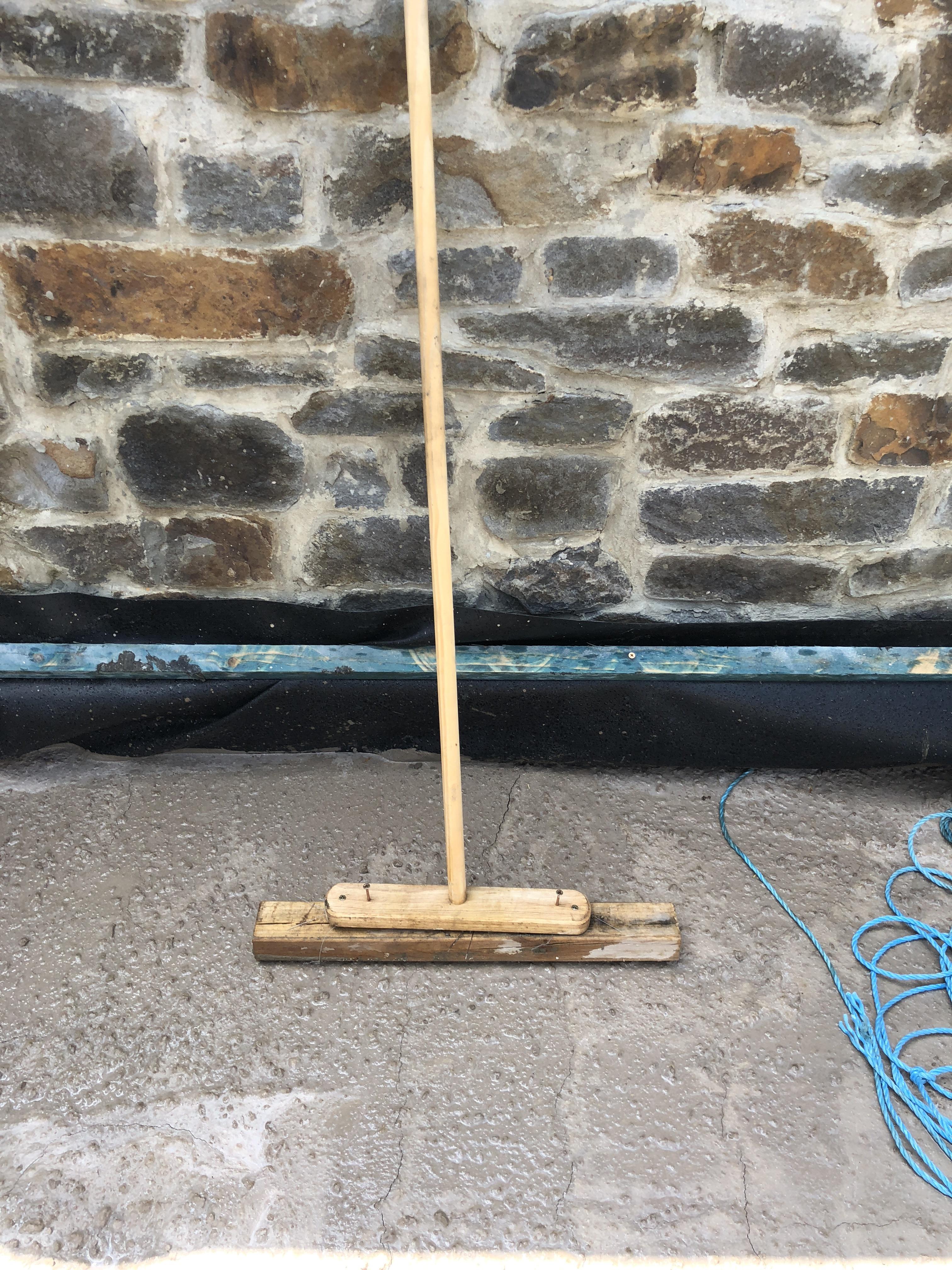

Actually thinking about it .... if if this was done correctly edpm would be up past the final paving block level . Then the flashing would hang over it and sit on the paving . Because my flashing is below ground (effectively ) any moisture that does get in there can’t escape - it’s not breathable . The expansion gap would allow condensation and air flow under the flashing lip . Have I convinced myself a lie ??? ?
Thanks ! maybe ! I don’t know Is the theory correct though ? Can’t do any harm putting it in can it ???...... Someone with more knowledge please join in ?
Ok ! got the first length in pretty good ! Over the worse of the lumps will stick ct1 all along the top and into the slot By pure chance a roofer was parked nearby so I grabbed him . Once he finished laughing he said as the flashing is below my block pavers that I should put a fibre expansion joint in front the flashing . So the concrete stops short and the expansion joint will allow any water that does get in to evaporate otherwise without it I might get the capillary action . This sound right ? If so , after googling ; can’t actually find a product ( he said 3m long 3 Inch high ) cheers
Ffs ! tnt ; next day delivery ; turns up 3 days late . Ordered 3 items , but am expecting 4 parcels ? ; just flashing has turned up Just placed it in grove too see - need to cut deeper . Also to get ‘over’ the stone bumps recon I can ‘hammer’ around them and deform the metal . No one ever sees it ?
