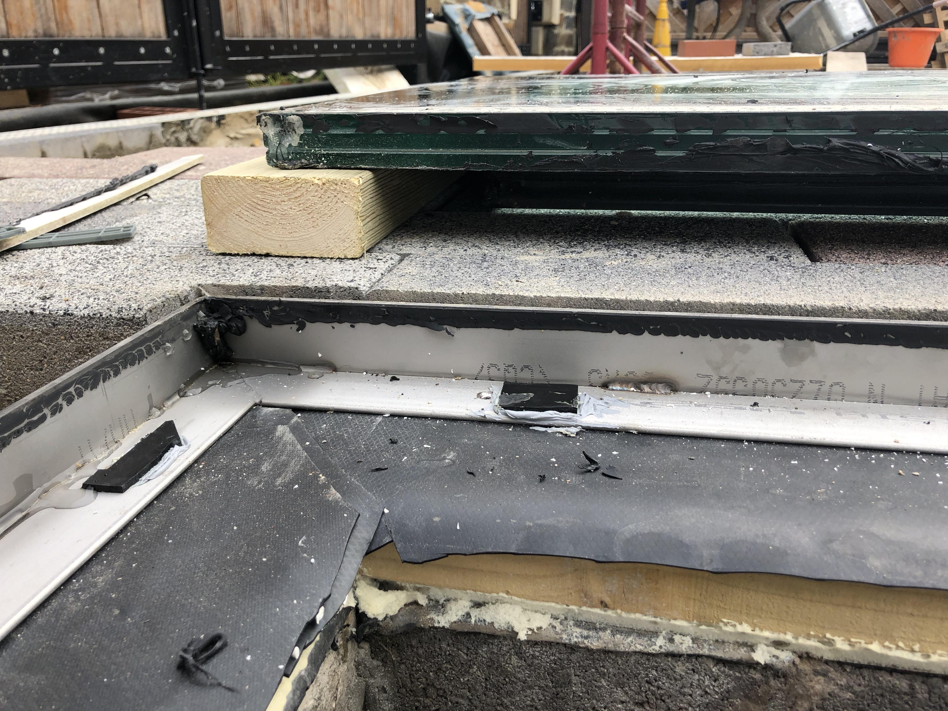

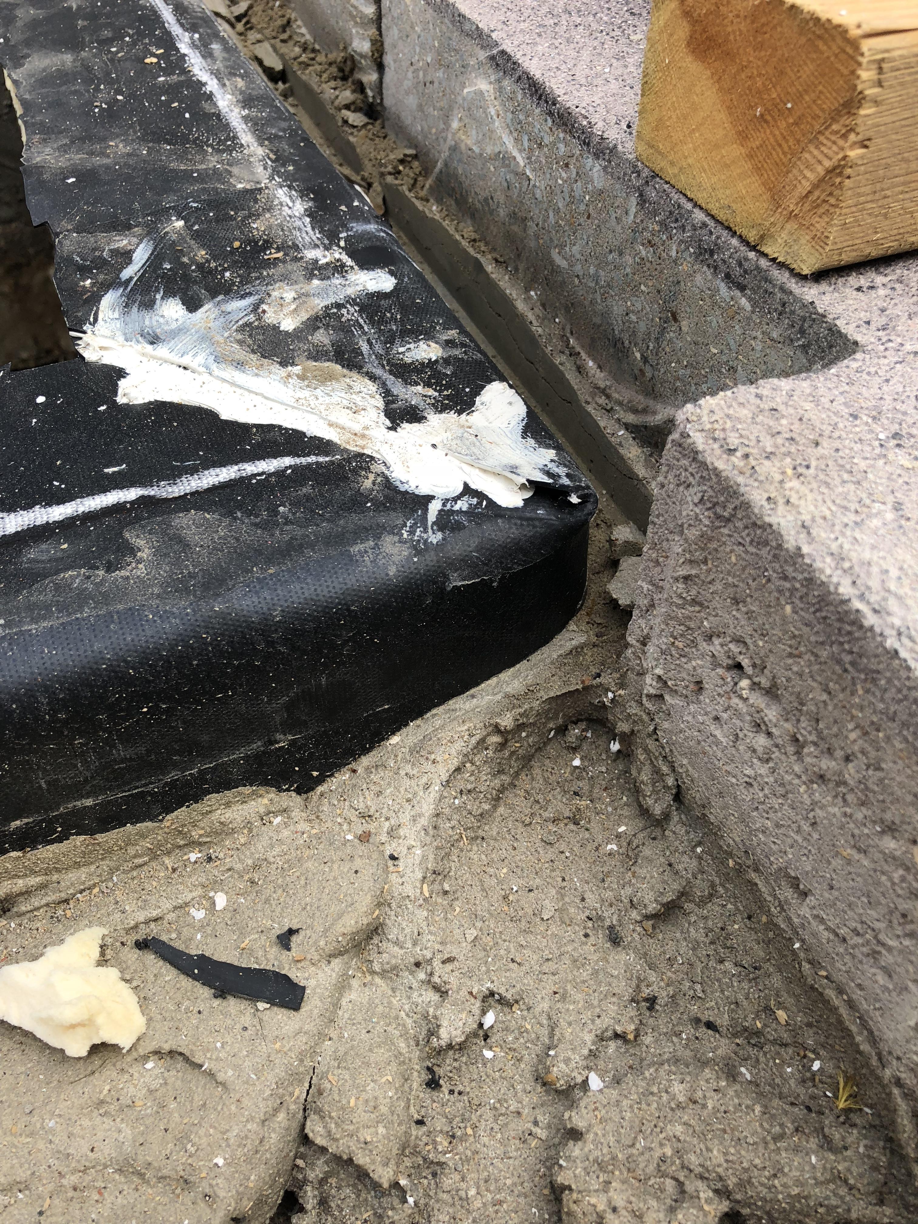

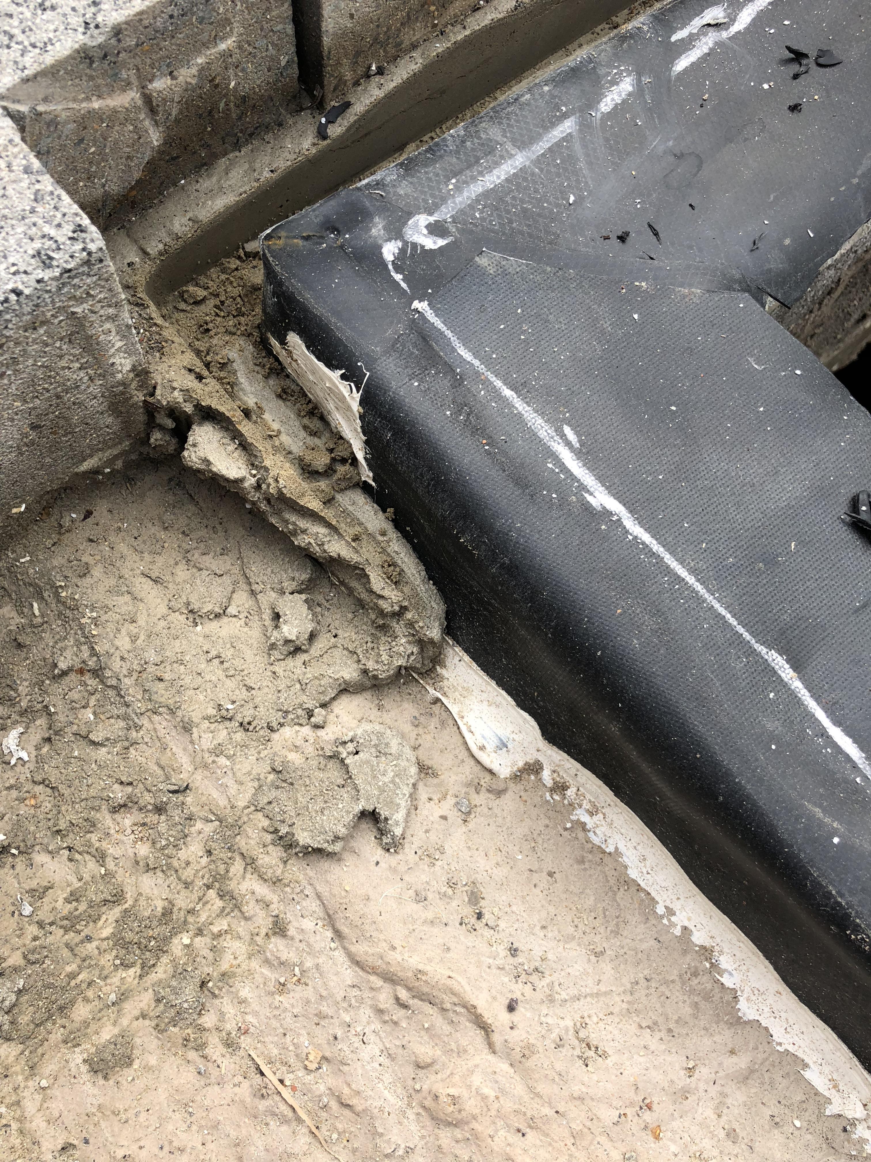

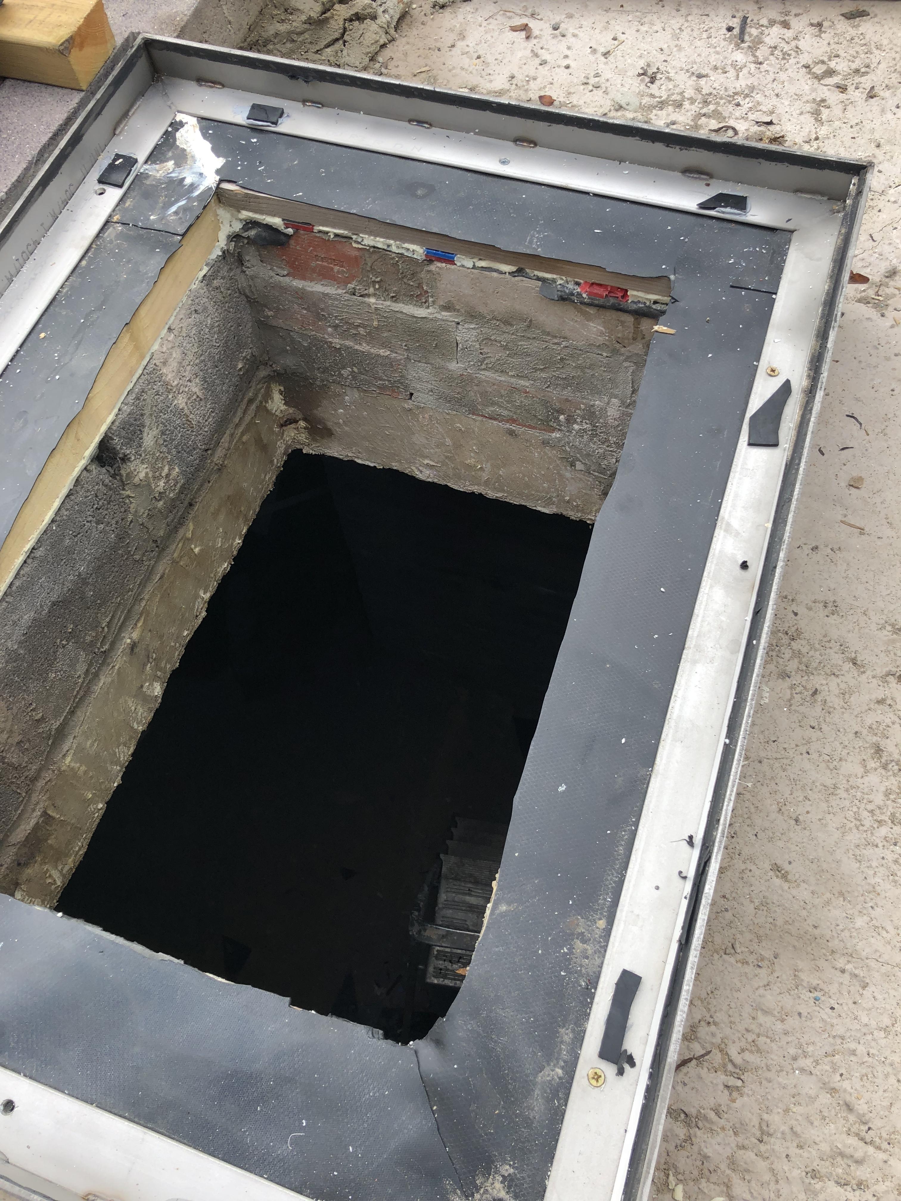

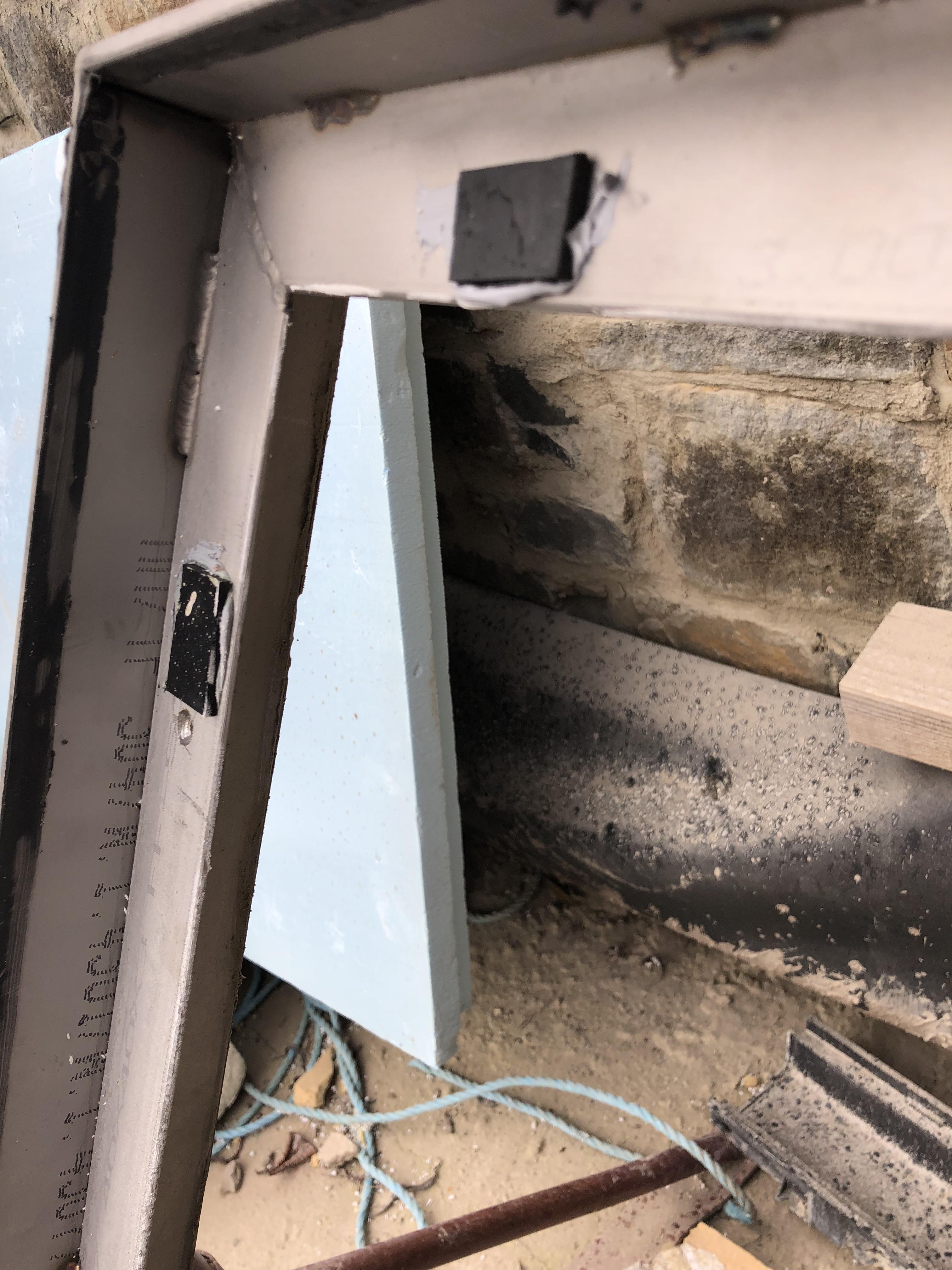

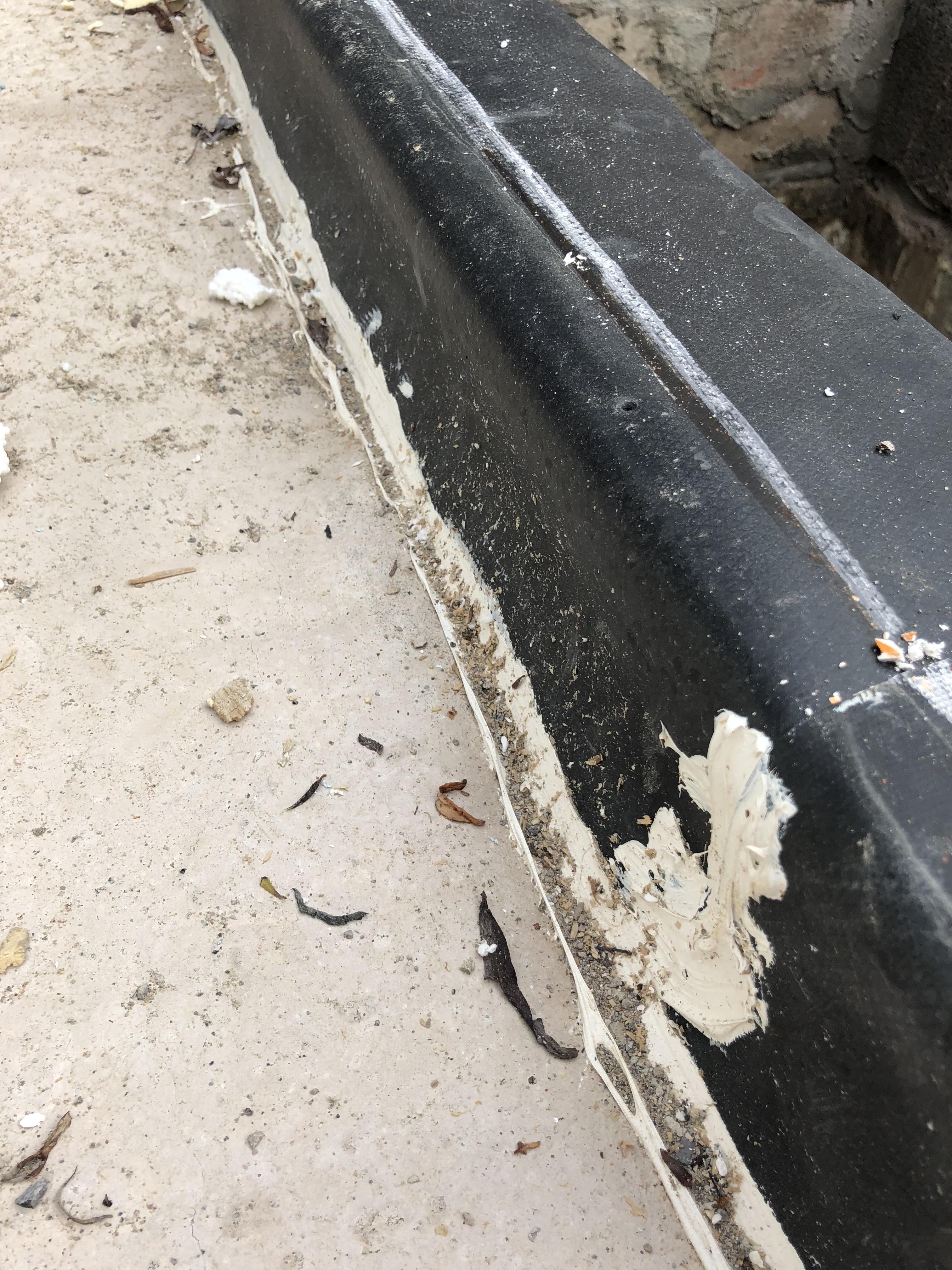

Well i managed to get the smaller window out which does leak . looking at it - hard to imagine the water level got that high I.e over the black rubber . Some photos - perhaps someone will see something I haven’t cheers
Thanks which one ? I assume stuck on the underside of the T frame so it expands towards the upstand ?
