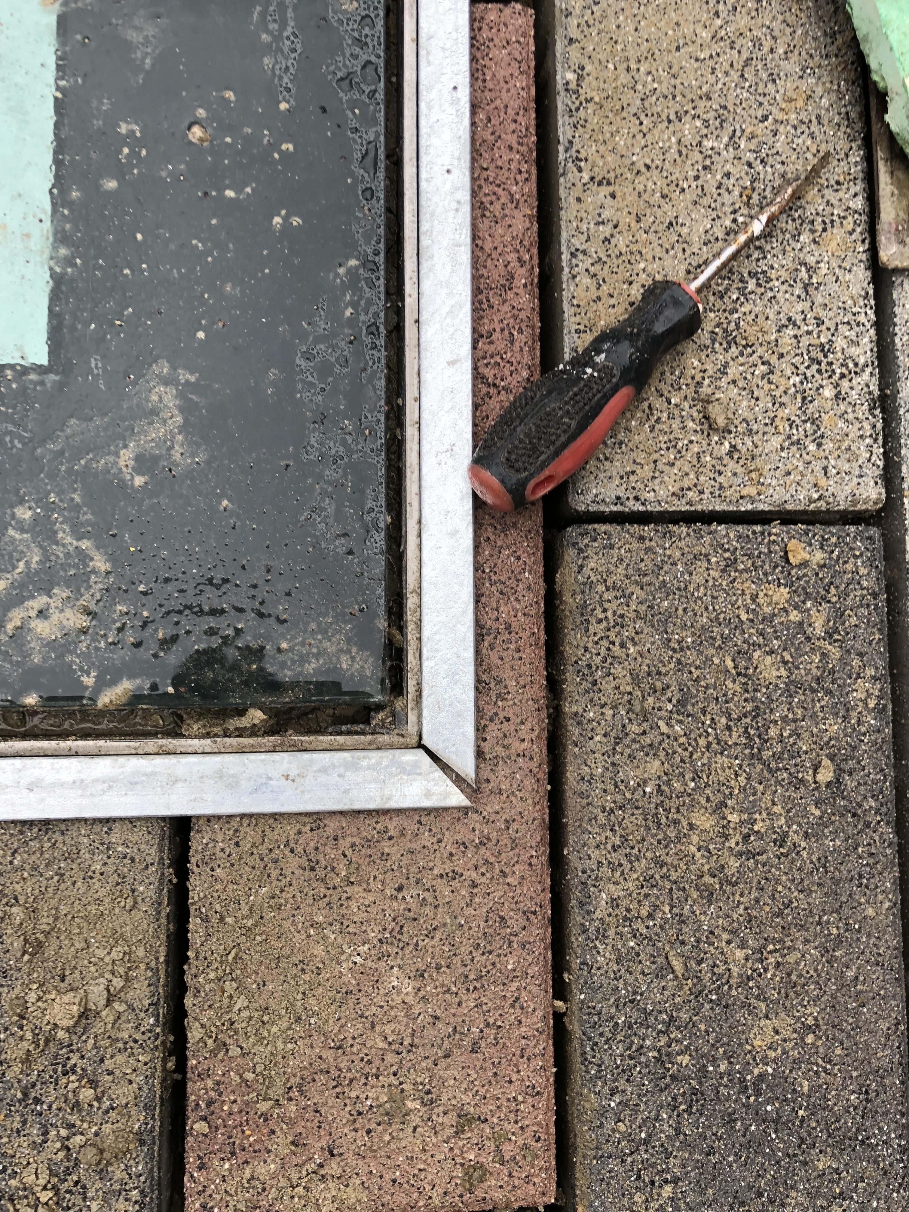

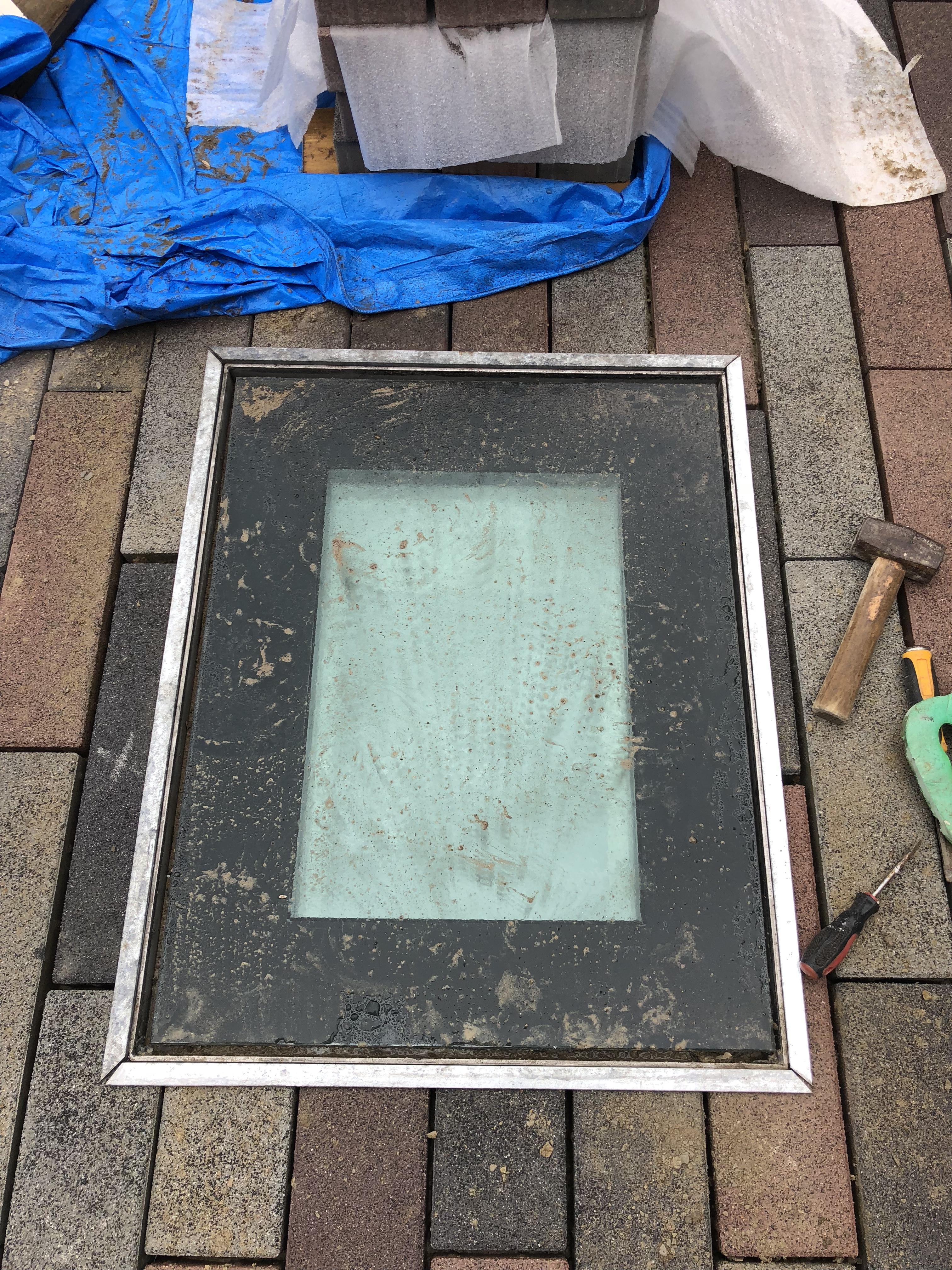

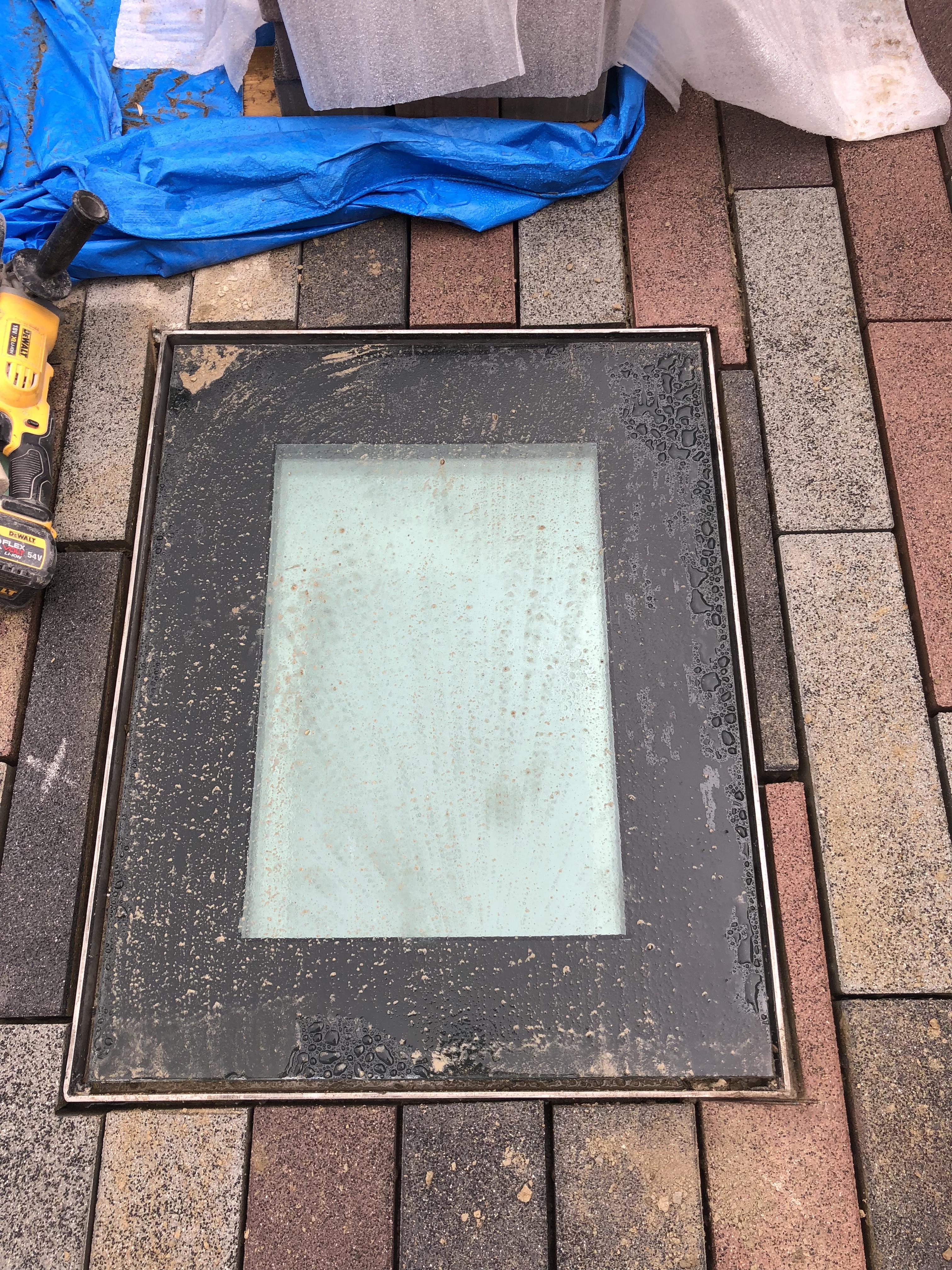

  4. Ct1 on the upstand then screwed in place . I wasn’t keen on this because there’s no way of knowing if it’s a perfectly tight seal all around . Im tempted to cut the structural silicone out around one piece of glass . Remove it . Then re do the ct1 between upstand and frame . But I’ve still got no idea how perfect or imperfect the seal is until I put the glass back in and silicone again . Also the largest glass weighs 130kg - so not much fun ....
  5. Lol Nope ! i did wonder if it’s just a ct1 everywhere job . To get under the lip will be difficult . Will post photos tomorrow. Really need a ct1 expanding foam type mega product . Actually how do I get ct1 under it ????
  6. I tested it ever step of the way . No leaks . But it would seem not 100% once water level is high enough . Only found this out because I started doing the paving . Windows with no paving ( as of yet ) fine . To get the pavers flush with the glass I build up with mortar etc . Thereby putting water level higher .
  7. So! I assume that rainwater is getting under the upstand because the concrete floor level is now level with it due to the block pavers! This area can be parked on and so drainage etc. wasn't an option. Not sure what to do. It's like I need to 'water proof' the window frame and upstand again somehow!!! My pavers seem to be the exact depth of the frame upstand unfortunately!! Previous to block paving no leaks - as the water level never got high enough.......
  8. Maybe. Kind of discussed it here a bit ....
  9. I will Rather annoyed tbh . ZERO leaks - checked it every step - but it’s water getting under the window ‘frame ‘ because ground level is higher because of the block paving . Sketch soon !!! ?
  10. Hey ! These have been leak free . Ive started doing the block paving around them . I haunch the concrete against the upstand so I can bed the brick . I think this is the issue ( obviously complete I would fill all the block paving joints with kiln dried sand - but can’t rely on that .... ) . So ! ; I think rain water gets in this gap ( at the moment ) and can creep in under the frame . Should I just ct1 the gaps around glazing unit and pavers ? . Just ‘top up’ with sand for astetics at the end ? Or bust those pavers out and ct1 under the frame ??? can stick a sketch up showing the upstand and pavers construction if that helps
